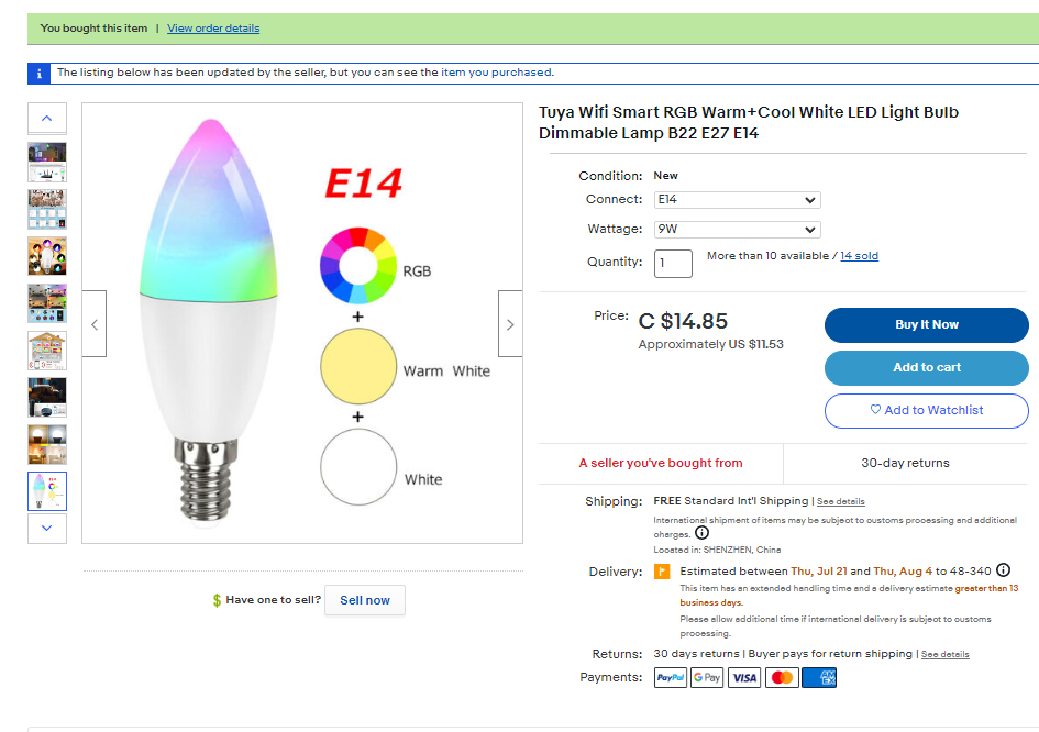

    Hello, I will present here two seemingly typical LED lamps (E27 and E14) RGBCW Tuya Smart, which are distinguished by the fact that they are extremely difficult to program due to the obscured UART pads in the WB2L_M1 (BK7231N) modules. Normally, to change their charge, you would have to unsolder these modules, but in the subject I will show an alternative, more convenient way, i.e. changing their firmware without opening the housing thanks to the use of tuya-cloudcutter . The firmware will be changed to mine OpenBeken , the equivalent of Tasmota, intended for the more exotic platforms used by Tuya. The topic will be another description of the interior and programming of IoT devices and will not cover the topics already discussed. I invite you to learn about the other topics from the series, you can find them in this section ( Equipment interiors ).
    Purchase of the bulbs
    I bought both from China, below are screenshots of the offers:
    Two difficult to program Tuya WiFi smart LED lamps - E14 and E27 [WB2L_M1]
    I paid about 10$ (PLN 40) per item. In some stores in Poland it is possible to get similar LED lamps cheaper (regular one-color with WiFi was once even for PLN 15), but I wanted to check those from China anyway, because I am looking for popular products to add their support to my OpenBeken .
    The shipment was from China but there were no customs issues. I waited for the goods for quite a long time, several weeks, until I lost track of time.

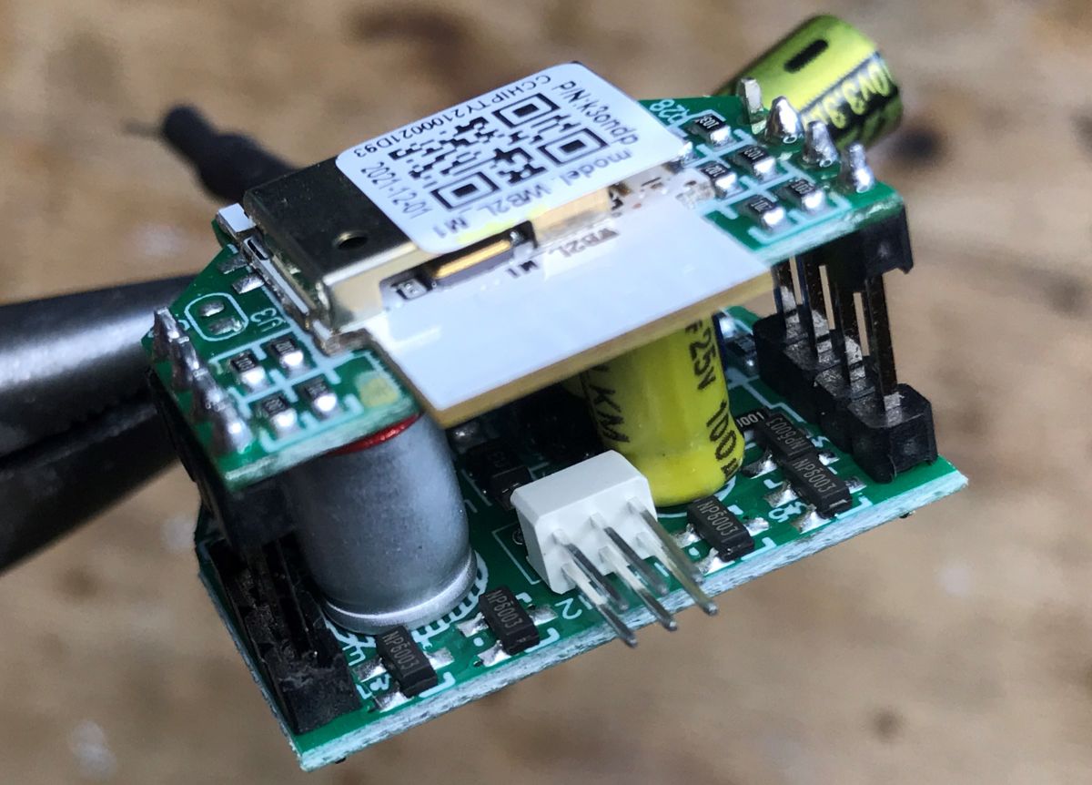

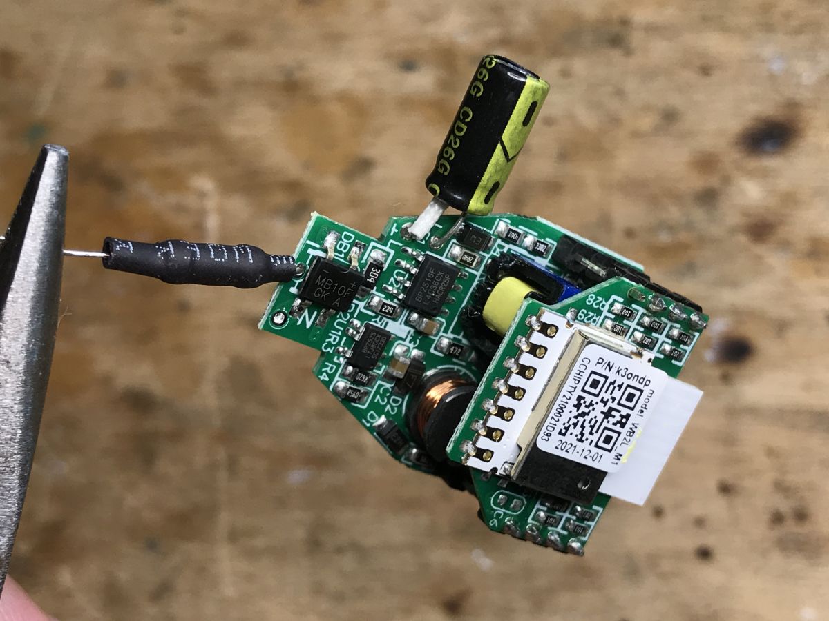

    You can see a fusible resistor (in a sleeve), a rectifier bridge, a WiFi module ...
    Two difficult to program Tuya WiFi smart LED lamps - E14 and E27 [WB2L_M1] Two difficult to program Tuya WiFi smart LED lamps - E14 and E27 [WB2L_M1] Two difficult to program Tuya WiFi smart LED lamps - E14 and E27 [WB2L_M1] Two difficult to program Tuya WiFi smart LED lamps - E14 and E27 [WB2L_M1]
    There are also two integrated circuits. BP2616F and BP2525. BP2525 is a transformerless power supply, it most likely provides 3.3V for WB2L_M1. The second component perhaps provides power to the LED.
    On the other hand, you can see five NP6003 transistors. Five, one per channel, R, G, B, C, W. These are of course N channel MOSFETs .
    It is worth paying attention to the Vds. Such a low voltage? This is because they do not switch the mains potential directly, they are connected downstream from the BP2616F. I also suspect that the BP2616F limits the current, so even if we permanently open all these five transistors, we will not exceed a certain predetermined barrier (I used to check it, smart LED lamps work either in RGB or CW mode, never all The LEDs are lit at once, out of curiosity I turned on all the LEDs one by one and I saw that after turning on RGB and CW at once, the current does not increase any more, because the BP2616F system limits it).

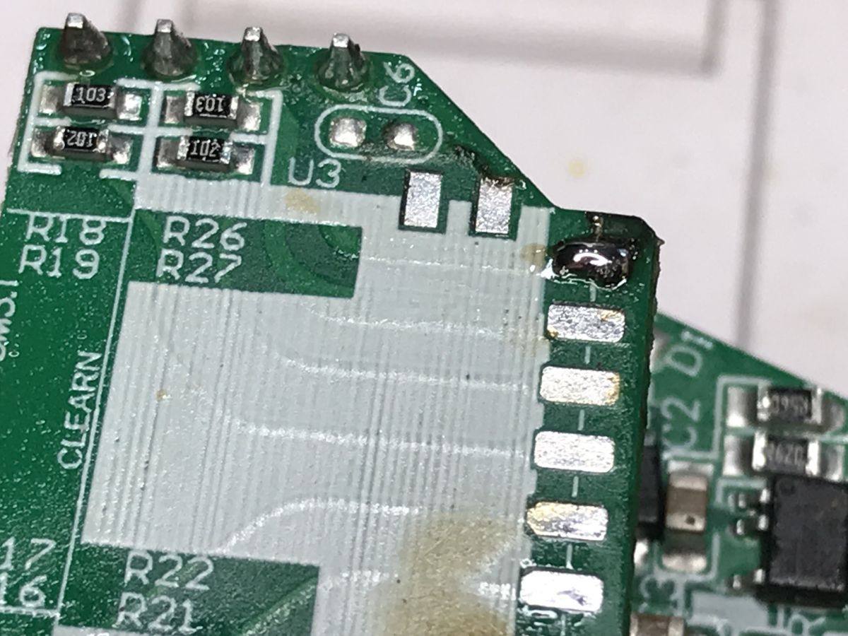

    However, this is not an ordinary WB2L. The WB2L has a BK7231T inside and the WB2L_M1 is based on a slightly newer Beken chip, the BK7231N. It is worth remembering about this when uploading the firmware.
    Additionally, we see that the RX / TX pins are covered.

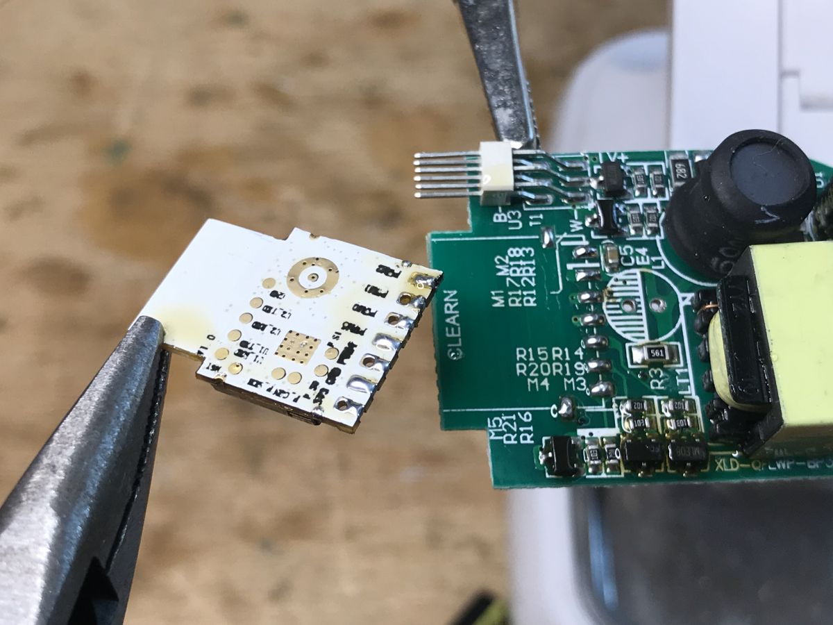

    In order to desolder the module, I added flux and fresh Pb solder (Pb solder has lower melting point) to its pads and started to gradually heat them with hot air:

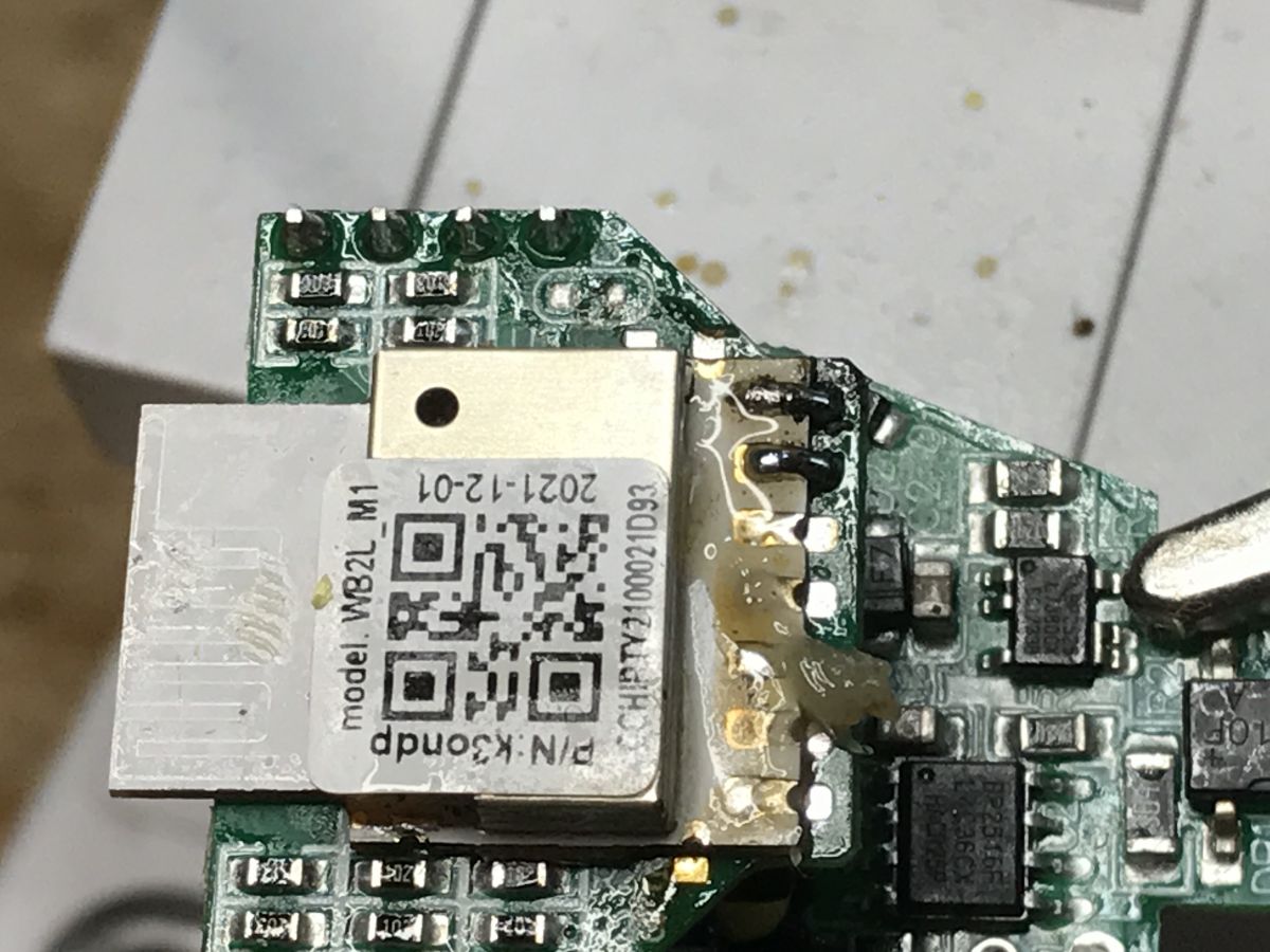

    At the bottom of the module you can see the desired UART interface for programming:
    Obviously, this module is going to come back into place. You need to clean the pads with a braid:
    I also washed the plate, I have an IPA cleaner for it.

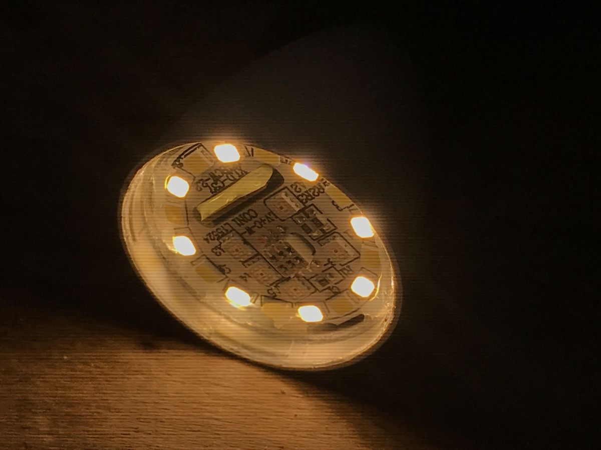

    That's it for this lamp. It is also worth showing how the individual colors shine:
