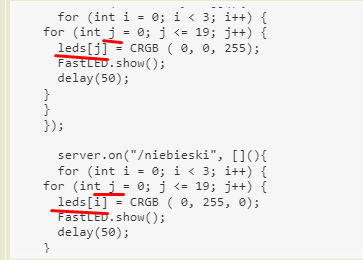

  • Adding WS2812B strip control to ESP8266 web UI
    #1 20524335
    BusyBoy
    Posts: 124
    Rate: 15
    Some time ago using esp8266 nodemcu v3 plus transmitter id control TV via phone. Now I still wanted to add the ws2812b 5v led strip control.
    I added new buttons in the code and added the effect I would like when the button is triggered (code all)

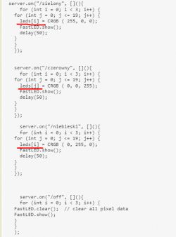

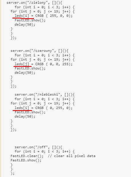

    [b]
        server.on("/zielony", [](){
        for (int i = 0; i < 3; i++) {
      for (int j = 0; j <= 19; j++) {
        leds[i] = CRGB ( 255, 0, 0);
        FastLED.show();
        delay(50);
      server.on("/czerowny", [](){
        leds[j] = CRGB ( 0, 0, 255);
        FastLED.show();
        delay(50);
        FastLED.show();
        delay(50);
        server.on("/niebieski", [](){
        leds[i] = CRGB ( 0, 255, 0);
        FastLED.show();
        delay(50);
        server.on("/off", [](){
      FastLED.clear();  // clear all pixel data
      FastLED.show();
    And here the problem arises. Because, for example, when I press the green button, the led bar works correctly, but when I press e.g. the next red button, the led bar "goes stupid" and starts green, red, blue so not the green colour itself. The buttons work with a delay. Unfortunately I do not know what this is caused by ☹
    Maybe someone can help me with this topic....

    Why do you use i and j once?
    ESP8266 NodeMCU V3 + WS2812B 5V LED Strip Control via WiFi
    By the way, I don't know why you have these extra loops so strangely done. Aren't they by any chance just copied without further analysis from:
    Code: C / C++
    By the way.... if you have a constant in the code, why do you rigidly type 19...?

    By the way, I don't know why you have these extra loops done so strangely. Aren't they by any chance just copied without further analysis from:
    Yes you're right - I'm trying by trial and error somehow to solve this teamt - that's why I copied the part responsible for infrared transmission (ira) and converted it to led bar.
    Why are there two variables ? hmm as I mentioned - I copied the code - and since there was also a loop there, I used it plus a loop for the led bar.

    It seems to me that it would be better if you analysed what these loops were doing, rather than copying. I don't know the libraries by heart, but that loop up to 3 is a leftover from copying the loop that sent the IR codes three times. In addition, in one of the loops you use j and in another you use only i, with the result that you only change the first 3 colours, the others are unchanged.
    Remove the unnecessary loop counting up to 3 and change the colours only with one loop, for the stop condition use NUM_LEDS.
    You have underlined here what causes the problem:
    Also these delays are superfluous - they also confuse you and make it hard to keep track of what is happening. For this reason the bar can seemingly run with a delay.
    Another thing is that in the loop you have to set the colours - and the show is enough once outside the loop. You at this point in the loop do these 20 times delay and show....
