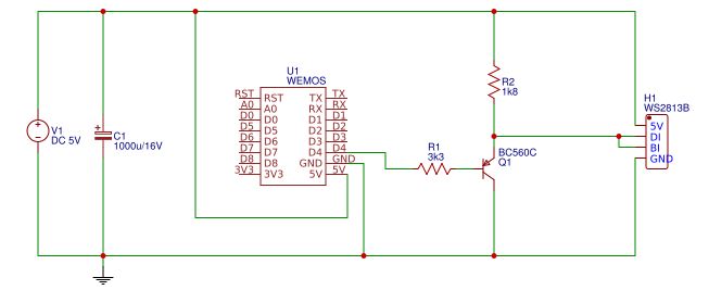

    I have an ESP8266 and a 5m WS2813 strip. All powered from a 20A 5V power supply. The first diode goes into such a strange state: it lights up either white/blue, once it paired properly after a reset. And now after plugging in it lights up red all the time. I know that the WS2813 should be operated with 5V logic, and the ESP gives 3.3V logic. However, it is probably the other diodes that should be the problem, but tests over longer distances show that the rest light up rather correctly.
    Is the first diode faulty, or should I dig out some 3.3V -> 5V buffer. The question is whether it can be unidirectional to WS2813, or whether it has to be bidirectional.
    And one more thing: the first examples use the ESP8266's DMA and connections only on GPIO3, which I did by connecting the DI inia. Whereas in t most of the examples, they say nothing about the CLOCK ini. So in my case it hangs around. There was only one example where both lines were defined (the example was on control from down pins). Any documentation on what to connect the CLOCK line from the WS2813 to?

    Instead of combining, wouldn't it be better to give 74HCT1G08? One element smaller than the transistor + 2 resistors, certainly sharper edges especially rising.

    khoam wrote:
    @marcingebus Below is the wiring diagram for Wemos. The transistor acts as a unidirectional 5V/3V3 logic level converter and emitter secondary.
    Source: https://github.com/arendst/Tasmota/wiki/WS2812B-and-WS2813
    WS2813 LED Strip with ESP8266: First Diode Lighting Issue and Logic Level Concerns .
    What library for handling WS are you using?
    Strange this schematic - when D4 is low - transistor Q1 conducts. When high - it also conducts (3.3V+0.7=4V, and the supply is 5V). Why not make a classic circuit on an NPN transistor with emitter to ground?

    krzbor wrote:
    Strange this schematic - when D4 is low - transistor Q1 conducts. When high - also conducts (3.3V+0.7=4V, and 5V supply)
    The schematic around 4V is the high state for WS2813 supplied from 5V. On a single NPN(phase inverter) you would have to do some reworking of the ready made libraries .

    The schematic around 4V is the high state for WS2813 supplied from 5V. On a single NPN(phase inverter) you would have to do a bit of reworking of the ready-made libraries .
    As I wrote this, I also thought that someone did not want to improve the libraries. Otherwise this solution has no justification.
