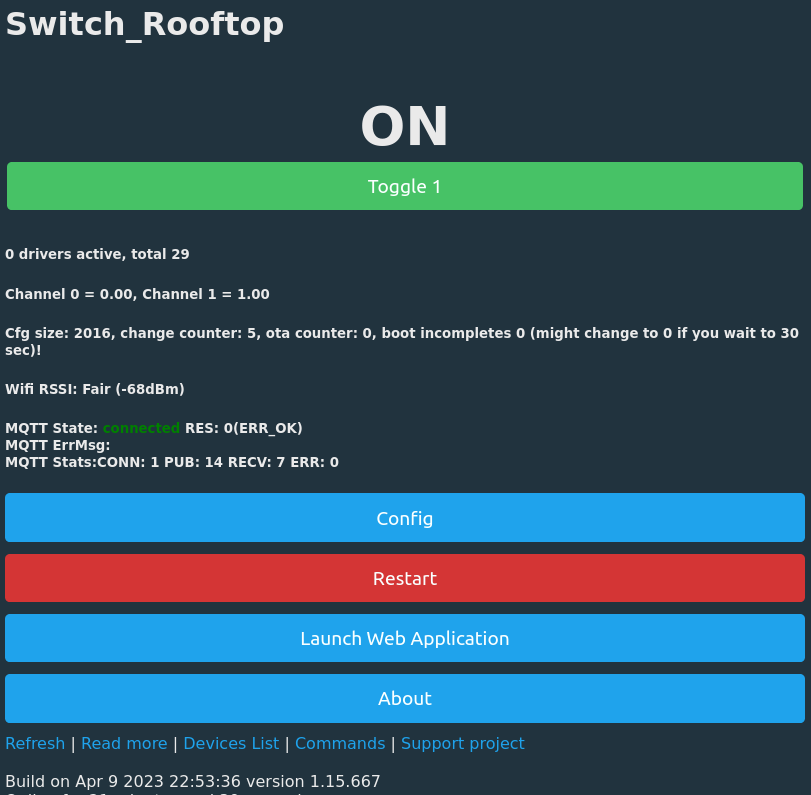

    Hi,
    I have flashed an Aubess mini switch with openbeken using the cloudcutter method. After flashing, the device is working normally and I can switch it on and off from the web UI or home assistant without any issue. However, I am unable to see any energy consumption data in the web interface or in Home Assistant. Not sure what I am doing wrong here. Appreciate your help.
    Note the switch I have is marked as Power Monitor switch and was showing voltage and wattage data in the Tuya app before flashing openbeken.
    Below is a picture of the pin configuration I used as well as how the device shows up in the web interface.
    No Energy data for Aubess 16a Mini WiFi Switch with Energy Monitoring

    it simply looks like you haven't BL0942 driver started. I can see "0 drivers running" on your screenshot. Please add a "startDriver BL0942" command to short startup command (or to autoexec.bat from Web App - choose one or the other) and reboot.
    Did you get config from the template? Maybe it's missing the startDriver line.
    PS: you can also do multiple commands by doing:
    backlog startDriver BL0942; startDriver NTP; startDriver SSDP;
    etc.
    You also might consider adding PowerSave 1. This helps to reduce heating and energy usage, and the wear out of the power supply.

    This worked. Thanks a lot for the help. I entered startDriver BL0942 in the Change startup command text. The energy data started appearing after rebooting.
