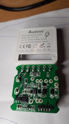

    zmrzlinabelektroda

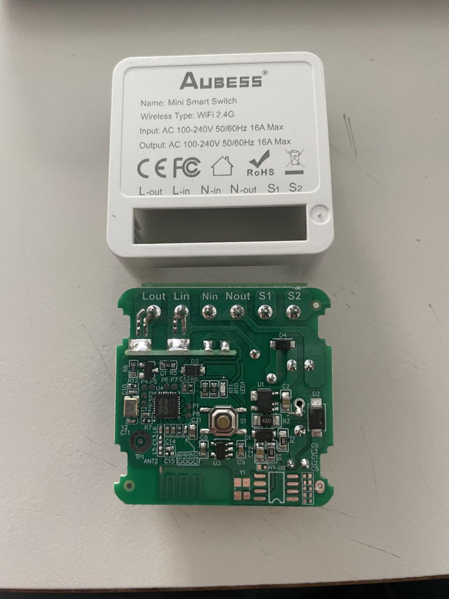

    Circuit board of the AUBESS WiFi MiNi Smart Switch with enclosure.
    AUBESS WiFi MiNi Smart Switch With Energy Monitor 16A is a simple device with a Button, Relay, LED and toggle switch terminal.
    Here are configs/templates:

  • New board revision blocks ESP transplant and needs pin mapping
    #2 20760323
    belveder79
    Posts: 15

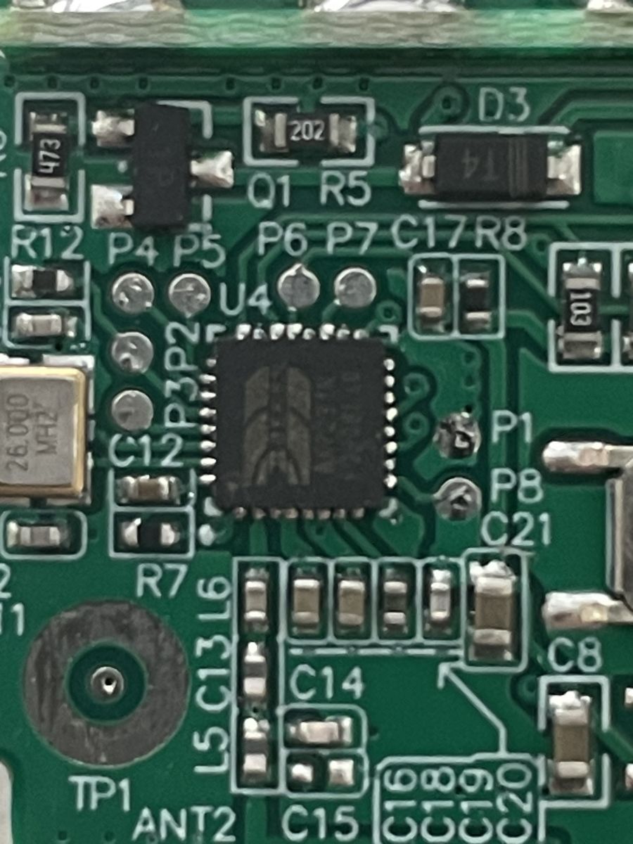

    I got 2 shipments with those and those work great, whether you do a brain-transplant with ESP to tasmotize them or with OpenBeken. I just received another shipment yesterday, and they are entirely different:
    Aubess Mini Smart Switch circuit board with its casing. Close-up of a circuit board with an integrated circuit and component markings.
    They moved the Beken straight onto the main plate, so no more transplant possible. Need to figure out the pin config now to flash them with OpenBeken... any ideas?
