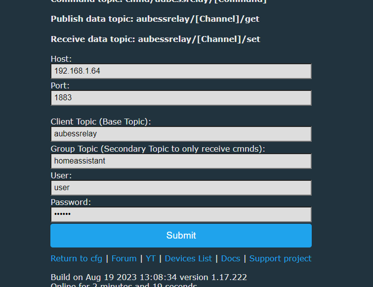

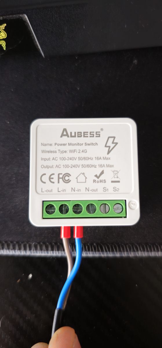

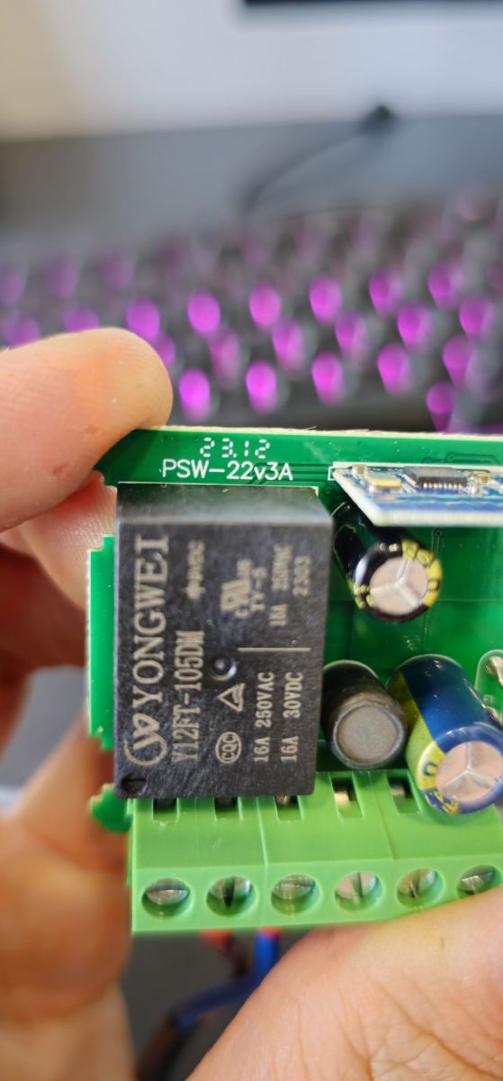

    Hi, I have just sflashed the aubess relay on openebeken, I have set pin 26 as relay and via the website I can control it. But I want to connect it to homeassistant via MQTT, and I have a problem because I have MQTT connected (data is 1000000% good) and it even says mqtt connected but no new device appears. What can I do in this case?
  • #2 21145577
    Posts: 14771
    Rate: 12914
    Home Assistant Discovery must be triggered manually from the Config - > Home Assistant menu (or something like that). Only then will the HA see the device.

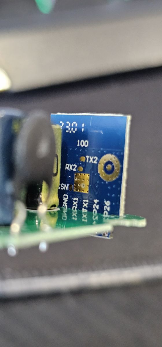

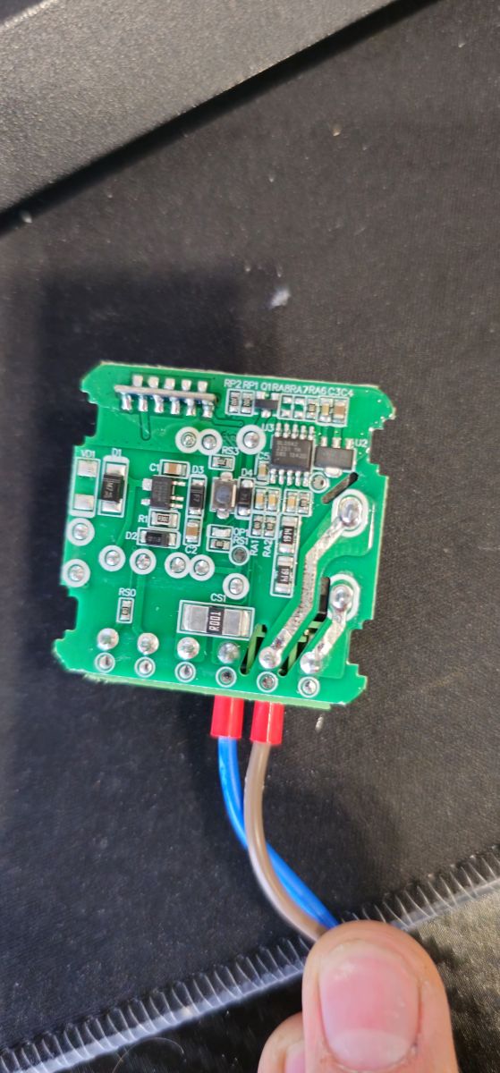

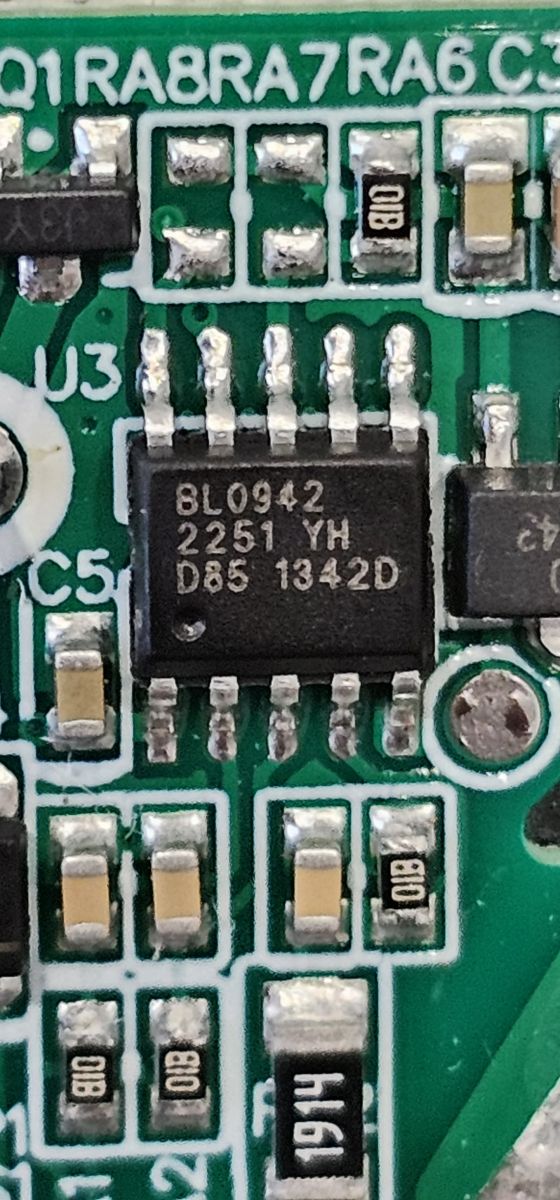

    And in the middle is the BL0942 or BL0937?
  • #7 21149930
    Filip8X8
    Posts: 138
    >>21149916 I don't know completely.... But there is something like this Aubess doped on openebeken - no device in Home Assistant via MQTT Aubess doped on openebeken - no device in Home Assistant via MQTT .
  • #8 21150086
    Posts: 14771
    Rate: 12914

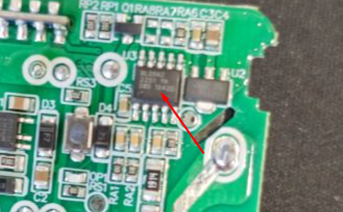

    This is not enough. The circuit you are looking for is rather on the bottom of the PCB. Read the markings.
  • #9 21150092
    Filip8X8
    Posts: 138
    >>21150086 There are not very many markings Aubess doped on openebeken - no device in Home Assistant via MQTT .
  • #10 21150103
    Posts: 14771
    Rate: 12914
    After all, I can see in the picture that there is some text, which BL is it?
  • #11 21150109
    Filip8X8
    Posts: 138
    >>21150103 O mother of one that's what you meant, so small that I missed it myself. Please Aubess doped on openebeken - no device in Home Assistant via MQTT .
    BL0942
    #12 21150128
    Posts: 14771
    Rate: 12914
    In that case, it will be enough startDriver BL0942 on the boot command line, reboot and then calibrate with a second, reliable meter, via VoltageSet/CurrentSet/PowerSet
  • #13 21150329
    Filip8X8
    Posts: 138
    >>21150128 O geez, I didn't think one command was enough. Thanks!
  • #14 21150332
    Filip8X8
    Posts: 138
    One command was enough.
  • MQTT discovery not starting with startup command
    #15 21152265
    Filip8X8
    Posts: 138
    >>21150128 I have one more important question. In the startup command I entered this command everything works great, it shows the parameters. But now I have no idea how to connect it to homeassistant using MQTT, I mean I know but it doesn't go. Previously in the startup command I had entered "scheduleHADiscovery 10" and somehow it worked because the device appeared in homeassistant, but now it doesn't work by itself, and I tried adding something like "startDriver BL0942; scheduleHADiscovery 10" but that doesn't work all the more. What can I do? The data to MQTT is 10000% correct, I even write that it is connected.
  • #16 21152407
    Posts: 14771
    Rate: 12914
    backlog command1; command2
  • #17 21152434
    Filip8X8
    Posts: 138
    >>21152407 I added something like this, and what does this do to these commands? Because I added it, well the parameters are shown but in HA you still can't see it. The mqtt configuration looks like this Aubess doped on openebeken - no device in Home Assistant via MQTT .
  • #18 21152437
    Posts: 14771
    Rate: 12914
    The short startup command is executed after the reboot.
  • #19 21152454
    Filip8X8
    Posts: 138
    >>21152437 Well, yes, and I did reboot the device. But it didn't show up in my mqtt
  • #20 21152521
    Posts: 14771
    Rate: 12914
    Then do the HA discovery manually, it appears? What did you name the device?
