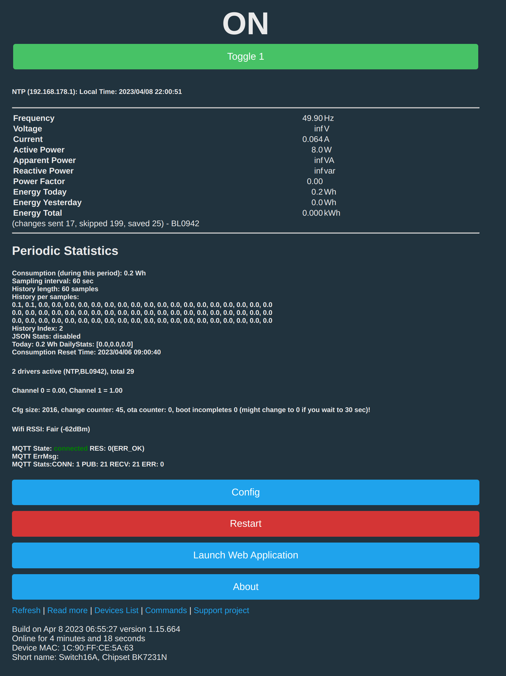

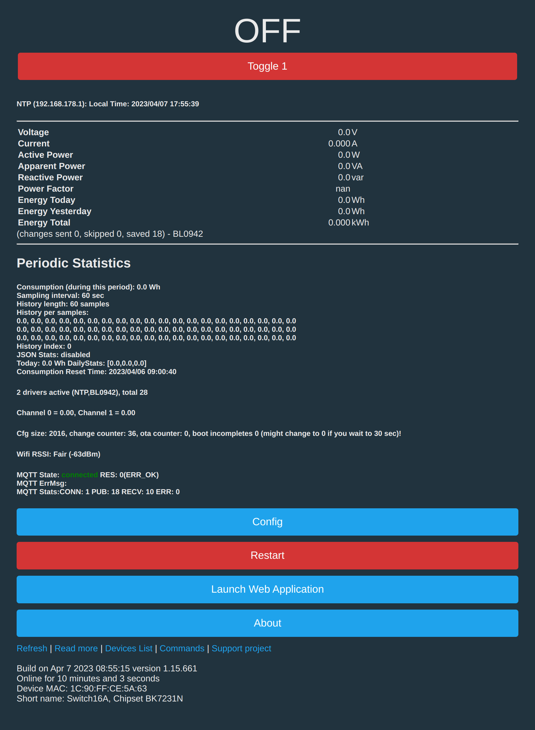

    I just received a Power Monitor Switch 16A Wifi Smart Switch with BL0942
    from this seller
    https://www.aliexpress.com/item/1005005134537878.html?spm=a2g0o.cart.0.0.448138daZoou4E&mp=1
    I have though an issue with the power monitor since I have zero values.
    OpenBeken - new BL0942 device is not receiving any data from energy meter
    All functionality of the gang works as expected. I have firmware 1.15.659 though I have tested some more old ones.
    Any thoughts ?

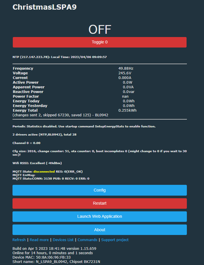

    How do you know it's really BL0942? Have you opened the case?
    Added after 54 [seconds]:
    I have firmware 1.15.659 and I get a reading:

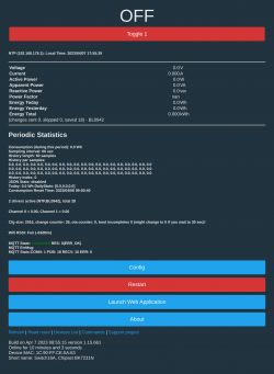

  • #3 20527459
    thanos_kalos
    Posts: 18

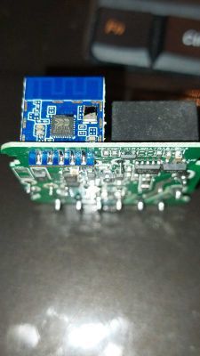

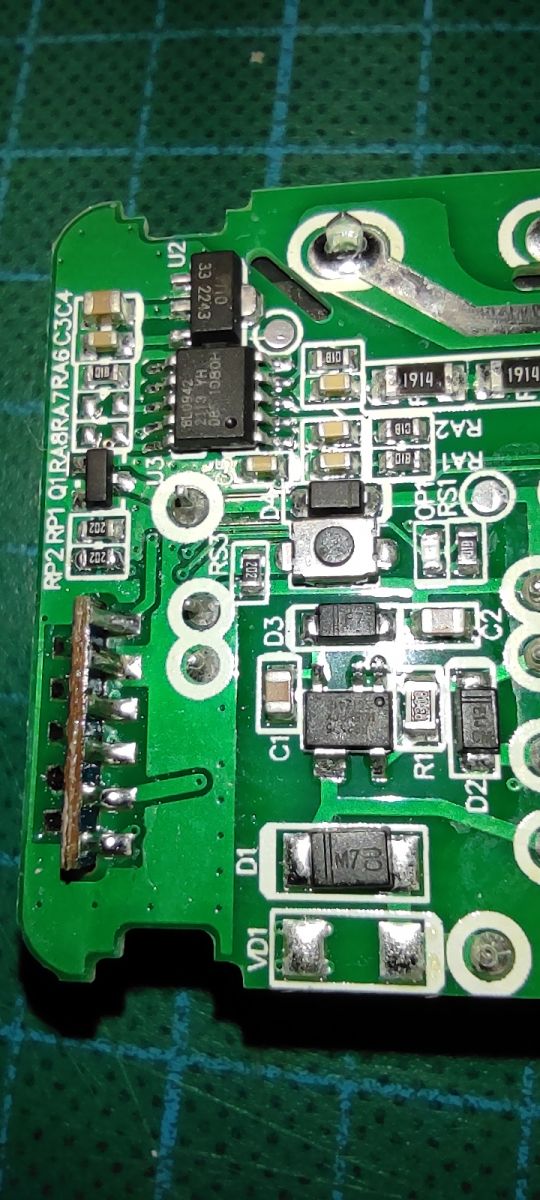

    Yes, I have opened the case.
    Have a look at the photo also
  • #4 20527508
    Posts: 14759
    Rate: 12886
    Do you have any BL0942 messages in the Web App log?
    BL0942 can also use SPI interface sometimes. BL0942 can also sometimes use different baud rate.

    Have no logs from BL0492. Following are the msg when I toggle the switch and also try to a reference on the voltage and Watts from tools section.
    Info:CMD:[WebApp Cmd 'logfeature 7 1' Result] OK
    Info:CMD:[WebApp Cmd 'logfeature 7 0' Result] OK
    Info:MQTT:Channel has changed! Publishing 1 to channel 1
    Info:MQTT:Publishing val 1 to switch16A-1/1/get retain=0
    Info:CFG:####### Flash Save Channel 1 as 1 #######
    Info:MQTT:MQTT client in mqtt_incoming_publish_cb topic switch16A-1/1/get
    Info:MQTT:MQTT in topic switch16A-1/1/get
    Info:MQTT:MQTT topic not handled: switch16A-1/1/get
    Info:MQTT:channelSet NOT 'set'
    Info:NTP:Seconds since Jan 1 1900 = 3889764734
    Info:NTP:Unix time : 1680786734
    Info:NTP:Local Time : 2023/04/06 13:12:14
    Error:CMD:cmd LED_Map NOT found (args )
    Info:CMD:[WebApp Cmd 'LED_Map' Result] Unknown command
    Info:EnergyMeter:VoltageSet: you gave 230.000000, set ref to 0.000000
    Info:CMD:[WebApp Cmd 'VoltageSet 230' Result] OK
    Info:NTP:Seconds since Jan 1 1900 = 3889764795
    Info:NTP:Unix time : 1680786795
    Info:NTP:Local Time : 2023/04/06 13:13:15
    Info:EnergyMeter:PowerSet: you gave 8.000000, set ref to 0.000000
    Info:CMD:[WebApp Cmd 'PowerSet 8' Result] OK

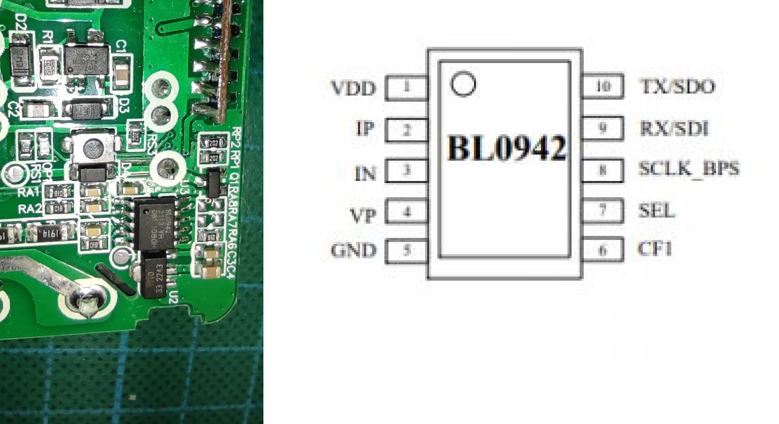

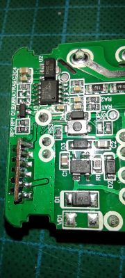

    Where are the TX, RX and BPS pins of BL0942 connected?
    BPS is used to select UART baud rate. Maybe your device is a non-standard one and has higher baud selected...
  • #7 20527733
    thanos_kalos
    Posts: 18
    I found the following :
    BL0942 BK7231N
    tx -> GND
    RX -> TX
    BPS -> ??? No connection
  • #8 20528393
    Posts: 14759
    Rate: 12886
    Are you sure? If BL0942 TX is shorted to ground, then it's not possible to get any result readings from BL0942....
  • #9 20528943

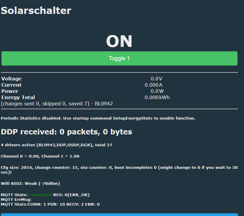

    priorsoeren93
    I have the same problem with the switch. I get 0 as well

    Which software version?

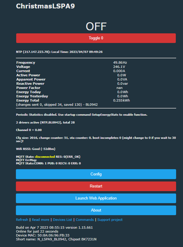

    Here's how it looks like on my LSPA9:
    If you are not receiving data, then something must have changed in Tuya circuit. Please provide good quality photos and tell me how is BL0942 connected.

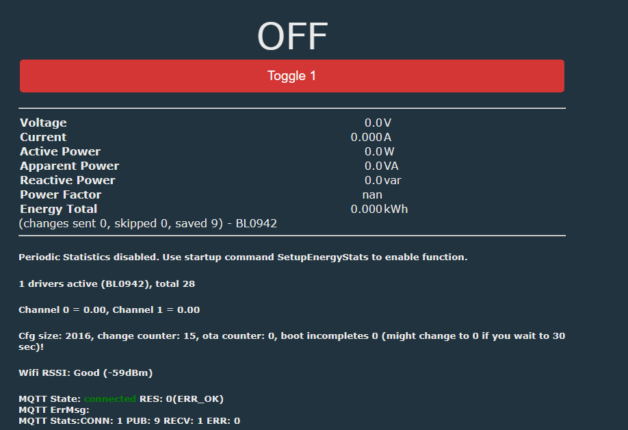

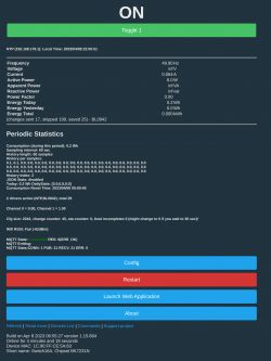

  • #13 20529813
    thanos_kalos
    Posts: 18
    I have 0 on all values.

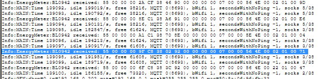

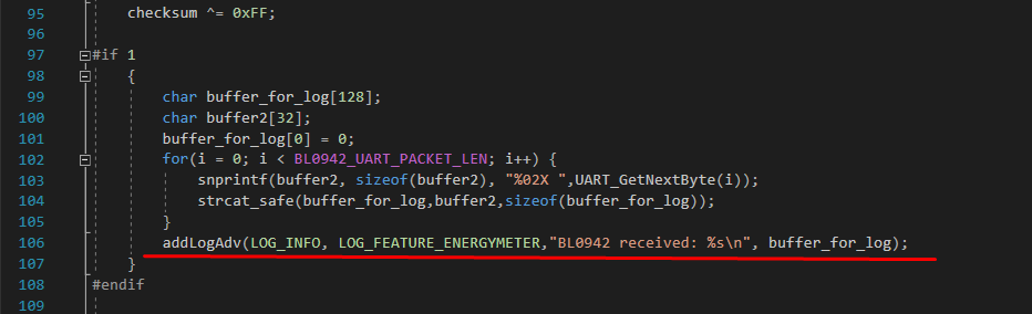

    1. @thanos_kalos - do you get that sometimes in Web App log?
    Info:EnergyMeter:BL0942 received: 55 00 00 00 A2 8C 39 42 8F 00 00 00 00 07 00 00 4E 4E 00 02 01 00 74

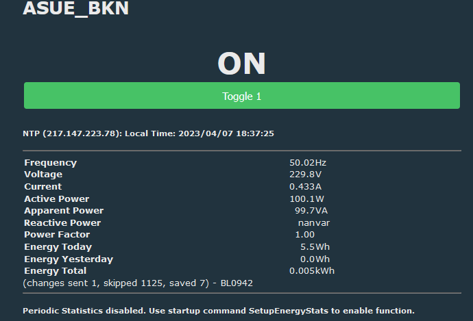

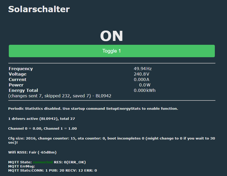

  • #15 20529923
    piratee
    Posts: 69
    >>20529376
    Hi.
    My version with BK7231N with a chip on the board was damaged during testing. Now I have a Mini Smart DIY Switch I have with a chip on a board placed vertically.
    Without a probe, the power measurement on the Mini Smart DIY starts.
    Regards OpenBeken - new BL0942 device is not receiving any data from energy meter

    BL0942 BK7231N
    TX -> RX
    RX -> TX
    Just noticed that the RX on BK7231N is on GND
    Regards

    thanos_kalos
    Posts: 18
    Yes I did the flashing with wires since on using the CloudCutter I made the mistake and installed the T firmware instead of the N.
    I did re-solder the BK chip and managed to not have a short between RX and GND. Now for BL0942 TX -> RX and RX -> TX with no grounding.
    Now I have data.
    I suggest to close the topic.
