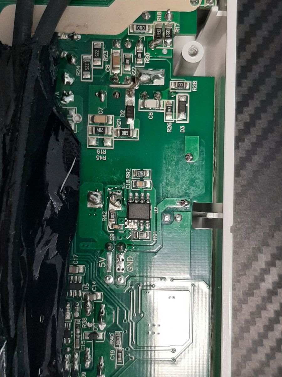

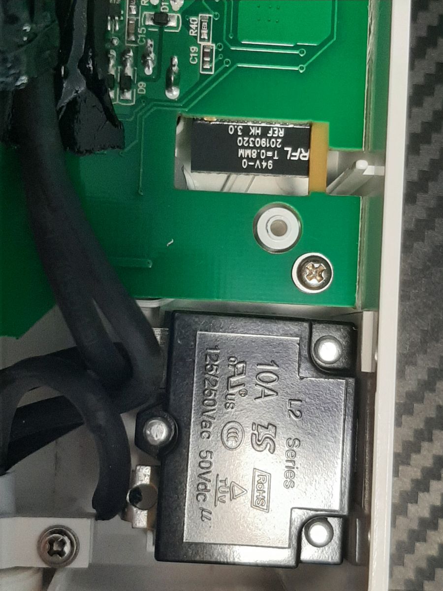

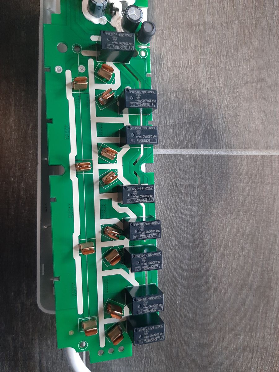

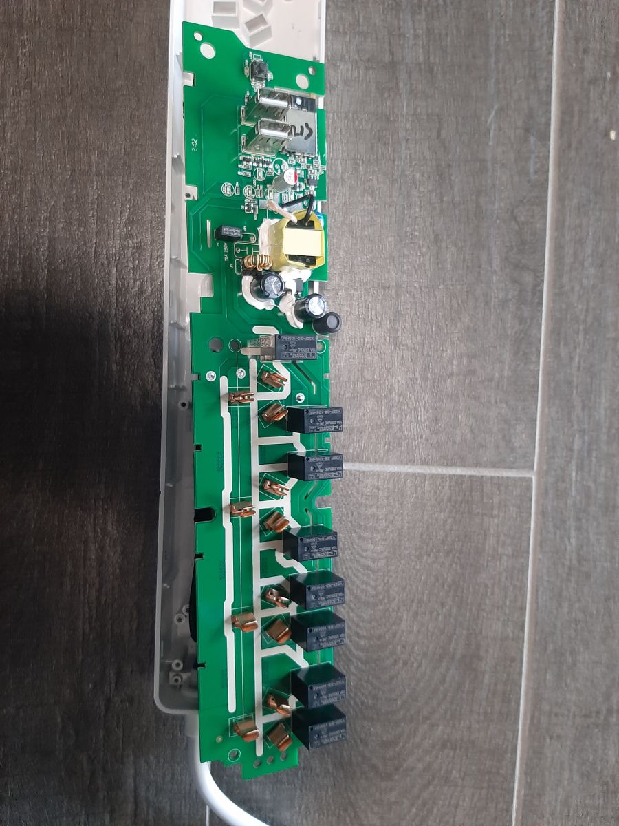

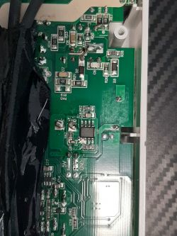

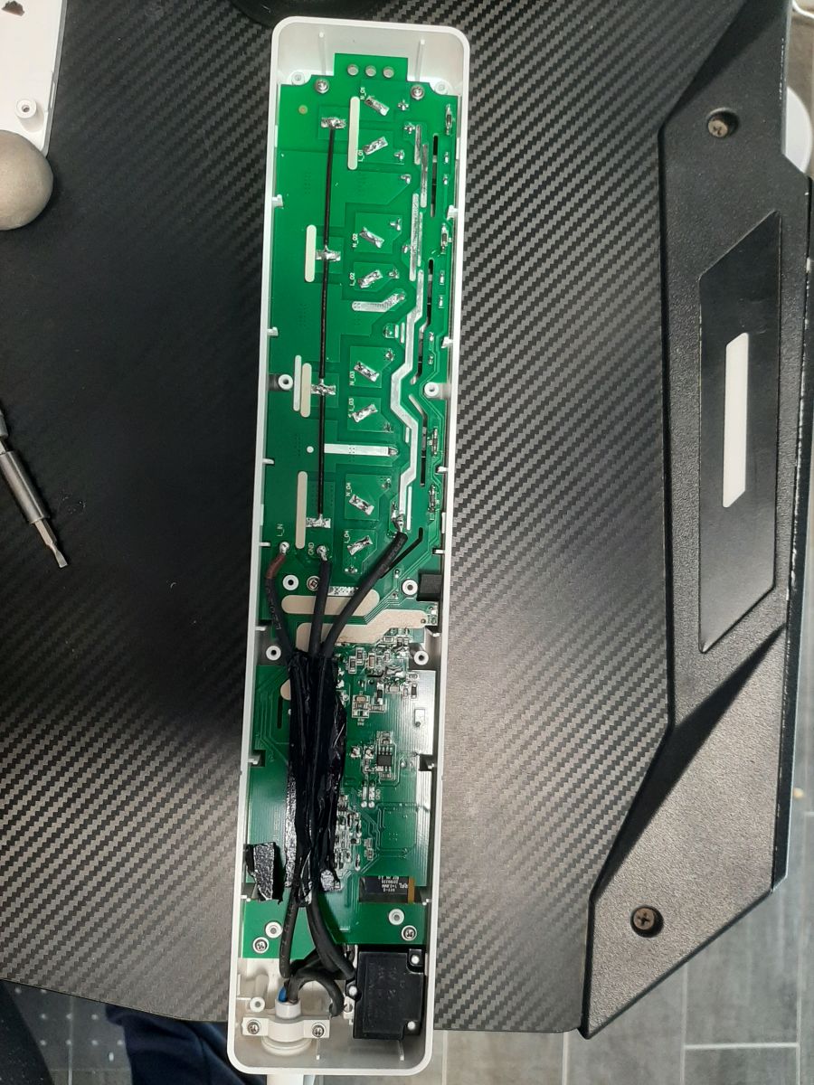

    Device Name: Cygnett 4 Outlet Smart Power Board with 2x USB-A Ports
    Device Type: Power Board with USB
    Device Chip: C10
    Device Purchased: Big W - $79.95AUD
    Cygnett 4 Outlet Smart Power Board with 2x USB-A Ports - Teardown Cygnett 4 Outlet Smart Power Board with 2x USB-A Ports - Teardown Cygnett 4 Outlet Smart Power Board with 2x USB-A Ports - Teardown Cygnett 4 Outlet Smart Power Board with 2x USB-A Ports - Teardown Cygnett 4 Outlet Smart Power Board with 2x USB-A Ports - Teardown Cygnett 4 Outlet Smart Power Board with 2x USB-A Ports - Teardown Cygnett 4 Outlet Smart Power Board with 2x USB-A Ports - Teardown Cygnett 4 Outlet Smart Power Board with 2x USB-A Ports - Teardown Cygnett 4 Outlet Smart Power Board with 2x USB-A Ports - Teardown

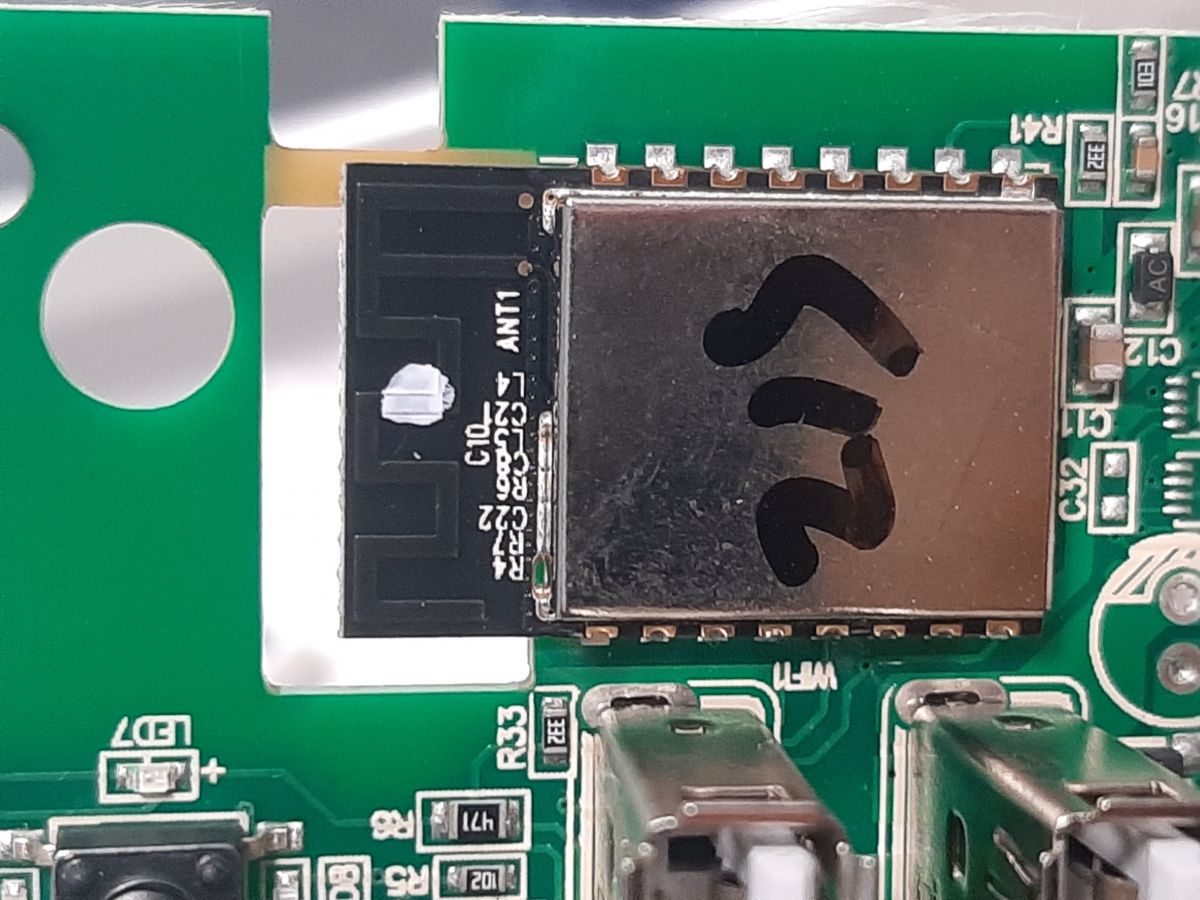

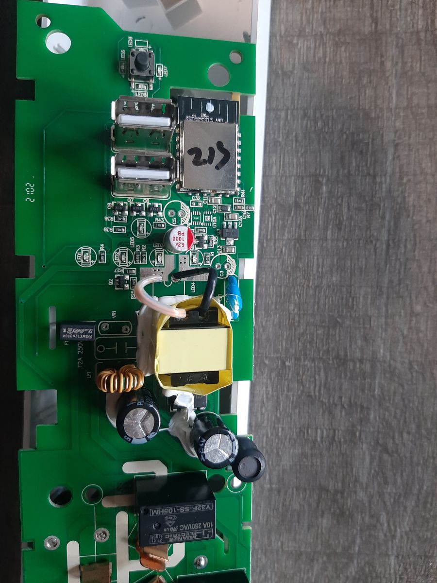

    Flashing of Main Chip
    This appears to be a new module. I have not been able to find any details about the C10 module as of yet.
    If anyone has any information about this module let me know. I will attempt to dump the firmware using BKwriter and see what happens from there. Not sure what pins will be required to do this yet so once I work that out I'll post the dump here and on the OpenBK github page.
  • #2 20545041
    Posts: 14627
    Help: 655
    Rate: 12646
    Hello, you can also just try looking up WB3S TX2 port which outputs debug log and try using it to read the log. Maybe the log can tell which microcontroller is that.
