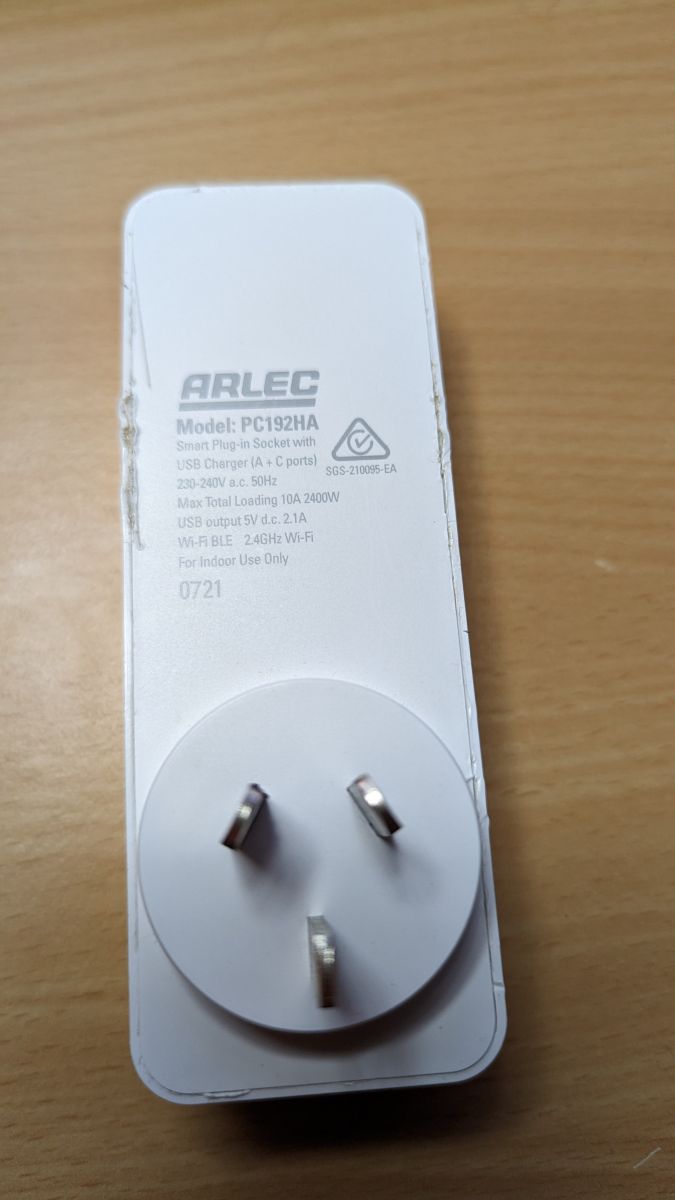

    Teardown and Differences: Arlec Grid Connect PC192HA vs PC191HA Plug-In Socket with USB Teardown and Differences: Arlec Grid Connect PC192HA vs PC191HA Plug-In Socket with USB

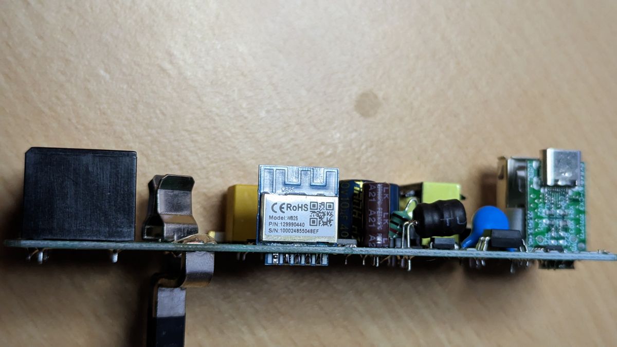

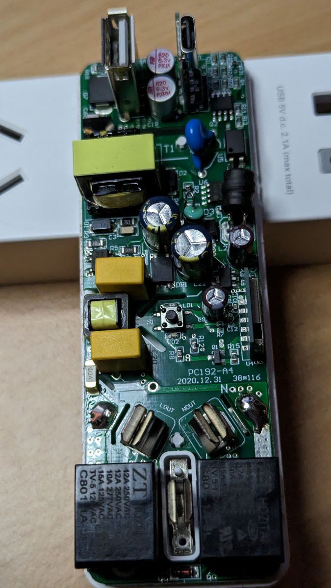

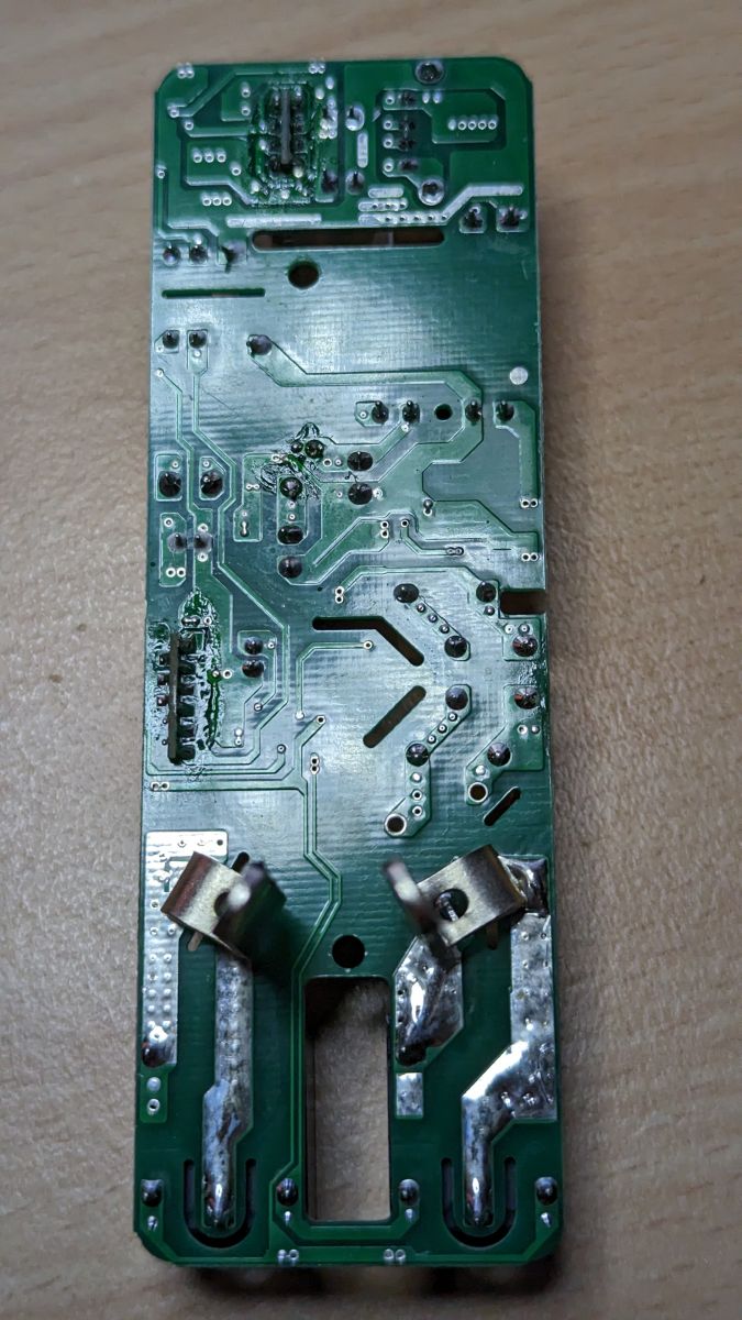

    On the inside (Disassembling/Reassembling same as for PC191HA):
    Teardown and Differences: Arlec Grid Connect PC192HA vs PC191HA Plug-In Socket with USB Teardown and Differences: Arlec Grid Connect PC192HA vs PC191HA Plug-In Socket with USB Teardown and Differences: Arlec Grid Connect PC192HA vs PC191HA Plug-In Socket with USB
    Like the PC191HA, It also uses the Tuya WB2S module with a BK7231T chip, has dual relays for switching both active and neutral, 1 button, and a red status LED.

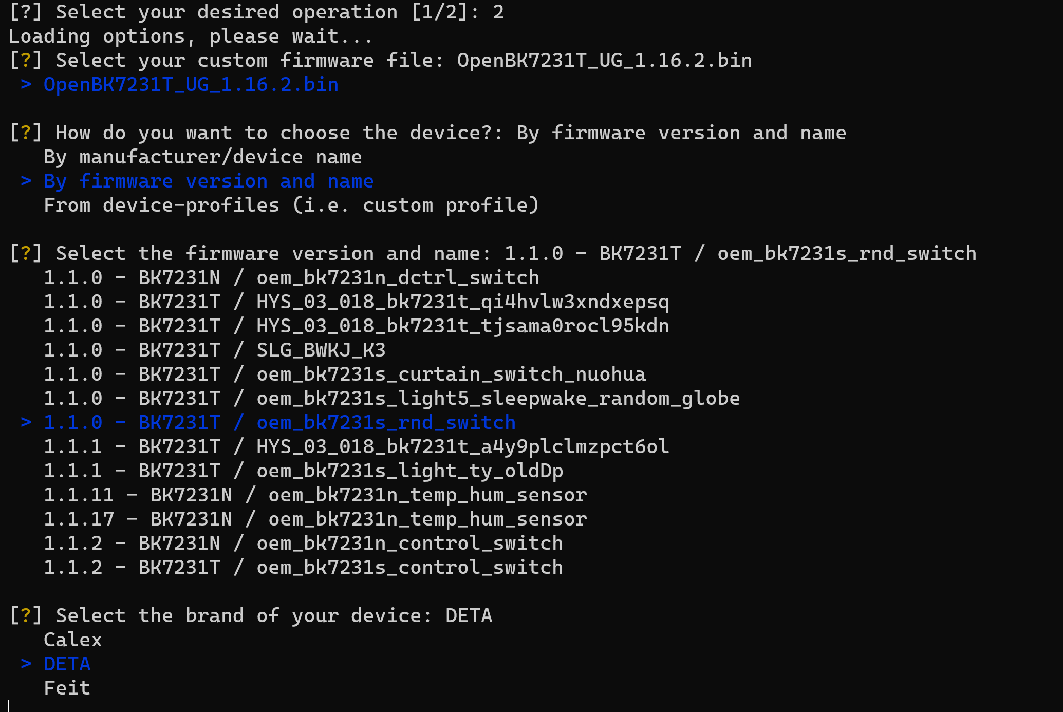

    * I used the cloudcutter method load the OpenBeken UG image as the custom firmware, but also using an existing firmware v1.1.0 profile.
    * The existing OS version on my raspberry pi was VERSION="10 (buster)" which is older than the one mentioned in the instructions but still worked.

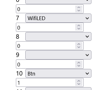

    PIN7: Wifi/Status LED - CH0
    PIN10: Button - CH1

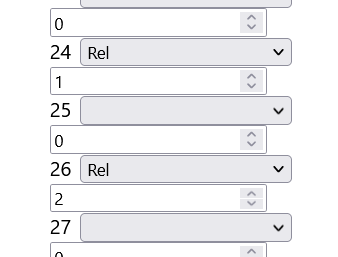

    PIN24: Relay Mains Power - CH1
    PIN26: Relay USB - CH2

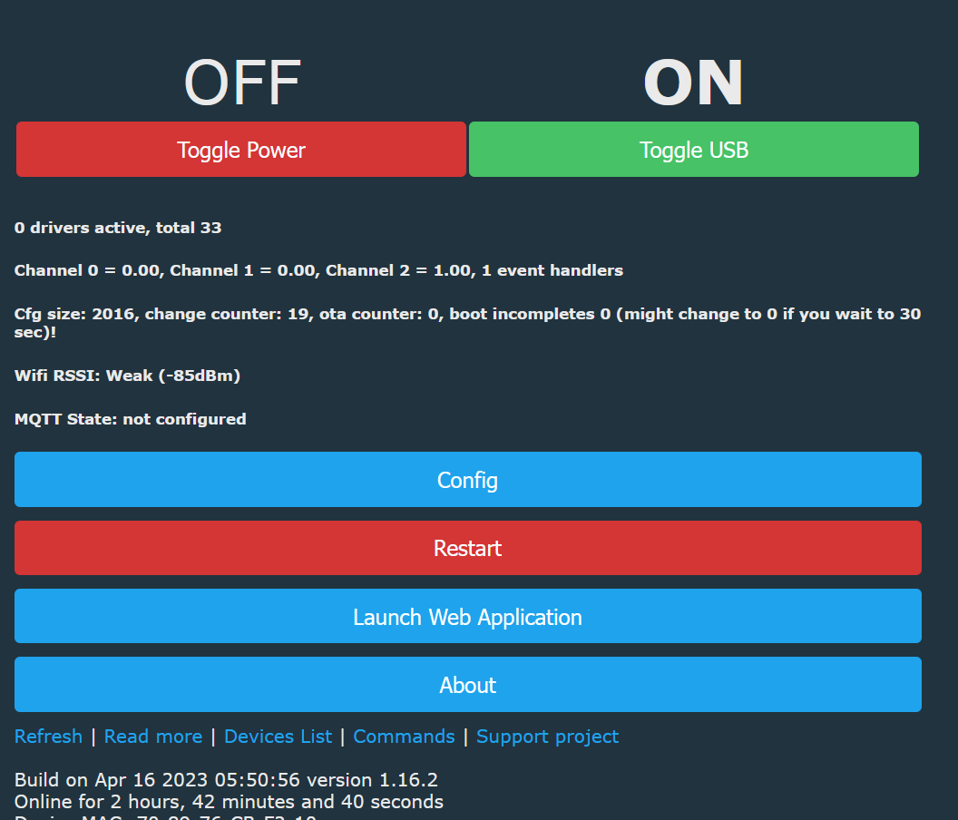

    Along with the startup command:
    backlog setChannelLabel 1 Power;setChannelLabel 2 USB;setChannel 2 1;addEventHandler OnDblClick 10 ToggleChannel 2
    The device will start with the USB, on Mains plug off, Single button press will toggle mains plug, double button press will toggle the USB power.
