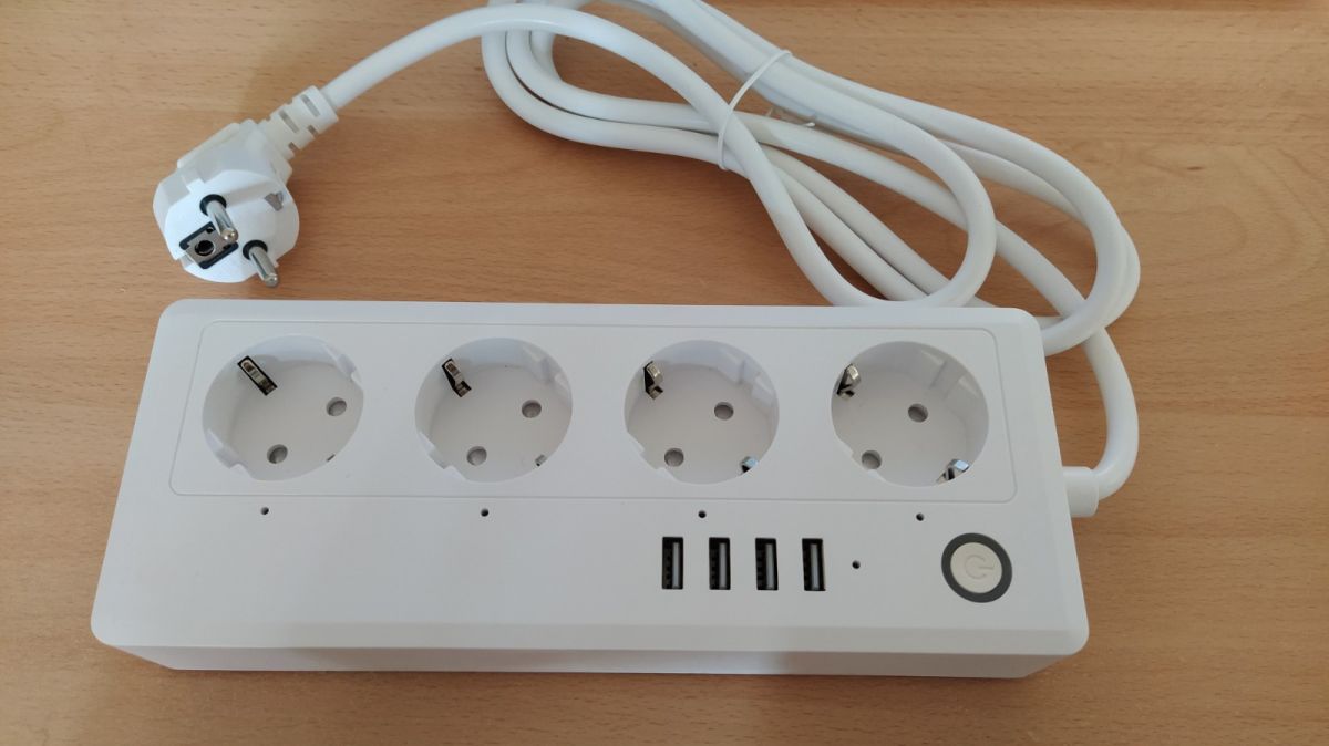

  • A Tuya Wi‑Fi smart power strip from AliExpress with 4 AC outlets and 4 USB ports was opened and tested for local flashing.
  • The JSON config targets model XS-A26 on a CB3S board with a BK7231N chip.
  • The strip is rated AC100-240V, 16A, 3450W, with 3.1A USB power and a 1.5m power line.

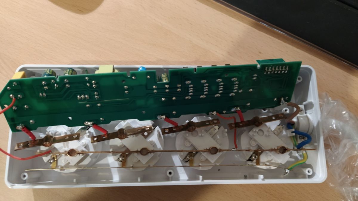

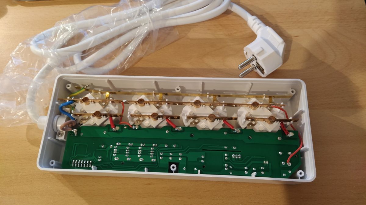

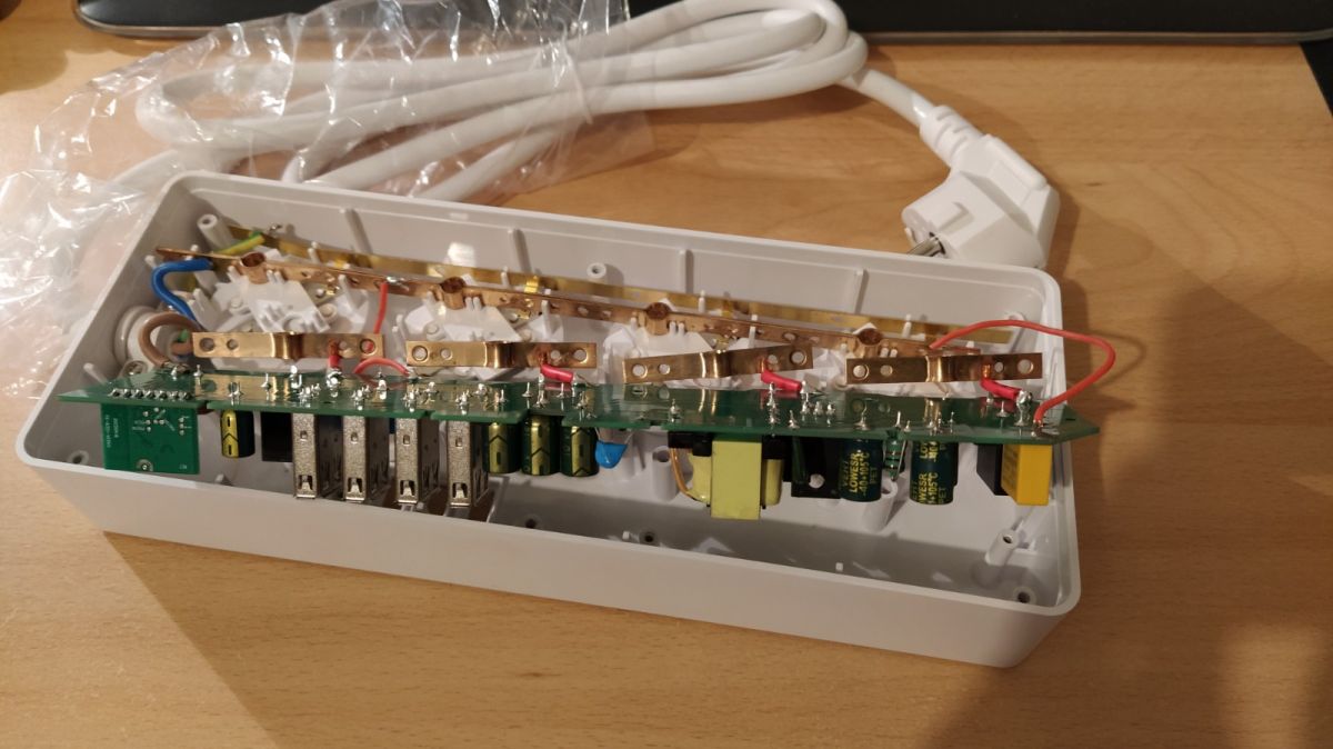

    I took elements from similar topics, as it has the same housing as this one, and a chip very similar to this one.
    For dissassembing, the 6 pads on the back can be easily removed, giving access to 6 triangle screws:
    [BK7231N] Tuya Smart Power Strip Review: 4AC + 4USB Ports, AliExpress, YX-B3S1-VER00 PCB [BK7231N] Tuya Smart Power Strip Review: 4AC + 4USB Ports, AliExpress, YX-B3S1-VER00 PCB [BK7231N] Tuya Smart Power Strip Review: 4AC + 4USB Ports, AliExpress, YX-B3S1-VER00 PCB [BK7231N] Tuya Smart Power Strip Review: 4AC + 4USB Ports, AliExpress, YX-B3S1-VER00 PCB

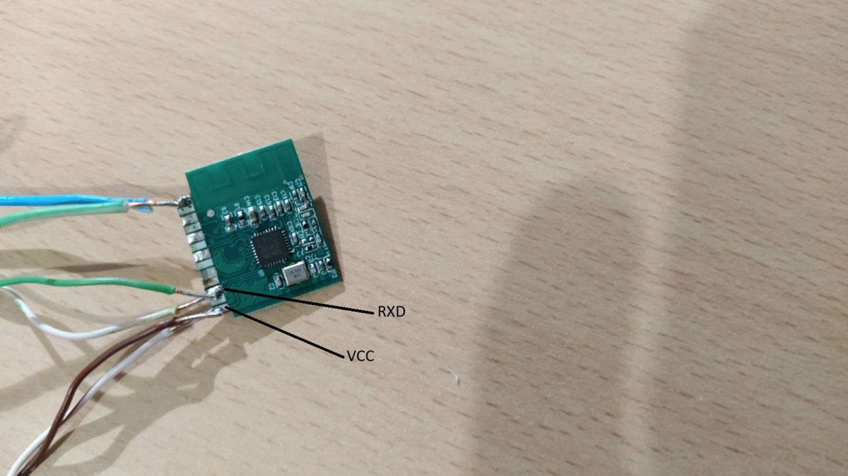

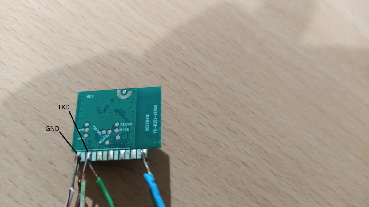

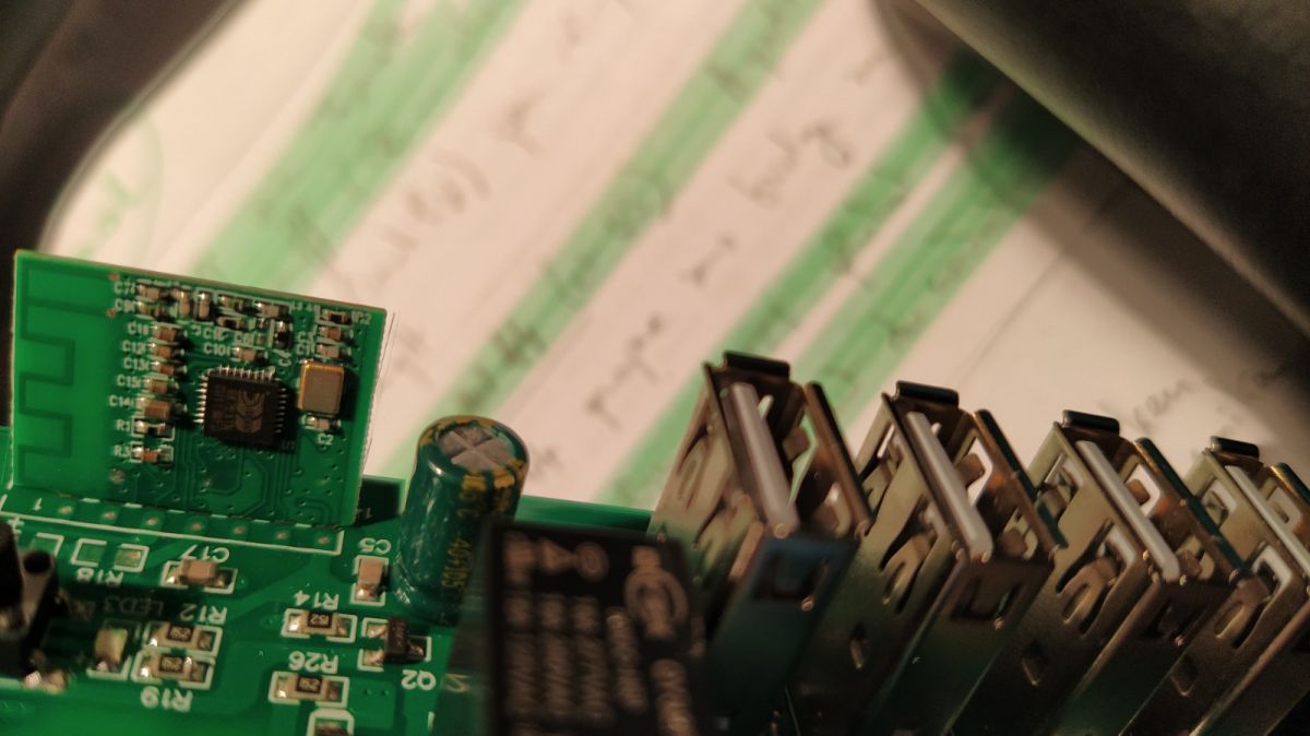

    The chip is a BK7231N on a small PCB with indication YX-B3S1-VER00
    I have not tried programming the chip while still soldered to main PCB. Instead I have unsoldered it and used the pinout below:
    I have not been able to find where is the CEN pin, I tried the 2 pins at the opposite of VCC and GND but it didn't work. On the other hand, unplugging VCC pin for a short time did the job to put the chip in programming mode.
    Initially I also used a separate 3.3V power source instead of my cheap USB to TTL adaptor to power the chip, but for unknown reasons this option brought more problems than expected, as I was not able to put the chip in programming mode with this external power source.
    Nevertheless using only the power source from the USB to TTL device (using 3.3V of course) was sufficient and appropriate in my case.
    The device was detected by bk7231flasher v1.1.0b as:

    Now it works perfectly. Thanks to the community!

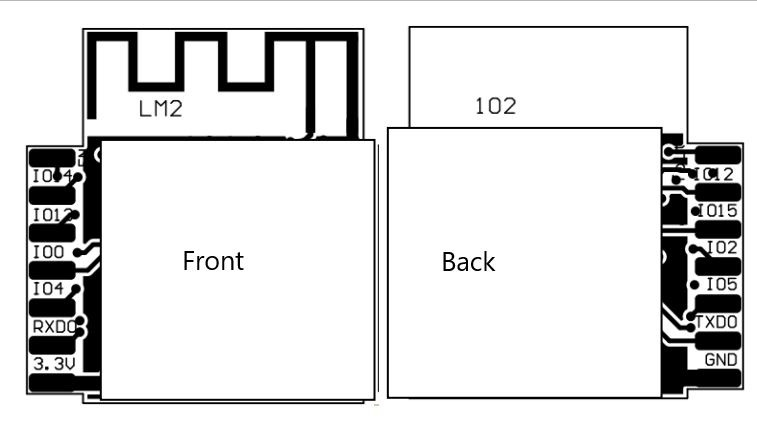

    Very nice review. Isn't that module a Beken version of LM2? Pinout seems to be matching.

  • CEN pad needed to enter programming mode
    #5 21719931
    yvesdm3000
    Posts: 7
    I could not get this chip into programming mode by power-cycling it. Touching the round pad at the back that is closest to the solder pads with ground did the trick for me. So I suppose that is the CEN pin.
    Yves
    Added after 6 [minutes]:
    Also my PCB has "YX-B3S1-VER01" as marking. Doesn't seem to have any noticeable difference.
