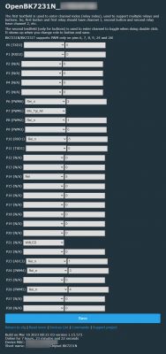

  • BK7231N CB3S pin map for SM-SO301K strip

    Here is the json config
      "vendor": "Generic",
      "bDetailed": "0",
      "name": "WiFi Smart Power Strip",
      "model": "SM-SO301K",
      "chip": "BK7231N",
      "board": "CB3S",
      "keywords": [
        "Mains Power Strip",
        "USB Power Supply",
        "4 Gang"
      "pins": {
        "6": "Rel_n;2",
        "7": "Btn_Tgl_All;0",
        "8": "Rel_n;1",
        "10": "Rel_n;6",
        "14": "Rel;5",
        "21": "WifiLED;0",
        "23": "Rel_n;1",
        "24": "Rel_n;3",
        "26": "Rel_n;4"
      "image": "https://obrazki.elektroda.pl/4535041600_1678464108_thumb.jpg",
      "wiki": "https://www.elektroda.com/rtvforum/topic3963570.html"

    Thank you, the device has been added to our list.
