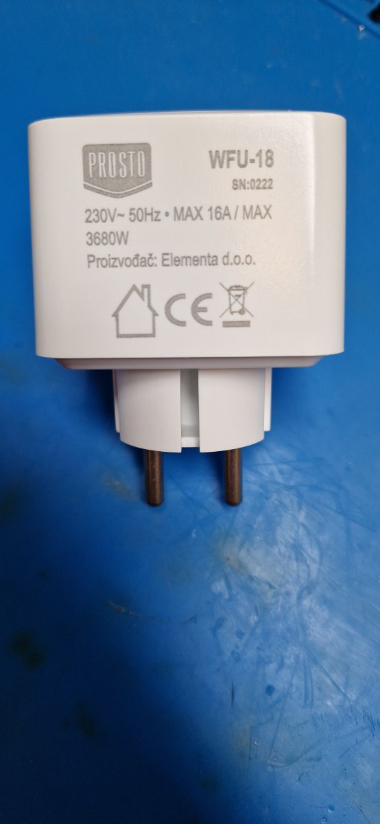

    Here is an interesting device without metering but with a interesting protection mechanism.
    [BK7321T] Prosto WFU-18 socket without metering - teardown, schematic and setup [BK7321T] Prosto WFU-18 socket without metering - teardown, schematic and setup

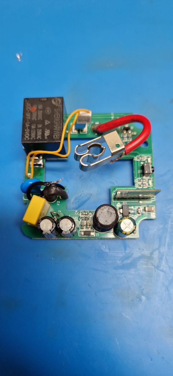

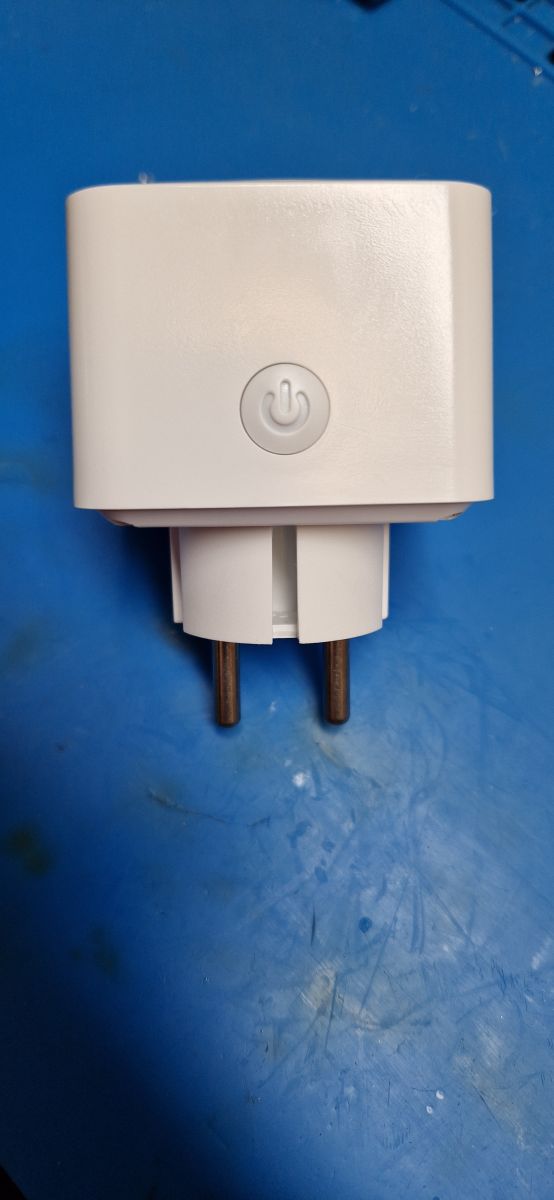

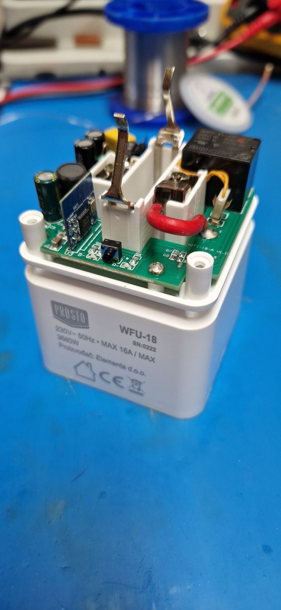

    Surprisingly it is not glued or ultrasonically welded, instead it has 2 screws on the bottom and opening is somewhat easy.

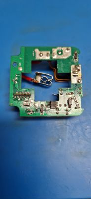

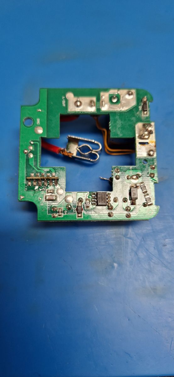

    There is a single screw holding a board down and one tab near the relay to de-solder.
    Interesting bit is that device that is hanging on those yellow wires, that is a temperature fuse (86'C/250V) nested inside a metal holder that is acting as a heater in case load is greater than specified. Device is based on BK7321T chip (WB2S module)

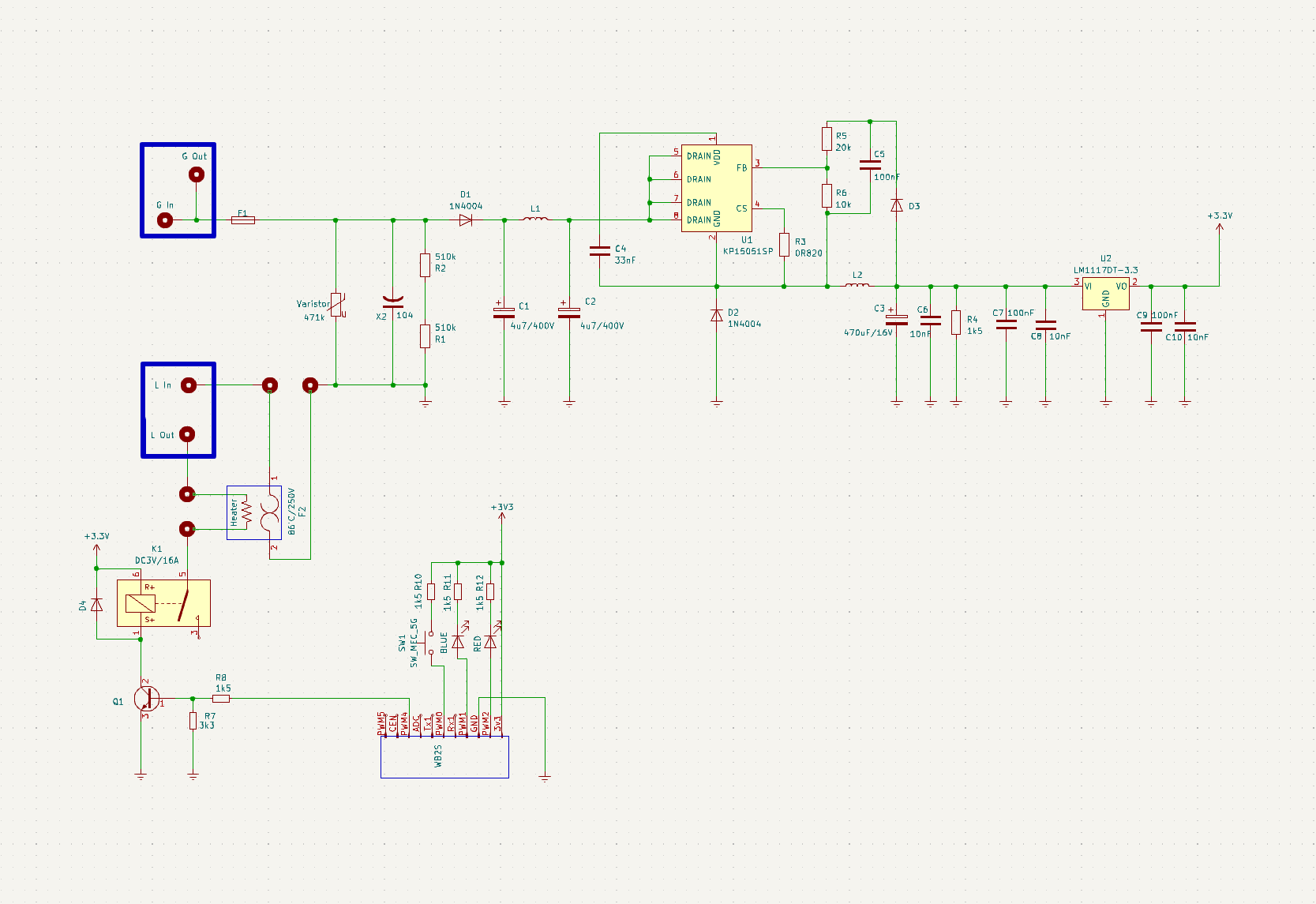

    Other than that it is very generic WiFi controlled switch/relay outlet. Here is the schematic for it (not all values are correct and present!!!)
    And finally here is the pin setup tested and working with present build (1.17.10)
        "pins": {
        "6": "Btn;0",
        "7": "WifiLED_n;0",
        "8": "LED_n;0",
        "24": "Rel;0"
