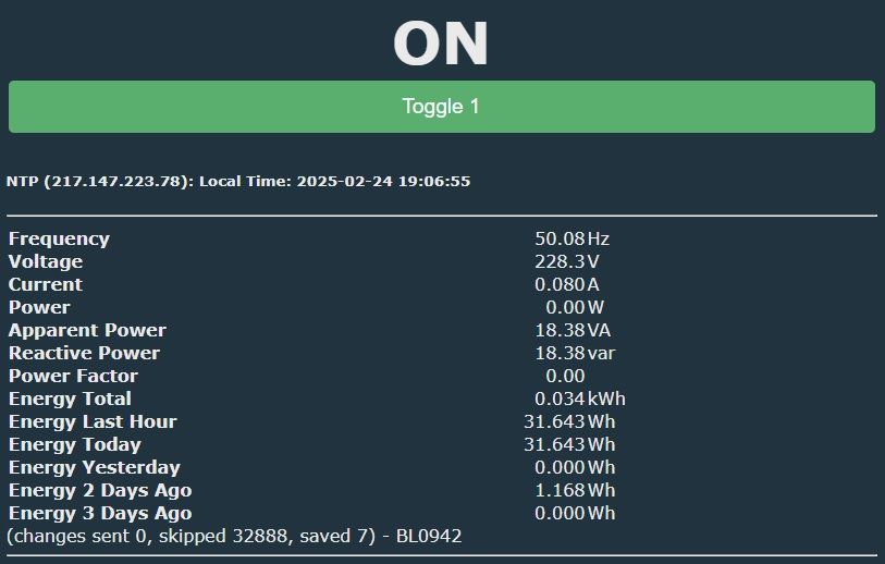

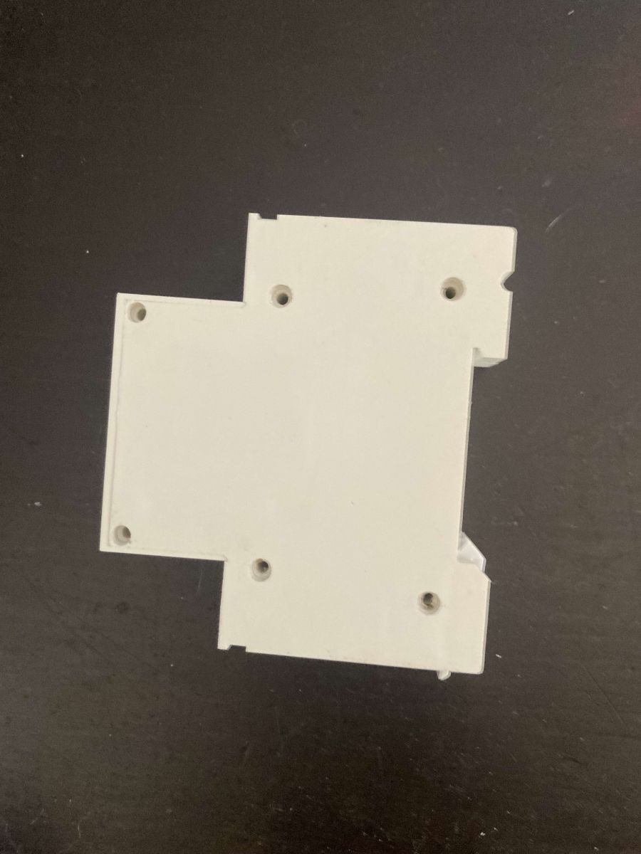

  • Teardown of the EARU EAWCPT-J 35mm DIN rail WiFi smart relay with energy metering, based on BK7231N/WC1H, BL0942 and a CBU module.
  • The enclosure opened by drilling the 6 holding screws and separating the shields, then wiring RX1, TX1, 3V3 and GND to an FTDI232.
  • UART access worked only at 9600 baud rate, which allowed JSON and configuration extraction from the firmware.
  • Voltage, current and power were calibrated after extracting the configuration.
  • A limitation remained: when the relay is down, Active Power and Power Factor show negative values even with Flag 38 checked, and the original firmware backup was saved.

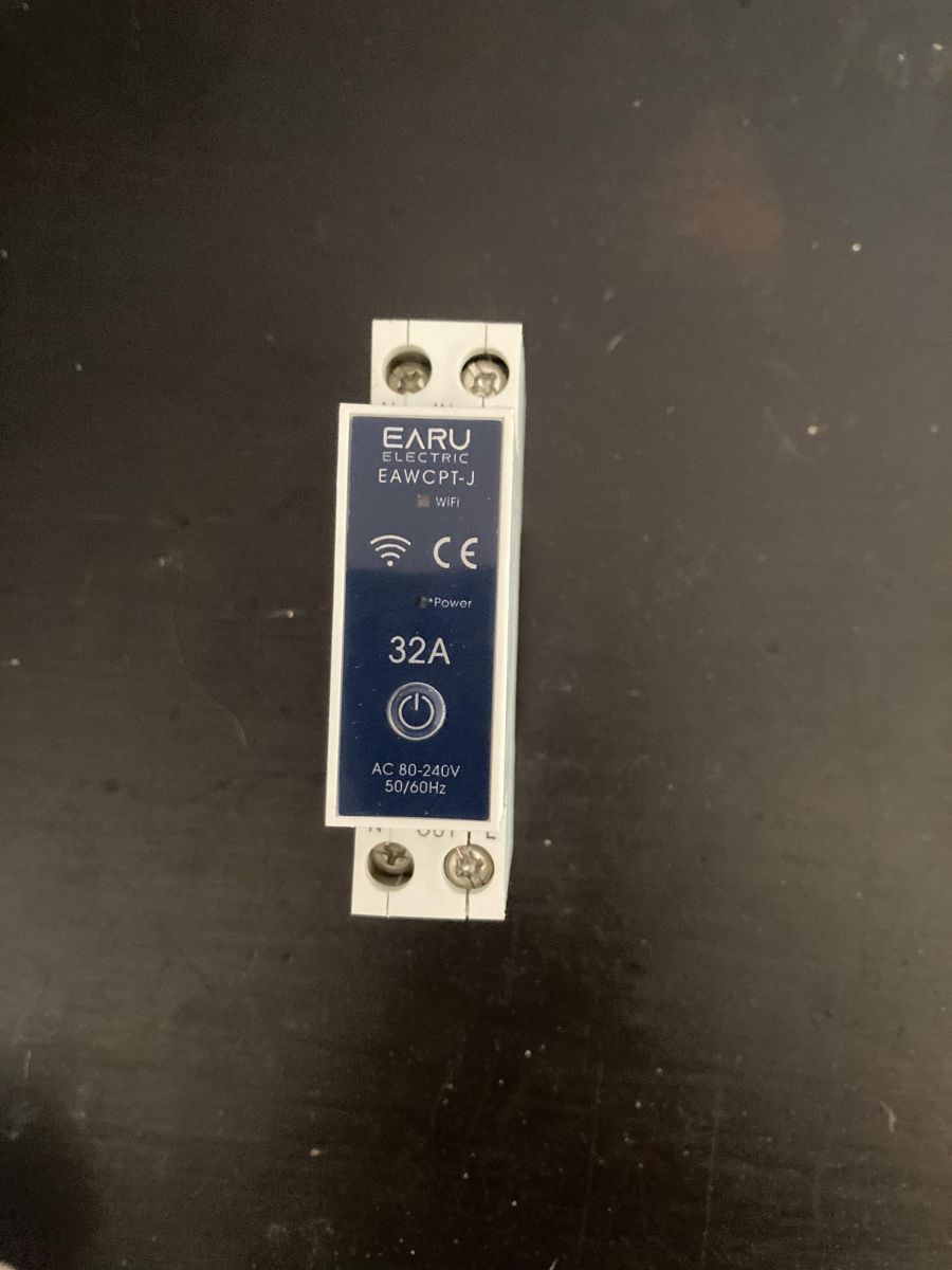

  • This is my teardown of EARU EAWCPT-J relay.
    35mm Din Rail WIFI Smart Switch Remote control byTuya APP for Smart home from https://fr.aliexpress.com/item/1005005903760507.html

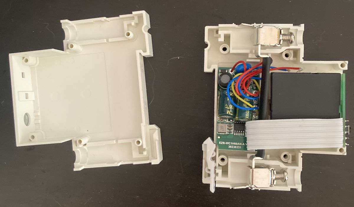

    EARU EAWCPT-J WiFi Smart Switch for DIN Rail View of the back part of a white DIN rail relay housing.

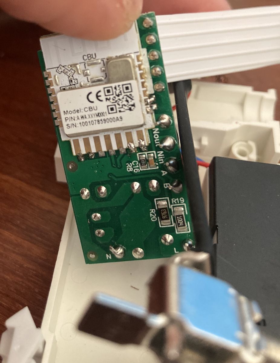

    First, drill the 6 holding "screws" and push them through. And split the shields.

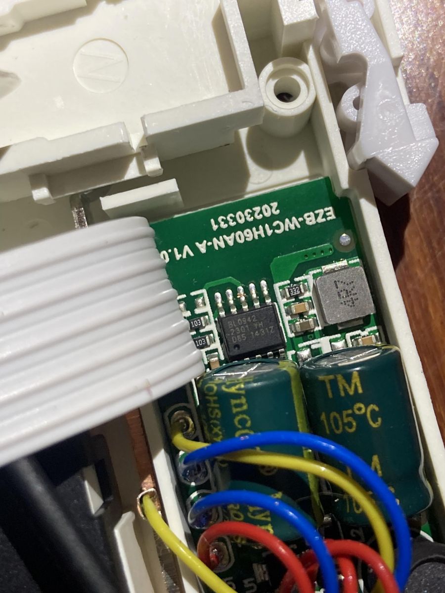

    Disassembled smart WIFI relay for DIN rail.

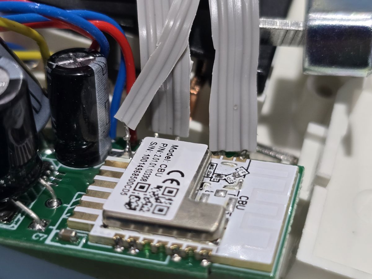

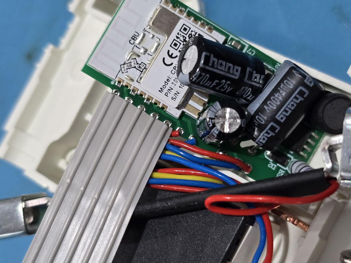

    WC1H - BL0942 - CBU :
    Close-up of the interior of a relay housing showing electronic components, including capacitors and a microchip. Close-up of an electronic module labeled CBU on a circuit board.

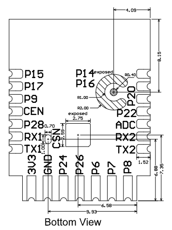

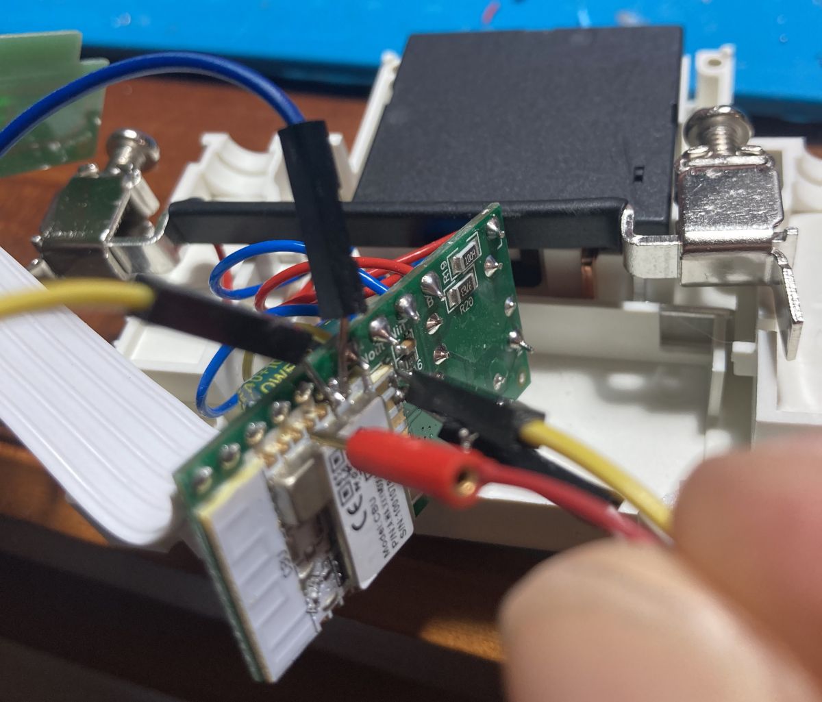

    From CBU pins :
    Bottom view schematic of the PCB with pin numbering and dimensions.

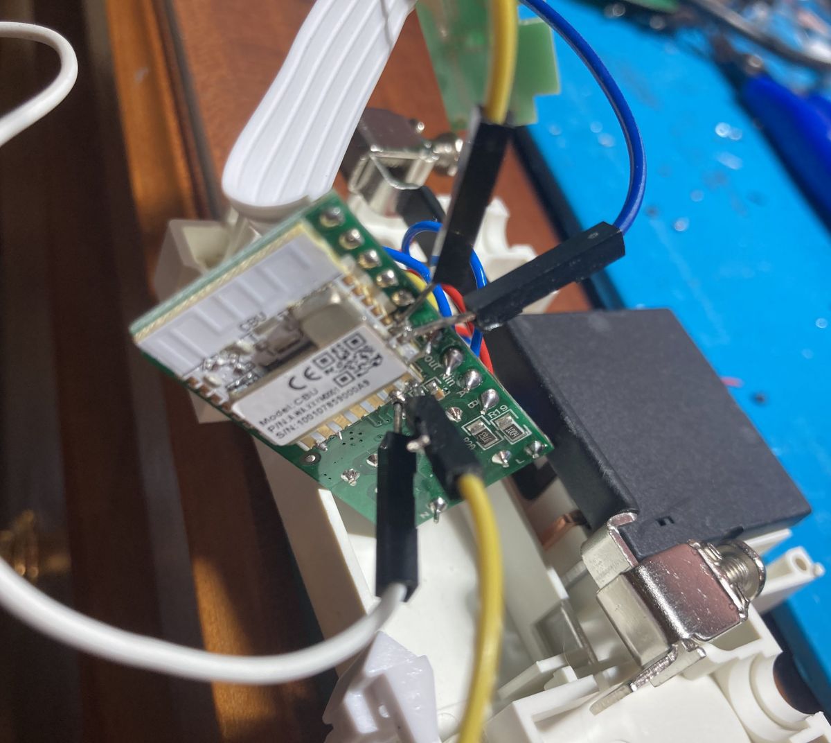

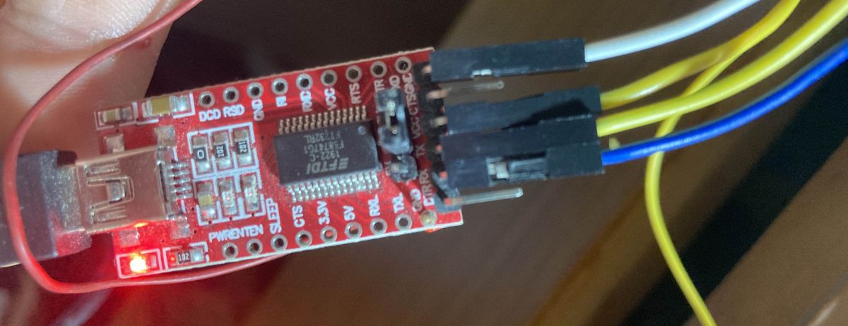

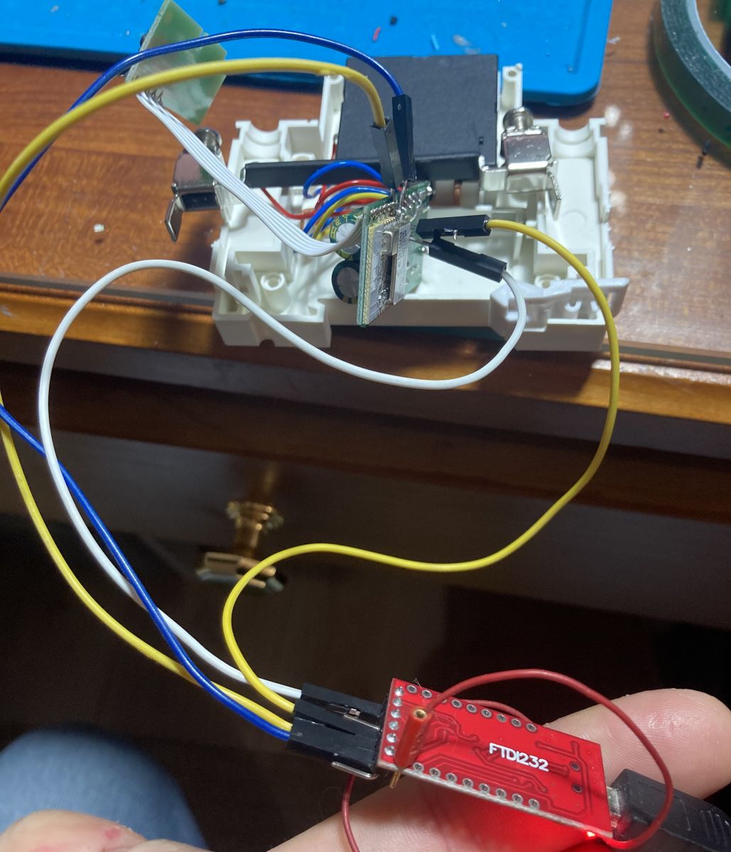

    Soldered to RX1, TX1, 3V3 and GND and connected to FTDI232 :
    The image shows a USB FTDI adapter with attached wires and a glowing LED. Close-up view of the internal components of a WiFi smart switch on a Din rail. EARU relay board with wired connections EARU EAWCPT-J relay circuit with connected FTDI232 module.

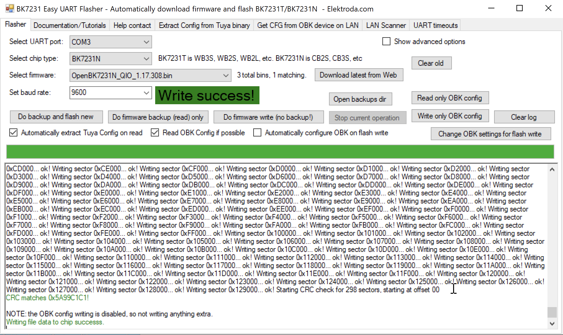

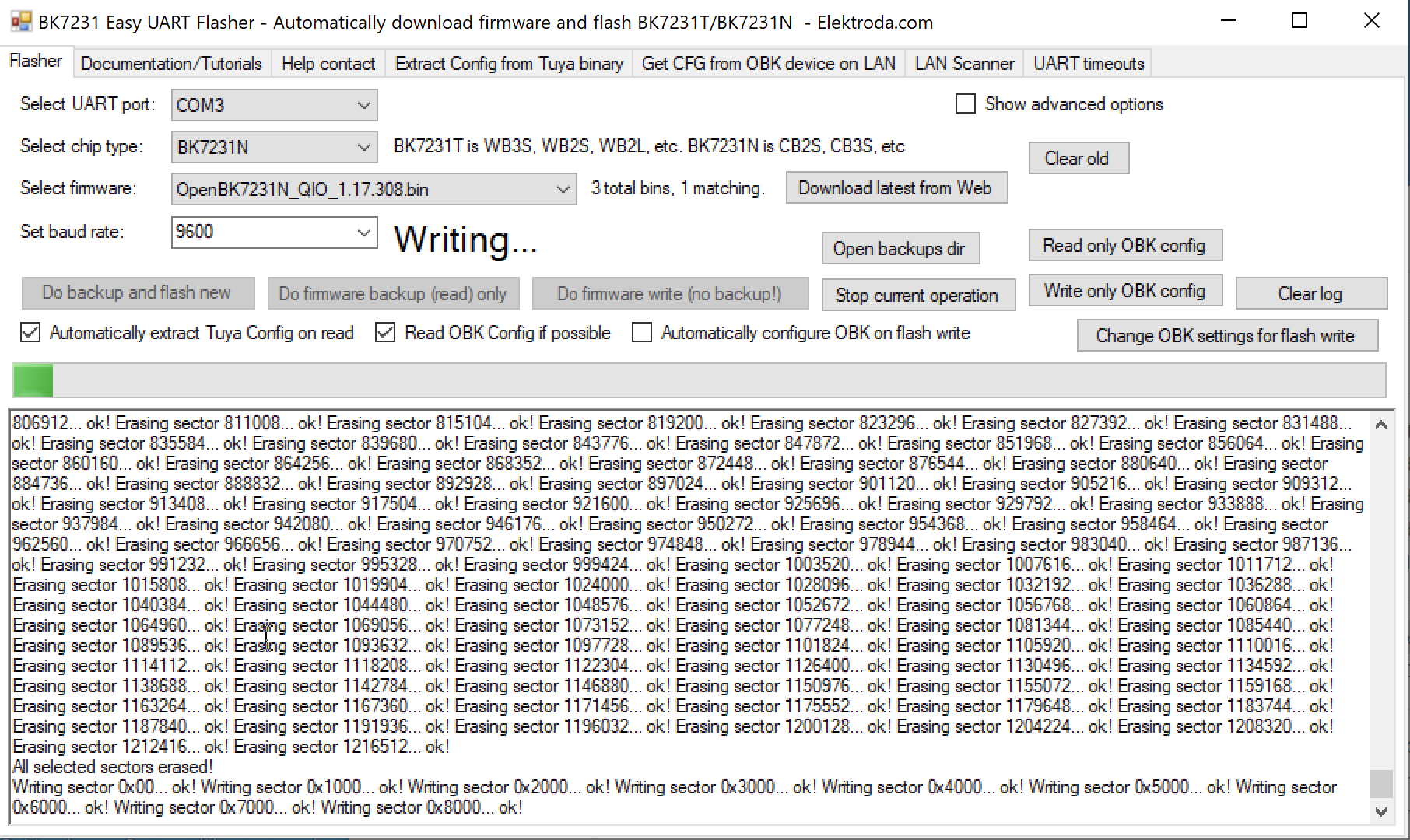

    Reading only worked with 9600 baud rate :
    BK7231 Easy UART Flasher software interface with visible operation log. Screenshot of BK7231 Easy UART Flasher showing successful firmware write.

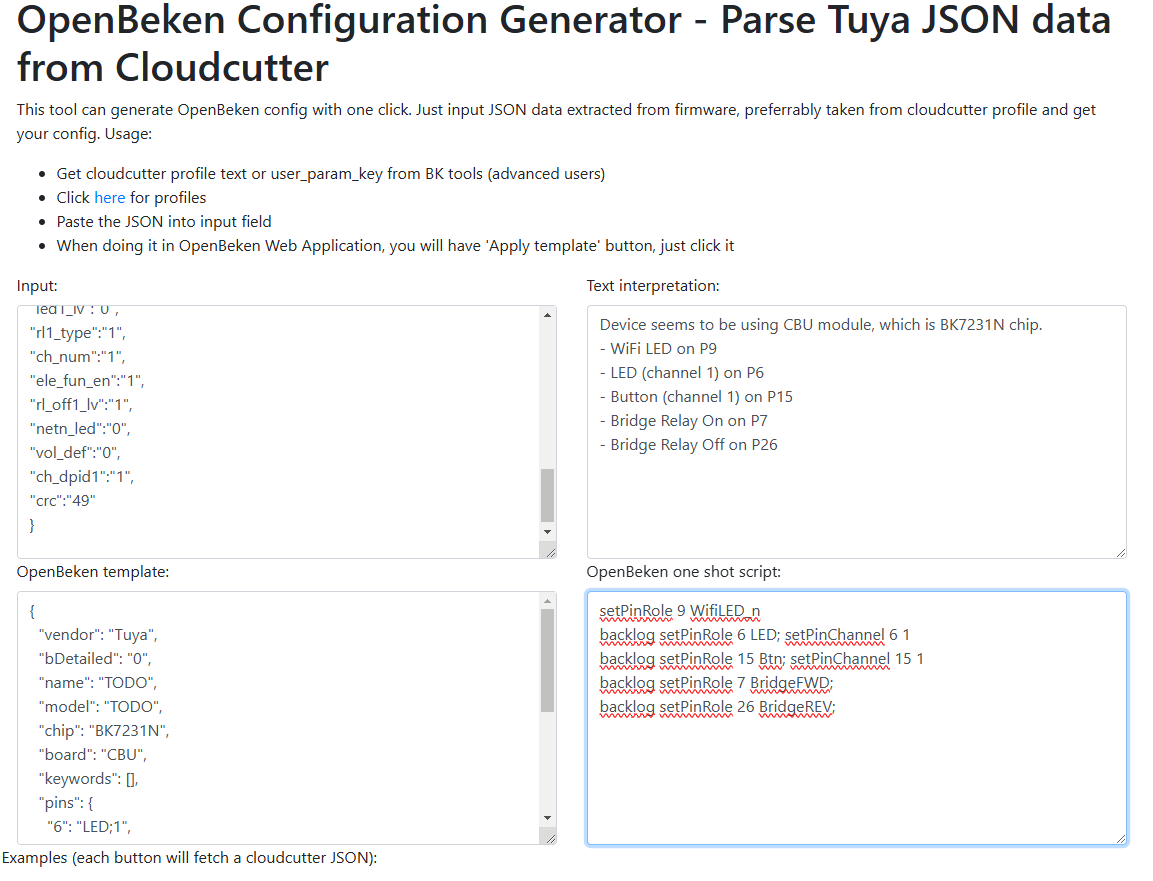

    json and configuration extracted:
    My current template:
    Startup command:

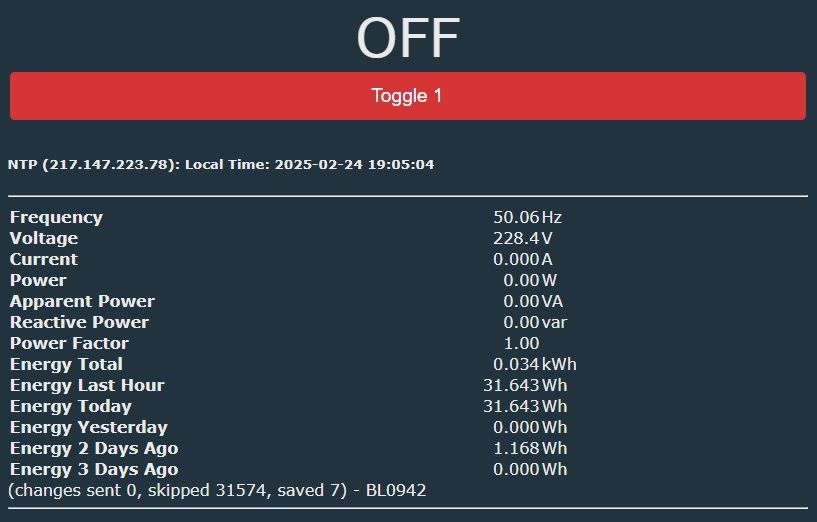

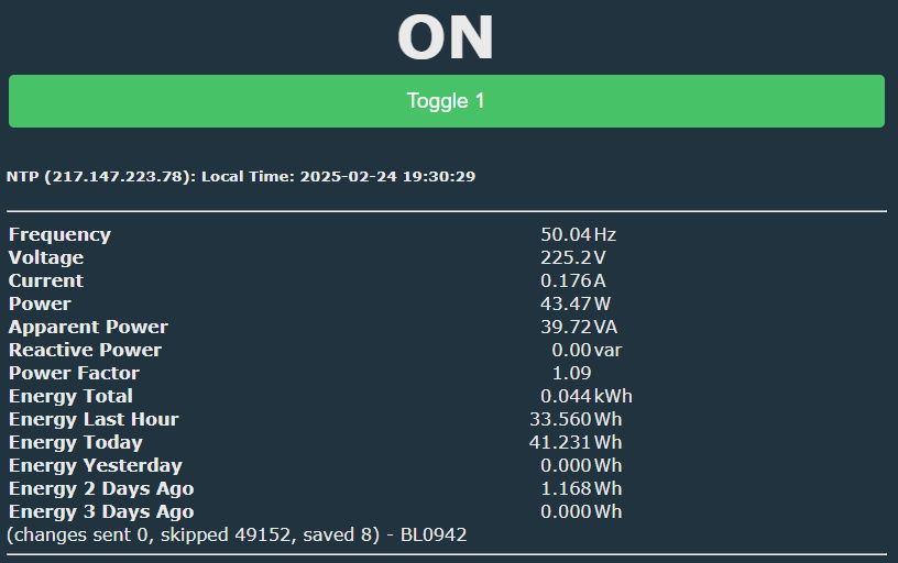

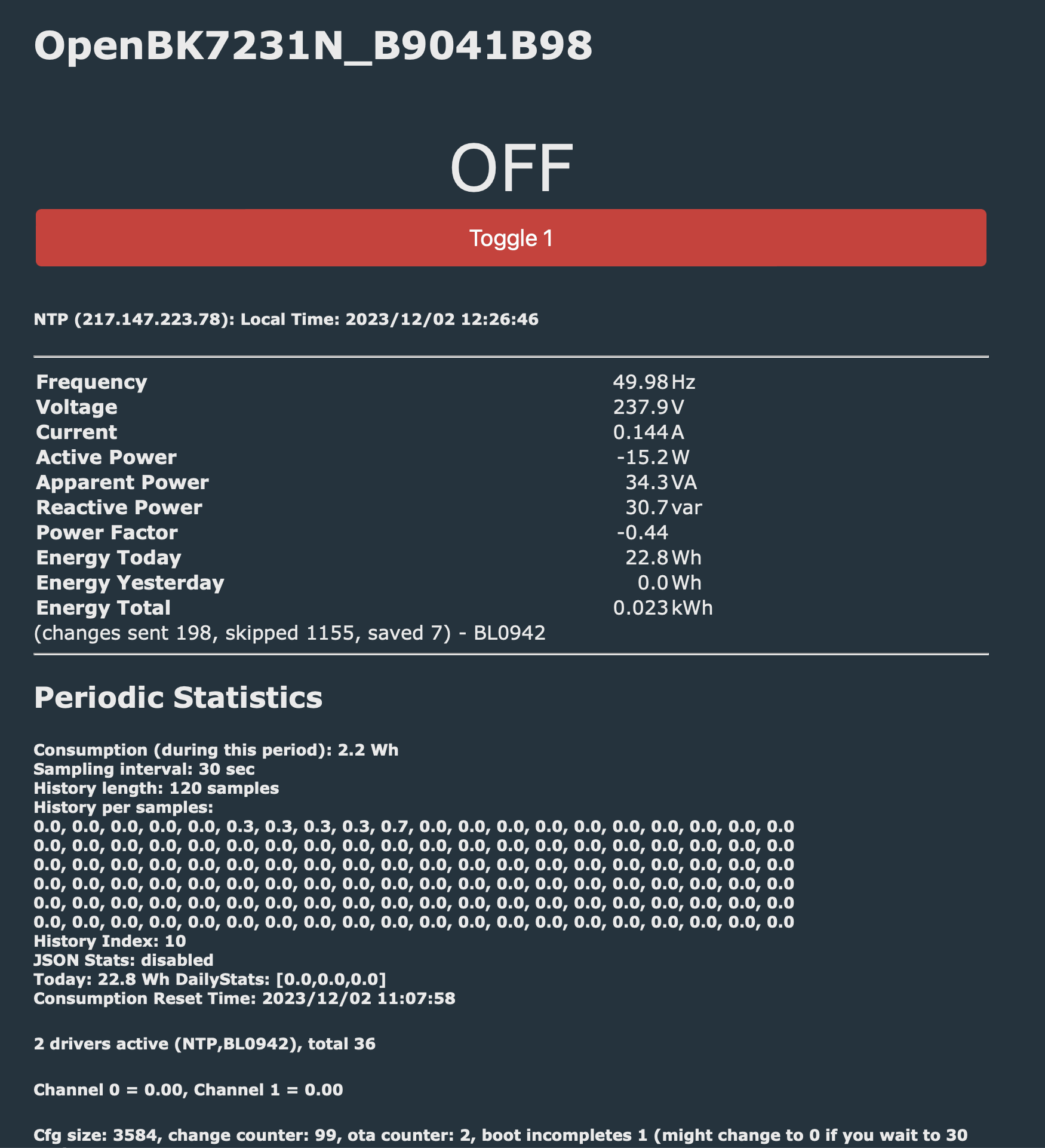

    I then calibrated Voltage, Current and Power.
    Just one issue, when relay is down, "Active Power" and "Power Factor" indicate negative value, even with Flag 38 checked.

    Concerning the issue with negatives/positives values when relay is OFF, I figured it out.
    I changed pins 24 and 26 to "BridgeFWD" and "BridgeREV".
    Updated template as well.

    Hello @flobuljeedom, how did you opened and closed it without broken it? I open mine forcing the plastic and the final result was not very good. I have no idea how to close it without tape :).
  • #4 21071486
    flobuljeedom
    Posts: 17
    Rate: 116
    As I wrote, drill it
  • Python uartprogram flashing method worked after GUI failure
    #5 21127569
    imarin2
    Thank you.
    The GUI Flash app did not work for me. It ended with write failure.
    However, the python "obsolete" method worked fine:
    python3 uartprogram OpenBK7231N_QIO_1.17.621.bin --unprotect -d /dev/ttyUSB0 -w --startaddr 0x0
    It is the third method in this page:
    https://github.com/openshwprojects/OpenBK7231T_App/blob/main/FLASHING.md

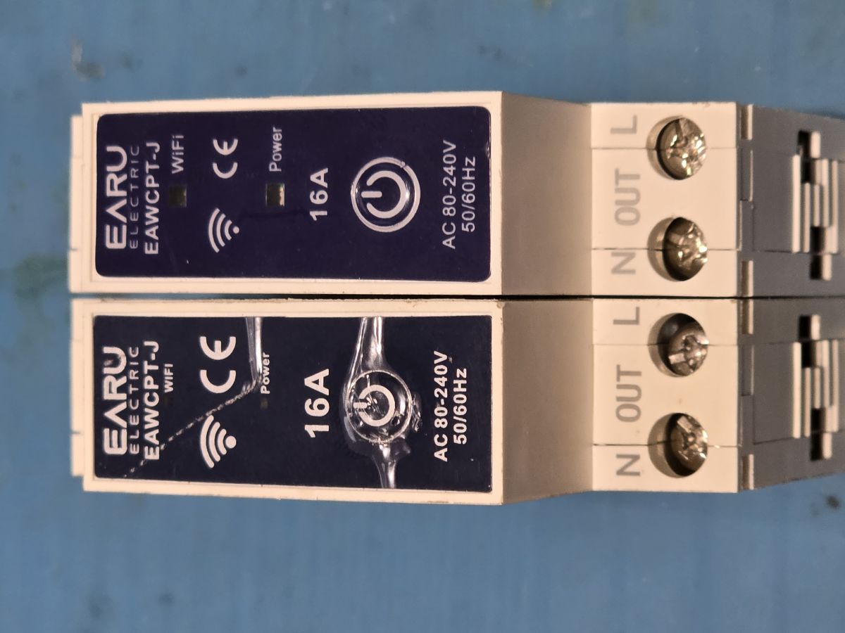

  • Hardware revision moves CBU module and breaks WiFi LED wiring
    #10 21281181
    theunknown
    ***CBU MODULE ON THE BACK? CHECK FIRST POST***
    ***CBU MODULE ON THE FRONT? SEE BELOW***

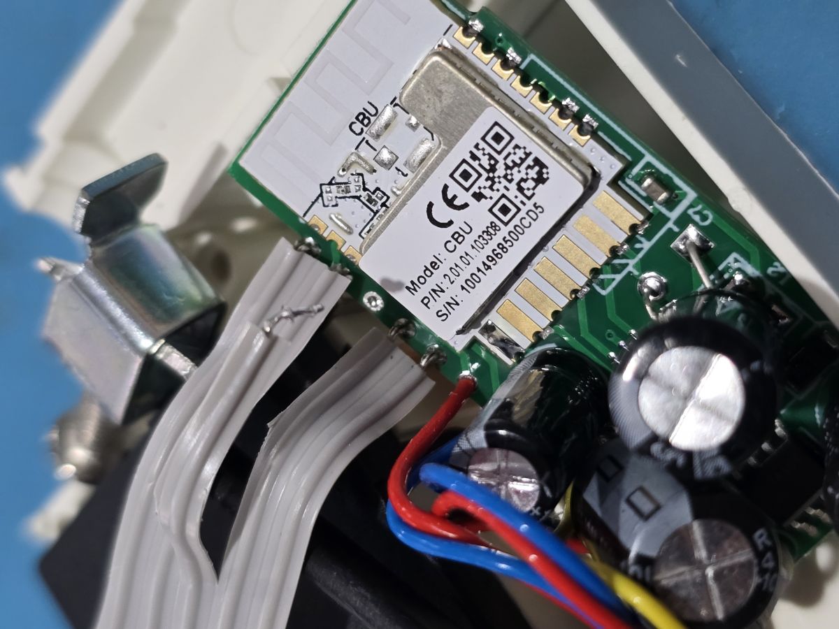

    It seems there has been a hardware revision for the EAWCPT-J. The CBU module is now on the front of the board, the pinout has changed slightly and the manufacturer made an error with with Red WiFi LED as it's now wired directly to 3.3v rather than GPIO of the module which results in it being on constantly.
    Two EAWCPT-J modules with WiFi label and 16A power rating
    The text output from the Tuya Config on the new module is below. You'll note they mapped P9 to WiFi LED when it should be the Relay LED.
    - Button (channel 1) on P15
    - Bridge Relay On (channel 1) on P7
    - Bridge Relay Off (channel 1) on P26
    - WiFi LED on P9
    This pinout map below will make the module work, but the Red WiFi LED will be on constantly.
    "7": "BridgeFWD;1",
    "9": "LED_n;1",
    "15": "Btn;1",
    "26": "BridgeREV;1"
    To fix the Red WiFi LED problem you need to de-solder the middle conductor from the front panel ribbon and solder it directly to P8 on the CBU module as below.

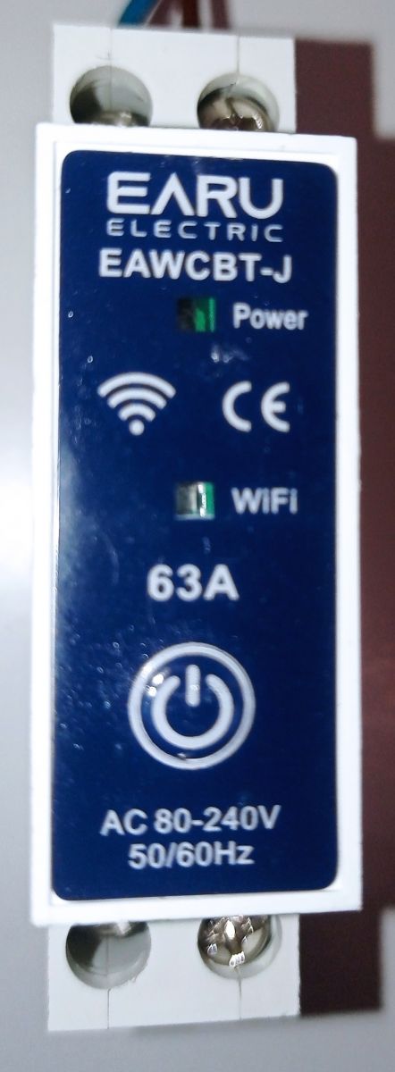

    I have just received the EAWCBT-J
    I'm assuming it's from current production, internally it looks identical to post #10, I uploaded OpenBK7231N using BK7231Flasher, I didn't solder - I used acupuncture needles. I used the configuration template from post #1.
    Compared to those shown, the location of the POWER and WIFI LEDs has changed.
    After commissioning, the POWER LED actually indicates the ON/OFF relay status, but I can only control from the web interface, the button on the panel is dead, the WIFI LED is on continuously.
    EAWCBT-J module by Earu Electric with visible Power and WiFi indicators.

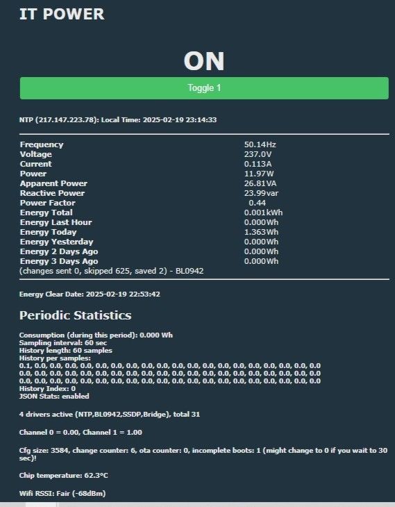

    another problem is the high power consumption, about 12W, obviously with no load, whether the relay is ON or OFF. As a consequence the circuit gets very hot >60°C.
    Screenshot of a web interface showing power data of a device.
    How to start full functionality and restore safety (temeperature) and efficiency (power consumed) of EAWCBT-J ?

    This 12W was measured with an external meter?
    As long as the Bridge is configured correctly, it shouldn't draw much power. Maybe there is something else wrong?

    - perhaps the Bridge is misconfigured, it shouldn't be drawing any current at all, unless you switch the
    - maybe you have not added the PowerSave 1 command to start/autoexec to enable power saving by the WiFi module
    That 12W is a lot, it might be worthwhile to quietly analyse what's going on there, clean up the configurations, measure with another meter, and turn things on/off one by one....

    measurement with meter ~10mA ~240V = 2.4W and indicates 12W
    - LED (channel 1) on P6
    - WiFi LED on P9
    Device seems to be using CBU module, which is using BK7231N.
    And the Tuya section starts at UNCOMMON POSITION
    I assume that the EARU EAWCPT-J is not added to the base due to the number of variants and "revisions" of the hardware implementation ?

  • #18 21453645
    Posts: 14755
    Rate: 12881
    Thanks for pointing this out - I see that on the Web App the importer did not have bridge relay implemented. Only on the windows app was it entered. I have corrected it:
    Screenshot of the OpenBeken Configuration Generator tool for generating configuration from JSON. .
  • Updated template and pin mapping for EARU EAWCPT-J
    #19 21454550
    abaku
    Posts: 73
    Rate: 10
    EARU EAWCPT-J
    In this version (delivery 02.2025), the location of the LED POWER and LED WIFI is changed https://obrazki.elektroda.pl/7131103900_1740038535.jpg
    working template:
    Notes:
    note to
    "6": "LED _n ;1" - after extraction from tuya the template returns "6": "LED;1"
    flag 41 was active - problem with button not working :-)
    calibration required
    despite calibration the measurement readings float a little
    "flags": "2622468" - above flags 31 are not represented in such a record

  • Off-state meter shows 9 V and reactive power
    #21 21454587
    abaku
    Posts: 73
    Rate: 10
    I'm not sure if the measurement is correct, look at what it indicates when the switch is OFF and when it is ON - there is a current measurement but no active power reading and strangely enough there is a reactive power measurement
    data without load
    Screenshot of electrical measurements with the switch OFF.
    Screenshot displaying electrical energy measurement data, including frequency, voltage, current, apparent and reactive power, and energy consumption. .
    under load looks quite likely
    of curiosities, with the relay off, I can see about 9V on the meter
  • #22 21454603

    and if you load it with a classic 60W bulb what does it show?
  • #23 21454637
    abaku
    Posts: 73
    Rate: 10
    it's not so easy to still have a 60W tungsten bulb :-)
    but I have a 40W Sawtooth
    Screenshot showing energy consumption monitoring with various values such as voltage and power. .
