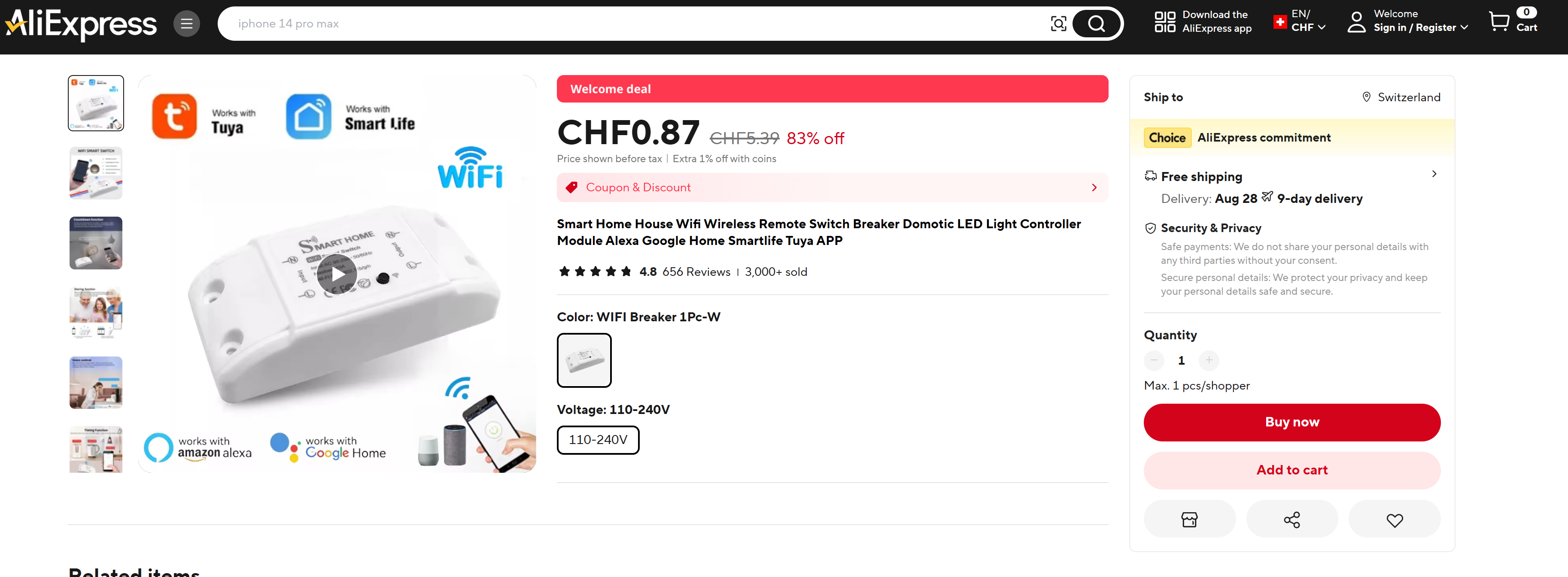

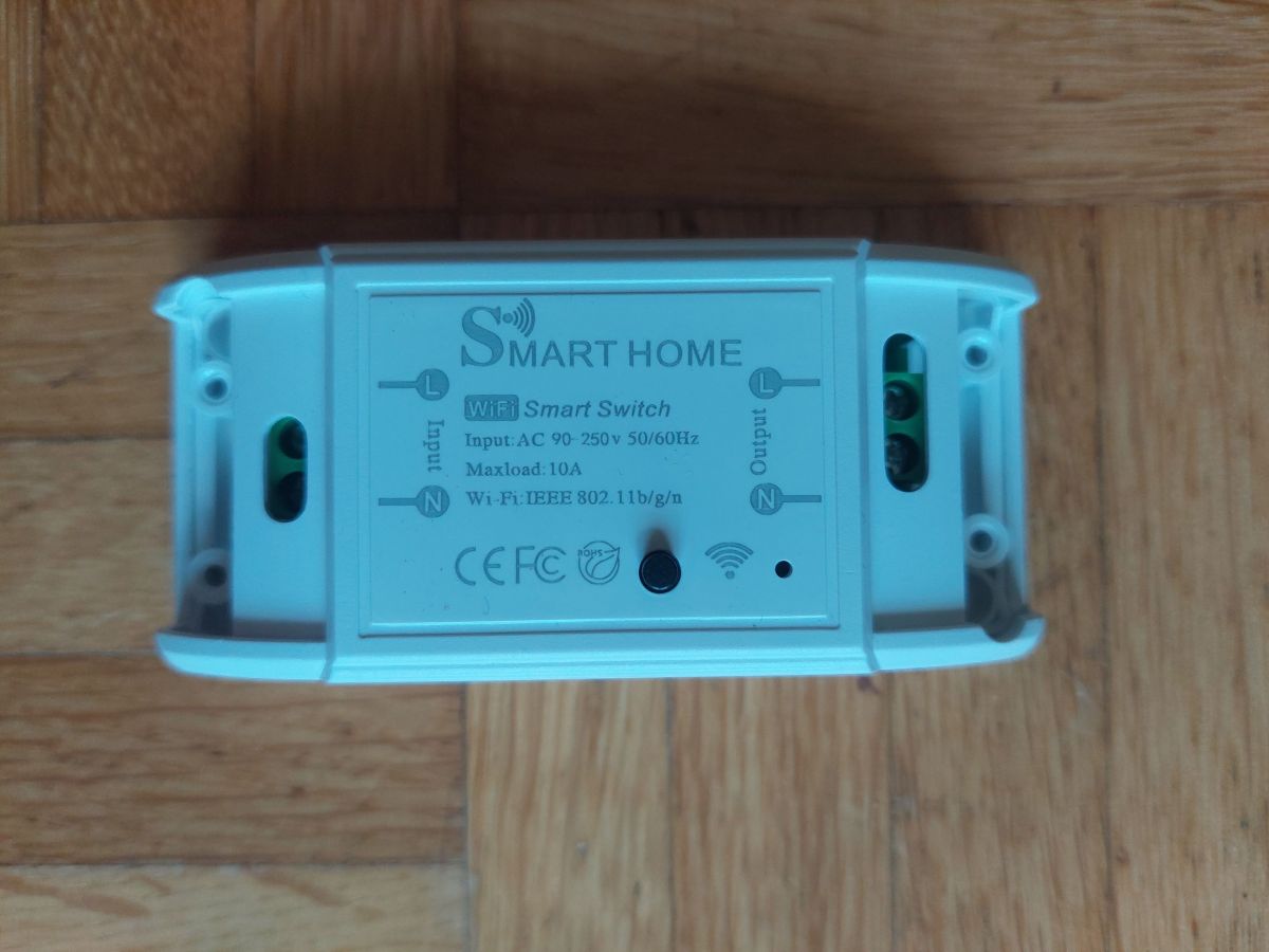

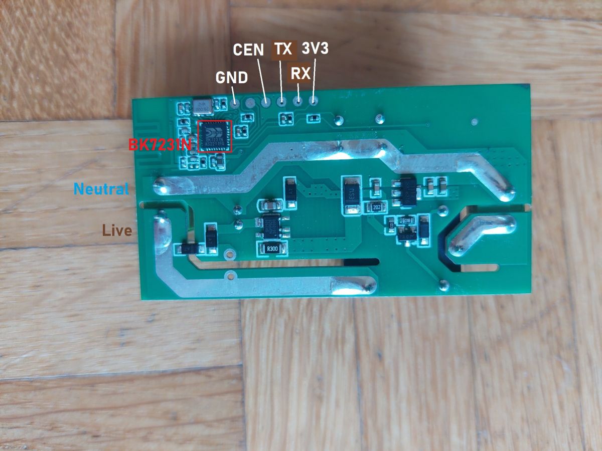

    Teardown of "Smart Home Smart Switch" WiFi Relay from Aliexpress.
    Product page: https://www.aliexpress.com/item/1005006322147252.html
    Product page on AliExpress for WiFi Smart Home Smart Switch.

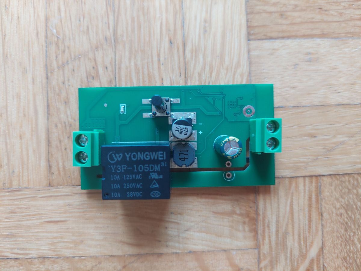

    Contains a Y3F-105DM relay rated for 10A @ 250VAC, controlled by a Beken BK7231N.
    Photos of device:
    WiFi Smart Home switch with visible electrical connectors Image of a WiFi relay circuit board from Aliexpress with electronic components. Printed circuit board with electronic components on a wooden surface.

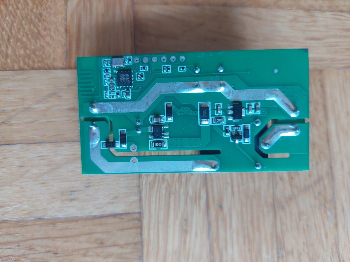

    Labelled PCB:
    View of WiFi relay PCB with connection labels.

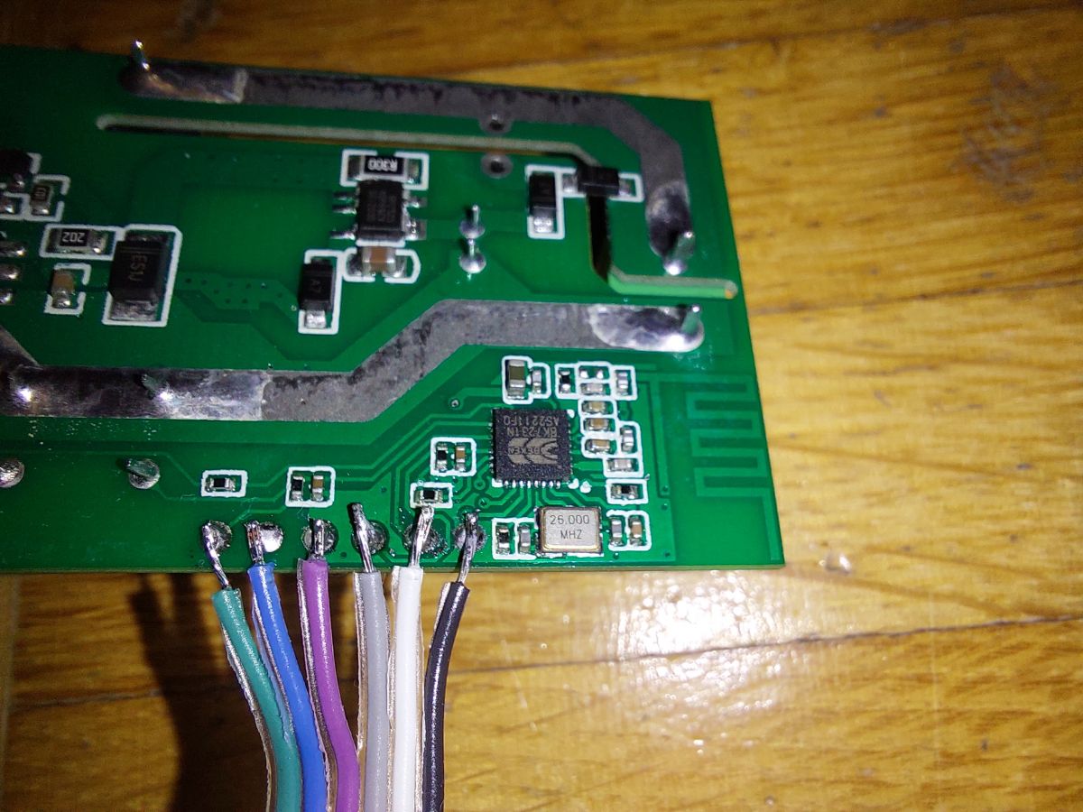

    PCB has solder points for Ground, 3.3V, UART1_TX, UART1_RX, CEN and P21=JTAG_TMS (not labelled)
    I used an ESP32 Devkit board as a UART bridge:
    Solder up some jumper cables to the PCB:
    WiFi relay PCB with soldered wires on connection points.
    Connect GND, 3V3, TX, RX to their counterparts GND, 3V3, TX0, RX0 on the ESP32 and connect the EN pin on the ESP32 board to ground to keep the ESP32-Module asleep. Then use the flash tool ( https://github.com/openshwprojects/BK7231GUIFlashTool ) according to its instructions.

    I've seen similiar device (chip and flashing pad placement) but with ESP8266 or similiar (maybe rather ESP8285?) some time ago on our forum

    It's interesting to see more and more ESP designs with BK chips now.
    Wait, are BK QFN pins matching ESP pins, more or less? I've never checked...

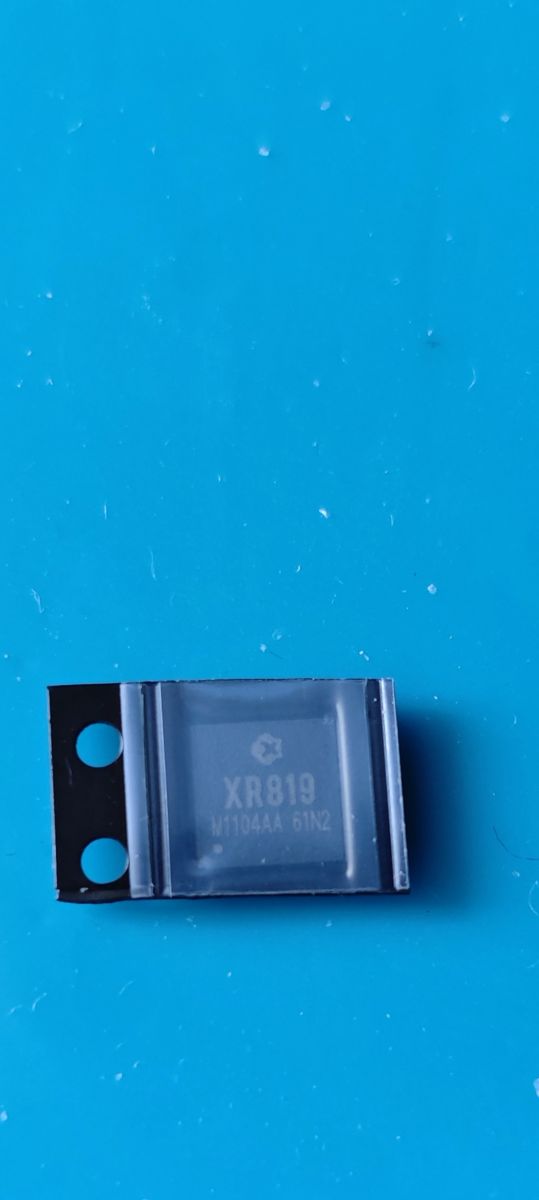

    Good question! I've never thought to check. I want to know for something similar, this XR819 (I want to try XR809 OBK on it somehow), so I'll do some comparisons.
    Image of XR819 integrated circuit on a blue background.

    BK7231N is smaller than ESP8285H16, so impossible to simply swap them.
    >>21203224
    XR819 is not a general purpose microcontroller, but a SDIO WiFi module (like esp8089). In the datasheet, most of the would be GPIO pins are NC.
