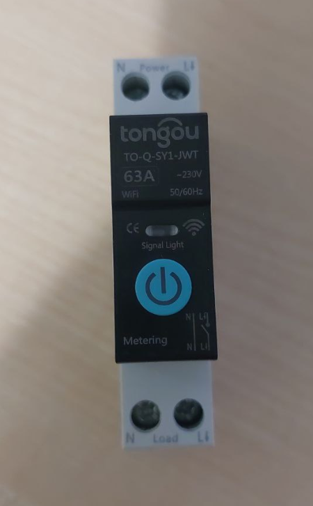

    [BK7231N - CBU] TONGOU TO-Q-SY1-JWT Din Rail Wifi Switch with power metering
    Chipset BK7231N module model CBU
    EDIT: Power metering uses BL0942 chip.

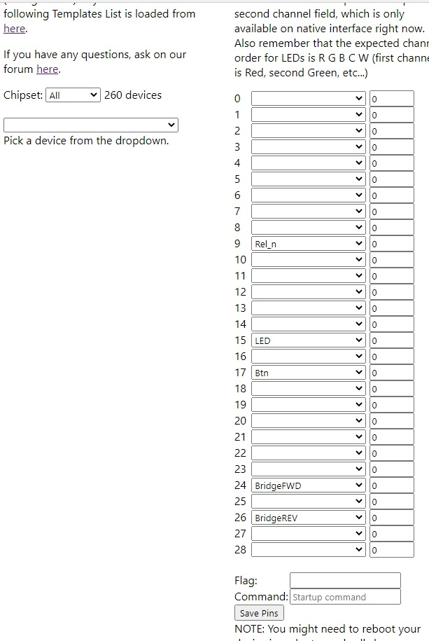

    thealphahelix
    Hey, I'm new to the forums and I have one of these I'm trying to configure.
    I've flashed the firmware over and it's working fine, but I'm now trying to work out the pin configuration... Is there a procedure for this? I've used the above information to get the LED correct and operating on the button press. I've not reconstructed the unit to see if the relay is closing (needs 12v I assume that's provided by the mains power!) but I assume that will be working by setting 24 and 26 to BridgeFWD and BridgeREV respectively.
    Do I just work out pin configurations, or is there more code to add somewhere? Sorry for the questions!
  • #7 20448030
    valeklubomir
    Rate: 15

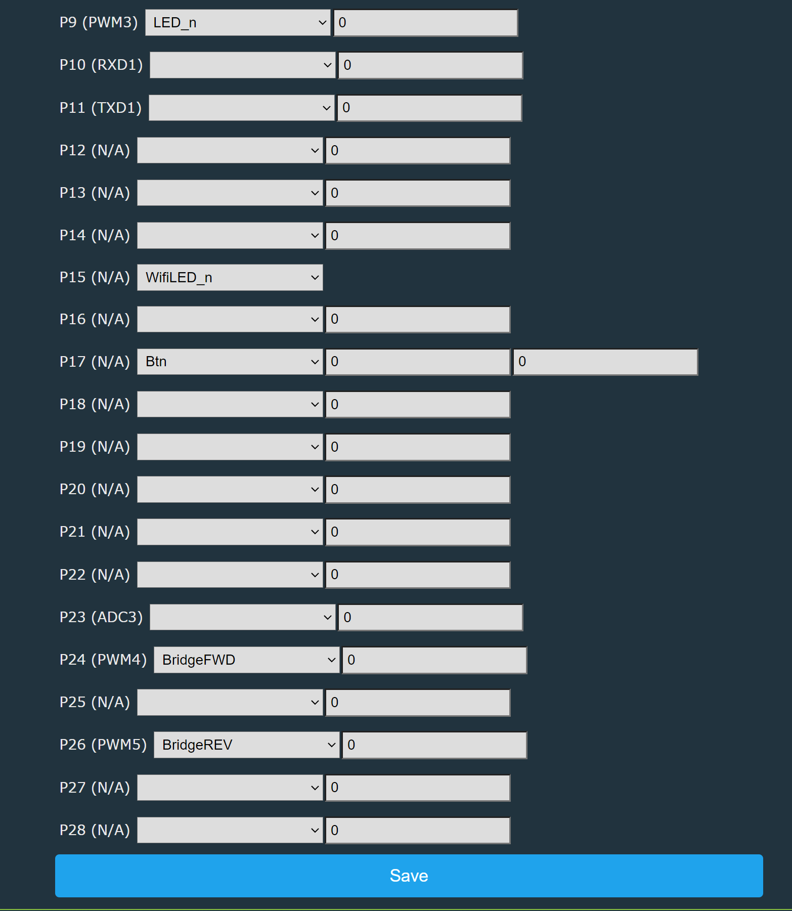

    For the basic functionality it is enough just to setup pins. Bridge driver will start automatically after reboot.
    BridgeFWD and BridgeREV must be paired with channel ID. If device with multiple relays would apear, then multiple pair of FWD/REV could be defined.
    So button/LED/FWD/REV must have same Channel ID.
    It will behave as normal RELAY. Same functionality in MQTT or HomeAssistant.

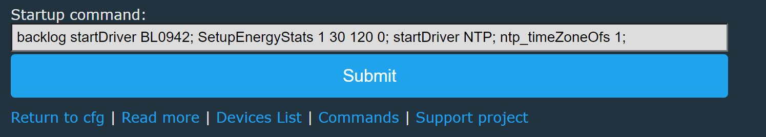

    I also activated startup command for using BL0942 energy monitor, if installed. There is also version without energy monitor.

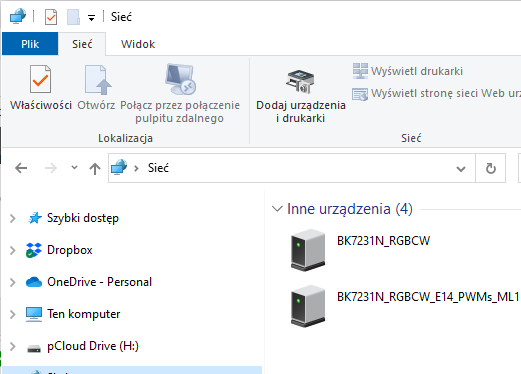

    Btw @thealphahelix , have you tried "startDriver SSDP"? Device will show up in Windows:

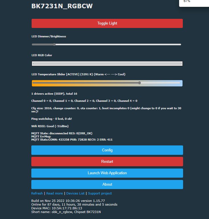

    btw2 - my bulbs has now almost 90 days uptime!

  • #12 20474627
    Posts: 14649
    Help: 655
    Rate: 12661
    You have attached images incorrectly. External links will expire over time. Please use our image hosting. I have already fixed your post, but keep it in mind.

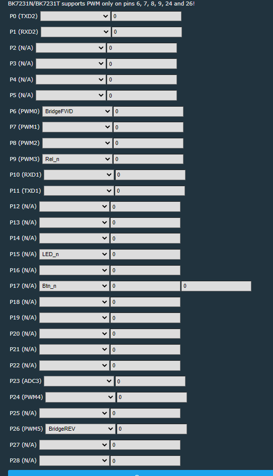

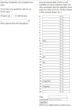

    Why do you have a Rel_n configured?
    Are you sure that your device is also using P24 and P26 for bridge?

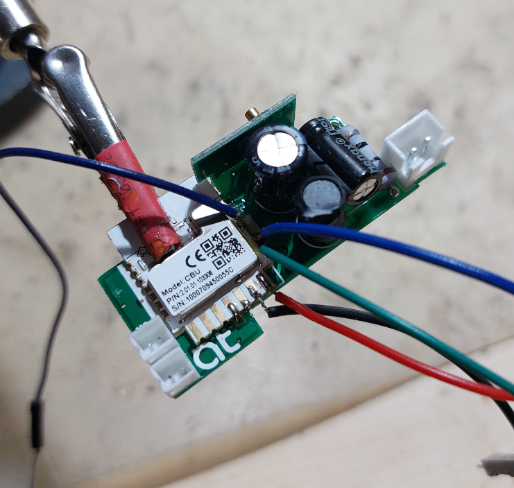

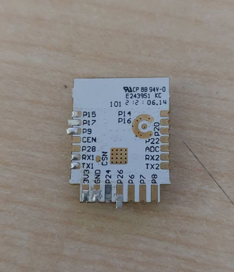

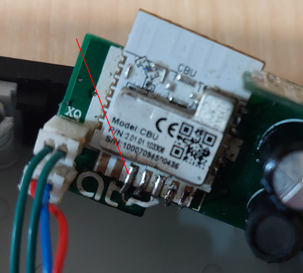

    i will only let know what was my problem :
    i solved it right now
    be desoldering the chip i have brake P24 pad
    also i connected it now - i have change to
    P6 (PWM0) it was near and soldered with thin cable to the route where come from relay output
    here som pictures from work
    [BK7231N - CBU] TONGOU TO-Q-SY1-JWT Din Rail Wifi Switch with power metering [BK7231N - CBU] TONGOU TO-Q-SY1-JWT Din Rail Wifi Switch with power metering [BK7231N - CBU] TONGOU TO-Q-SY1-JWT Din Rail Wifi Switch with power metering [BK7231N - CBU] TONGOU TO-Q-SY1-JWT Din Rail Wifi Switch with power metering [BK7231N - CBU] TONGOU TO-Q-SY1-JWT Din Rail Wifi Switch with power metering [BK7231N - CBU] TONGOU TO-Q-SY1-JWT Din Rail Wifi Switch with power metering [BK7231N - CBU] TONGOU TO-Q-SY1-JWT Din Rail Wifi Switch with power metering [BK7231N - CBU] TONGOU TO-Q-SY1-JWT Din Rail Wifi Switch with power metering

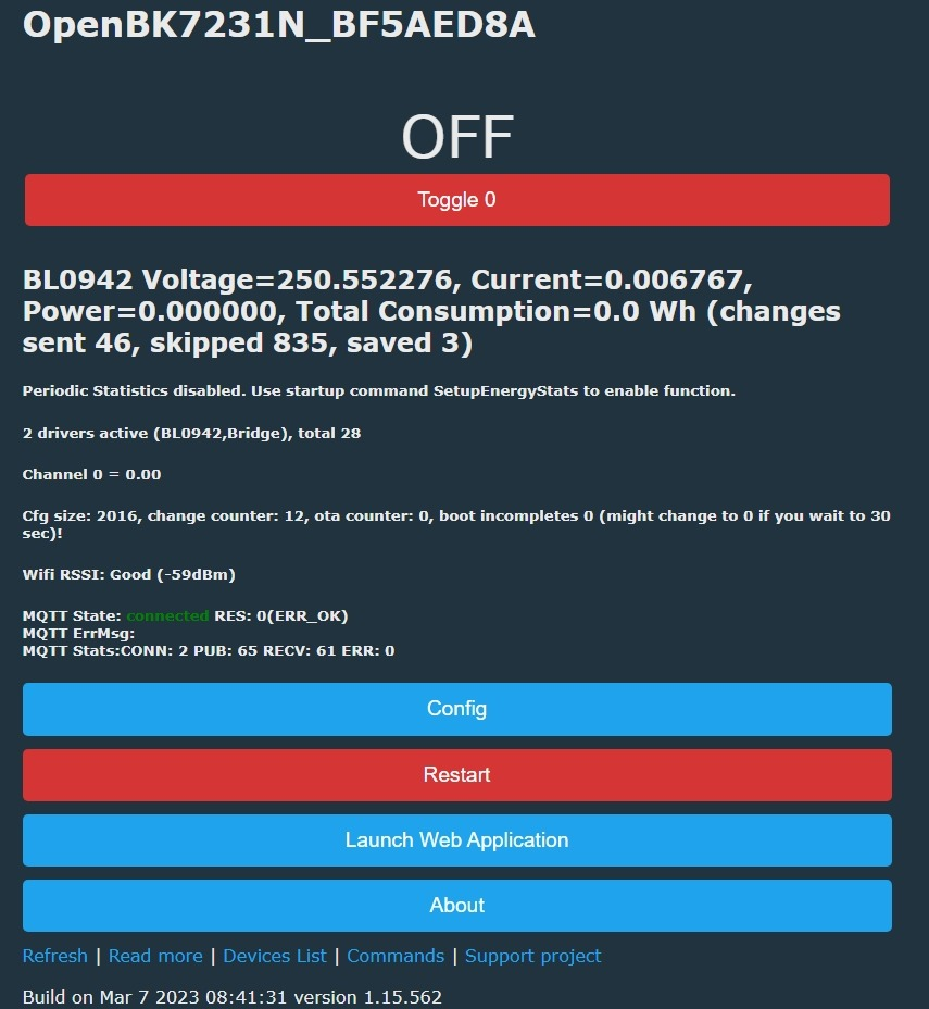

    Added after 4 [minutes]:
    Added after 13 [minutes]:

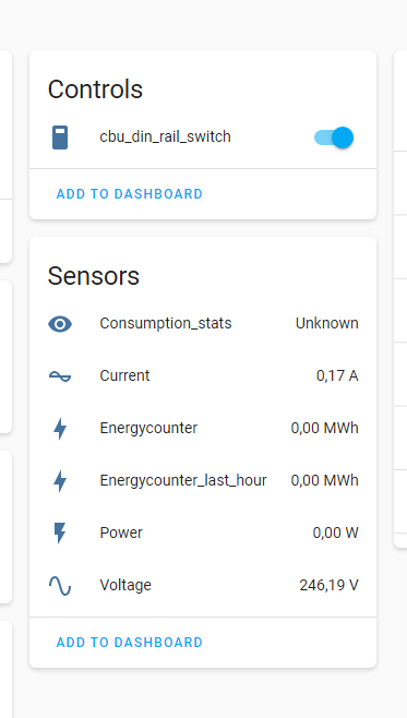

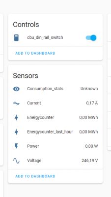

    why i dont have more reading there ?
    ON
    BL0942 Voltage=244.916381, Current=0.172250, Power=0.000000, Total Consumption=0.0 Wh (changes sent 34, skipped 570, saved 4)
    now is 75W bulb attatched on Load

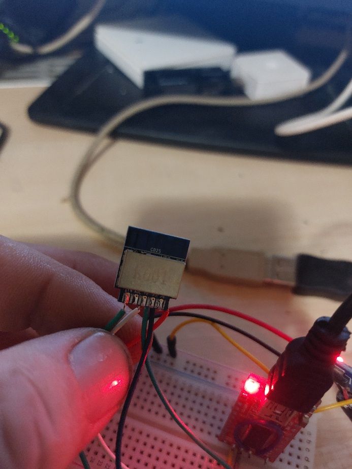

    Posts: 7

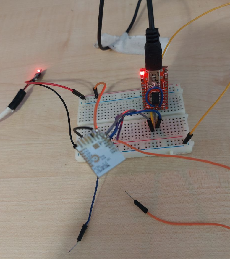

    i have used a hot gun, but not much practice, like you see :)
    now is second done, but why the programer needs 100 atempts to write sucesfully ?

    /startup_command
    backlog startDriver BL0942; SetupEnergyStats 1 30 120 0; startDriver NTP; ntp_timeZoneOfs 1; startDriver SSDP;

    What kind of USB to UART converter do you have? For me it works good.
    Maybe not enough flux when soldering? Did you first add Pb solder to make joints melting point lower?
  • #17 20475051
    romanfarki
    Posts: 7
    i use this one
    no i used only gun temperature 330 Celsius
    but second i have make on board , i solder there only 5 wires _ RX,TX,VCC,GND and CEN to reboot

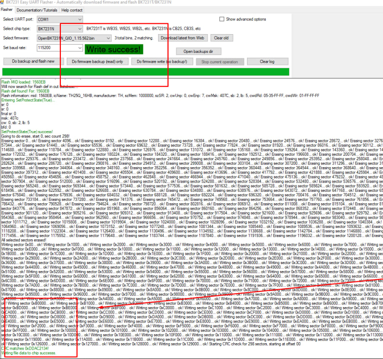

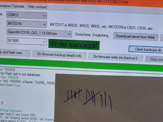

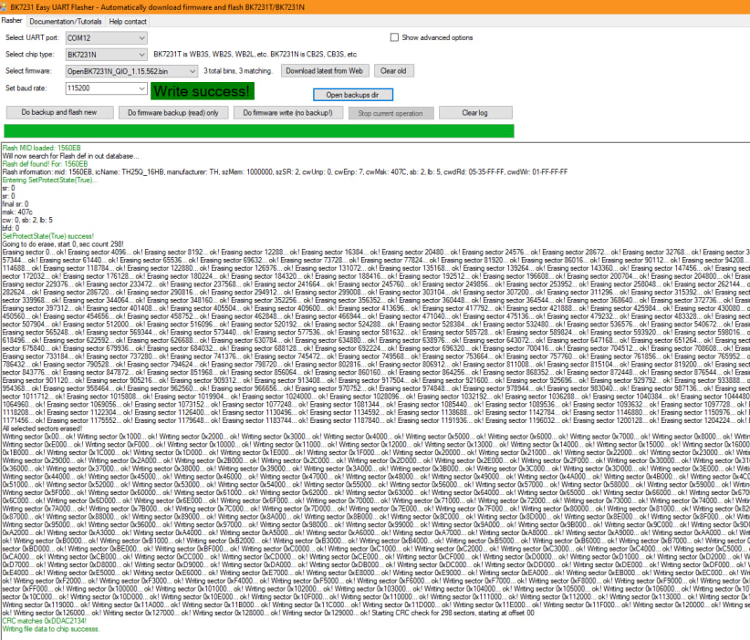

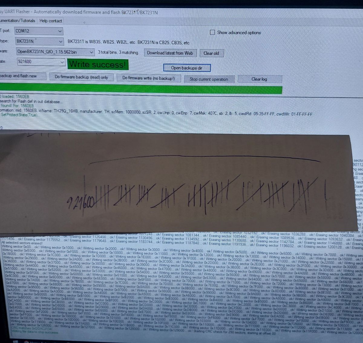

    today i have flashed 2 more cb2s chips
    but not work on first time at all
    see picture :) [img-0] [BK7231N - CBU] TONGOU TO-Q-SY1-JWT Din Rail Wifi Switch with power metering [BK7231N - CBU] TONGOU TO-Q-SY1-JWT Din Rail Wifi Switch with power metering
    Strange
    Sometimes write in 5 min sometimes 30 min..

    What about other baud rates?
  • #22 20476727
    romanfarki
    Posts: 7
    I tried every one but only the middle work 921600
    backup work well in 1or two attempts
    but write - horror
    today I recorded about 10 cb2s to switch 16Amp
    but I spent 5 hours on it... well, I don't know, maybe it will be my flasher
    Thanks for help.

  • #26 20670966
    przemsi_ele
    Posts: 62
    Rate: 15
    I flash the CBU Wi-Fi TONGOU TO-Q-SY1-JWT without soldering and it worked. i only added 4 wires , CEN't use, in debian hid_download_py-master/uartprogram enter and turn on 3V3 and flies....
    As I downloaded the template in obk (http......./?app), the pins were set to rel and rel_n making the relay coil energized all the time and heated up a lot which gave me a thought, I changed to H bridge as below:
    "24": "BridgeFWD;1",
    "26": "BridgeREV;1"
    and now it is ok
    only this template name was missing some letter and maybe it was a template for another type
    my code: TO-Q-SY1-JWT 63
    and this template https://www.elektroda.com/rtvforum/download.php?id=1189399 has pins 24 and 26 for my case wrongly set are Rel and they are supposed to be bridge , because the relay controlled by H bridge

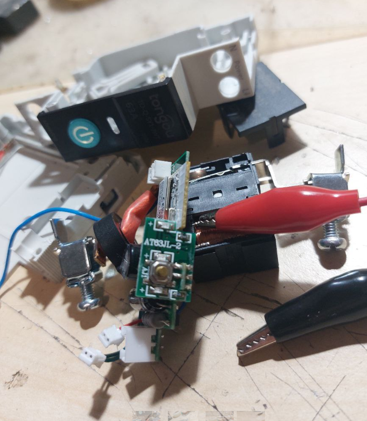

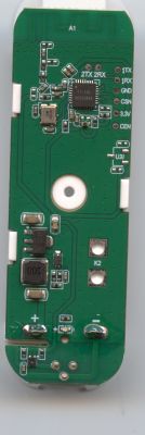

    maybe they are the same but different device ? or maybe the description needs to be made up ?

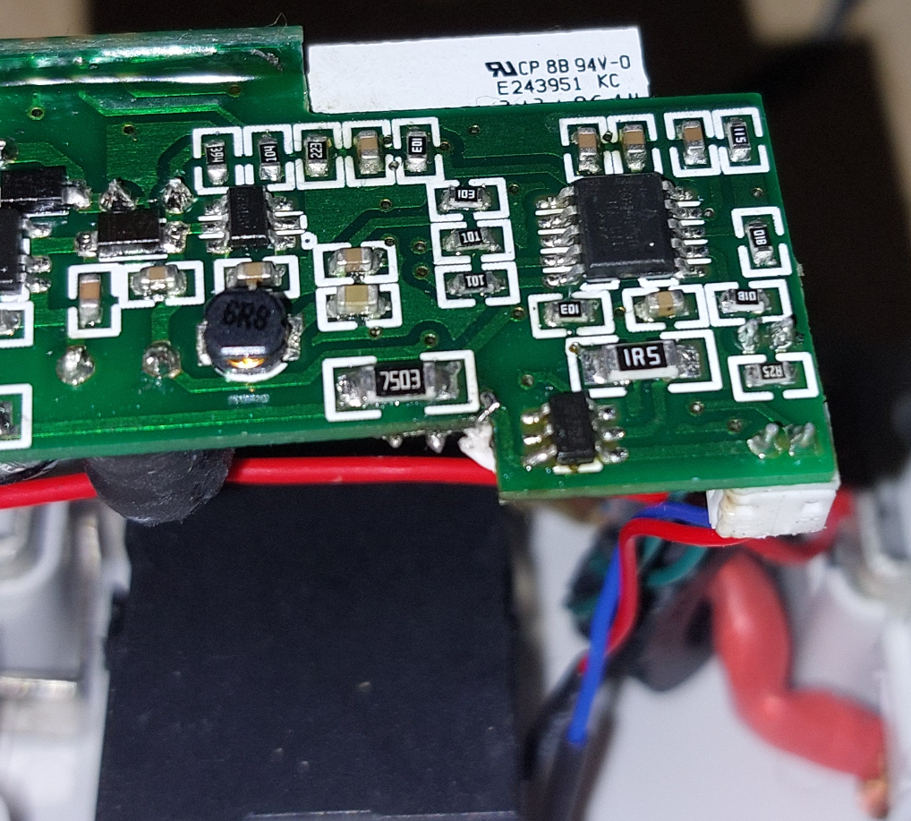

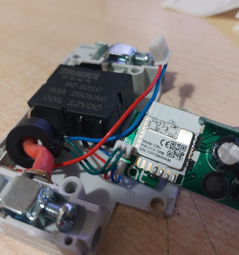

    I analyzed the photos and I have a slightly different model, the board with the button I have soldered in a different way, above in the photo there are 3 solder fields on one side and 2 solder fields on the opposite side, and in my case 3 solder fields are in one place on the board and another 2 places in another place on the board :)
    buttered butter
    edits because the device is similar, pins are the same, only the design of the board is different

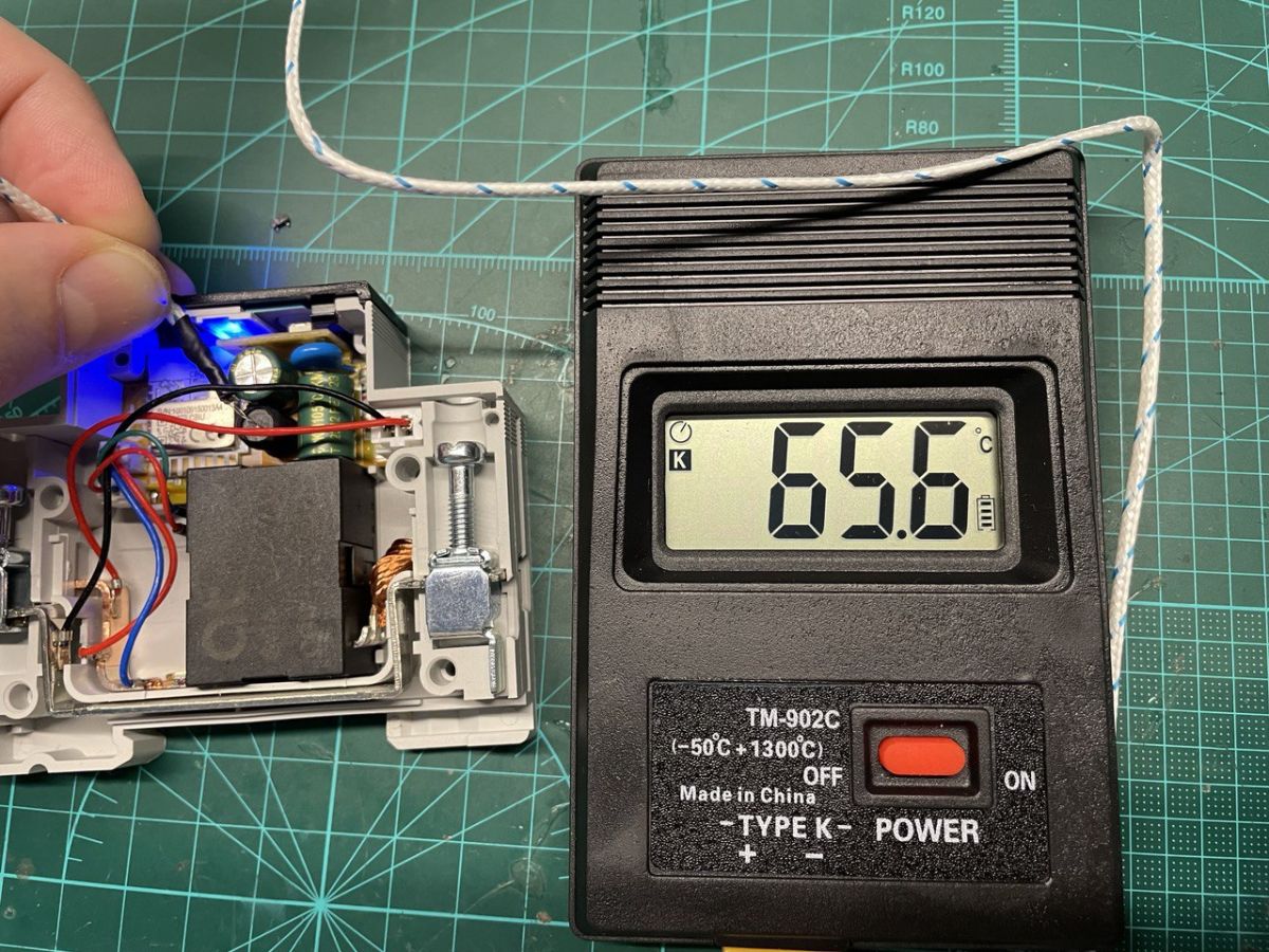

    This model has a 12V coil , tuya was running fine, I uploaded openbk and now when switching the relay CBU restarts, the LED flashes and connects to the wifi.
    As I disconnect the relay the device continues to work without rebooting.
    Maybe I did something wrong

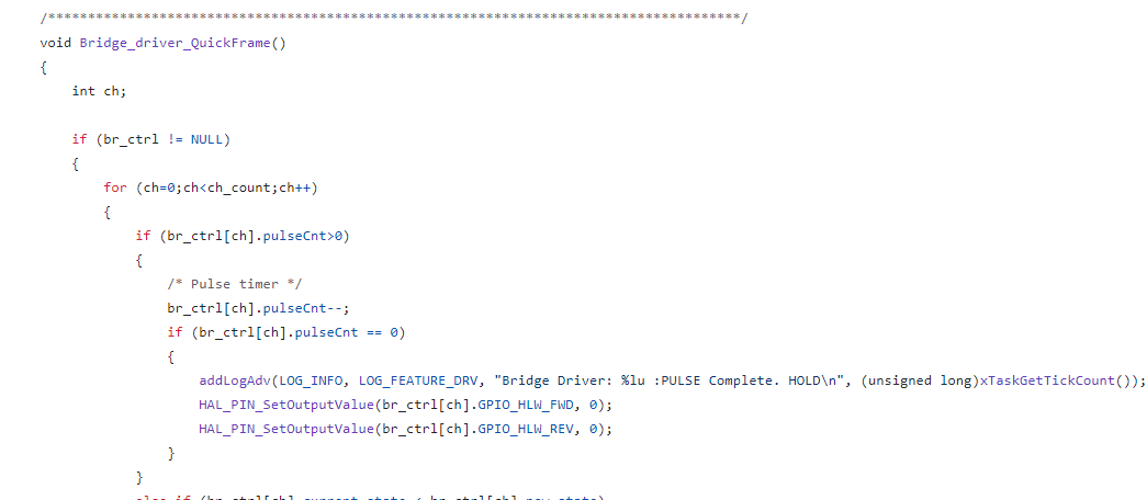

    Seems I found a great problem with this firmware settings and how it works with bridge relay.
    In the first message in this thread was attached a diagram, how bridge Driver should be controlled:
    Diagram for controlling a bridge driver with 100 ms pulse timing.
    And there clearly showed that it controlled by impulses about 100ms.
    But in yours implementation bridge relay controlled by continuous power.
    This is a reason of ac-dc adapter and bridge driver itself is hardly overload and it's become VERY hot. This is extremely dangerous as for relay components so for environment!!! I show not the maximum temperature, it's continue to grow up.
    A thermometer showing 65.6°C next to an open casing with electronic components.
    Can you please update configuration for firmware to fix this issue? Thank you!
    PS: May be I'm doing something wrong?

    Thank you reporting the issue. The bridge driver was created by Valek and I am not sure if he's active these days, @valeklubomir , are you online?
    If he's not, then we will have to fix the issue ourselves.
    So, are you saying that one of the relay coils is left on forever? This is strange, because judging from the code, it seems that both pins are set to 0 when time is out:
    Snippet of C code related to the operation of a bridge driver.
    Or maybe I have misunderstood you, I haven't analyzed the working principle of this bridge controller yet.
✨ The discussion centers on the TONGOU TO-Q-SY1-JWT DIN Rail WiFi switch featuring the BK7231N chipset (CBU module) and integrated power metering via the BL0942 chip. The device uses a magnetic polarized relay driven by an MD7620 bridge driver IC, requiring 100-200 ms pulses to toggle relay contacts, which then hold position without continuous power. Initial firmware lacked support for the MD7620 bridge driver, but a pull request was submitted and merged to add this functionality. Proper pin configuration is critical: pins 24 and 26 must be assigned as BridgeFWD and BridgeREV respectively, not as simple relay outputs (Rel/Rel_n), to avoid continuous coil energizing and overheating. The bridge driver should start automatically on reboot, but manual startDriver Bridge command may be necessary if autostart is disabled. Adjusting the bridge pulse length is possible but not fully documented; some users reported issues with pulse timing affecting relay operation. Flashing the device can be done without desoldering the module by connecting to UART pins, though some users experienced difficulties with programming stability and recommended using hid_download_py or the BK7231GUIFlashTool. Power metering calibration remains imperfect, with non-zero power readings at no load and issues distinguishing real, apparent, and reactive power. Firmware flags and startup commands can influence metering behavior and device startup states after power outages. Community members shared updated JSON templates for device configuration, emphasizing correct pin roles and startup commands to enable bridge driver and energy monitoring. The discussion also touched on hardware modifications for broken pads and soldering techniques for module removal.
TL;DR: A 100–200 ms pulse is enough to flip the MD7620 latching relay, and “Bridge driver will start automatically after reboot” [Elektroda, valeklubomir, post #20448030] OpenBK v1.17.441 adds native Bridge support and fixes over-heating caused by continuous coil drive [Elektroda, robert21965, post #20942245]
Why it matters: Correct pin roles and pulse timing stop the relay from drawing >2 W as heat and extend module life.
• Wi-Fi SoC: Beken BK7231N, 32-bit, 2.4 GHz [Elektroda, valeklubomir, post #20288620] • Relay driver: MD7620 H-bridge, 100–200 ms activation pulse [Elektroda, valeklubomir, post #20288620] • Metering IC: BL0942, ±1 % typical after calibration [Elektroda, valeklubomir, post #20288620] • Latest tested OpenBK: v1.17.441 (Jan 2024) [Elektroda, robert21965, post #20942245] • Flash speed: 921 600 bps UART; HID tool removes 100-attempt issue [Elektroda, romanfarki, post #20476727]
How do I enable the H-bridge driver in OpenBK?
  1. Set P24 to BridgeFWD;1 and P26 to BridgeREV;1. 2. Reboot so the Bridge driver autostarts. 3. If 0 drivers show, issue startDriver Bridge once [Elektroda, Osrx, post #20863693]
My relay stays energised and overheats—why?
Using Rel/Rel_n roles powers the coil continuously. Switch to BridgeFWD/BridgeREV roles so the driver sends a 100–200 ms pulse only [Elektroda, przemsi_ele, post #20862770]
