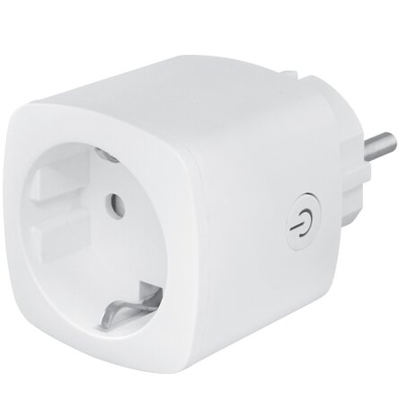

    The device is a Prosto WFU-08PM Smartplug with Energy Monitoring.
    I wasn't able to open it up but because it's glued down. Although I did manage to use Tuya Cloudcutter. It was using MCU 1.3.5 and is based on the BK7231T chip. After messing around in the config panel, it turned out the smartplug uses the BL0937 chip for power monitoring.

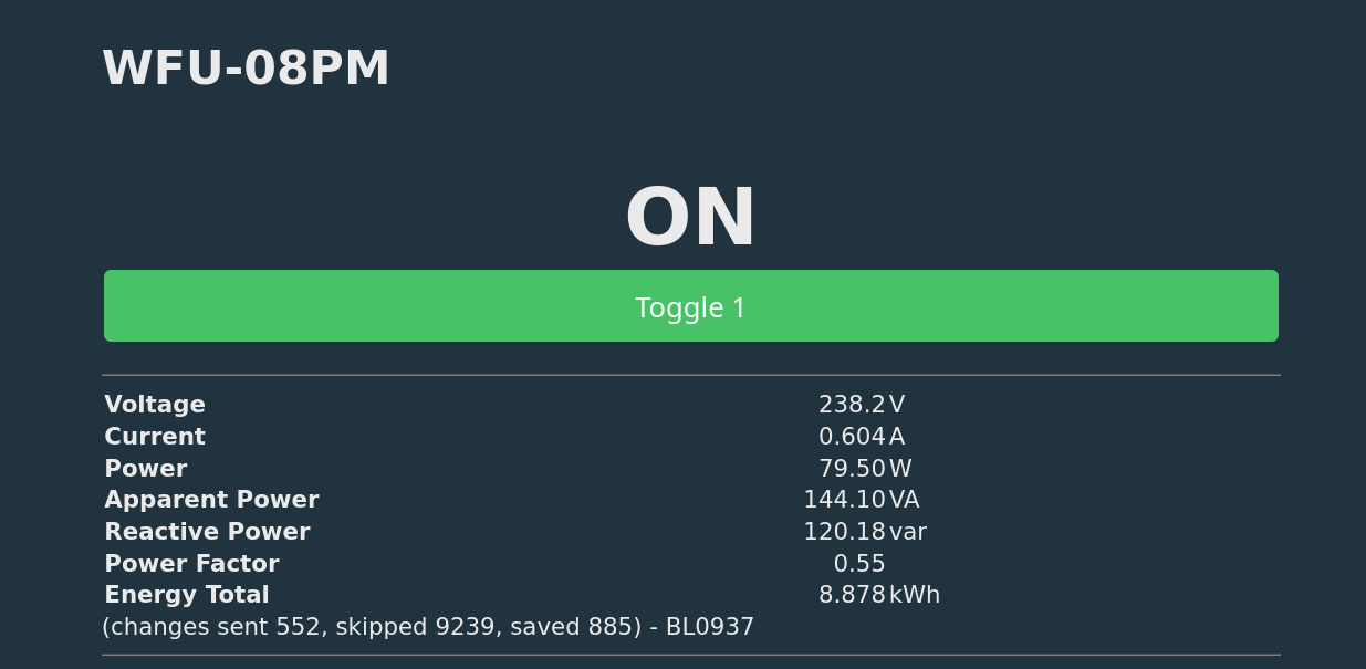

    Looks like I've accidentally kept a button during debugging. I saw that other plugs in the file don't have feature flags set so I've updated the JSON based on the commit you've shown.
    Here's the update:

    I've fully reset the device and then tried this import -- works very nice.

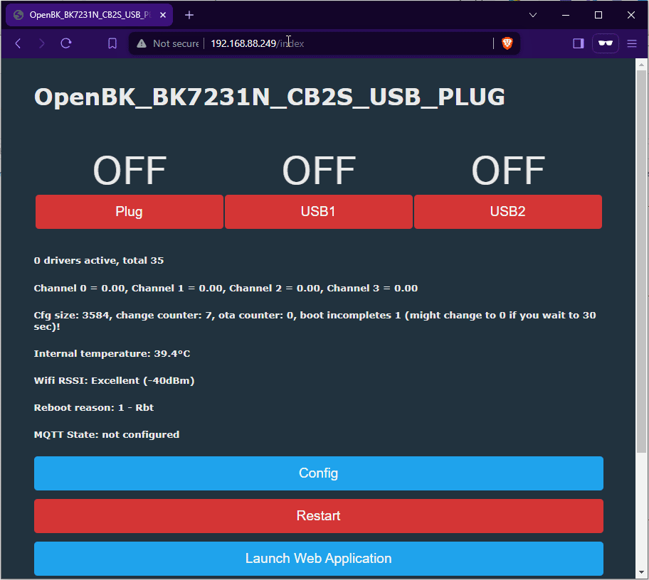

    Edit:
    Woops, forgot screenshot:
    [BK7231T] Prosto WFU-08PM Smartplug with BL0937 Energy Monitoring
    Also added PowerSave command.
