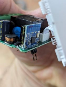

    jnoam

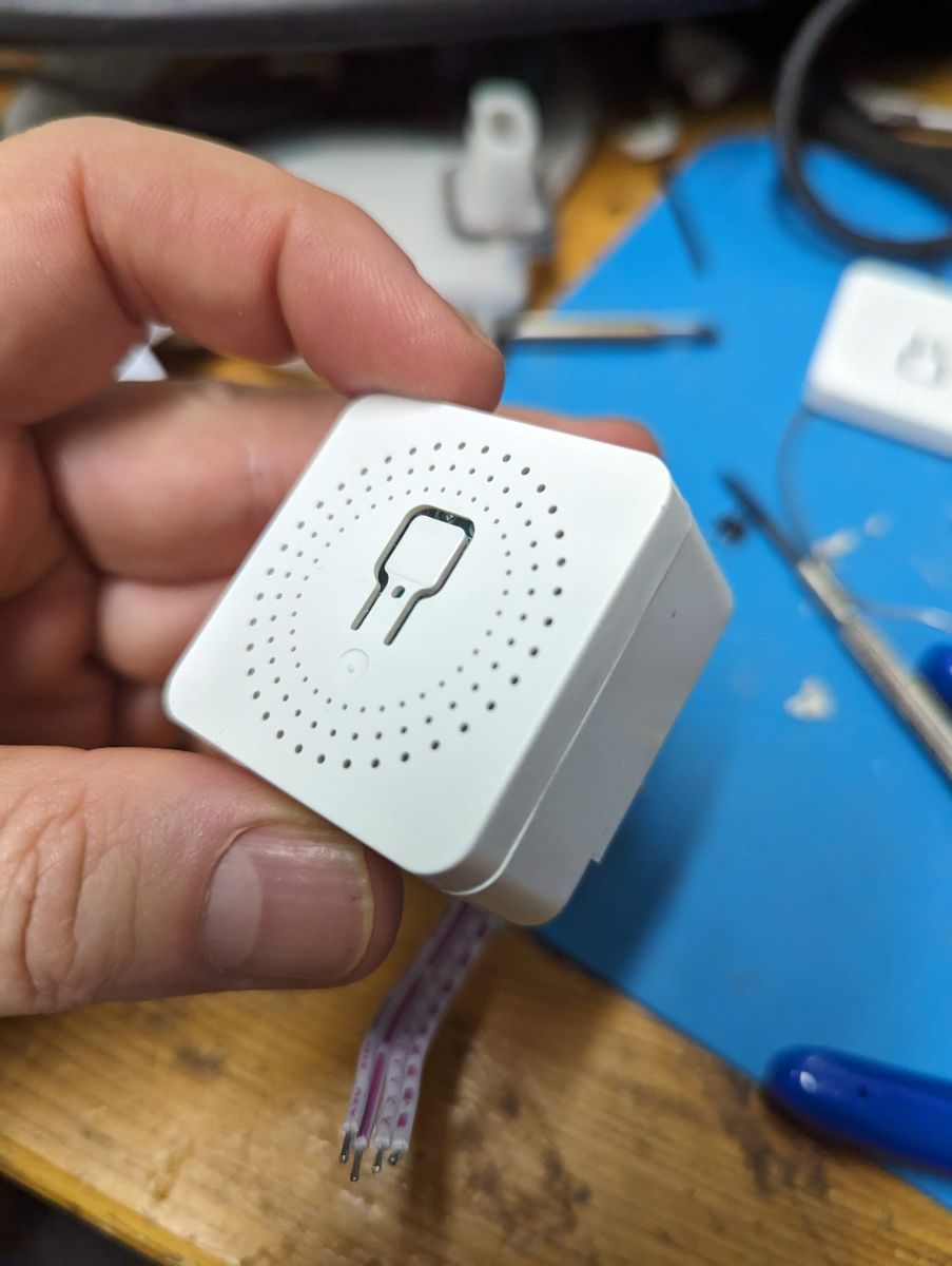

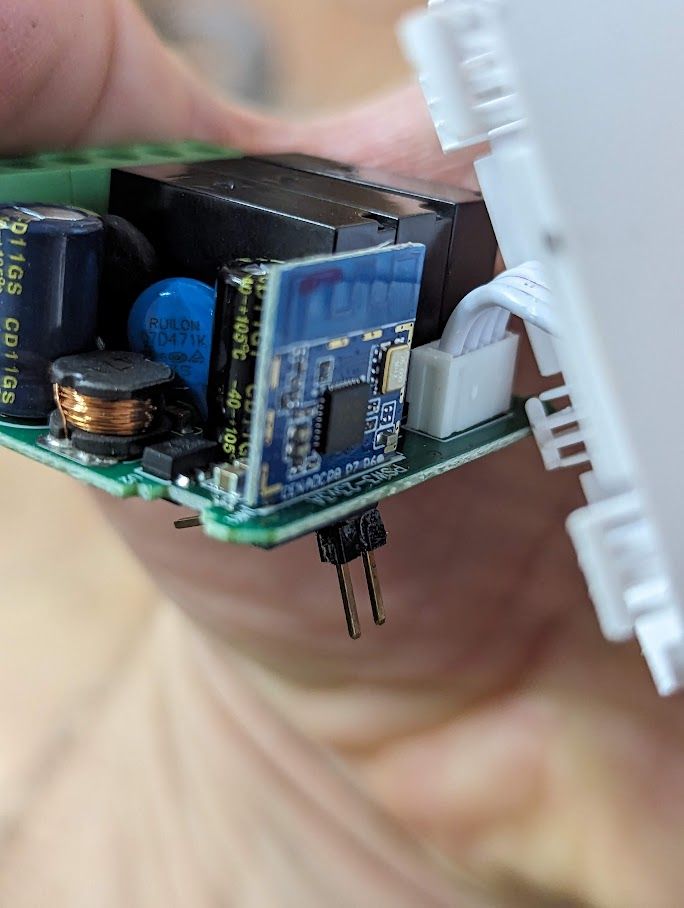

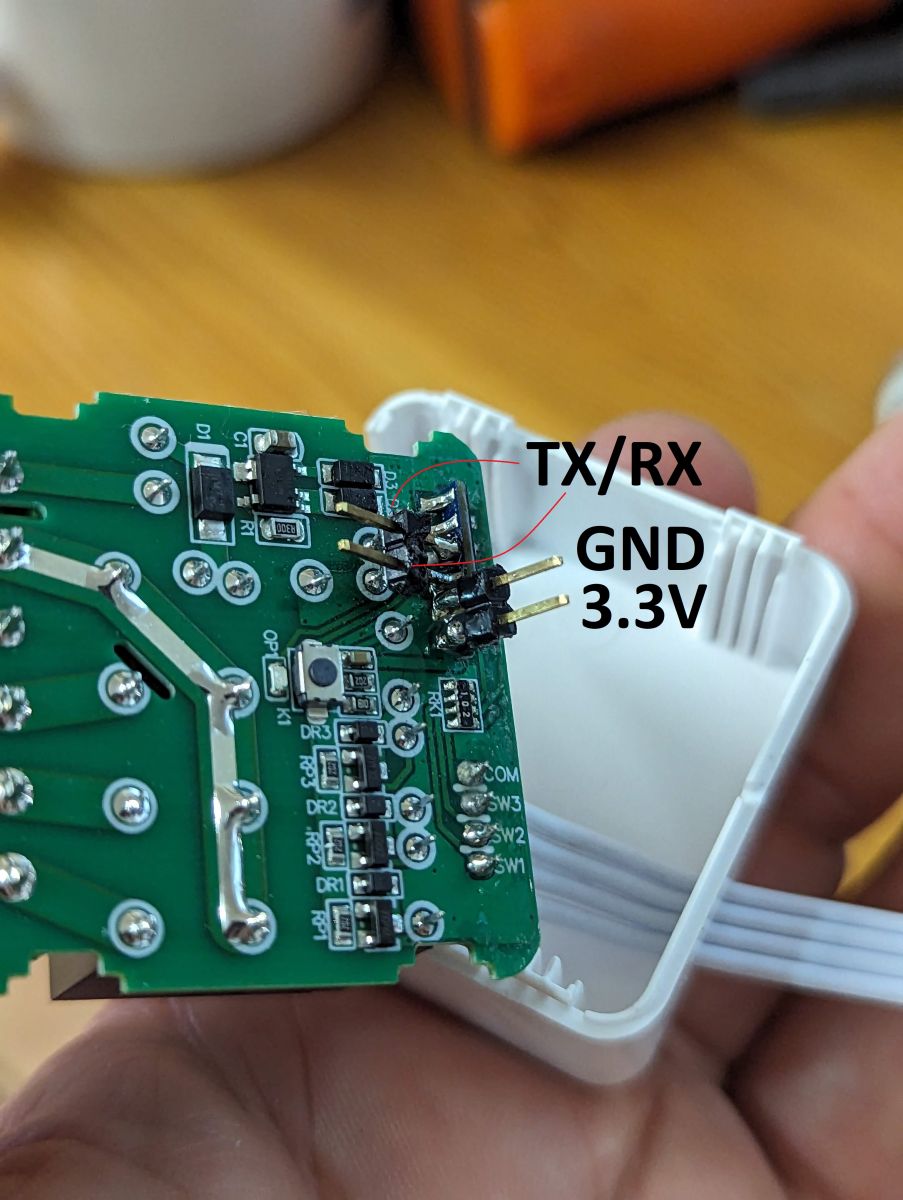

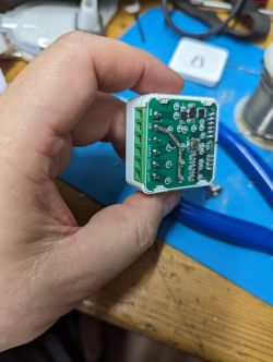

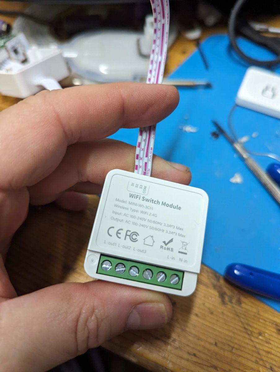

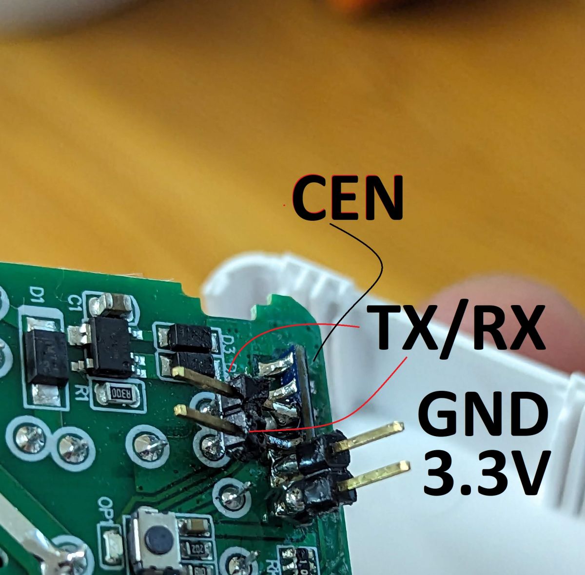

    Close-up of a circuit board with labeled elements CEN, TX/RX, GND, and 3.3V. A teardown of a new format of what I think is a common device. It is a 3-channel switch with BK7231N daughter card but installed at 90 degrees to the PCB (without a riser card). Loading of OpenBK was easy (even though it was my first time with this chipset) as I soldered headers to the daughter card pads and that's it.
    The image shows the disassembly of a 3-channel switch with a BK7231N card installed at a 90-degree angle to the PCB. Labels TX/RX, GND, and 3.3V are visible. A hand holding a white square switch with a pattern of small holes on the surface. A hand holding a WiFi switch module with long wires, against a workbench background. A person holding an electronic switch in hand with visible integrated circuit and soldered components. Close-up of the interior of a device with a BK7231N card mounted at a 90-degree angle to the PCB.
    To reset, just touch the CEN pad on the edge with a GND cable. It worked on the first try on all 3 devices I converted.

    Thanks! Please post OBK JSON template (copy from the Web App) and Tuya Config, see tutorial:
    https://www.youtube.com/watch?v=WunlqIMAdgw
    Futhermore, on that kind of devices, please remember to use PowerSave 1. They have bad quality power supplies.
