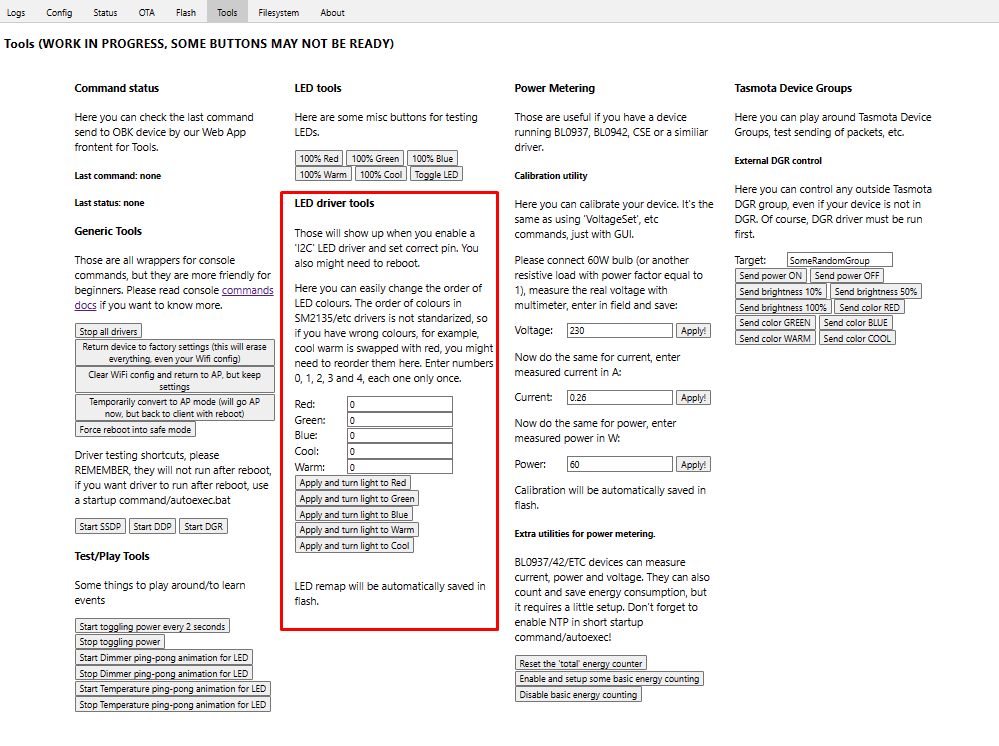

    The bulb turns on, but the color pinout is completely off. First off, I have not gotten any color at all, just the 2700-6500k. Second, I am not able to figure out what pins do what and have been tinkering with them for a good hour now.
    Was wondering if there was an easier way to figure out the pins than trial and error in the tools tab.

    There is a tool for that, have you seen it?

    Yes, that is the tool I have been using. I am not having any luck getting any color or figuring out what pins are toggle/dim/etc. Seems like each configuration I try just does random things with color temperature and brightness. I can't figure out a pattern to any of it.

    are you sure its BP5758D?

    I'm a dummy....it is SM 2235. Now I can figure out the pinout. I'll update this post when I figure it out, in case someone else is looking for this bulb to convert.
    Pin 6: SM2235CLK
    Pin 8: SM2235DAT
    SM2235_Map 2 0 1 3 4

    Those chips do not have any data validation, so random colors are a good sign of using wrong kind of configuration, like BP5758 for SM2235, like you did above.
