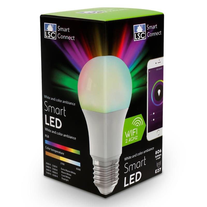

    https://docs.calex.eu/doc/970719.1.pdf
    Packaging of the LSC Smart Connect LED smart bulb with a mobile app on the package.
    https://github.com/OpenBekenIOT/webapp/commit/9ecf2cc5a9e346a0870afa75522f9886974e34d7
    Added after 3 [minutes]:
    good resource for cross-referencing other details like article numbers, EAN, factory model https://docs.calex.eu/doc/
