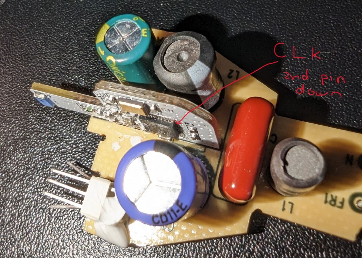

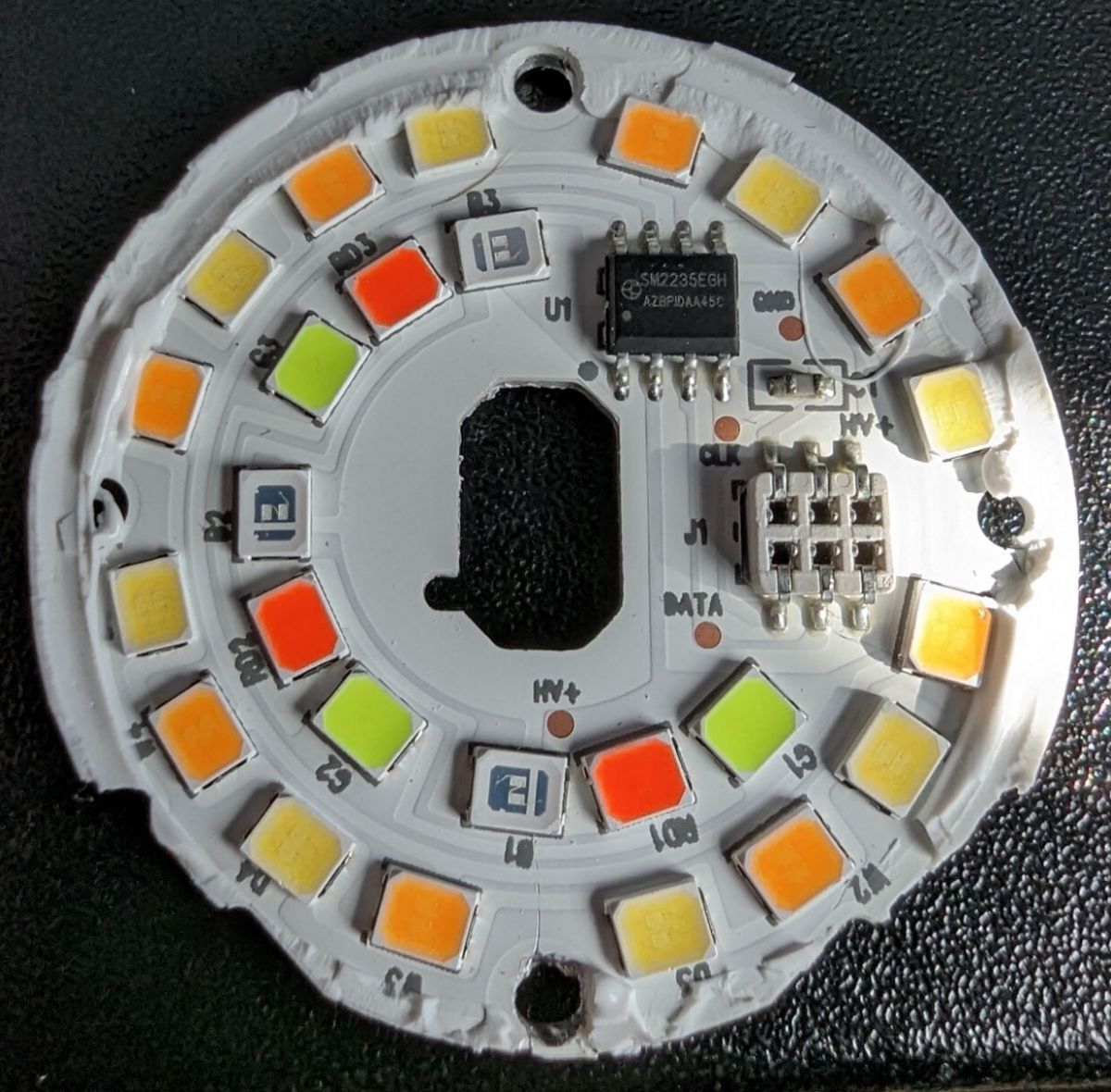

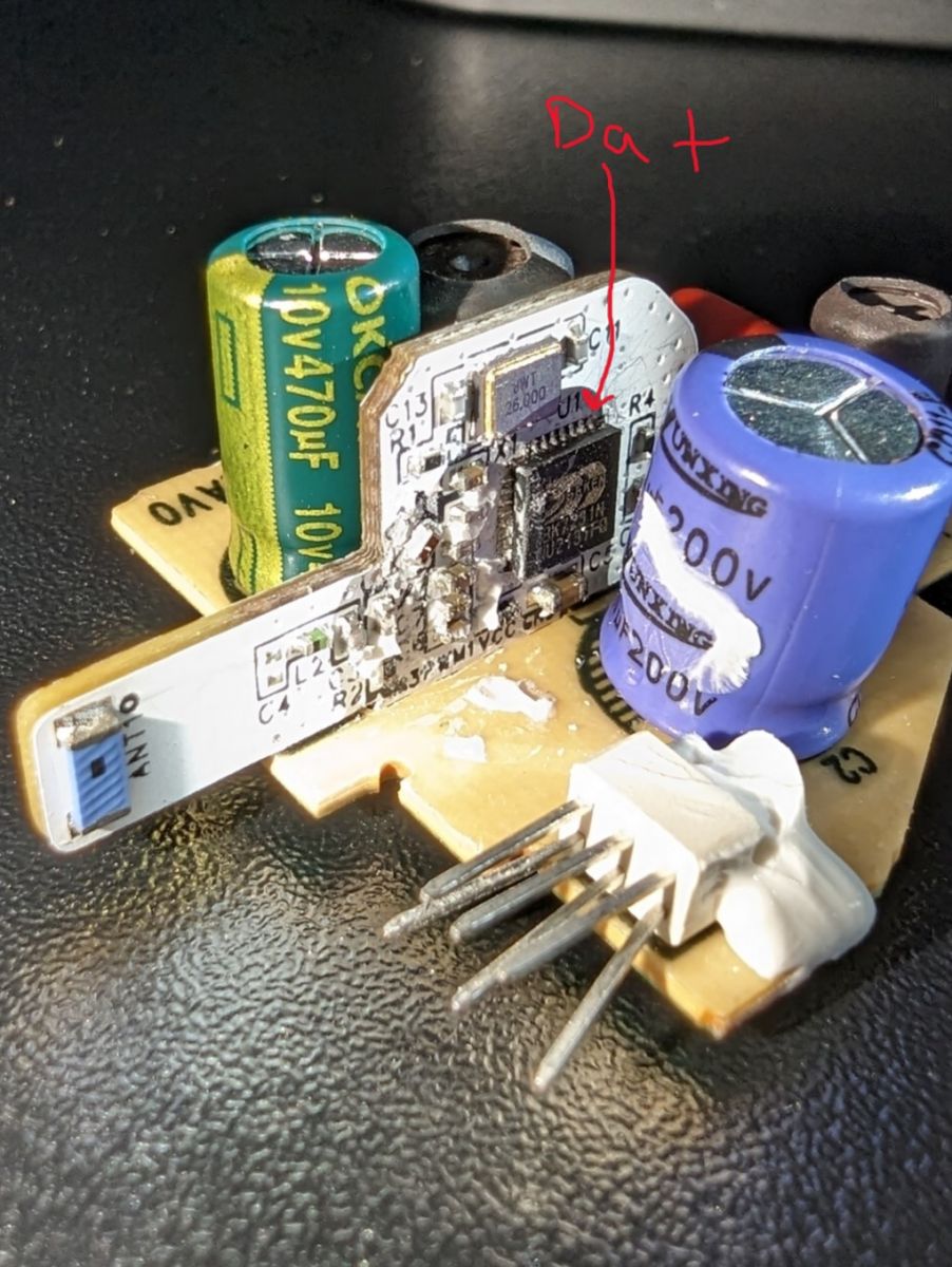

    EDIT: Nevermind, got it working. Correct config was:
    Pin 7: SM2235CLK
    Pin 9: SM2235DAT
    Thanks for all you do!
    ORIGINAL MESSAGE:
    Hello!
    I'm back with another generic bulb. Any help would be very much appreciated.
    https://www.amazon.com/gp/product/B0BS14VHH3
    I feel silly that I can't figure this one out. It is SM2235, BK7321N, and CBLC9??? Board does not have marking on it, but it looks similar to the writeup on this forum.
    The pinouts aren't making much sense and I've used multiple combinations of the PWM pins. Nothing works.

    SM2235_Map 2 0 1 3 4

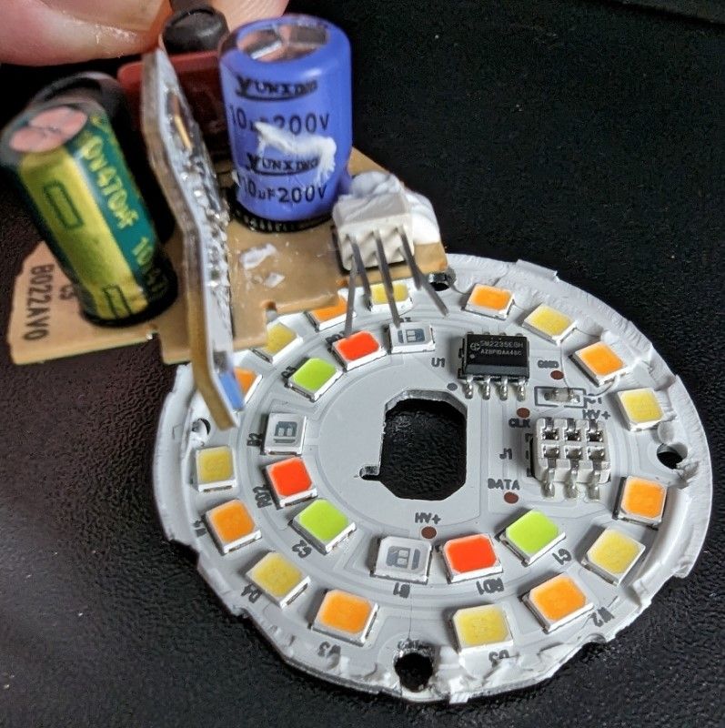

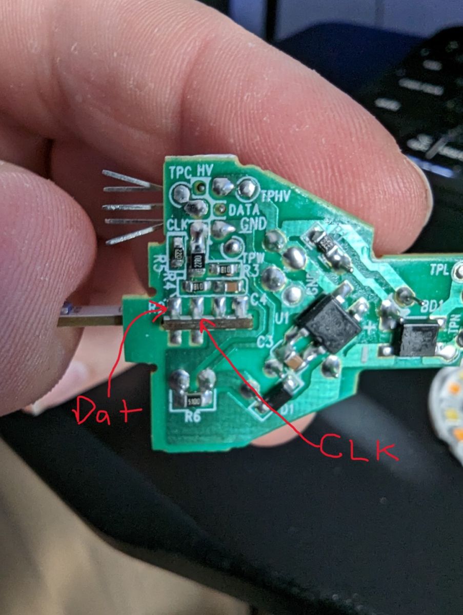

    Strangely, one of the bulbs did not work with pins 7 and 9. I got it to work briefly using pins 8(clk) and 9(dat). But now it won't light up again.
    I will do some more tinkering to figure this one out. I don't want to take this one apart since I already busted apart the one spare bulb I had.

    Do you have 2 MB dump?
    Latest flasher can extract Tuya config.
  • #7 20574042
    bobthemonkee
    Posts: 33
    Wow! That worked! I pulled the dump from the bulb I disassembled, put it in the flasher and it gave me the config and now the bulb works!
    You are awesome, thank you so much for everything you are doing!
