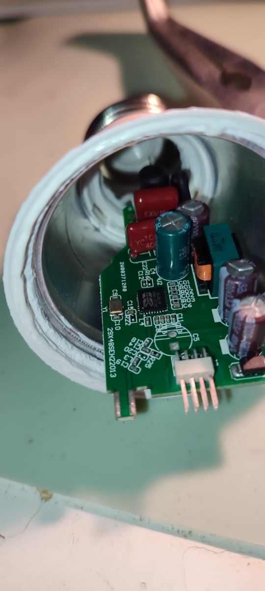

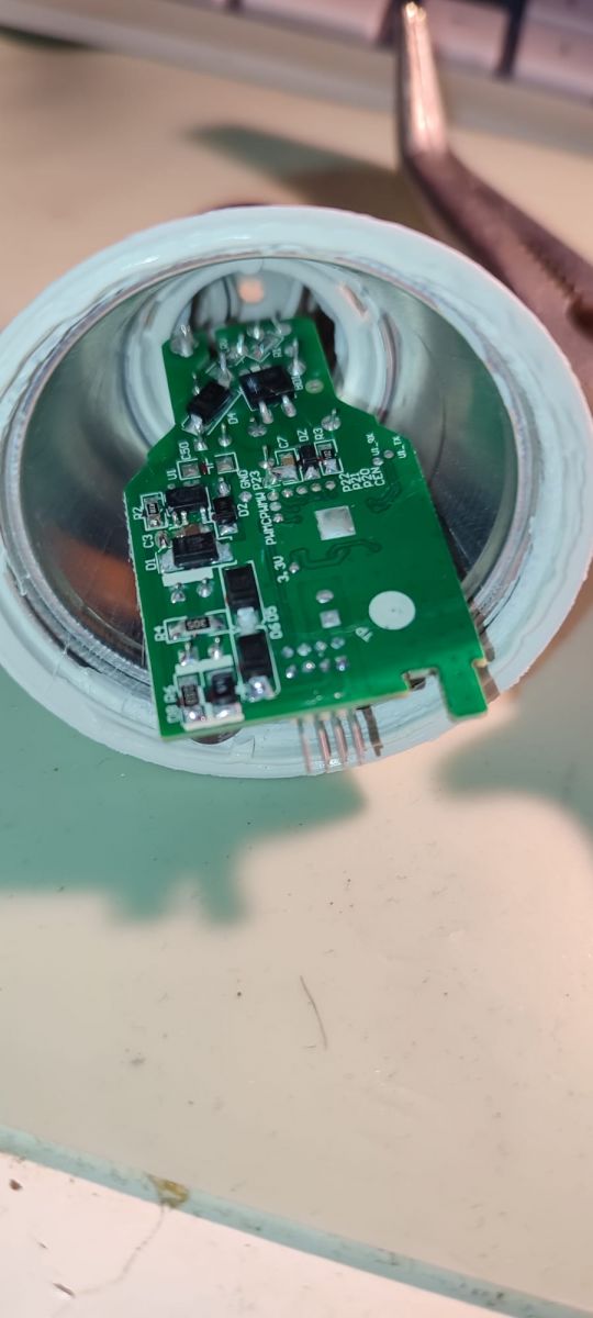

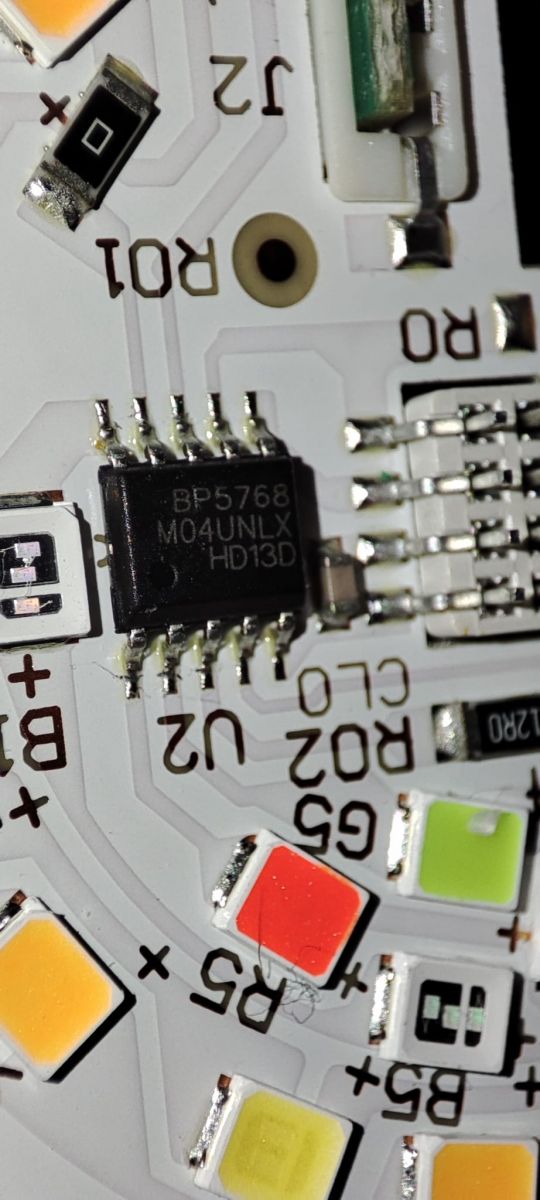

    Hello, I opened this RGBCW bulb from LSC and I found a BK7231T inside. I programmed it with openBK but now... I don't know how to control the LEDs. There is no usual LED controller, but this BP5768 with 10 pins instead of 8. I cannot find any information on it on the internet. Does anyone found this chip ?

    Hello, the first step is to determine whether it's possible to control your colours by raw PWMs, with no "i2c" drivers.
    BK7231 has 6 possible PWM pins:
    PWM0I/OGPIOP_6, which is connected to the P6 pin on the internal IC
    PWM1I/OGPIOP_7, which is connected to the P7 pin on the internal IC
    PWM2I/OGPIOP_8, which is connected to the P8 pin on the internal IC
    PWM3I/OGPIOP_9, common GPIO, which is connected to the P9 pin on the internal IC
    PWM4I/OGPIOP_24, common GPIO, which is connected to the P24 pin on the internal IC
    PWM5I/OGPIOP_26, which is connected to the P26 pin on the internal IC
    Considering that your bulb is RGBCW (so it requires 5 PWMs), if you set 5 of those pins roles to PWM, you should get some control and then you can work from there, see which channels are swapped.
    Please try. Or just apply some random PWM-based bulb template in Web App.
    Then double check - are you able to get any light at all? If no, then we can start worrying and assume that your bulb is using a custom "i2c" driver like SM2135 or SM2235.
    But it doesn't look like it - your photo is showing that there is 2x4 gold pin header going to LED board. That's whole 8 signals! So many signals are usually not needed for "i2c" drivers, that would suggest your LED is using just simply PWMs.

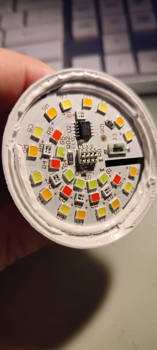

    Hello Kaszmarek, I tried all the PWM pins and no light at all... So I think it is I2C. The other 2 pins that you see next to the 2x4 connector are Antenna and Gnd.
    And on the BP5768 chip, 4 pins (let's say 3 because 2 are connected) are used for data, 1 and 8 are directly connected to the chip and from these 2 pins, there are 2 components both connected to pin 27. But those components look like capacitors... not 2 resistors to 3v3 for SDA and SCK... But maybe I'm wrong... I will measure them when I'm home.

    I can see PWMC and PWMW markings on the board...
    But according to this topic:
    https://www.elektroda.com/rtvforum/topic3947431.html
    BP5768 is seemingly possible to control with our BP5758 driver. Maybe it's some kind of chip variant, but with the same protocol. Can you try?

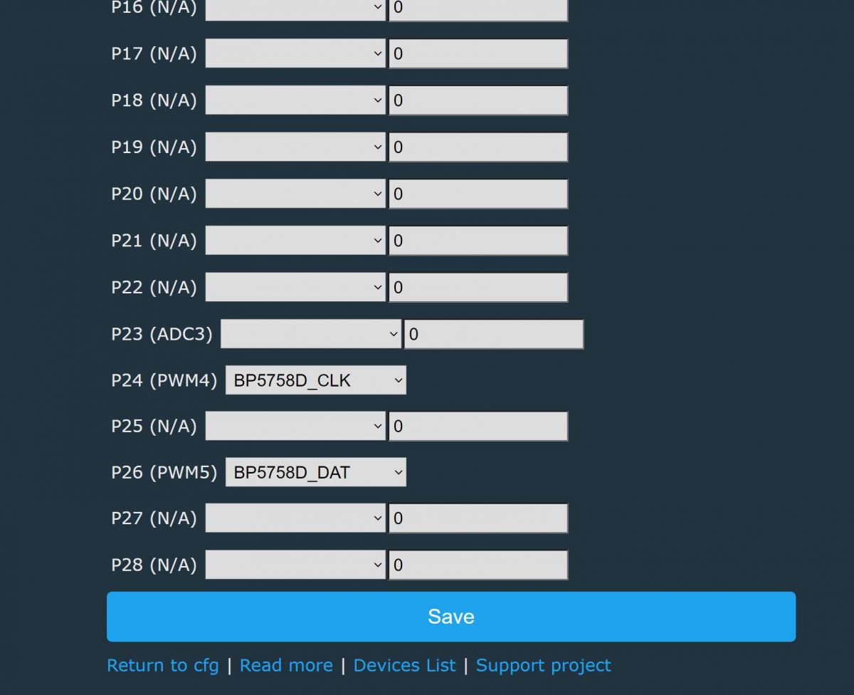

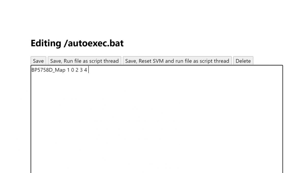

    Hello p.kaczmarek2, I changed the P24 to BP5758D_CLK and P26 to BP5758D_DAT.
    I saved that autoexec.bat to "BP5758D_Map 2 1 0 3 4", like in that example and now when I'm pressing Toggle light is working as Toggle, but the bulb color is green. The LED RGB COLOR picker is changing the brightness of the green color and if I'm changing something in the LED Temperature Slider the bulb turns off and nothing works anymore.
    I need to restart the bulb to be able to turn it on again.
    So I think I need to play with the BP5758D_Map but there are so many possible combinations...
    #6 20413376
    Posts: 14770
    Rate: 12911
    Wait, you don't have to do it randomly. Once you set something like "BP5758D_Map 2 1 0 3 4", and you know, that, for example, changing RED colour (index 0) changes blue (index 2), then you know that you have to swap 2 and 0 here....
  • #7 20415257
    keops50
    Posts: 6
    Thanks p.kaczmarek2, I changed the settings as in the photos attached and now is working ok.
