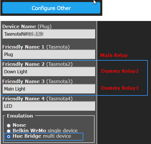

  • Hue emulation workaround for Alexa control of 3-gang switch
    #4 20623298
    jkwim
    Posts: 186
    Rate: 25
    As a workaround to make the 3-gang switch fully controllable from Alexa, I did the following:
    1. Switch 1 could be directly integrated with Alexa using Wemo driver (StartDriver Wemo)
    2. Used a smart plug running Tasmota with Hue Bridge Multiple Device Emulation
    a. Defined two Dummy Relays using spare GPIOs.
    b. They appear in Hue emulation page and gave some names
    OpenBeken DS-101JL 3-Gang Switch: Alexa Integration, Wemo Limitations & Hue Emulation
    Now the additional two devices can be discovered in Alexa.
    On Tasmota device, using scripting language, detected the POWER status of these Dummy Relays and triggered MQTT publish commands towards OpenBK 3-Gang switch for switch2 and switch3.
    So until Wemo Multi Device Driver is implemented I have a working setup for the 3-gang switch.

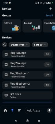

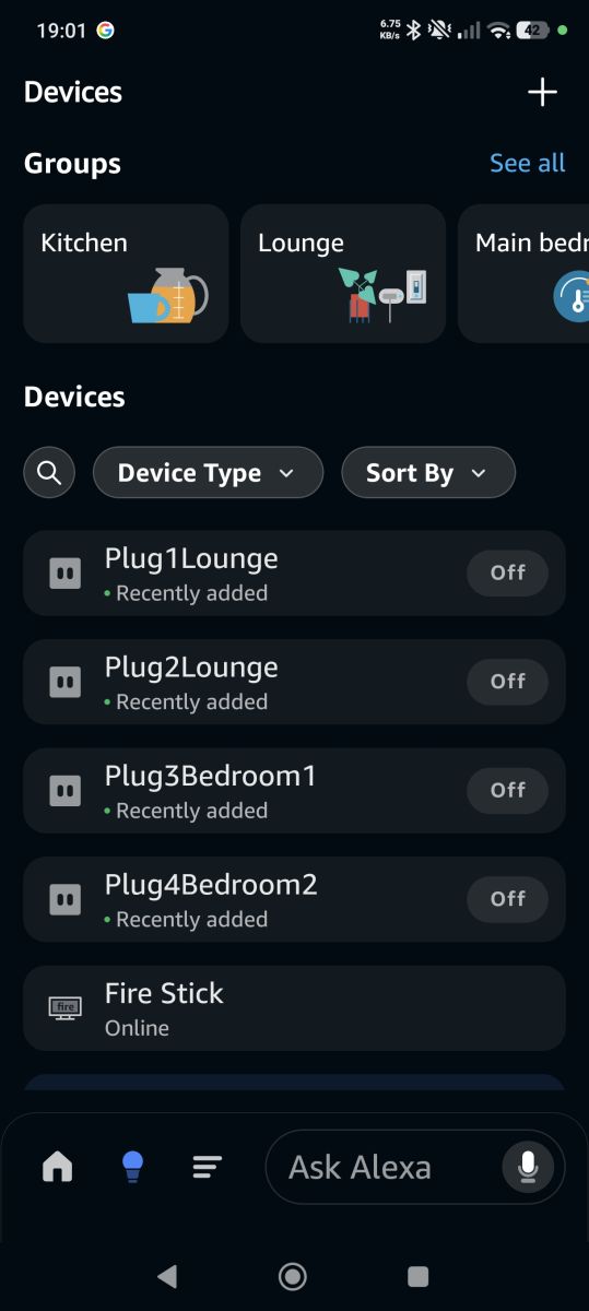

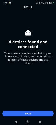

    I've been playing with the OpenBeken Wemo driver in an attempt to get multiple 'plugs' to be independently controllable from one physical device. I can get as far as detection of all configured rel/btn channels, but Alexa will always just toggle controls for the first channel.
    Alexa app screenshot showing devices Plug1Lounge, Plug2Lounge, Plug3Bedroom1, Plug4Bedroom2 with Off toggles Alexa app setup screen showing “4 devices found and connected” with a “Next” button.
    It can advertise multiple controllees, and Alexa will happily list multiple 'plugs', each with its own name. The problem shows up at the control layer: whichever plug I press in Alexa, the HTTP/SOAP requests arriving at OpenBeken always resolve to device/channel 1, so everything ends up toggling the first relay.
