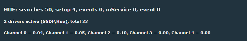

  • Hue driver log test for Alexa discovery
    #5 20629254
    Posts: 14793
    Rate: 12940

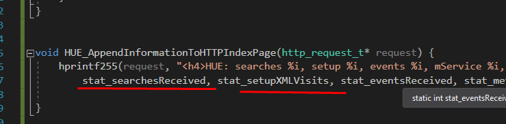

    Today I pushed the first part of the Hue driver. It is not finished and will not work, but you can check whether anything is received by doing:
    0. Make sure that Wemo is not running on your OBK. Of course, update your OBK.
    1. First, open the web app log.
    2. Then, clear it.
    3. Do the command "startDriver SSDP" and then "startDriver HUE."
    4. Start Hue/Alexa/anything discover.
    5. Copy here the web app log. Also, check the stats on the main www page. Is anything received?
    Alexa Identifies OpenBeken Downlights as Switches: Enabling Hue Option for Color Control
  • #6 20629572
    MnM1
    Posts: 175
    Rate: 13
    Hi,
    Thanks for looking at this.
    I have a question. In the log options which Log and Feature should I select?
    Also what log level?
    I have all selected now and I am losing log lines while waiting for discovery.
  • #7 20629604
    Posts: 14793
    Rate: 12940
    Log lines are only lost if you have two tabs open with Web App. Make sure you have only one web app tab open in your web browser.
    Try the broadest log level.

    Info:MAIN:Time 1606, idle 247337/s, free 81352, MQTT 1(1), bWifi 1, secondsWithNoPing 1, socks 3/38
    Info:MAIN:Time 1607, idle 251270/s, free 81352, MQTT 1(1), bWifi 1, secondsWithNoPing 1, socks 3/38
    Info:MAIN:Time 1608, idle 243878/s, free 81352, MQTT 1(1), bWifi 1, secondsWithNoPing 1, socks 3/38
    Info:MAIN:Time 1609, idle 245645/s, free 81352, MQTT 1(1), bWifi 1, secondsWithNoPing 1, socks 3/38
    Info:MAIN:Time 1610, idle 246895/s, free 81352, MQTT 1(1), bWifi 1, secondsWithNoPing 1, socks 3/38
    Info:GEN:dhcp=0 ip=172.50.1.1 gate=172.50.255.254 mask=255.255.0.0 mac=a0:92:08:83:a7:fd
    Info:GEN:sta:rssi=-46,ssid=DPIWIFIII_slow,bssid=ac:8b:a9:be:5b:39,channel=1,cipher_type:CCMP
    Info:MAIN:Time 1611, idle 242692/s, free 81352, MQTT 1(1), bWifi 1, secondsWithNoPing 1, socks 3/38
    Info:MAIN:Time 1612, idle 239293/s, free 81352, MQTT 1(1), bWifi 1, secondsWithNoPing 1, socks 3/38
    Info:MAIN:Time 1613, idle 246974/s, free 81352, MQTT 1(1), bWifi 1, secondsWithNoPing 1, socks 3/38
    Info:MAIN:Time 1614, idle 243803/s, free 81352, MQTT 1(1), bWifi 1, secondsWithNoPing 1, socks 3/38
    Info:MAIN:Time 1615, idle 487914/s, free 81352, MQTT 1(1), bWifi 1, secondsWithNoPing 1, socks 3/38
    Main page shows this:
    Hope this was what you were looking for.

    Well, it receives both searches and setups, so far my code must be working good. I can proceed now and work more on the hue support.
