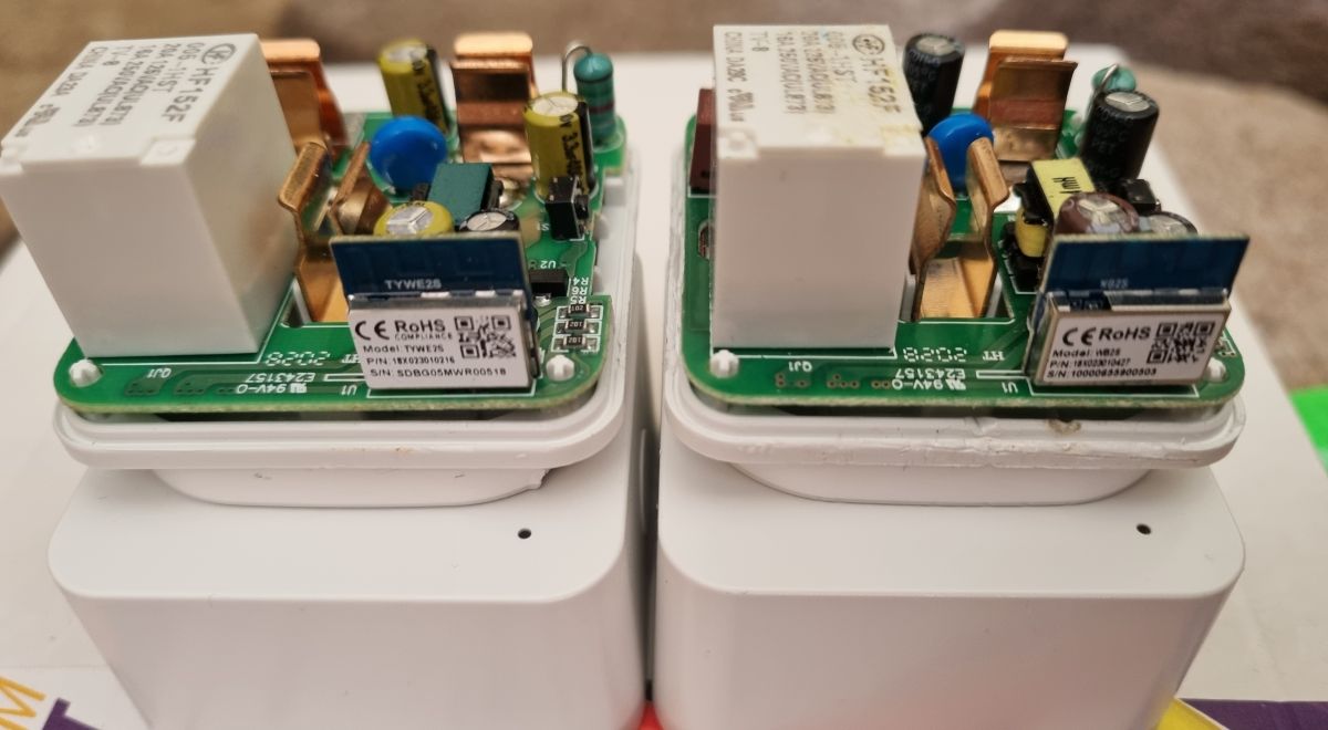

    Avoid opening if possible, but Poundland still have TYWE2S on shelves in exactly the same packaging as new stock which are WB2S based
    Plug it in and scan Wifi for nearby clients, or put in AP-mode to make it more visible and even connect to it.
    Looking for the MAC, the ESP based devices
    D4:A6:51:XX:XX:XX = Tuya Smart Inc. (WB2S)
    50:02:91:XX:XX:XX = Espressif Inc. (TYWE2S)
    Opening is not too difficult but it is plastic and easily deformed. Start with craft knife or finger nail hearing "cracking" noise asyou go all the way around.
    Ultrabrite Smart Wifi Plug [BK7231T] [WB2S] UK Poundland Purchase: Comparing TYWE2S and WB2S
    Inside the all versions are identical apart from the chip:

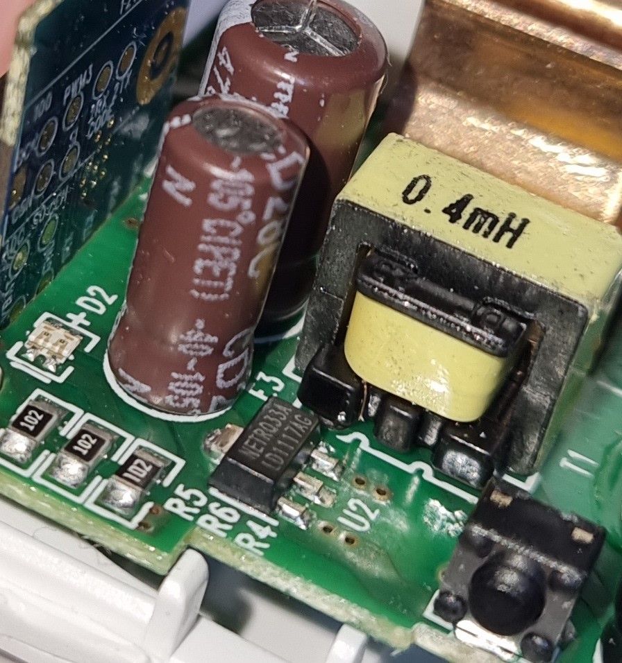

    LD1117AG Voltage Regulator, transformer, capacitors and the backside of a WB2S

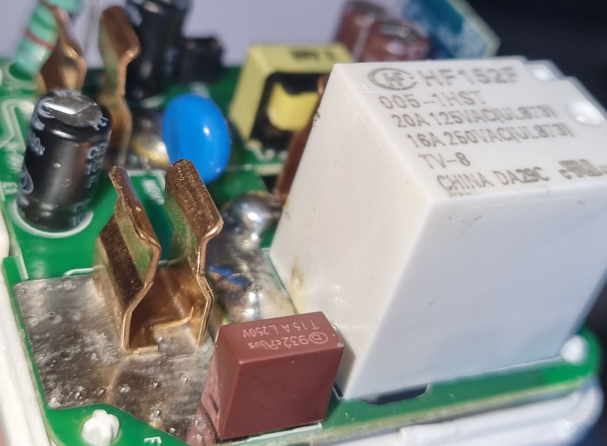

    HEL-7D471K Varistor, HF152F Relay, 3.3uF Cap between the Live and Neutral, is that for filtering?

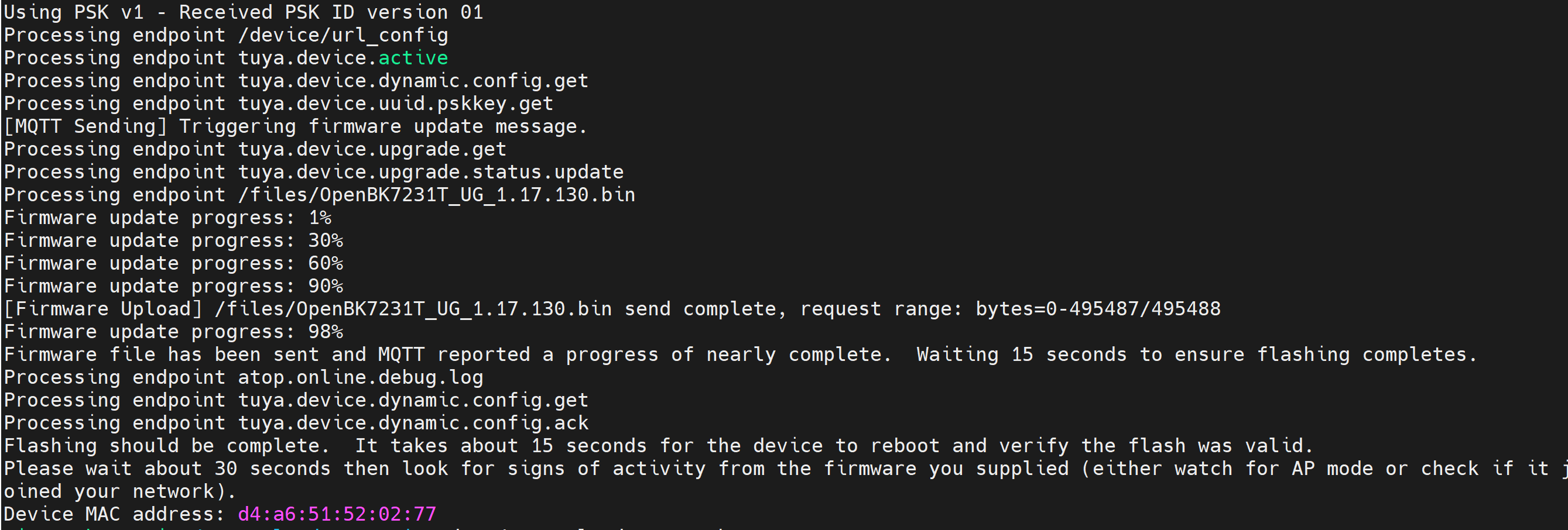

    Flashing the WB2S is easiest with tuya-cloudcutter and is now added to profiles as By manufacturer/device name Ultrabrite

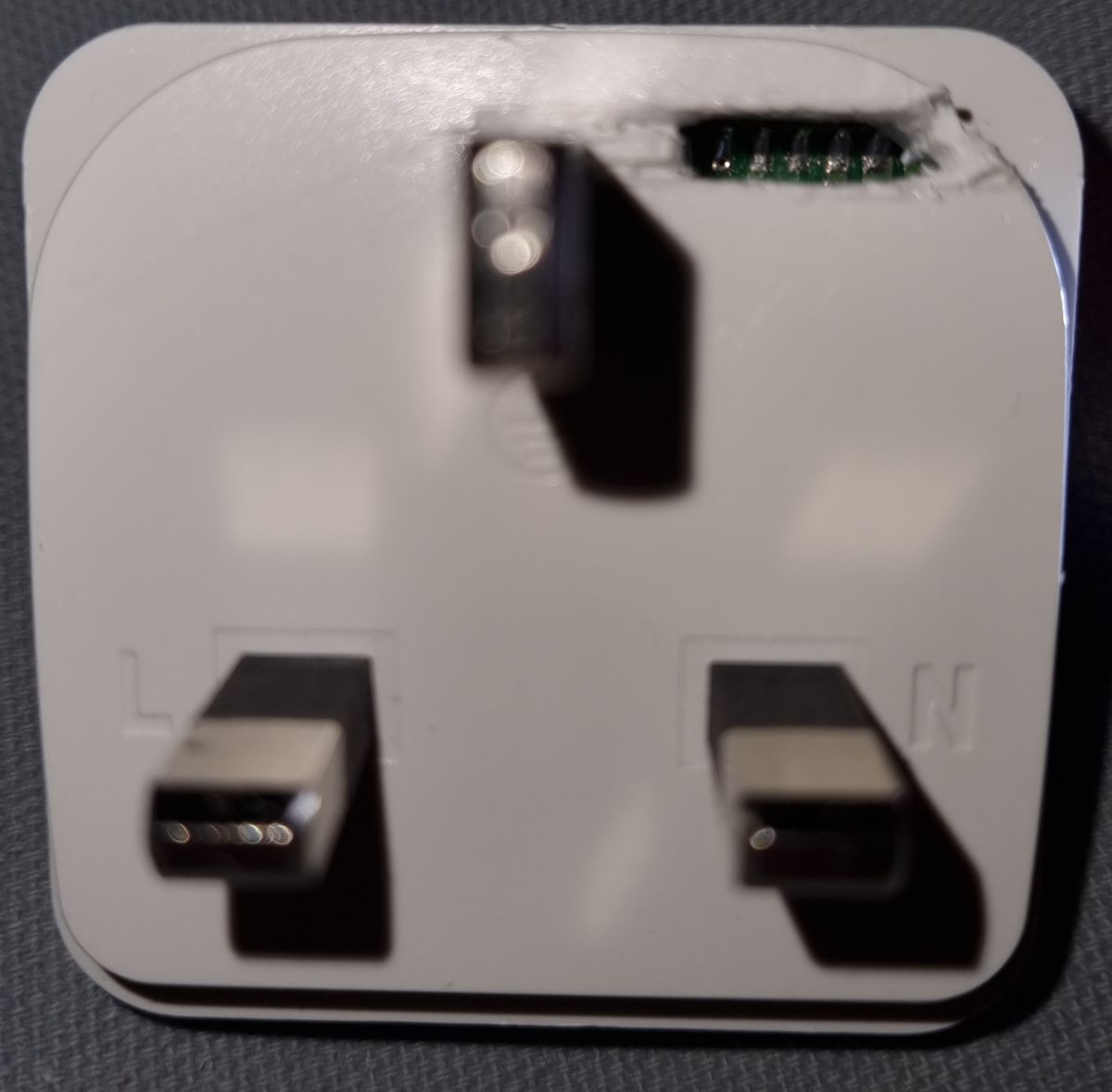

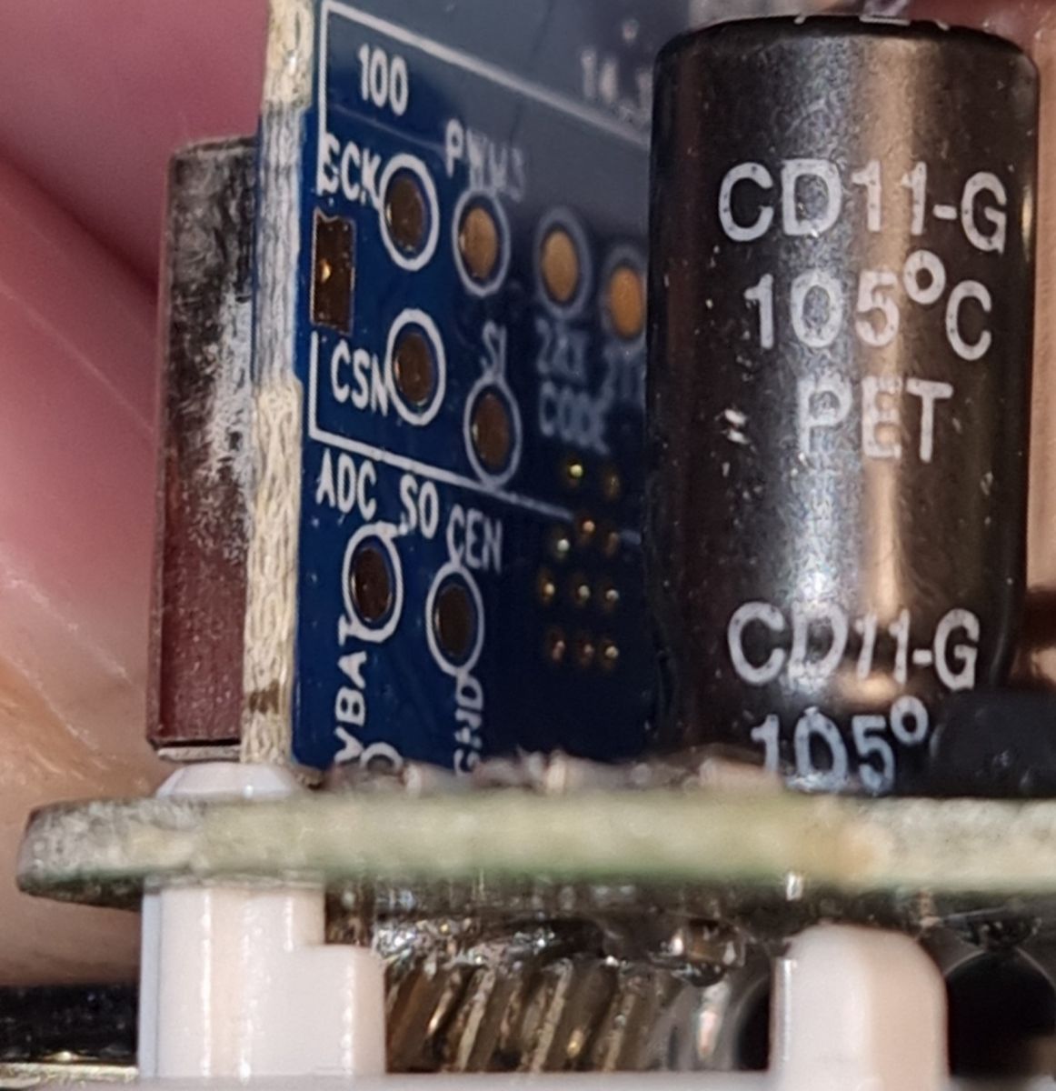

    If you need to flash by serial then you either have de solder the main plug pins (Live and Neutral) to allow the pcb to be removed.
    Or cut a hole in the bottom of the plastic case:

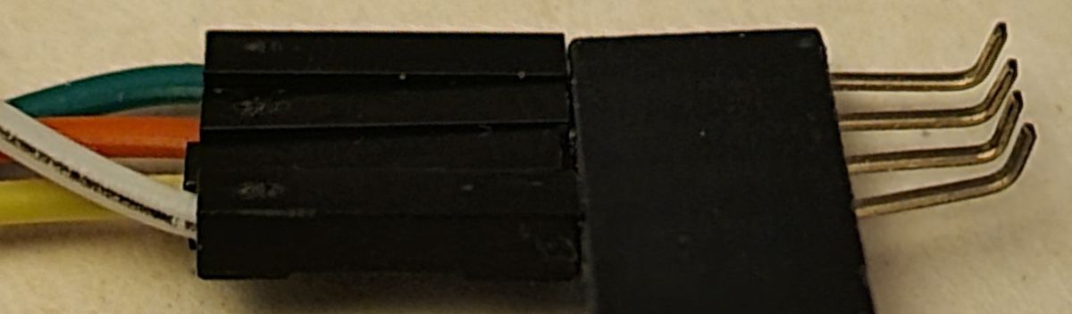

    or use a bent pin header to blindly reach around the back of the WB2S
    Ultrabrite Smart Wifi Plug [BK7231T] [WB2S] UK Poundland Purchase: Comparing TYWE2S and WB2S Ultrabrite Smart Wifi Plug [BK7231T] [WB2S] UK Poundland Purchase: Comparing TYWE2S and WB2S

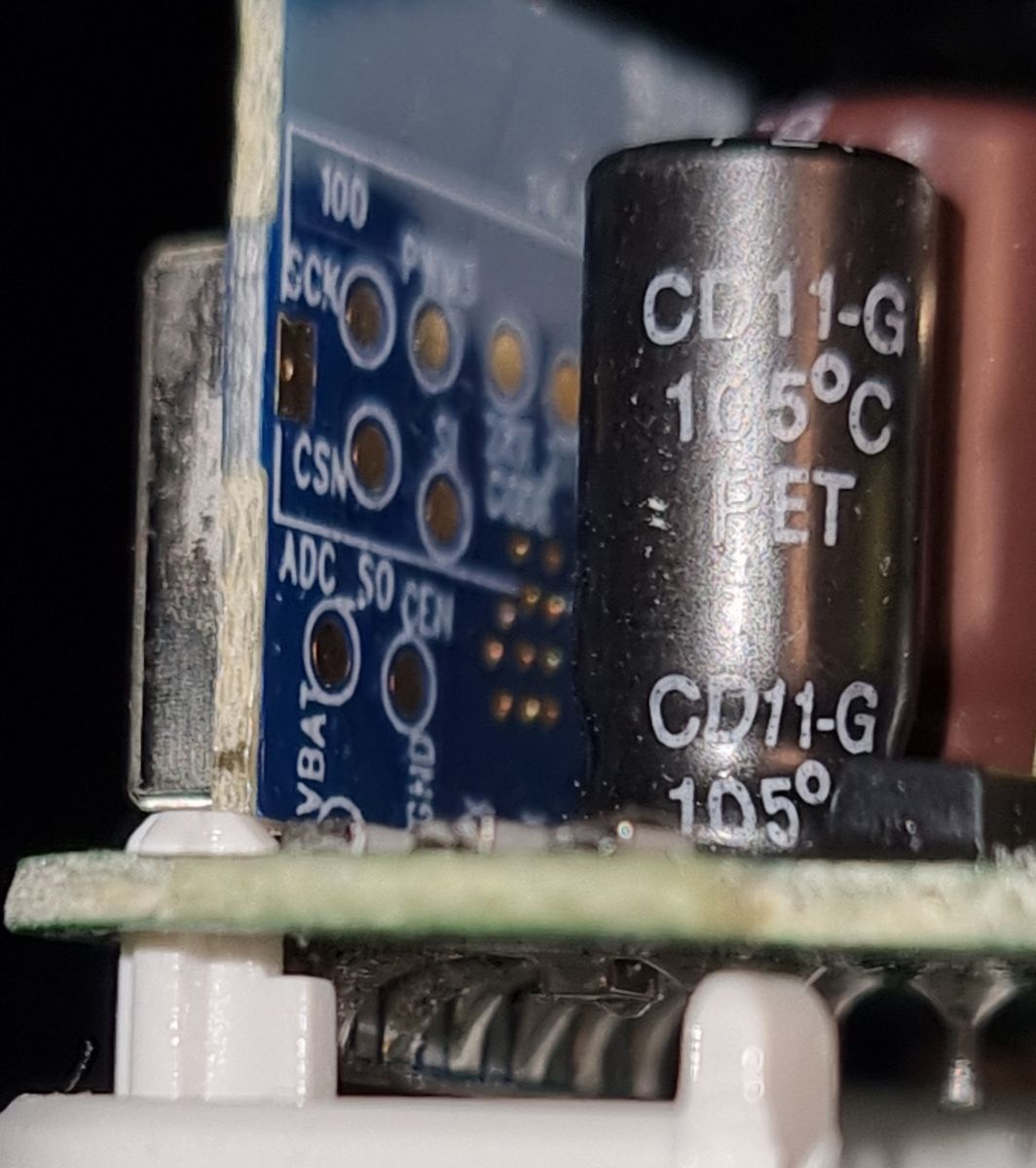

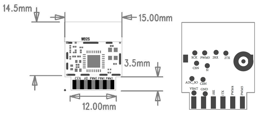

    To flash by serial, you need to connect to the 4 pins on the backside and briefly ground the CEN pin, there's one on front and another on the back...

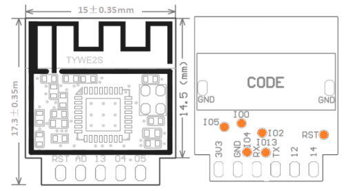

    the TYWE2S version has the "same" pinout:

    Cutting hole in case to get access to programming interface is a very good trick, I have already used it in the case NAS-WR01W/NAS-WR07W plugs:
    https://www.elektroda.com/rtvforum/topic3917832.html

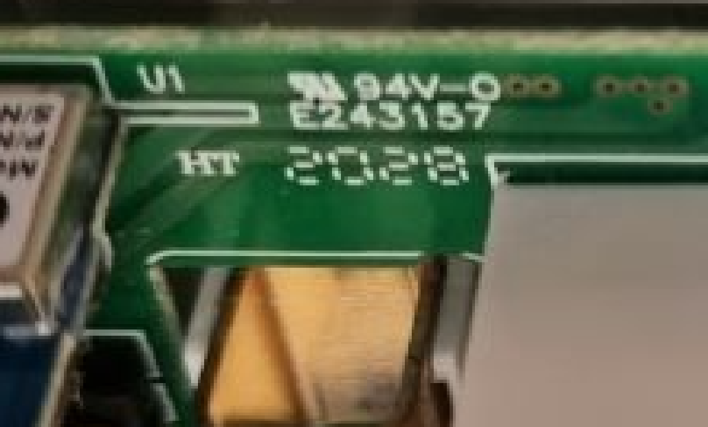

    Are there any date codes on the PCB or case, or the packaging? Are they the same in case of both versions?
  • #3 20601367
    baukje
    Posts: 27
    Both plugs are identical, the PCB has all the same markings. is this a date code?
