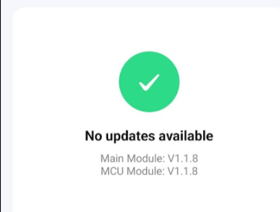

    Came with v1.1.8 firmware and was successful with Tuya-Cloudcutter "1.1.8 - BK7231T / oem_bk7231s_rnd_switch" profile.

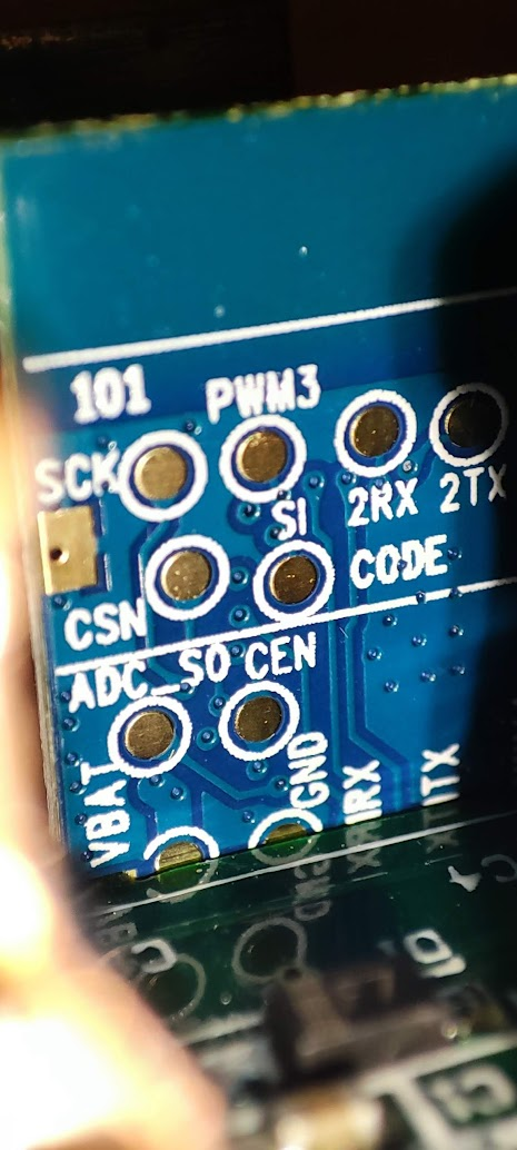

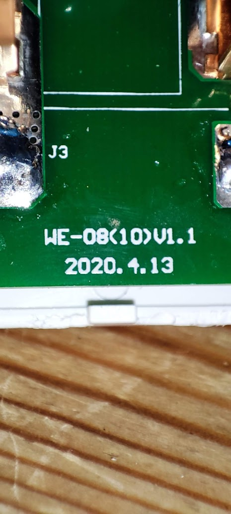

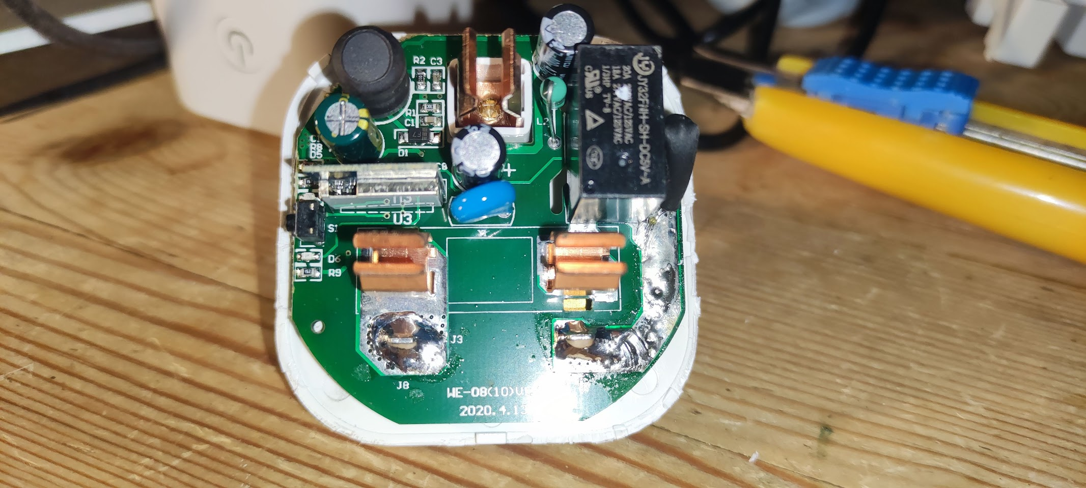

    WE-08(10)V1.1 2020.4.13 PCB

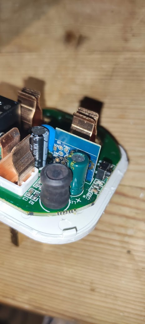

    I did open the unit to check on similarities (it was a pig to unglue). I did not want to be too destructive so didn't dump firmware.

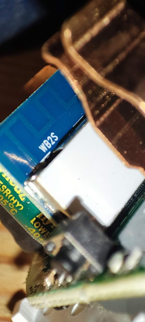

    Apart from some silk screening on WB2S, it looked to be the same.
    Update screen message indicating no updates available, with main module and MCU version V1.1.8.

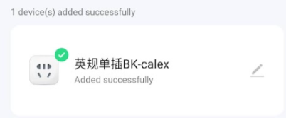

    Notification of successful addition of BK-calex device. Close-up of the interior of an electronic device with a visible printed circuit board and components.
    Close-up of a PCB marked WE-08(10)V1.1 dated 2020.4.13, with electronic components.
    Close-up of PCB labeled WE-08(10)V1.1 with date 2020.4.13.
    Close-up of a PCB with a WB2S module.
    Close-up of the inside of an electronic device, showing markings on the PCB.

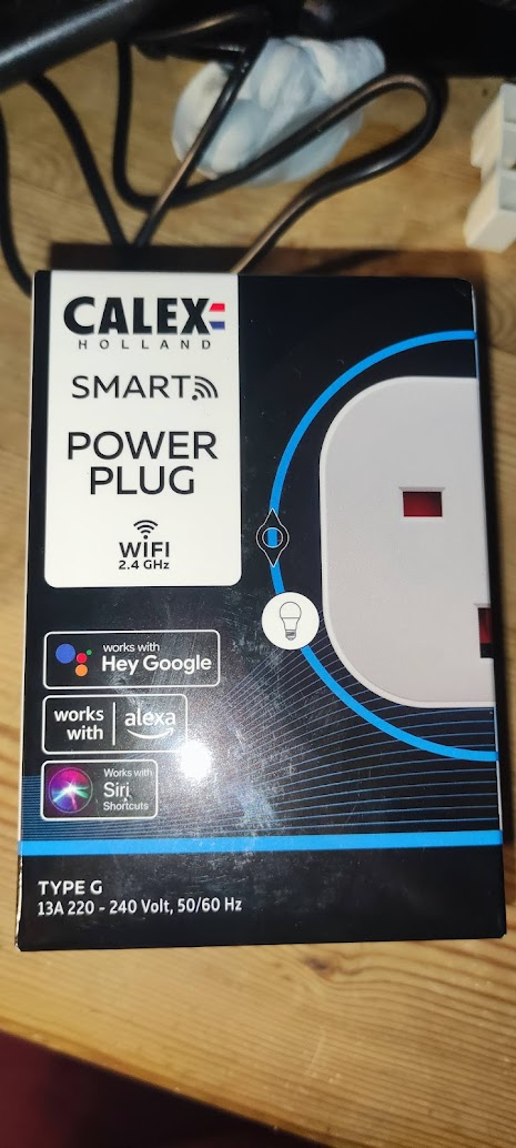

    Calex product packaging with article number 5202000300.
    Box of Calex Smart Power Plug, type G, supporting integration with voice assistants.
    I've used @btsimonh bin file to check OBK config
    - Button (channel 1) on P6
    - LED (channel 1) on P8
    - WiFi LED on P7
    - Relay (channel 1) on P24
    All works, apart from when the plug is on the blue AND red LED is lit, red only when off. Unless that's how it's supposed to be, I didn't try it before cloudcutter. This looks to the same gpio config as the two LSC UK plugs and the other two Calex plugs already in the supported device list.
    Anyway, it's an easy OpenBeken convert for anyone in the UK wondering about these Calex devices at Tesco. I used some Clubcard vouchers so got it for PLN3 in the end.

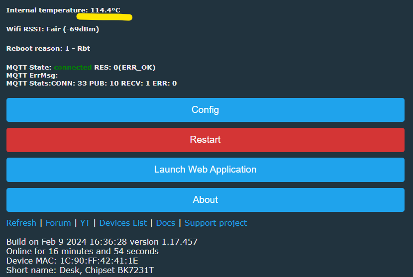

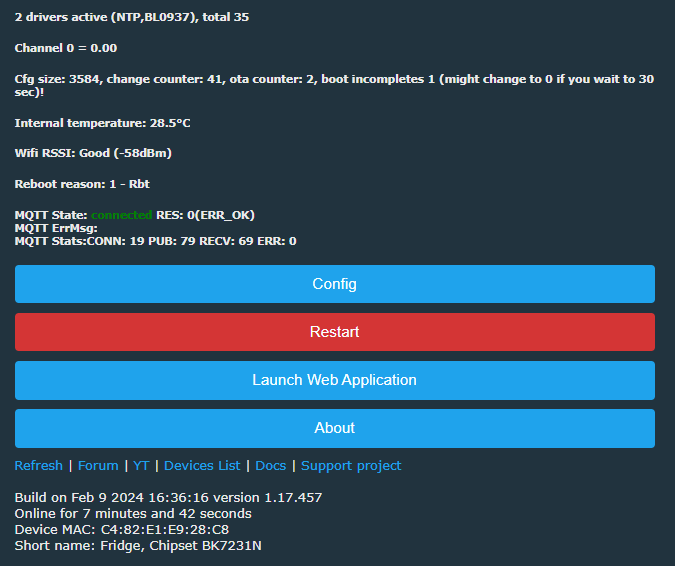

    hmm, thank you for adding temps for BK devices. not sure BK7231T is OK tho.
    This T plug is physically next to this N
    Screenshot of a device interface showing high internal temperature of 114.4°C and other system information.
    Screenshot displaying the status of a device with BK7231N chipset.
    all other N devices are within expected similar temps around the house
