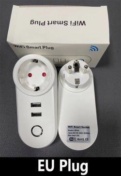

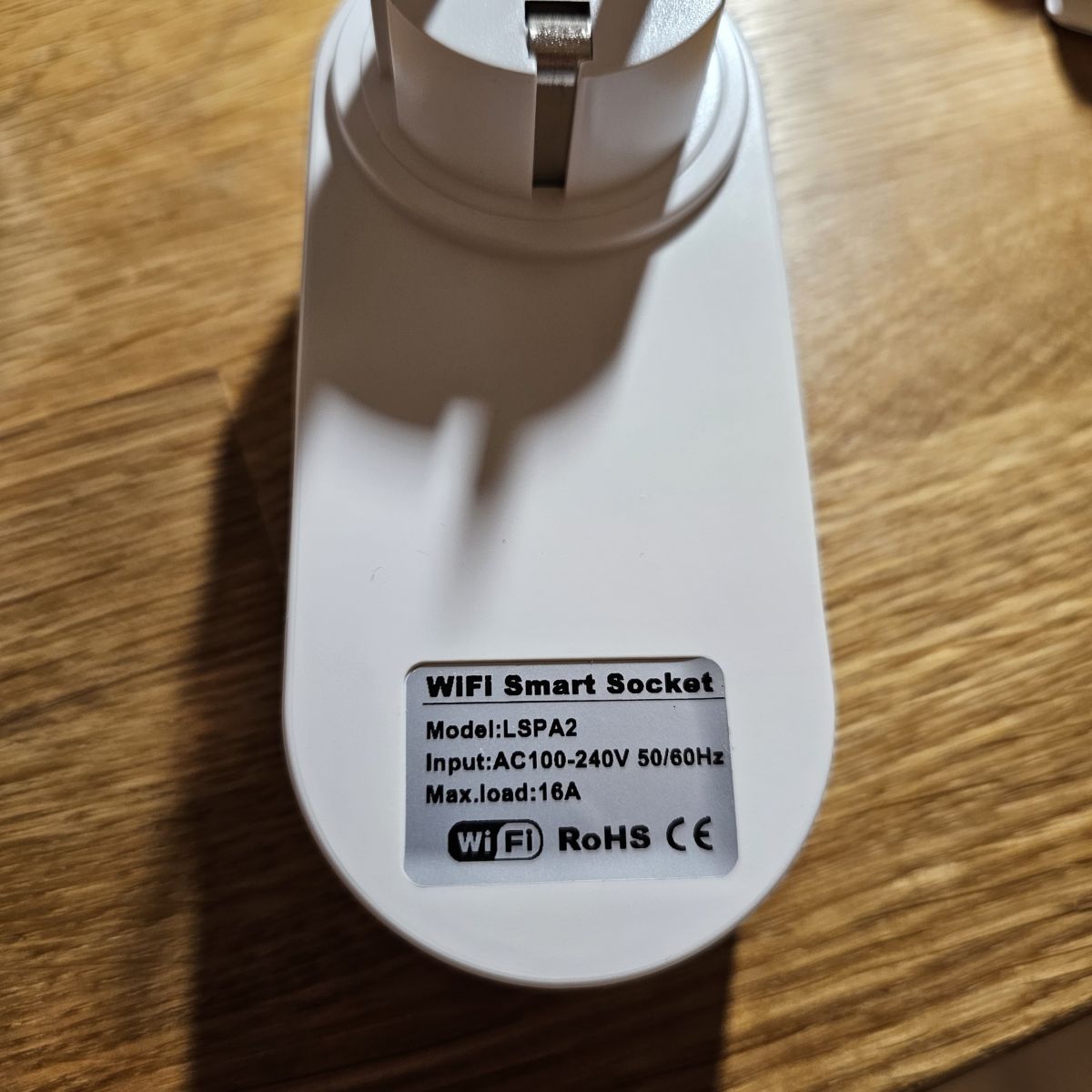

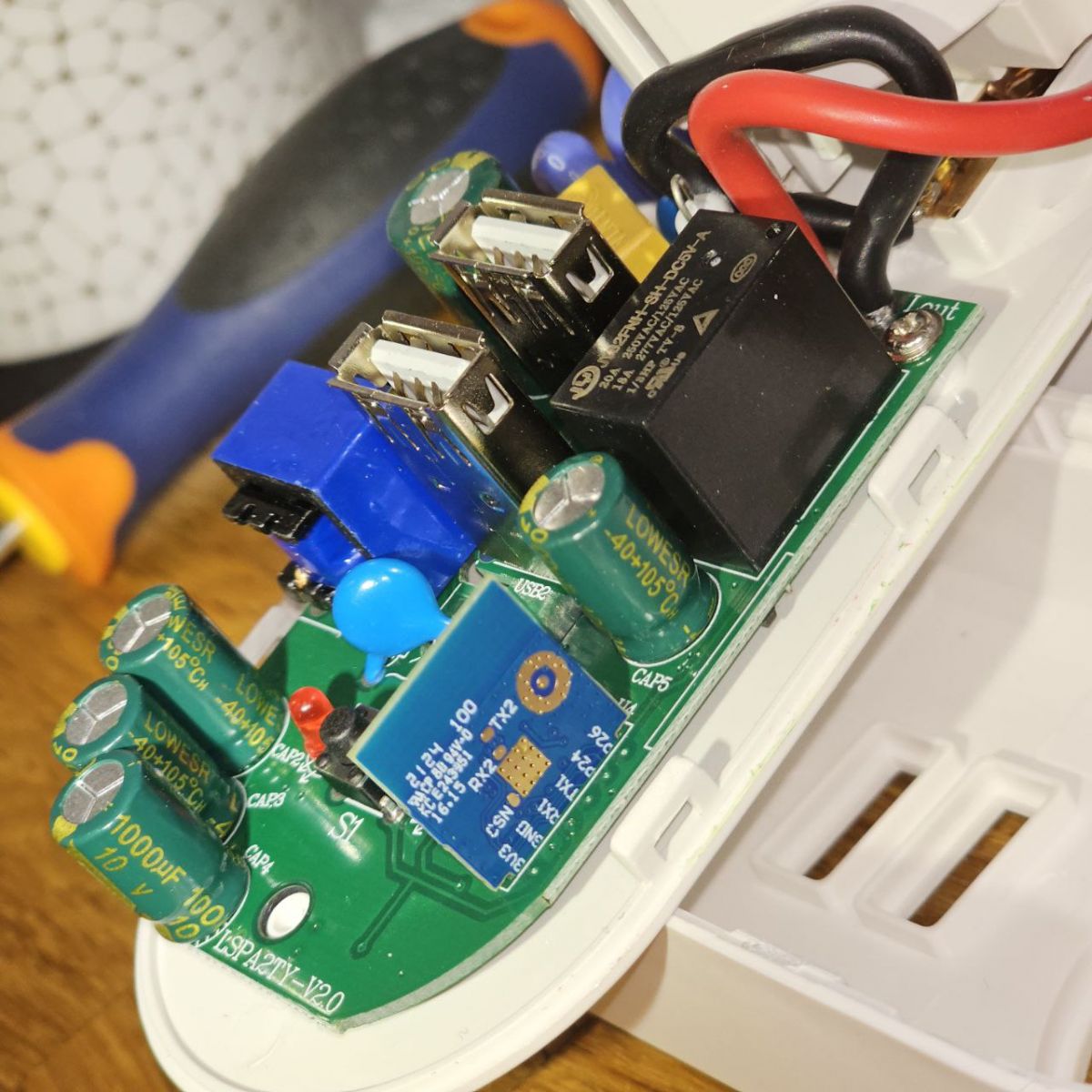

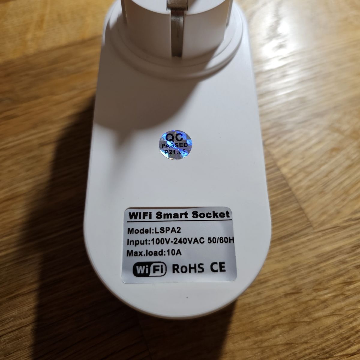

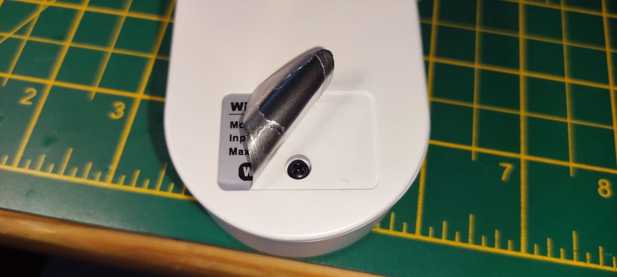

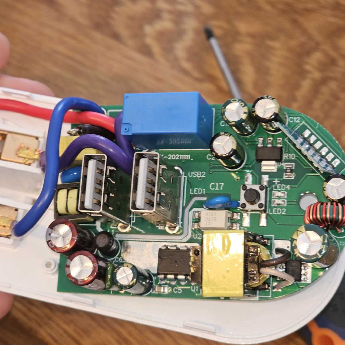

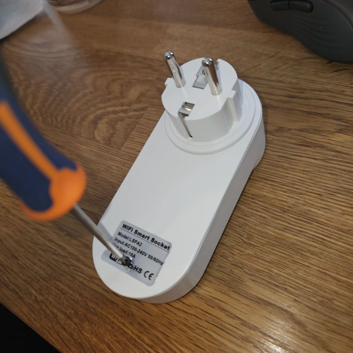

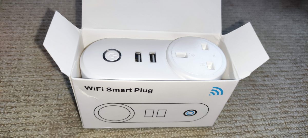

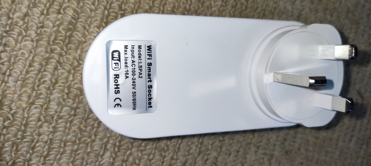

    [BK7231N/BK7231T/CB2S] Tuya LSPA2 Wi-Fi Smart Plug 16A ЕС AU UK + 2.1A Dual independent USB [BK7231N/BK7231T/CB2S] Tuya LSPA2 Wi-Fi Smart Plug 16A ЕС AU UK + 2.1A Dual independent USB [BK7231N/BK7231T/CB2S] Tuya LSPA2 Wi-Fi Smart Plug 16A ЕС AU UK + 2.1A Dual independent USB [BK7231N/BK7231T/CB2S] Tuya LSPA2 Wi-Fi Smart Plug 16A ЕС AU UK + 2.1A Dual independent USB [BK7231N/BK7231T/CB2S] Tuya LSPA2 Wi-Fi Smart Plug 16A ЕС AU UK + 2.1A Dual independent USB
    A new version of a similar BSD31 smart socket. It differs in that both USB ports are controlled independently and the BK7231N chip is used, not T.
    When buying, the firmware version 1.1.8 is installed on the smart socket.
    I installed the OpenBK7231N firmware using tuya-cloudcutter installed on Raspberry 3 with Raspberry PI OS.
    I chose hack "By firmware version and name": "1.1.8 - BK7231N / oem_bk7231n_plug"
    or download last firmware file OpenBK7231N_UG_1.17.135.bin to /tuya-cloudcutter/custom-firmware and run:
    sudo ./tuya-cloudcutter.sh -r -p "mirabella-genio-i004527-double-plug" -f "OpenBK7231N_UG_1.17.135.bin"
    Hacking occurs according to the instructions, from the second pass. After that, the device gives the impression of being broken, the indicators are not lit, the buttons are not pressed, but it is working. You can connect to the OpenBK7231N_MAC Wi-Fi network and configure the device by URL http://192.168.4.1/.

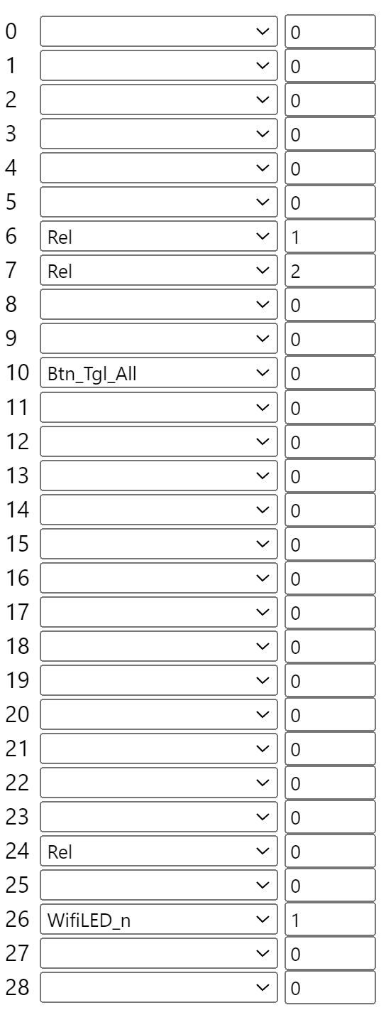

    ClearIO // clear old GPIO/channels
    lfs_format // clear LFS
    StartupCommand ""  // clear STARTUP
    stopDriver *  // kill drivers
    backlog setPinRole 6 Rel; setPinChannel 6 1
    backlog setPinRole 7 Rel; setPinChannel 7 2
    backlog setPinRole 10 Btn_Tgl_All; setPinChannel 10 0
    backlog setPinRole 24 Rel; setPinChannel 24 0
    backlog setPinRole 26 WifiLED_n; setPinChannel 26 1

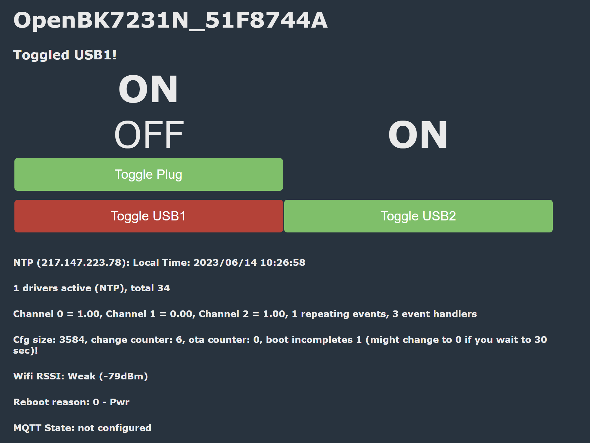

    setChannelLabel 0 Plug
    setChannelLabel 1 USB1
    setChannelLabel 2 USB2
    Flags 1024

      "pins": {
        "6": "Rel;1",
        "7": "Rel;2",
        "10": "Btn_Tgl_All;0",
        "24": "Rel;0",
        "26": "WifiLED_n;1"
    AgranBox
    Level 4  
    AgranBox wrote 5 posts with rating 2. Been with us since 2023 year.
  • Requesting Tuya config and USB current test

    That's the first device with independent USB port control that I've ever seen. Have you considered using:
    to give them some better display names on UI? See our docs:
    Also, have you checked USB current capability of the port?
    Can you attach Tuya config partition binary, extracted as shown here:
    https://www.youtube.com/watch?v=WunlqIMAdgw&ab_channel=Elektrodacom

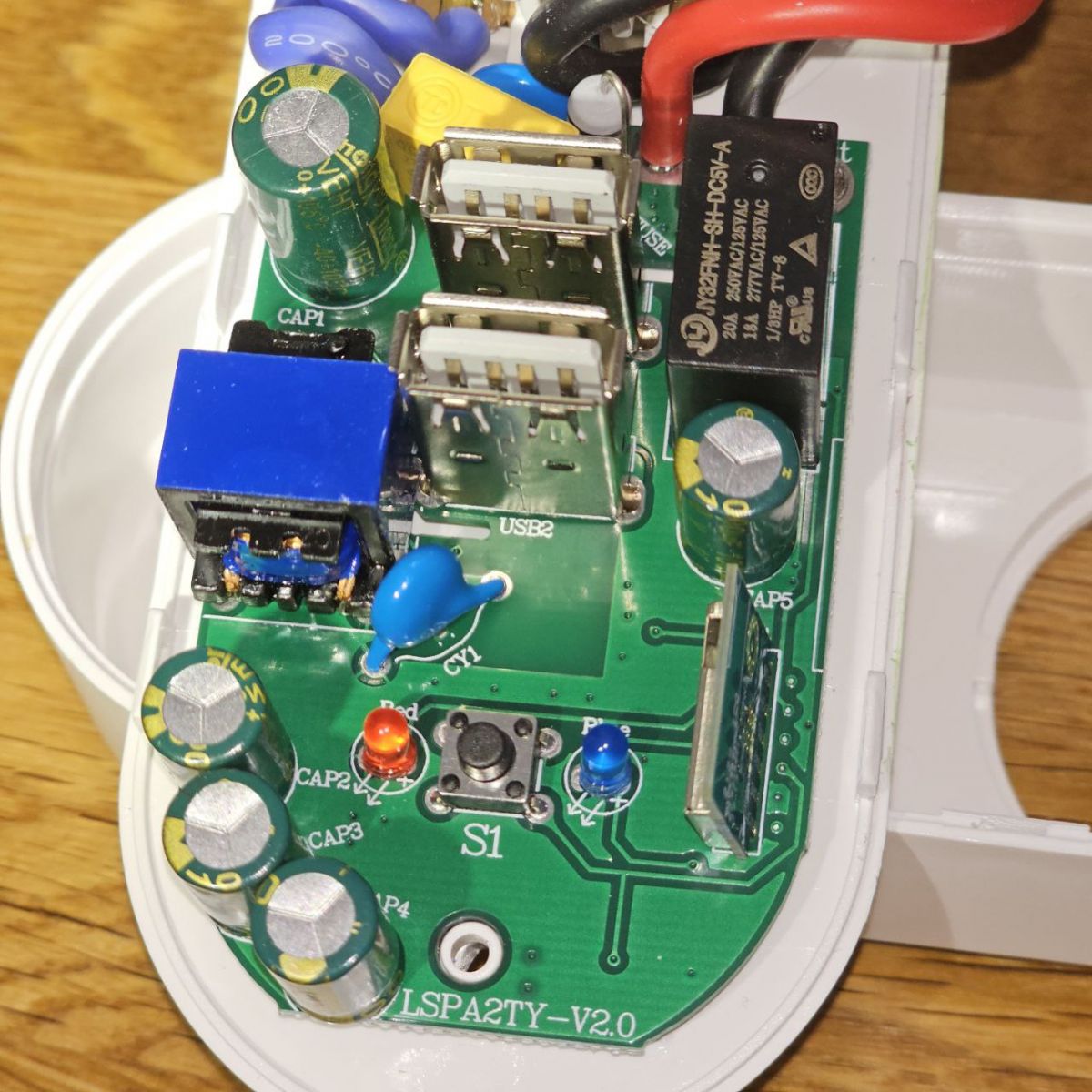

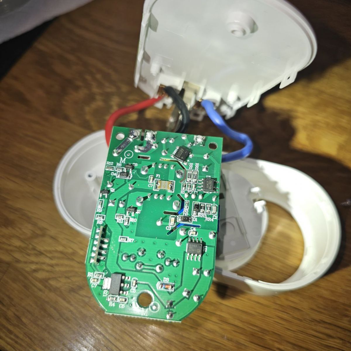

    Here's what I extracted:
    - Relay (channel 3) on P7
    - Pair/Toggle All Button on P10
    - WiFi LED on P26
    - Relay (channel 2) on P6
    - Relay (channel 1) on P24
    Device seems to be using CB2S module, which is using BK7231N.
    And the Tuya section starts at UNCOMMON POSITION 0
    so it's CB2S module! Good to know.

    First I installed the firmware ESPHome-Kickstart-v23.04.28_bk7231n_app.ota.ug.bin and there were problems with switching to OpenBK7231N.
    No OpenBK7231N firmware was installed via the web interface. Then I converted the firmware with the ltchiptool utility
    python -m ltchiptool uf2 write -b cb2s -o openbkt.uf2 OpenBK7231N_1.17.135.rbl=device:download
    The resulting file is openbkt.uf2 https://disk.yandex.ru/d/f0mC-pO2o4wSow
    It worked!

    I also prepared an autoexec.bat file so that the device reboots every day at 7 am. And also when you press the button, it turns off the ports for 3 seconds and turns on again. This is necessary to reboot connected devices, which sometimes freeze.
    autoexec.bat
    startDriver NTP
    ntp_timeZoneOfs 3:00
    addClockEvent 07:00 0xff 1 reboot
    addChangeHandler Channel0 == 0 addRepeatingEvent 3 1 setChannel 0 1
    addChangeHandler Channel1 == 0 addRepeatingEvent 3 1 setChannel 1 1
    addChangeHandler Channel2 == 0 addRepeatingEvent 3 1 setChannel 2 1
    setChannel 0 0
    setChannel 1 0
    setChannel 2 0
    delay_s 3
    setChannel 0 1
    setChannel 1 1
    setChannel 2 1

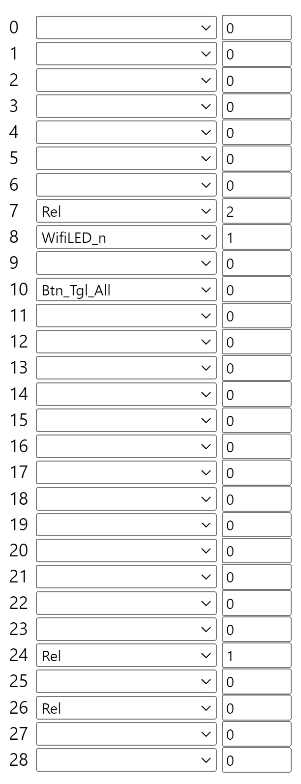

    I have another socket, this time on a different chip BK7231T. It had firmware 1.0.7.
    For the firmware I used this command:
    sudo ./tuya-cloudcutter.sh -r -p "tuya-generic-bsd31-16a-smart-plug"
    BK7231T_TuyaConfig_obk76B4542B.bin https://disk.yandex.ru/d/_m2-j_fxf9qeug
    All these devices have independent control of each USB port. But the channel settings are slightly different, different from the first socket.
    backlog setPinRole 8 WifiLED_n; setPinChannel 8 1
    backlog setPinRole 24 Rel; setPinChannel 24 1
    backlog setPinRole 26 Rel; setPinChannel 26 0
    Flags 1024

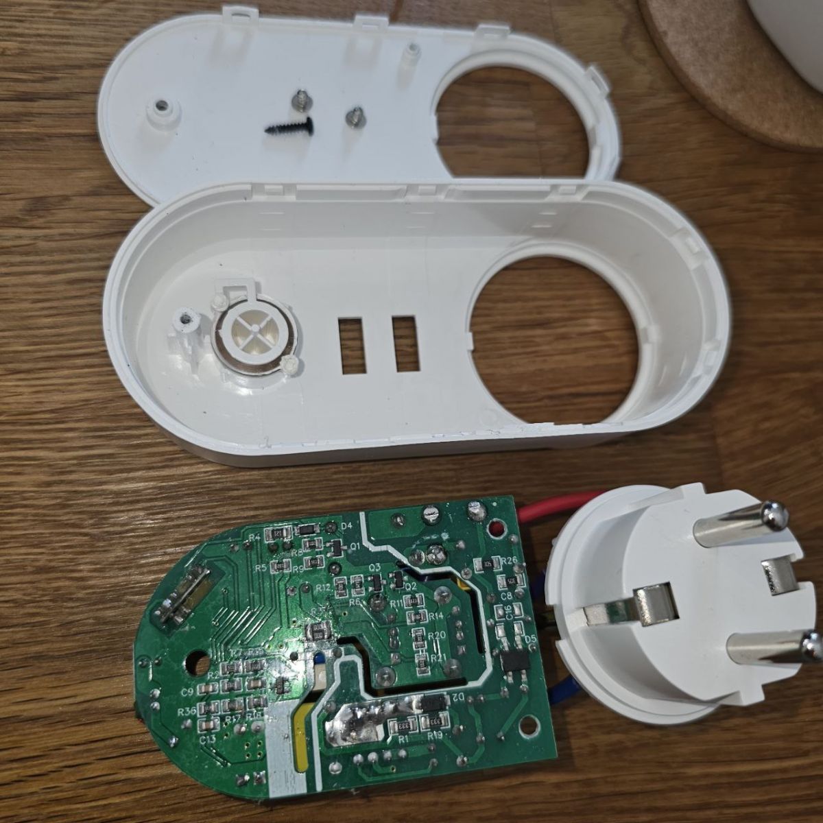

    These two smart sockets do not have LEDs showing the operation of each USB port, as in the socket from the first post.

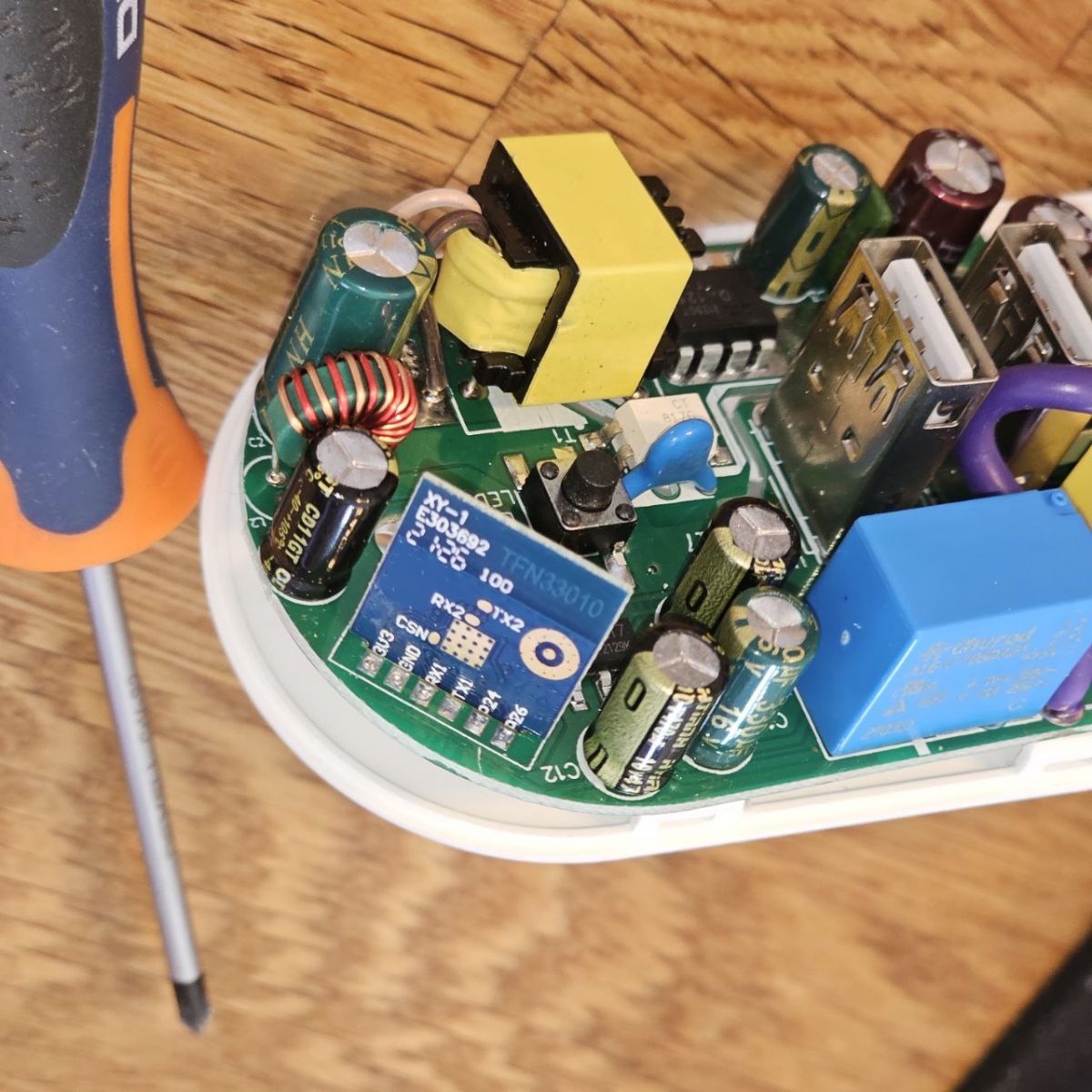

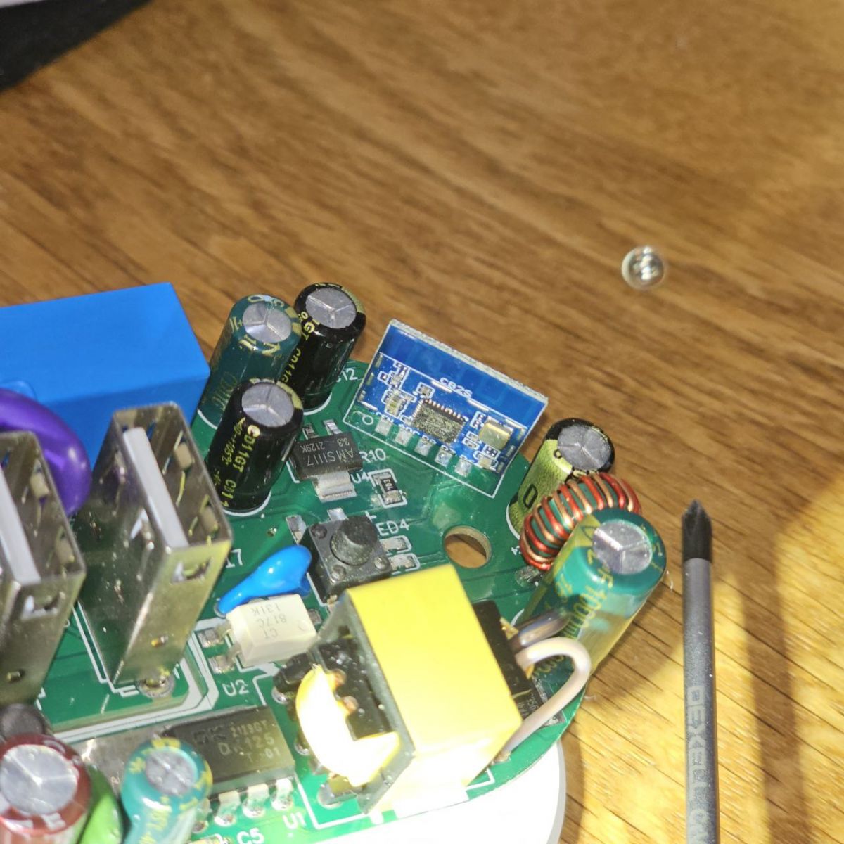

    #7 21006754
    Posts: 5212
    Help: 446
    Rate: 914

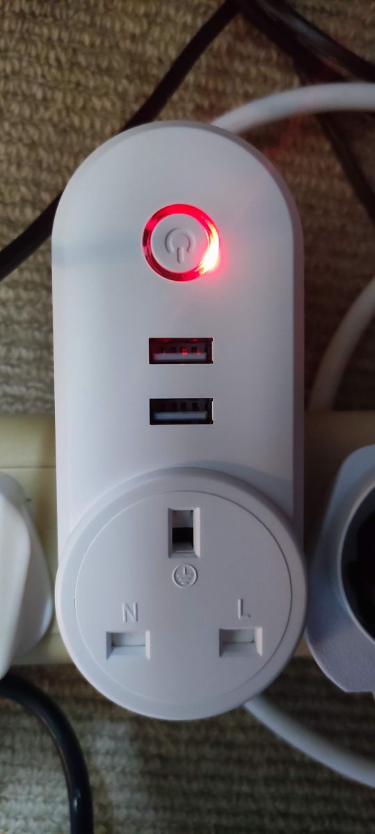

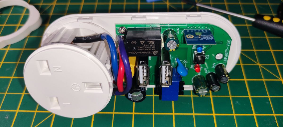

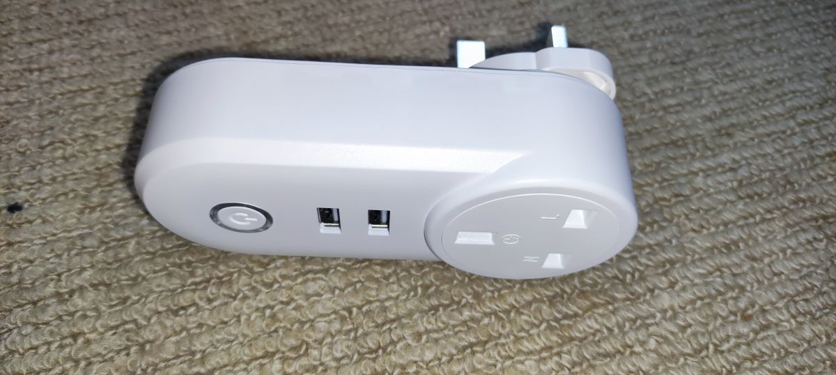

    I got one too. It matches the second variant.
    Boot output
    JSON
    Tuya API return

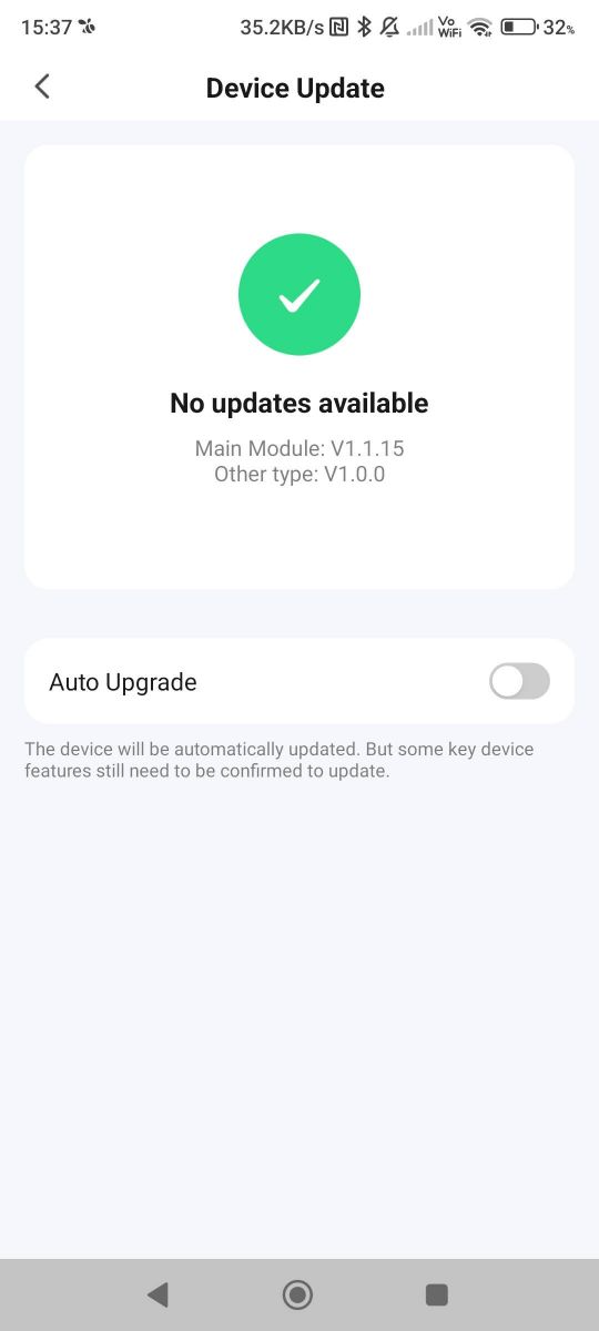

    factory fw attached. UK version hardware. Firmware v1.1.15 is no good for Cloudcutter. Some piccies:
    [BK7231N/BK7231T/CB2S] Tuya LSPA2 Wi-Fi Smart Plug 16A ЕС AU UK + 2.1A Dual independent USB [BK7231N/BK7231T/CB2S] Tuya LSPA2 Wi-Fi Smart Plug 16A ЕС AU UK + 2.1A Dual independent USB [BK7231N/BK7231T/CB2S] Tuya LSPA2 Wi-Fi Smart Plug 16A ЕС AU UK + 2.1A Dual independent USB [BK7231N/BK7231T/CB2S] Tuya LSPA2 Wi-Fi Smart Plug 16A ЕС AU UK + 2.1A Dual independent USB [BK7231N/BK7231T/CB2S] Tuya LSPA2 Wi-Fi Smart Plug 16A ЕС AU UK + 2.1A Dual independent USB [BK7231N/BK7231T/CB2S] Tuya LSPA2 Wi-Fi Smart Plug 16A ЕС AU UK + 2.1A Dual independent USB [BK7231N/BK7231T/CB2S] Tuya LSPA2 Wi-Fi Smart Plug 16A ЕС AU UK + 2.1A Dual independent USB [BK7231N/BK7231T/CB2S] Tuya LSPA2 Wi-Fi Smart Plug 16A ЕС AU UK + 2.1A Dual independent USB [BK7231N/BK7231T/CB2S] Tuya LSPA2 Wi-Fi Smart Plug 16A ЕС AU UK + 2.1A Dual independent USB [BK7231N/BK7231T/CB2S] Tuya LSPA2 Wi-Fi Smart Plug 16A ЕС AU UK + 2.1A Dual independent USB

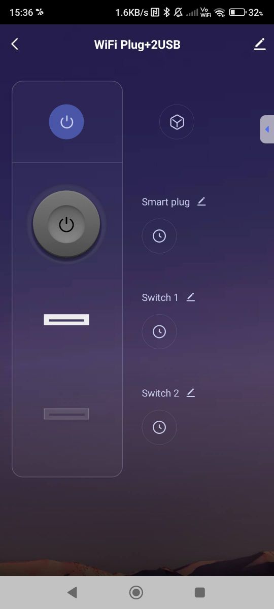

    and I am using this in autoexec to label switches
    I propose two OBK templates are added to the device list.
    • LSPA2.bin (2 MB) You must be logged in to download this attachment.

    Is there a solution for CloudCutter for firmware 1.1.15 in the meantime?
  • #11 21252141
    Posts: 5212
    Help: 446
    Rate: 914
    >>21252057
    No. UART flashing is the only known option if the firmware is patched for Cloudcutter exploit.

What are the differences between the two OpenBeken template configurations for the Tuya LSPA2 dual USB smart plug?
Type 1 maps relays to P7 channel 3, P24 channel 2, and P26 channel 1, with Wi-Fi LED on P8. Type 2 maps relays to P6 channel 1, P7 channel 2, and P24 channel 0, with Wi-Fi LED on P26. Both use CB2S, BK7231N, Btn_Tgl_All on P10, and Flags 1024. [#21006754]
