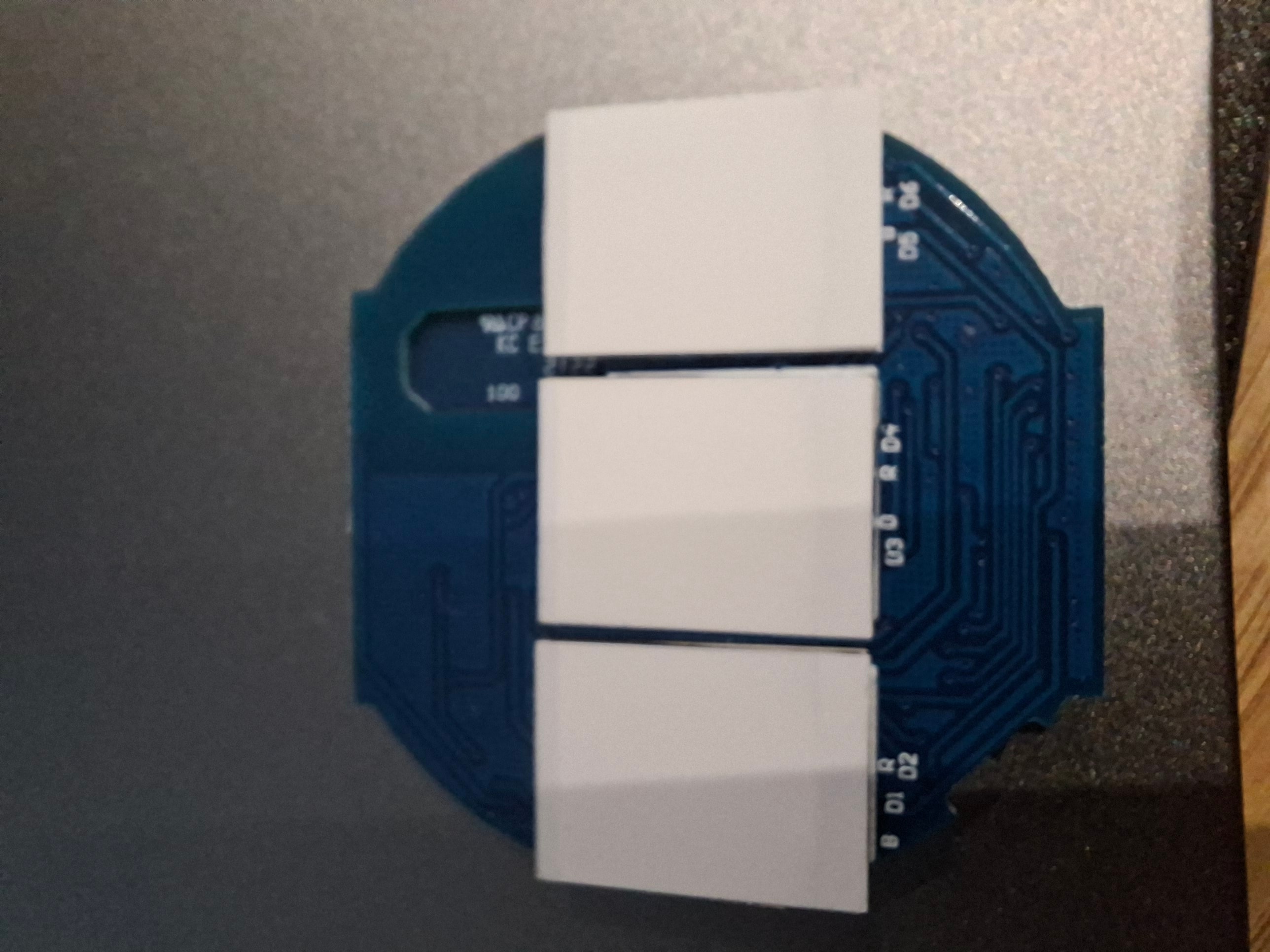

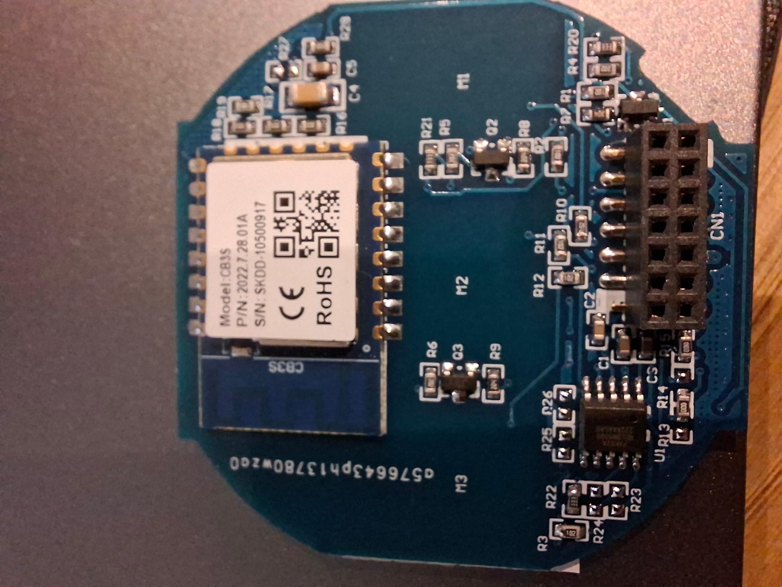

    I am struggling with the configuration of ESPHome on my roller shutter controller.
    I am having trouble configuring the third stop/pause button.
    This is the only thing I have a problem with....
    The open and close times work fine even locally from the buttons.
    Has anyone embraced such 3 button touch controllers?
    Debugging "all GPIOs" does not detect the touch of the missing button. Any ideas/guidance for a beginner? :)
