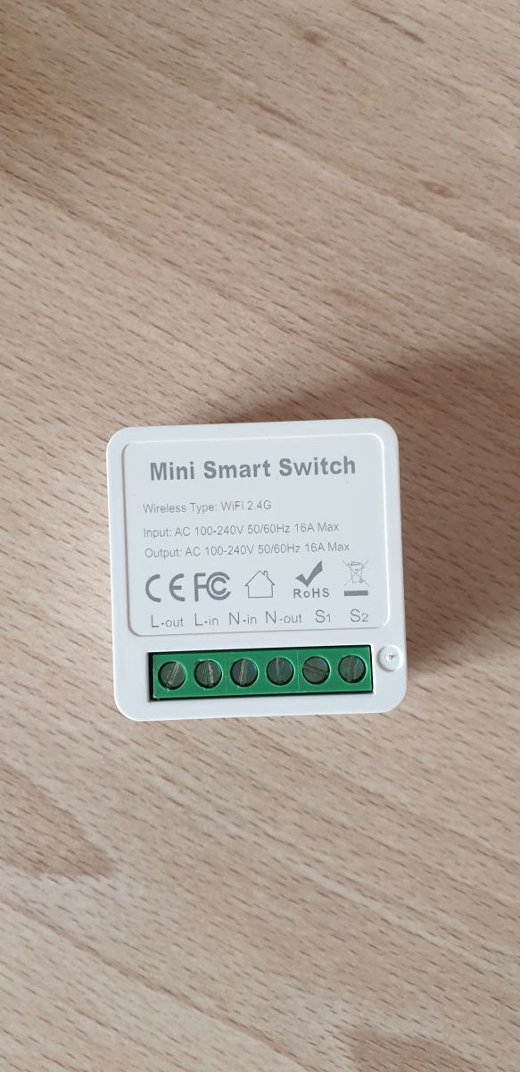

    Hello, I have such a transmitter from tuya, I'm wondering if it can be used to control a roller shutter, or if it is only single channel, and if it can be used for a roller shutter then how to connect, thanks for any answer, greetings Connecting Tuya Smart WiFi Transmitter to External Roller Shutter

    Not really. You connect the power supply from the left, then the next two you have the relay output - it only cuts off the L and the S is the terminals for the switch.

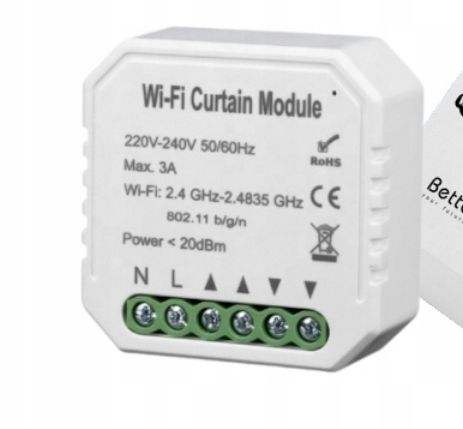

    Buy a dedicated one for roller shutters. There are some:

    sosarek wrote:
    There is no wiring diagram on the back of it?
    They don't have one.The diagram is on a leaflet in the box.
