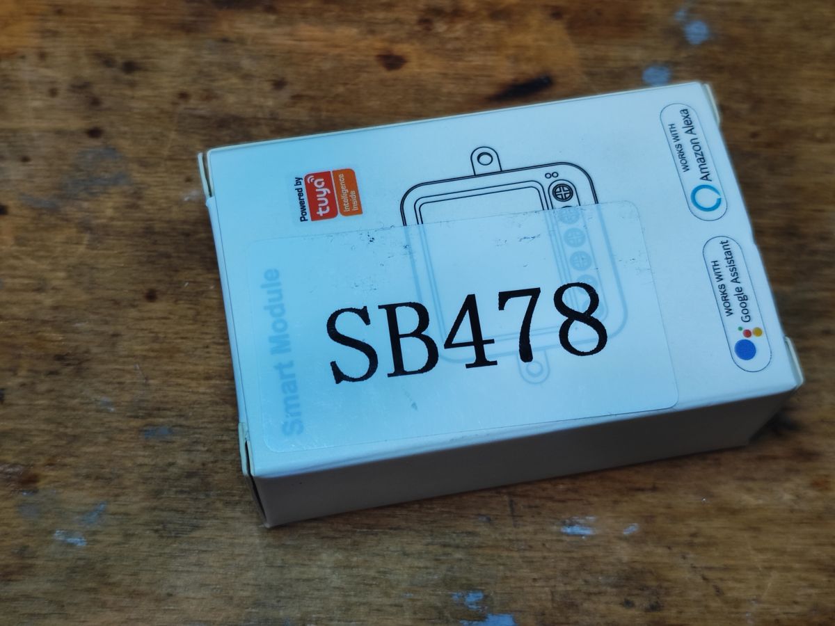

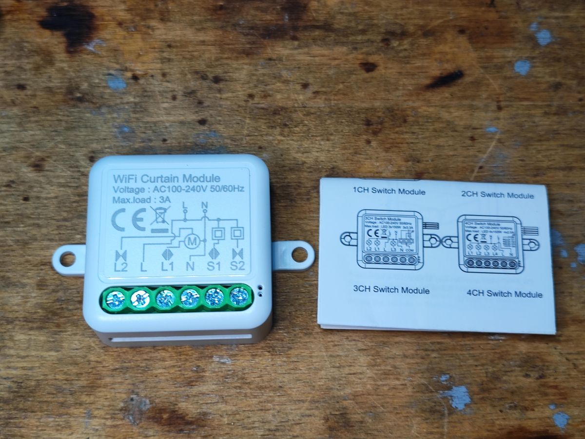

    Some time ago I showed how tightly Tuya packs two relays using the example of the AVATTO WSM16-W2 after-box module for PLN56. Here I will show how Tuya "repainted" this product as a roller shutter controller, i.e. the interior will be similar, but the function quite different....

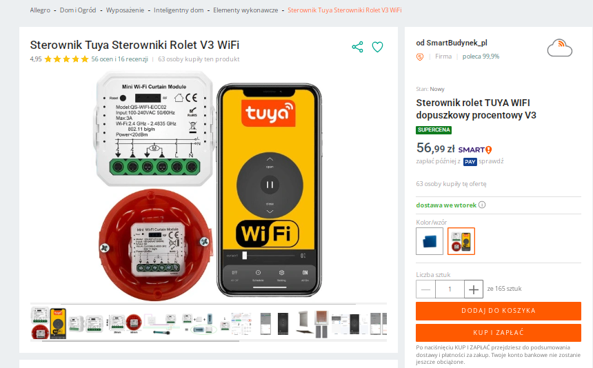

    Purchase SB478/QS-WIFI-ECC02 .

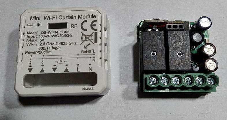

    Here, the price is almost identical to the lighting control version. This is a plus, the manufacturer does not artificially inflate the price for the roller shutter version. The marking QS-WIFI-ECC02 is visible in the picture:
    [CB3S/BK7231] Small and flat roller shutter controller for SB478/QS-WIFI-ECC02 box - batch change .
    What we get in practice:
    [CB3S/BK7231] Small and flat roller shutter controller for SB478/QS-WIFI-ECC02 box - batch change [CB3S/BK7231] Small and flat roller shutter controller for SB478/QS-WIFI-ECC02 box - batch change [CB3S/BK7231] Small and flat roller shutter controller for SB478/QS-WIFI-ECC02 box - batch change .

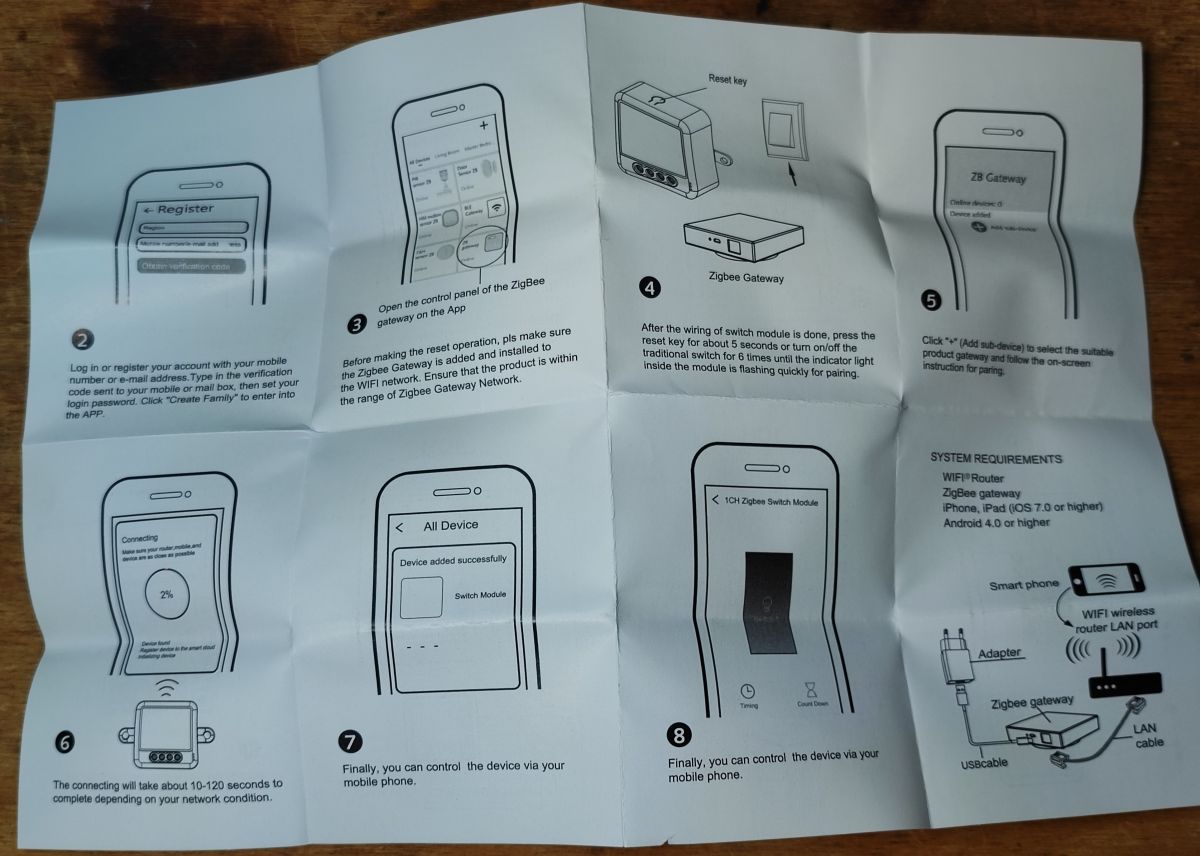

    No screws included this time. It's time to look inside, the tests with the Tuya application I skip because I've done many times.
    Instructions:

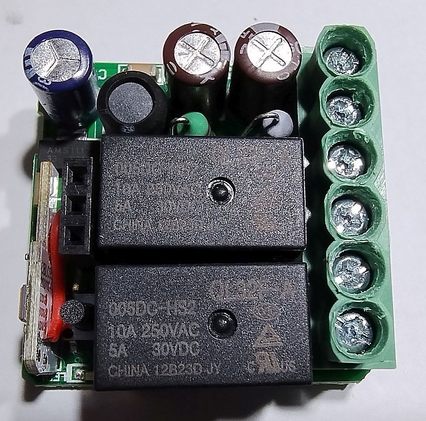

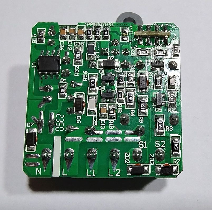

    Interior of SB478/QS-WIFI-ECC02 .
    The interior is similar, but not identical, to that of the AVATTO WSM16-W2 , I recommend you compare the photos for yourself.

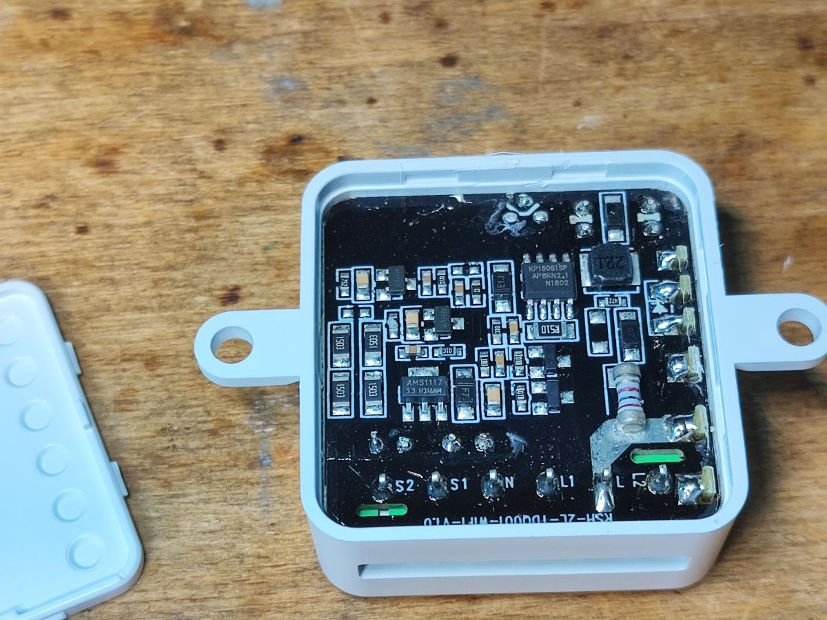

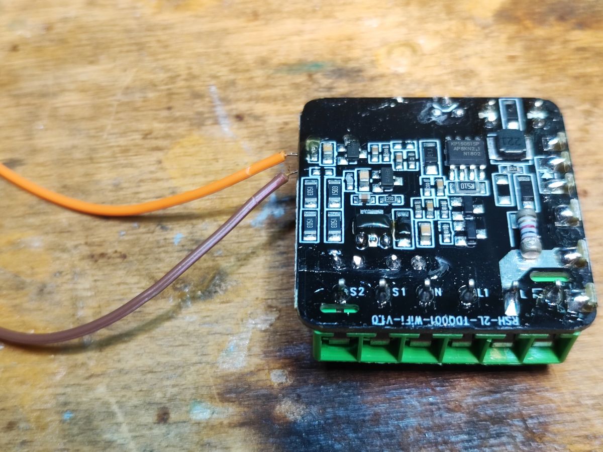

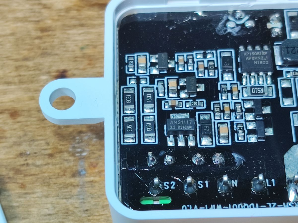

    The power supply is based on the KP15051SP:
    I have also seen it in a Modemix product:
    [BK7231N/CBU] Modemix MOD003 dual WiFi light controller .
    It generates 5V for the relays, separately on the board is a 3.3V LDO for the WiFI modulus.

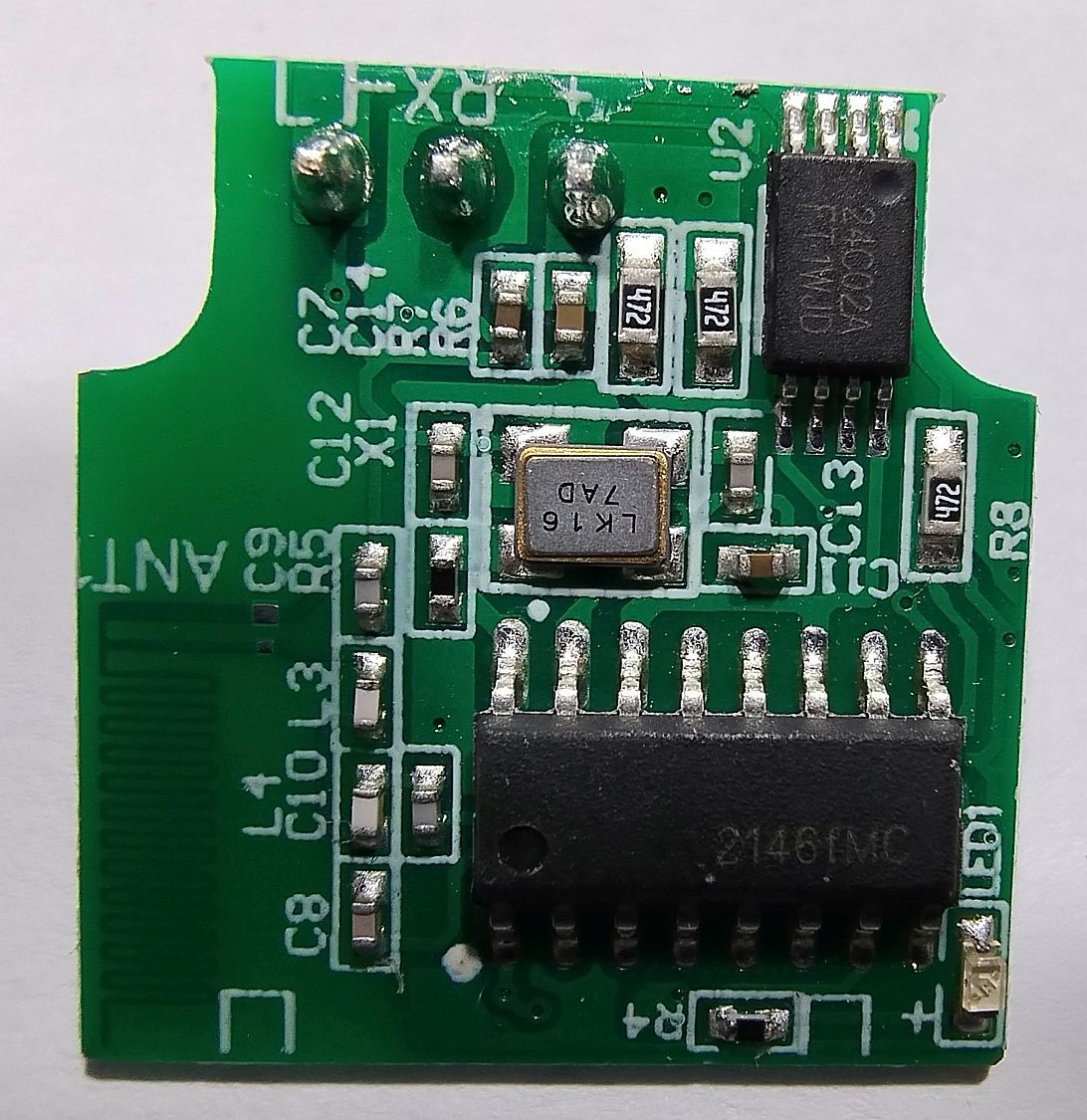

    The whole system is based on the CB3S WiFi module, the BK7231N.

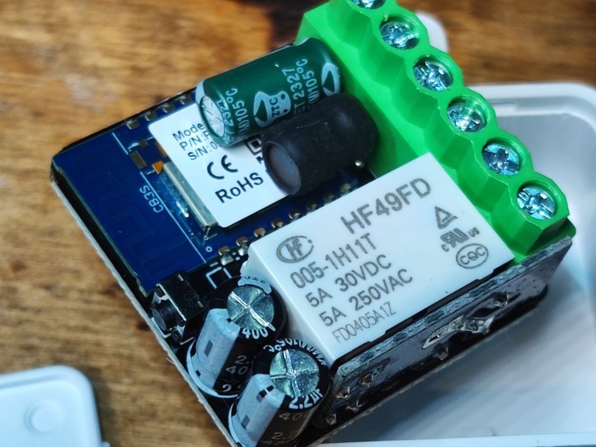

    Cleverly packed relays reduce the height of the module:

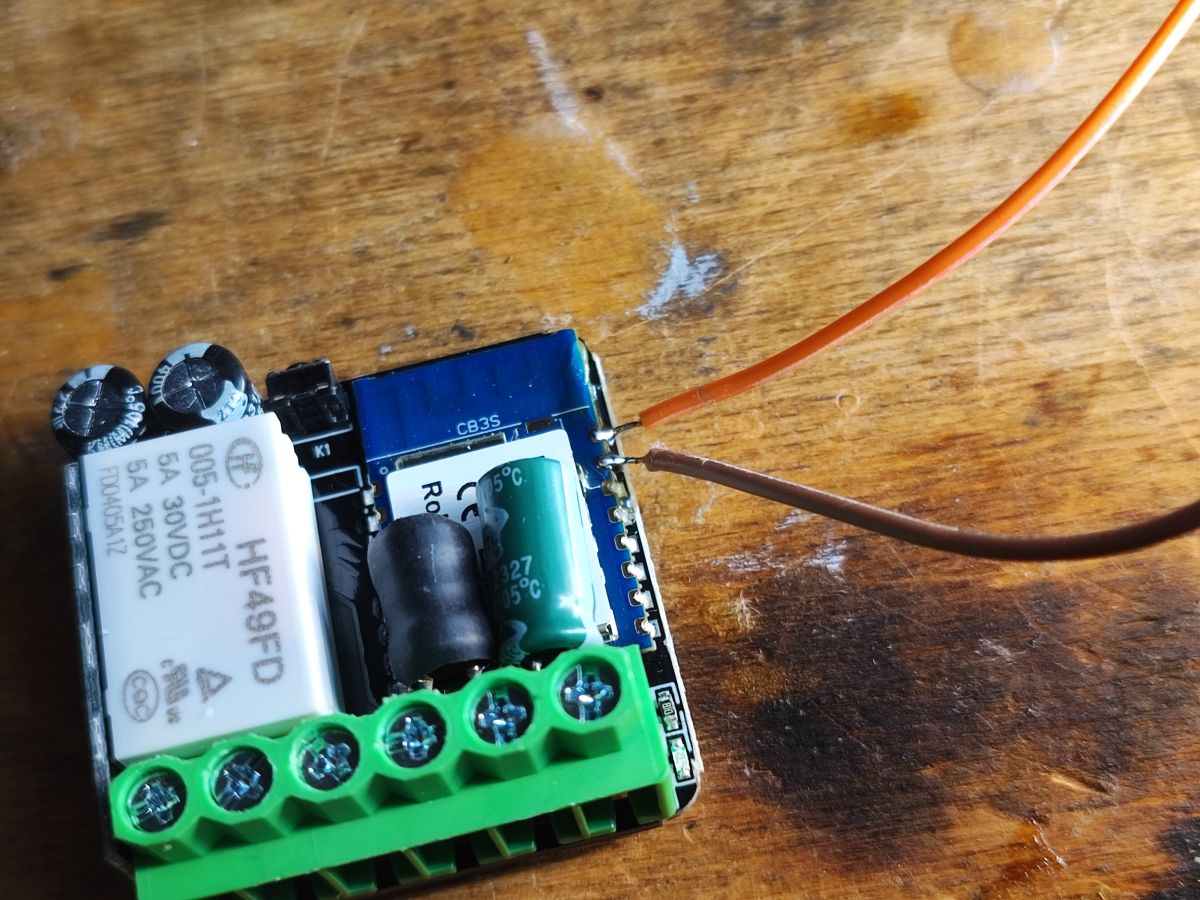

    Changing the SB478/QS-WIFI-ECC02 batch .

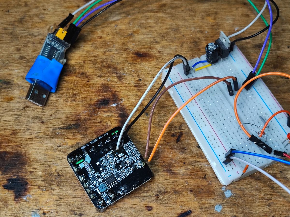

    Upload OpenBeken , according to the flasher instructions:
    We solder the power supply and the TX and RX:
    We can either solder the power supply to the AMS1117-3.3V output (check its leads in the datasheet note) if we have 3.3V, and if we want to supply from 5V, we solder to the AMS1117-3.3V input, so the WiFi module gets 3.3V anyway.

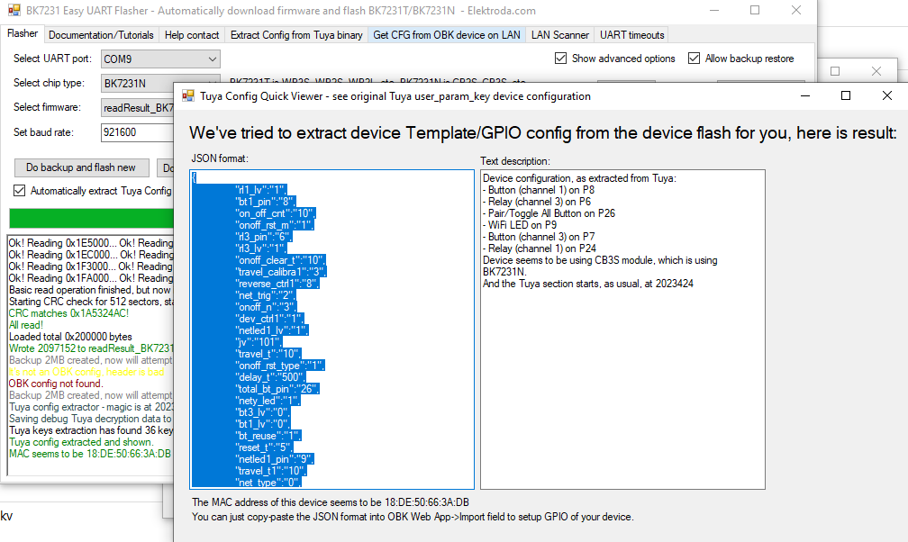

    My flasher correctly detects the Tuya configuration:
    Verbal description:
    Device seems to be using CB3S module, which is BK7231N chip.
    - Relay (channel 1) on P24
    - Relay (channel 3) on P6
    - WiFi LED on P9
    - Button (channel 1) on P8
    - Button (channel 3) on P7
    - Pair/Toggle All Pin on P26
    OBK template:
    Depending on how you want to use this product, further configuration may be required. The configuration of the curtains is described in other forum topics, for example:

    The product is quite similar to a simple two relay controller because it just basically is one - it's the batch that does most of the work. Changing the firmware is straightforward, there are no problems accessing the RX/TX, and my flasher decodes the Tuya configuration correctly, so we momentarily learn the GPIO roles. The only thing left is to configure the blinds, but about that another time. If anything, you can refer to other users' elaborations, as I haven't run the blinds myself yet.

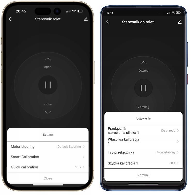

    Apart from the leads, you also need to be careful how you connect the buttons - in some controllers to phase and in others to neutral. A separate issue is what type of pushbutton the controller theoretically supports: There are monostable and bistable switches. Sometimes this can be changed in the settings and sometimes not:

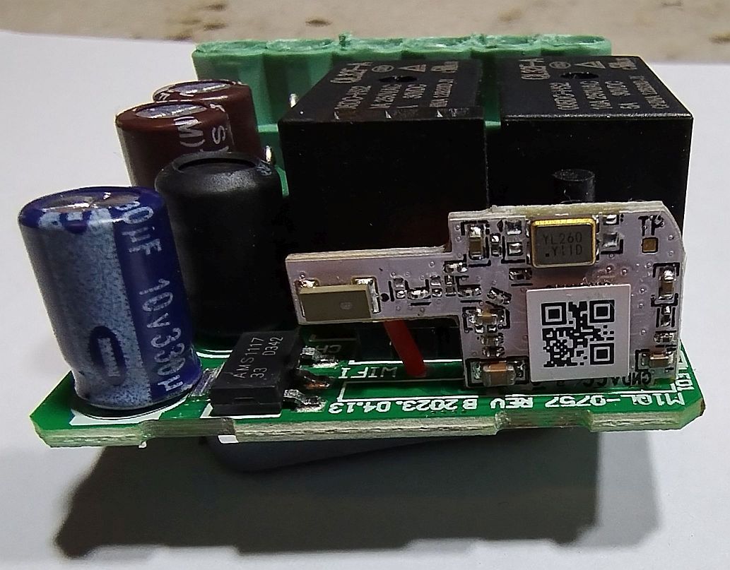

    Unfortunately, on my unit, the button setting does not work - i.e. both mono and bistable work so that you have to hold the 'bell' button the whole time the roller shutter is moving.... Photo of the inside of my module:
    Relays look solid - big. Worse with the WiFi coverage, which is much worse than the IoT switch placed in the same location. It's all clear when you look at the processor and its antenna (BTW: What's the processor? The QR code reads "ZKLE18SY05988" but I couldn't find anything about it...)

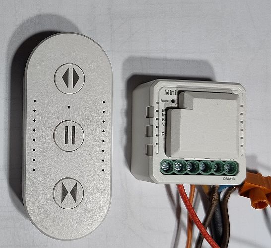

    Why did I decide on this particular model? In addition to the 5A relays, I wanted a three-pin socket marked "RF", which allows a radio receiver to be attached and controlled by a separate remote control:
    The remote control works properly i.e. just one click and the middle button is used to stop. And the physical buttons are only one shortcoming. The second problem is calibration, which cannot be done properly. Polish roller shutters have a compression option, which does not allow the correct determination of the opening percentage. Such an option is supposedly available in Supli, but for me this is mustard after dinner - I bought a Tuya. The price was the deciding factor - Zamel suppli are nightmarishly expensive. Now I know there is a cheaper alternative - reprogrammed Sonoffs....
