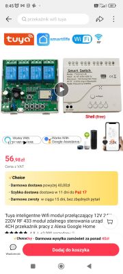

    I have removed the window lowering motor from an Astra G, I want to make an automatic door for the chicken coop. I will hang a piece of metal plate on the cable from the mechanism. The motor has a cool module that shuts off further operation when there is a lot of resistance. So I am looking for a suitable controller with which I can start opening with a click (short-circuit of wires for 3-4 s) and closing (also short-circuited but with another wire for 3-4 s,)
    What do you think, could such a module dedicated to external roller shutters be used?

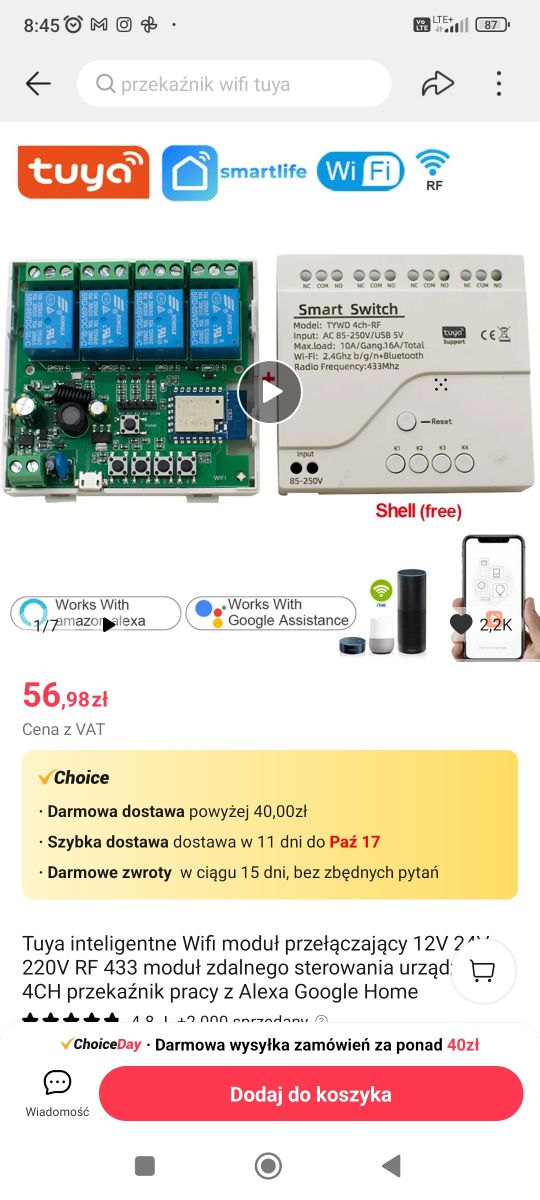

    That's a great idea, I didn't think there were no relays in those controllers. I found one on Ali with four channels, and it will be even better because I will first switch the power to the motor, and use the second and third relays to open and close. From what I see here, you can set everything automatically in Smart life or tuya. So, for example, I will set the motor to switch on at 6 o'clock and open the door with a 10 second delay for 3-4 seconds. This motor is really ideal for this because you can set too long a time and still the module will disconnect it at high overload, the other side of the coin is the brake, once raised it will not lower itself all day. Tuya smart switch module with four relays and casing. .
