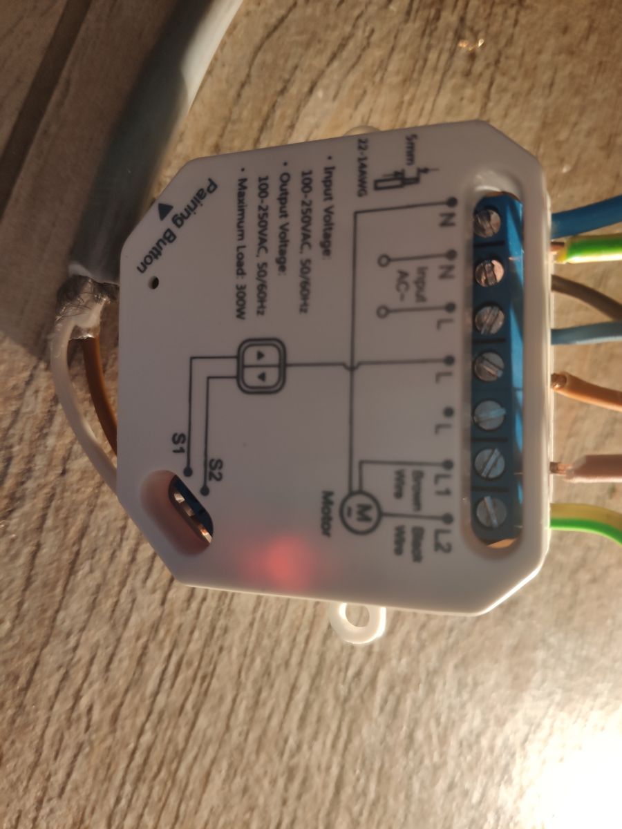

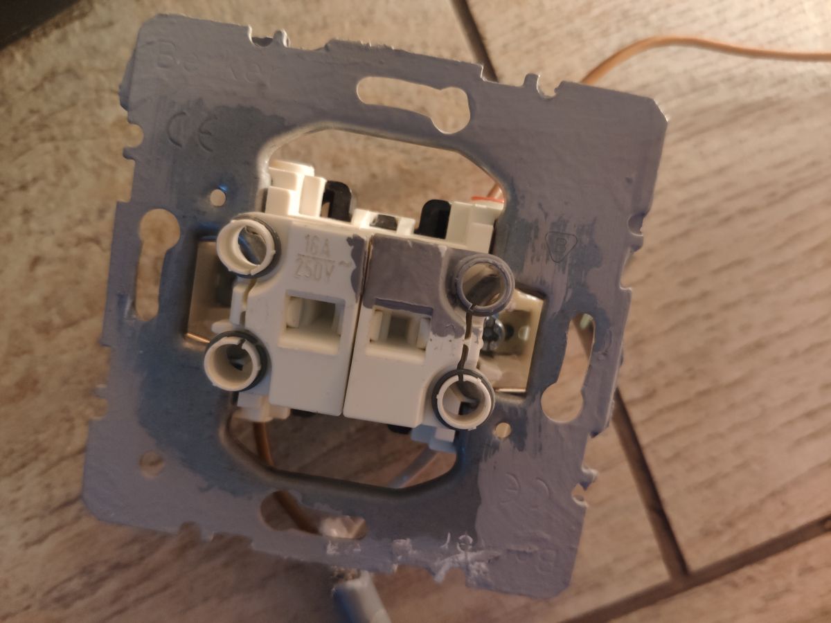

    I have purchased a tuya module for the back box so that I can control the roller shutters from my phone. Everything works great, until I don't use the switch (as in the picture). Applying voltage to the motor, via the switch, makes it impossible to control from the phone.
    The module, after a while, will disconnect the application of current to the motor through this switch (I did tests on light bulbs), but I still cannot control from the phone.
    Does anyone have any ideas?
    The two buttons on this switch, are bistable, with a mechanical interlock, so that I cannot apply voltage to open and close the roller shutter.

    The photo does not say the type of this relay. By the way, does this motor have a protective wire connected?
    Because from the photo you can see that the yellow-green is used to control the direction.

    And shouldn't there be a phase connected to this L terminal next to L1?
  • #6 18377620
    gruniu
    Posts: 930
    Rate: 179
    I don't think so. In the instructions you don't connect anything there. When you start the module, there is voltage there all the time.

    Have you checked that there is definitely no voltage between S1 and N or S2 and N when this problem occurs?
    Maybe try shorting S1 or S2 to N without a switch and see if the situation recurs.

    I have an identical controller installed at my place. everything works flawlessly.
    According to the specifications of the device, it only works with monostable switches and that's probably where the problem came from.

    I fitted switches to the roller shutters, controlled by the Tuya system. Everything is working beautifully.

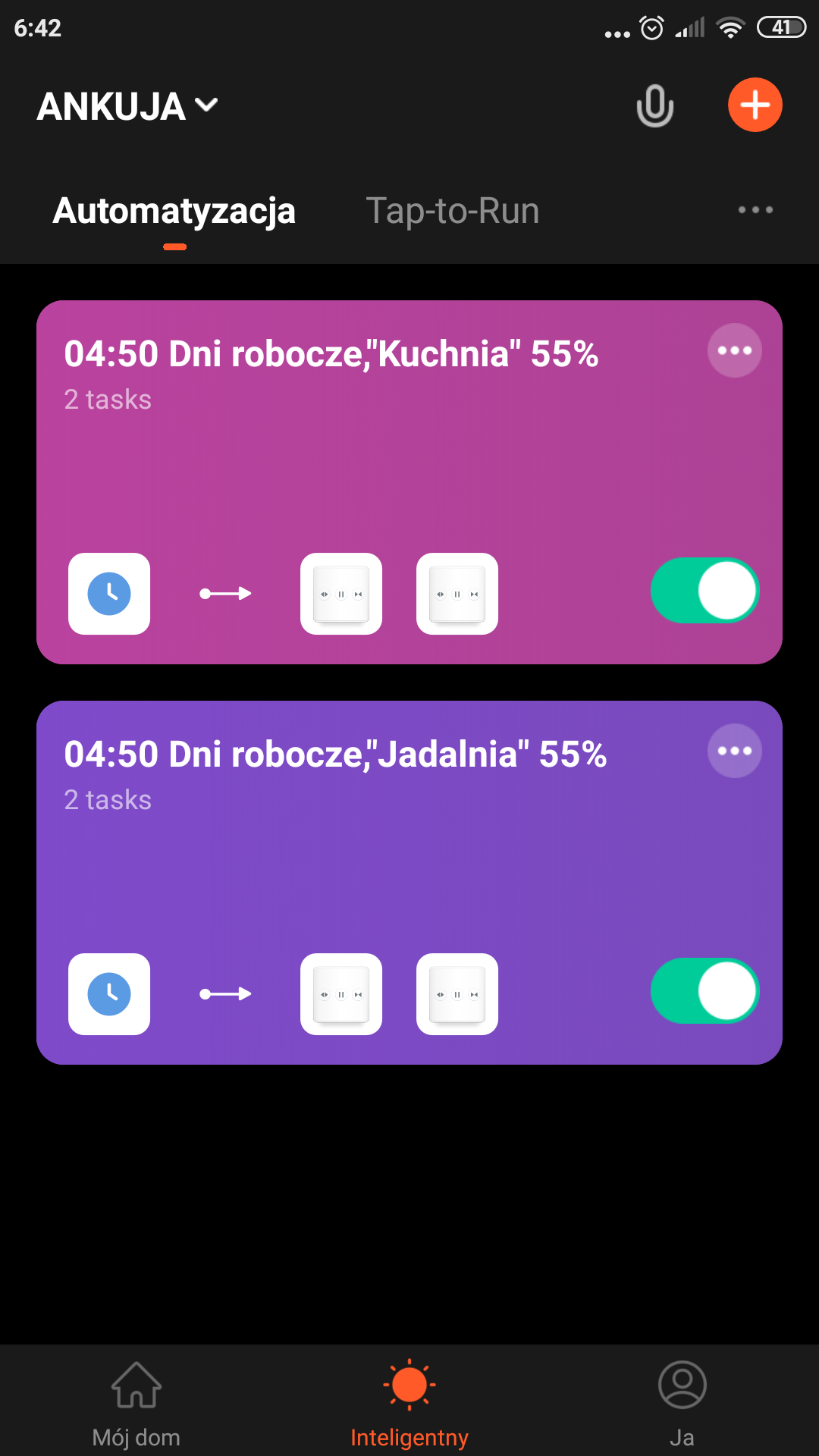

    I need help as I can't find instructions anywhere for setting up the roller shutters more fully in the tuya app.
    My 3 roller shutters open and close completely according to a schedule - with this I have no problem.
    However, I would like, for example, one of them (in the morning) to open earlier by a certain percentage - to brighten up the room before I leave for work, then fully open according to the schedule.
    How and where do I enter this opening percentage in the application?
    Please help me with what to do and enter one by one.
    Thank you.

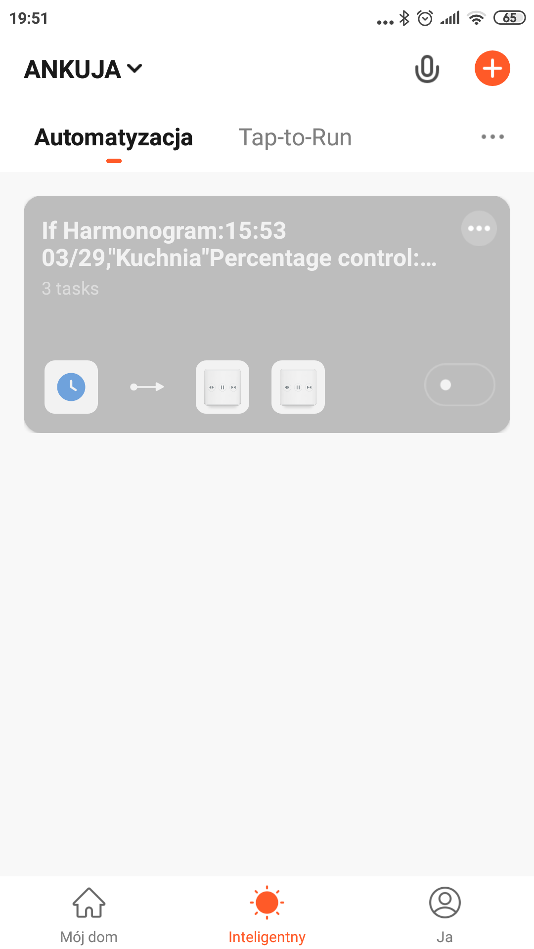

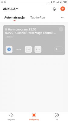

    But at the bottom of the screen is "Smart".
    Clicking on this goes into "Automation" and next to Tap-to-Run" and at the top "+".
    Clicking on the "+" sets the condition and task.
    Somehow I set it and got the text:
    "If Schedule 15:53 03/29, 'Kitchen'"Percentage control20%....
    - so there is something here for setting percentages, however it doesn't work as expected for me.
    I could not find instructions for setting the blinds, also in English.

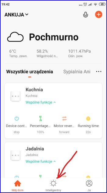

    Only this: https://support.tuya.com/en/help/_detail/K9hutfnqcnby1
    Added after 4 [minutes]:
    Maybe the opening % value is set somewhere.
    Also, in the main window with my finger by sliding the slider I can set the % opening and it works, but it is with my finger and I would like to set this % in tuya programmatically.

    Show me a screenshot of this roller shutter control module.
  • #17 19377860
    kasuj
    Posts: 14
    How do I combine a bistable switch with a Tuya module for roller shutters? .
    Added after 32 [seconds]:
    Added after 1 [minute]:
    Does that first screen look any different on you?

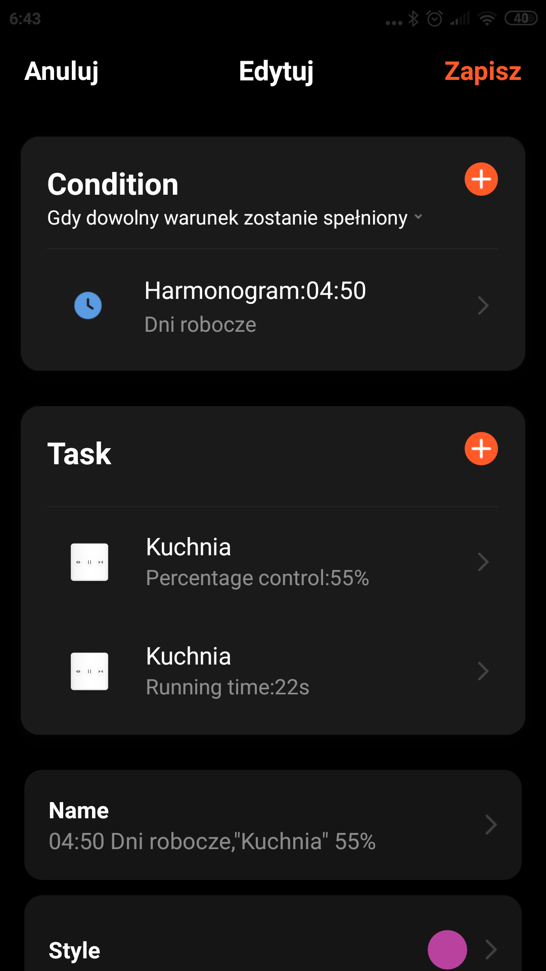

  • #18 19388676
    kasuj
    Posts: 14
    I managed to set in Tuya the automatic opening of the blinds in the morning to 55%.
    I am attaching the screenshots.
    How do I combine a bistable switch with a Tuya module for roller shutters? How do I combine a bistable switch with a Tuya module for roller shutters? .

    gruniu wrote:
    On what basis, the system will department how many percent will open the roller shutter? For this you need an encoder.
    Who mounts the encoder to the roller shutter?
    Based on time. When setting up the roller shutter i.e. calibration, Tuya assumes the opening time of the roller shutter as 100 %. This is not an accurate indication, but some kind of approximation, and in addition creates problems with longer roller shutters, because the time of opening and closing differs by about 2s, which causes the roller shutter to stop at 95% open. This does not change the fact that the indication is there.
