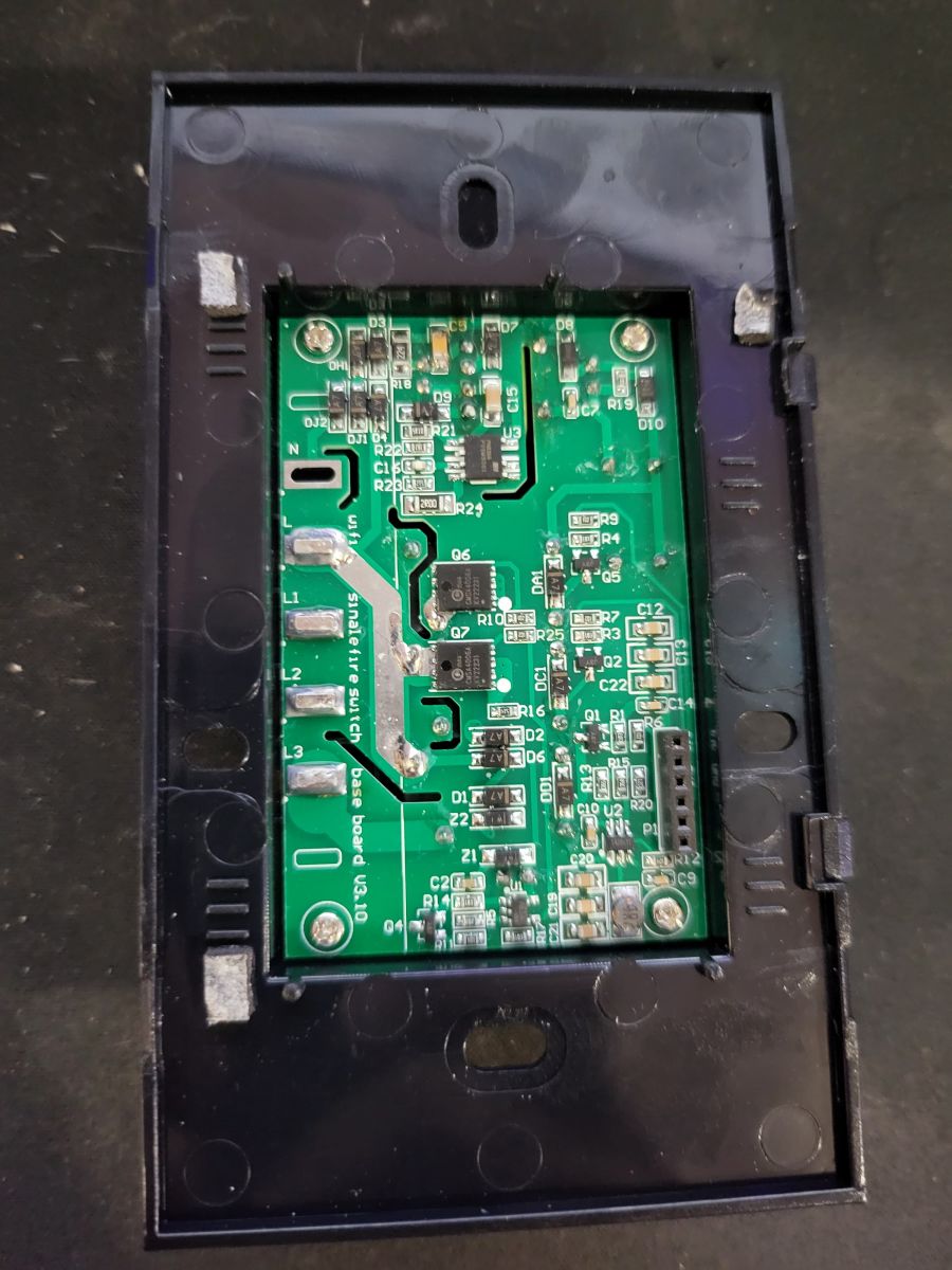

    https://pt.aliexpress.com/item/1005005862715843.html
    AVATTO WiFi Smart Switch panel without neutral wire on AliExpress.

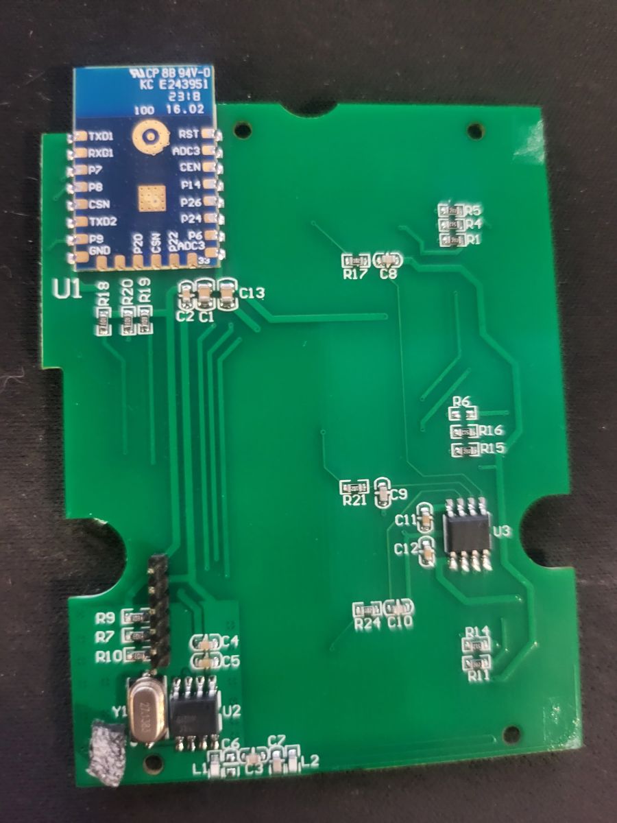

    Circuit board placed in a plastic casing. Green circuit board with three buttons and an electronic module. Photo of a circuit board with a blue module attached.
    I wasn't able to find anything in the database, so I'm posting here. Also looking into what I should do to flash it.

    This should be easily flashable by:
    Please see related tutorials on our channel https://www.youtube.com/@elektrodacom , especially:
  • #3 20904629
    guilhermemaciel
    Posts: 13
    Thanks for the help, I will get the tools and report my success or request further assistance. Thanks a lot!
  • #4 20904830
    Posts: 14763
    Rate: 12896
    From what I can see on the photo, it doesn't look like TX1 and RX1 are going anywhere, so the flashing procedure will most likely be very simple.

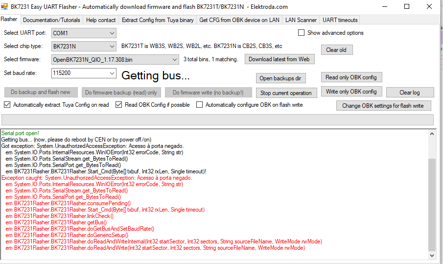

    I'm getting this error when trying to flash:
    Screenshot of BK7231 Easy UART Flasher showing an error message.
    Tried on another computer and I checked my connections also.
    Added after 50 [minutes]:

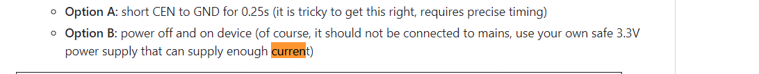

    I believe it's because I'm getting the 3.3v from the FTDI usb board itself and it isn't able to provide enough power.

    You are correct, @guilhermemaciel . That's what we say on every flashing guide, and even in the flasher readme:
    A section of the instructions for flashing options with a highlighted part of the text.

    I used an external power. The board is fully booting, I know because I can connect/control it with the app. However, I didn't manage to flash it at all. I tried resetting it over 100 times and it didn't work...
    I even broke one of the pins of an IC that I thought was connected to the RX or TX of the board.
    Is it a better idea to desolder the board for reflashing?
  • #8 20930966
    guilhermemaciel
    Posts: 13

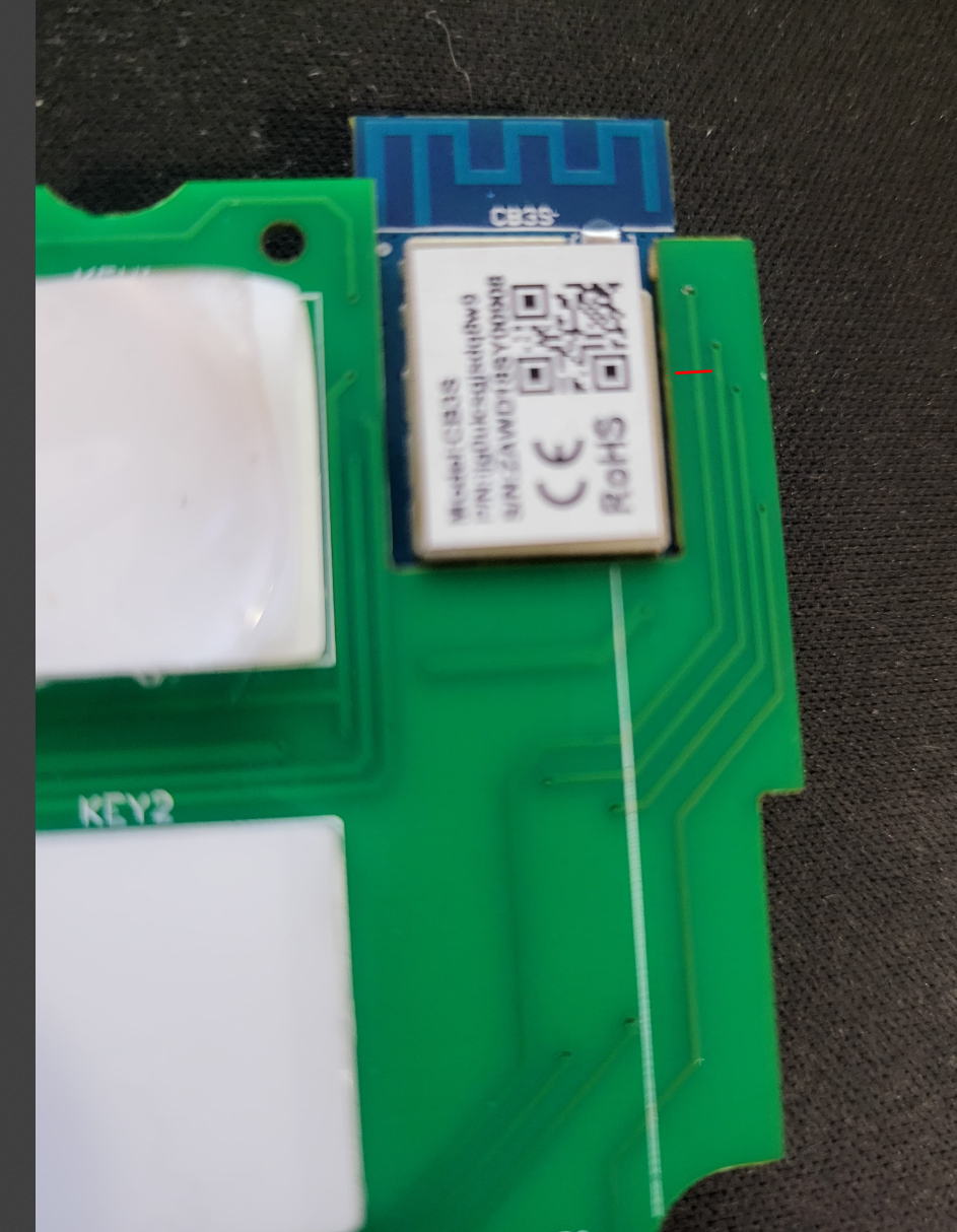

    Desoldered the board and managed to flash. I'm trying to understand what vias are messing it up so I can just cut them on the board and fix them later. I think it's easier than desoldering.

    Close-up of a green PCB with a mounted module featuring CE and RoHS markings.
    If I cut this trace, I can flash without desoldering. I damaged 2 units in the solder/desolder process. I overheated one of the touch buttons with the hot air, and on another one, one of the SMD capacitors went missing, also because of the hot air.
    I'm going to start installing soon. The only thing that seems to be wrong is that the green "reset" LED that one of the buttons has stays on all the time.

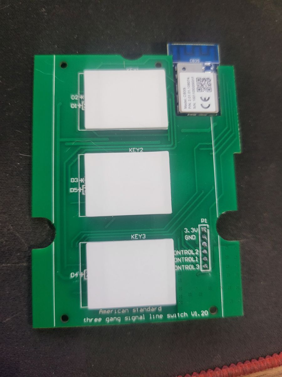

    I'm not sure where to ask, but, I'm having issues with the buttons, they died on 3 boards. I thought it was some mistake on the ones that I was removing the CB3S chip, but, I'm sure that in at least one I tested it before installing. Any tips on what to check?
    I'm sure it isn't related to the fw, I think I broke something, just don't know exactly what traces to follow.

    Do you have childlock flag enabled?
  • #17 20942136
    omniron
    Posts: 114
    The buttons seem capacitive, then rarely anything can fail.
    What's the name of the U3 8-pin chip on the backside?
    One source of problems I found are the headers, resolder them with decent solder and maybe some flux.
    Plug the unit in while soldering, so the pins/sockets don't fall out of line.
