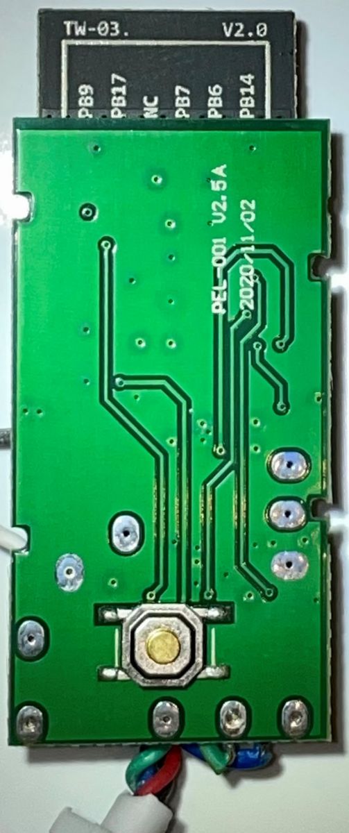

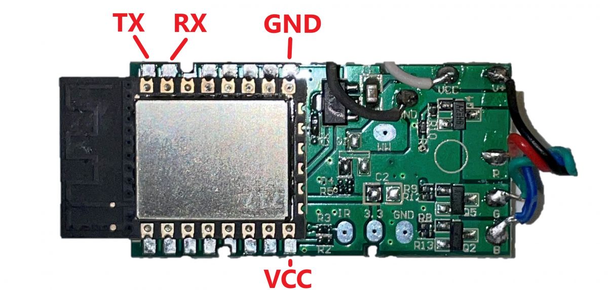

    Bought this LED strip from Walmart on discount for $7.99. This RGB LED strip is a basic USB powered Wi-Fi enabled strip, with one button offering minimal functionality. The board is accessible with a basic spluger tool.
    [W600 / TW-03 ] Monster Illuminessence RGB LED Strip (5V USB) [W600 / TW-03 ] Monster Illuminessence RGB LED Strip (5V USB) [W600 / TW-03 ] Monster Illuminessence RGB LED Strip (5V USB)

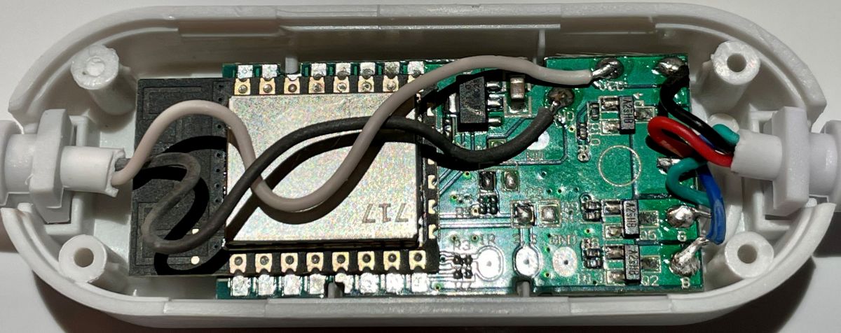

    The board inside is a Winnermicro W600 TW-03. Additional Information

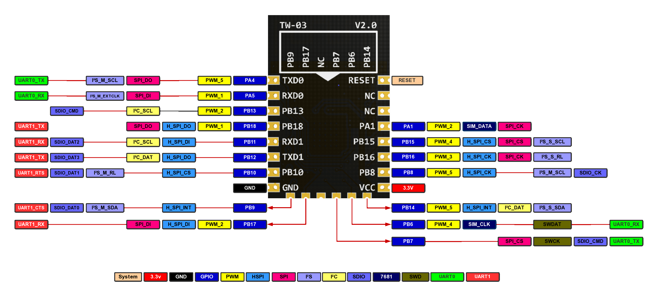

    The following pins are in use:
    PB10: Button
    PB15: PWM
    PB16: PWM
    PB18: PWM

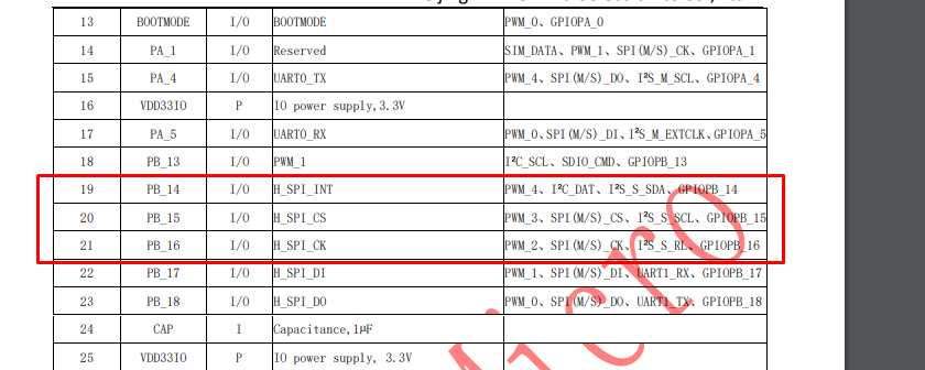

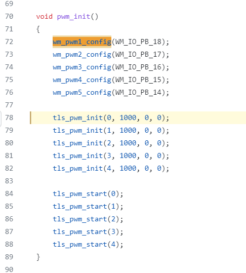

    Hmm, those pins are indeed PWM:

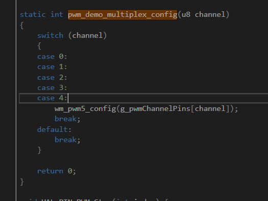

    I am looking at our code:
    and at the SDK:
    It seems only PWM5 gets used correctly. @iprak, do you know anything about it?
    I pushed a PWM fix, maybe:
    https://github.com/openshwprojects/OpenBK7231...mmit/c810767d30bdec7ab960ad84cd1c3f28654adbfe
    Can you get the binary from the branch and check if it works better? Both config and PWM issue?
    https://github.com/openshwprojects/OpenBK7231T_App/suites/13590705430/artifacts/748909700
