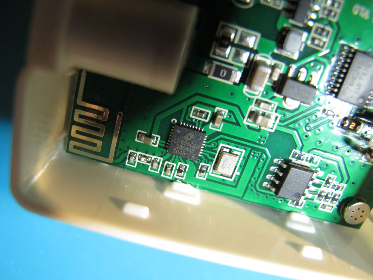

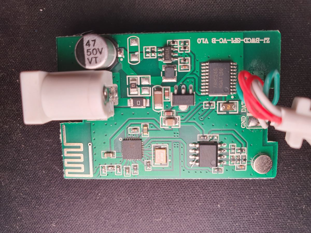

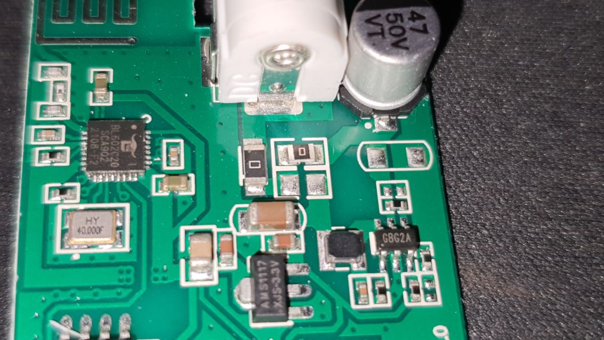

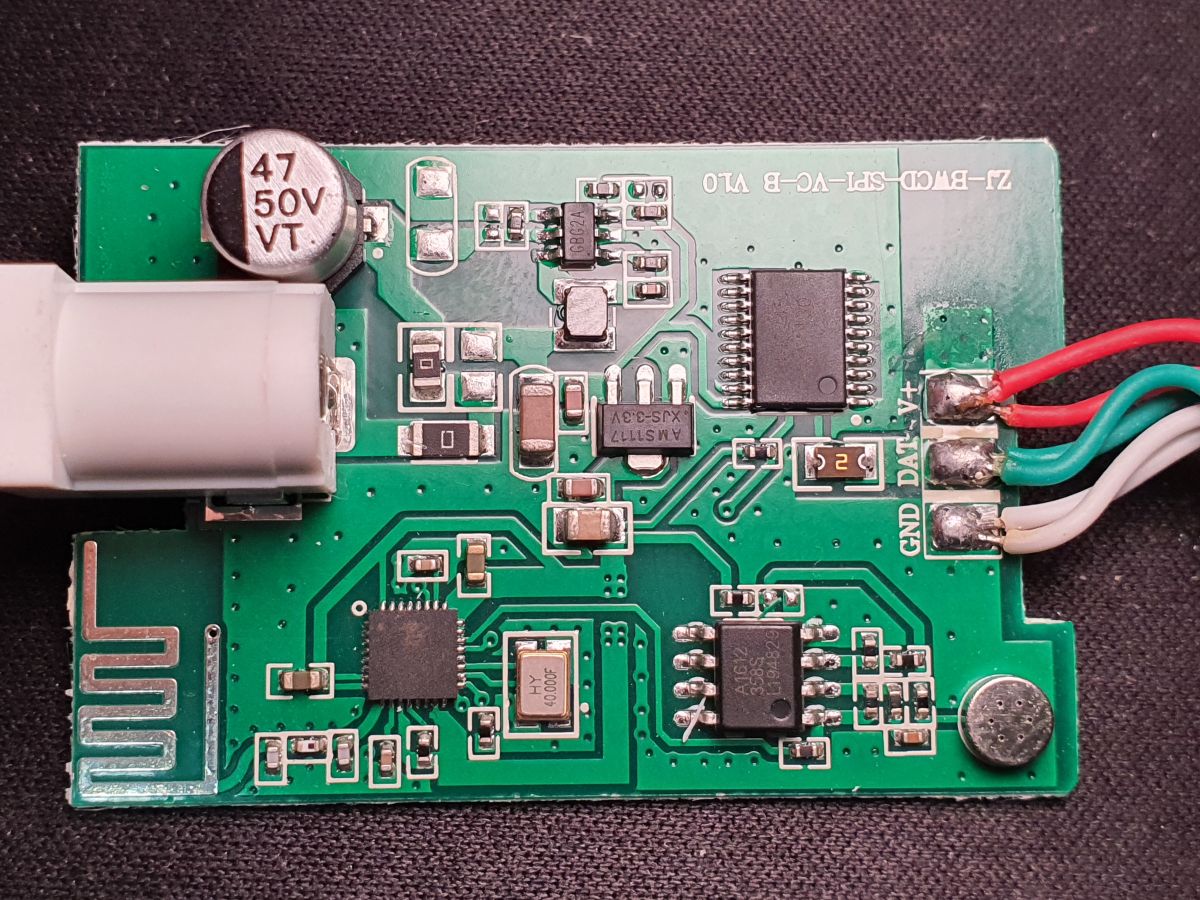

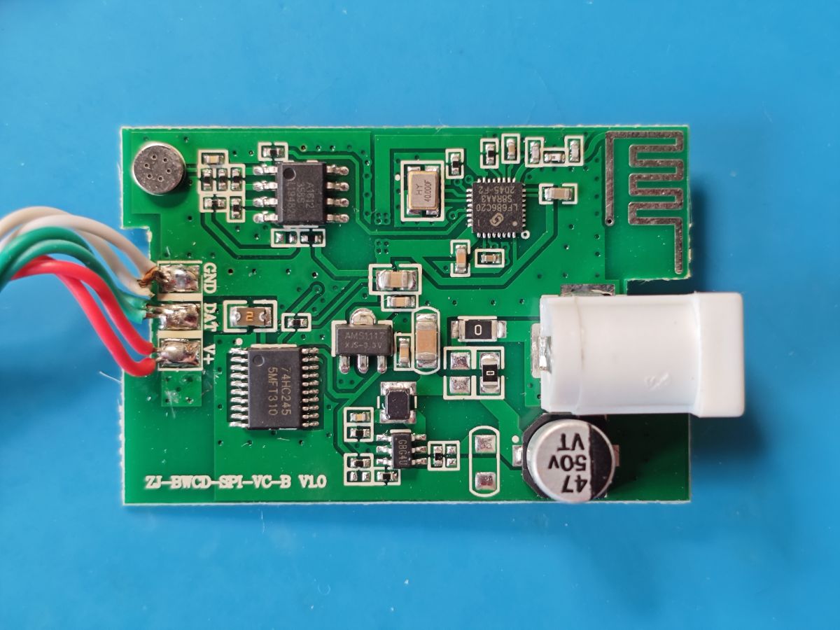

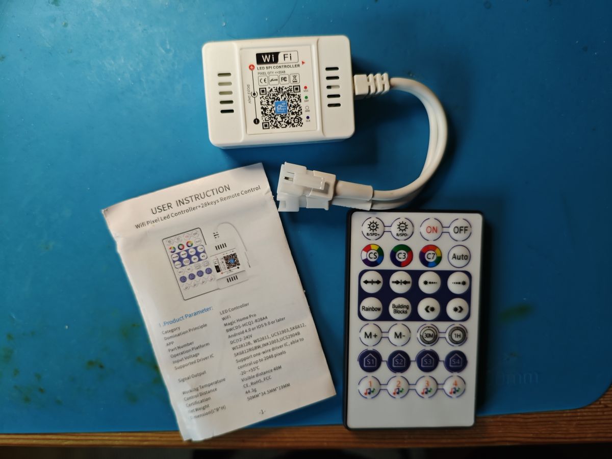

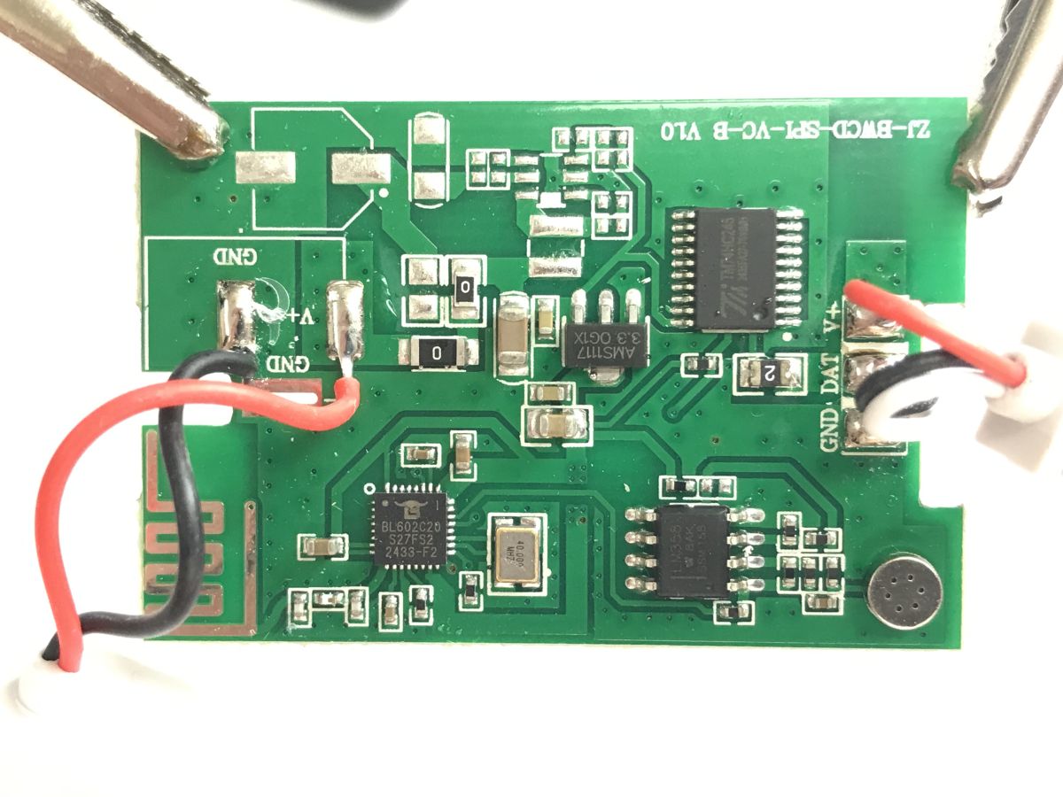

    Hello everyone. I leave you the teardown of the ZENGEE intelligent LED controller.
    It uses the BL602 chip, A612 for the microphone input for music effects I guess and the integrated 74HC245 which is a one-wire driver IC, able to control up to 2048 pixel. It supports WIFI+BLE and has a 24-button RF remote control.
    ZENGEE smart LED controller with RF remote control. Photo of the ZENGEE smart LED controller with a Wi Fi LED SPI CONTROLLER label. Close-up of the ZENGEE smart LED controller circuit board. The image shows a disassembled ZENGEE smart LED controller with components like the BL602 chip and 74HC245 on the circuit board. Back of ZENGEE smart LED controller PCB with visible traces and markings. Close-up of a circuit board with 74HC245 and A1612 chips. PCB board with BL602 chip and other electronic components.

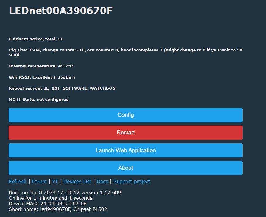

    I was able to install OpenBeken using the mhflasher app and it worked flawlessly. Then I updated by OTA to the latest version. At the moment I could not find a way to make it work with my WS2811 PIXEL LED. I will make measurements on the BL602 output pins and identify which one connects to the driver and how to use it. I am new to OpenBeken but I will let you know of any progress I make. If you have any questions feel free to ask and I will help you any way I can.
    LED ZENGEE controller interface screen showing device information and configuration options.
    LED controller configuration interface on OpenBeken.
    EDIT: PAD 21 GPIO12 is connected to 74HC245
    PAD 22GPIO14 is connected to A612

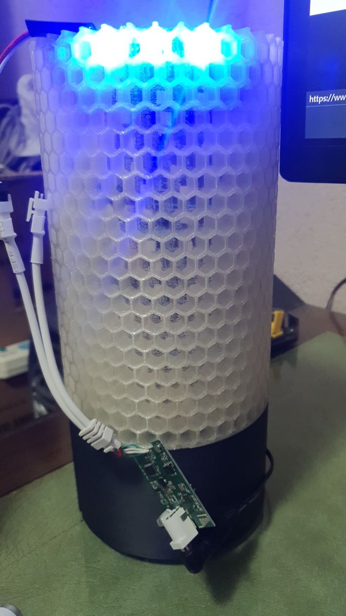

    I've been working abroad for a while and didn't have a chance to do anything until today. Had some problems with the LFS partition so I couldn't create files and save them with the LittleFS. Solved it by flashing via UART the non OTA version.
    Now that everything is working I'm trying to compile the PixelAnim driver but it's a bit beyond my knowledge. I also wanted to ask a question. The device comes with a RF control, not IR. Can it be used with OBK?
    PS: I don't know why but after the update, the first led stays on at startup with blue light. It is a lamp made in 3D printing with WS2811 led strip on it.
    3D-printed lamp with blue lighting and a PCB board.

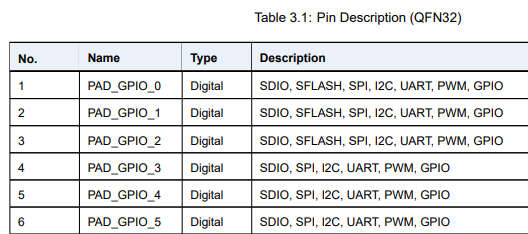

  • P5 may be SPI and OBK boots cleanly
    #10 21157385
    Posts: 5236
    Help: 450
    Rate: 920
    and perhaps P5 is connected for SPI
    Table showing pin description for QFN32, including number, name, type, and description of functions for pins PAD_GPIO_0 to PAD_GPIO_5.

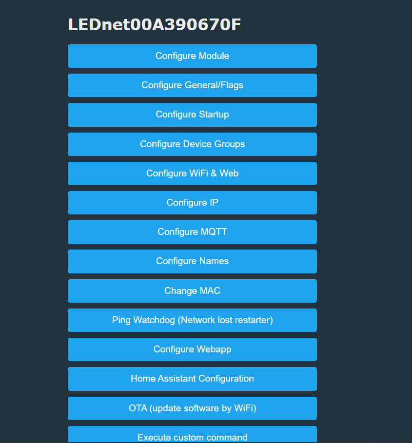

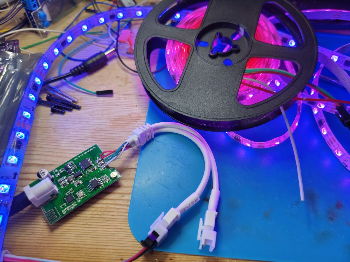

  • P12 is the SPI data pin on this controller
    #14 21637109
    Posts: 5236
    Help: 450
    Rate: 920
    OK. With this Zengge device specifically...
    OTA
    Jun 17 2024 21:41:40 version 1.17.617 -> 1763_merge_30912ac9583a
    it is not. P12 is SPI for this.
    4M/60 WS2812B looks good. Animations and colour look correct
    WS2812B LED strip connected to Zengge controller on a workbench

  • P5 and P17 fail despite SPI MOSI labels
    #16 21637140
    Posts: 5236
    Help: 450
    Rate: 920
    insmod wrote:
    You forgot pins in the template.
    lol oh yes.
    insmod wrote:
    Can you test on a dev board if MISO pins are working?
    yes. setting up a test now

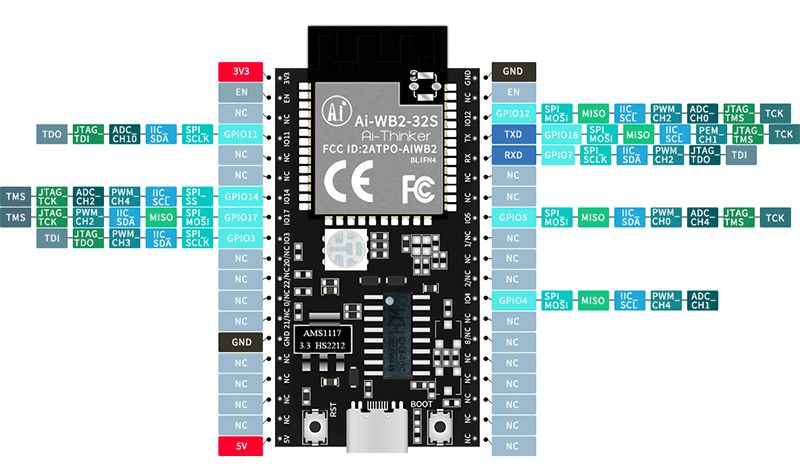

    Added after 1 [hours] 8 [minutes]:
    insmod wrote:
    Potentially? - P1, P5, P9, P13, P17, P21. They are MISO by default? But can they be used as MOSI?
    on Ai-Thinker WB2-32S it seems only P5 and P17 is available from that list. Other pins are labelled but like P1/NC
    Pin layout diagram of Ai-Thinker WB2-32S module with GPIO and interface labels
    P5 ❌
    P17 ❌
    weird because theyre clearly labelled SPI MOSI. P12 works - animations, all fine, like the Zengge. IO4 works too

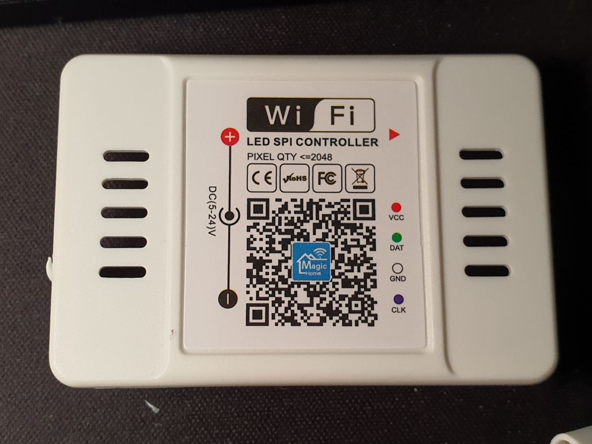

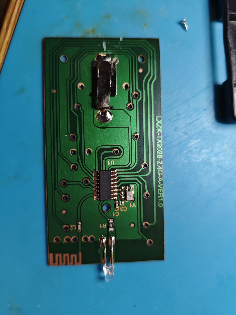

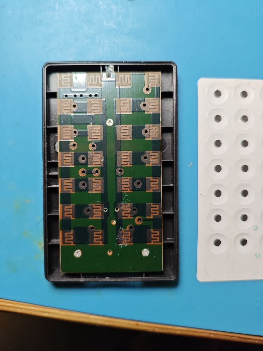

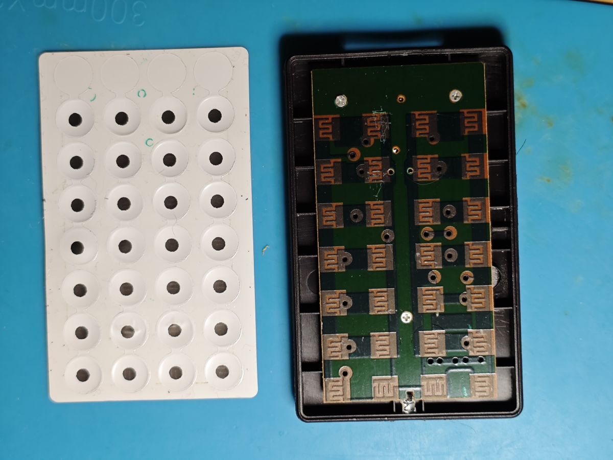

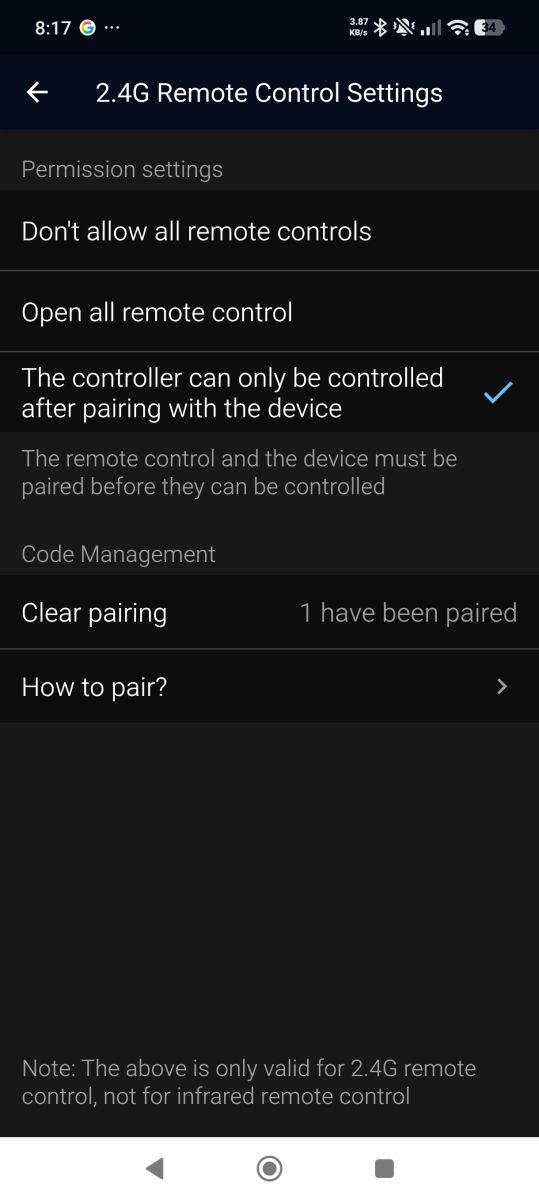

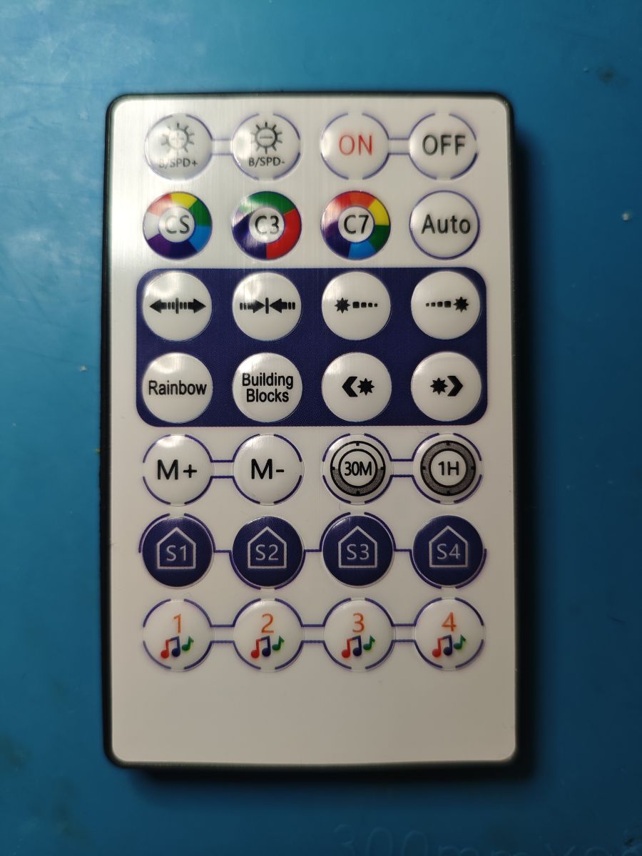

    just dug this device out again after thinking about this GitHub issue regarding a BL602 device with remote https://github.com/openshwprojects/OpenBK7231T_App/issues/2071
    I don't see any obvious RF real estate so I'm guessing it's a bluetooth remote.

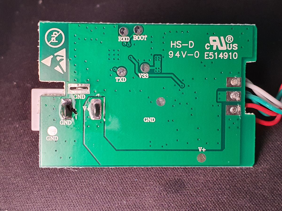

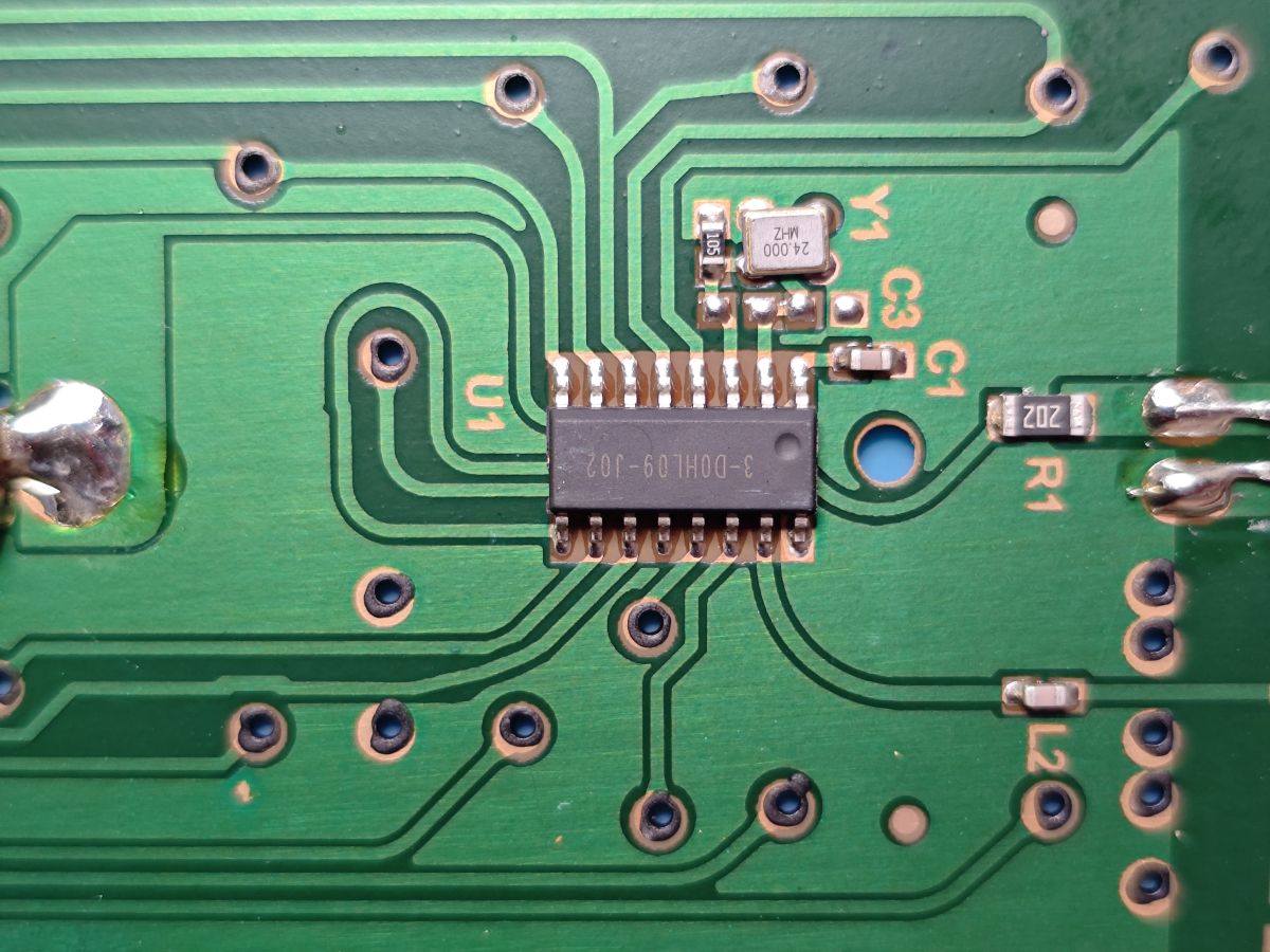

    TEARDOWN [BL602] ZENGGE Magic Home Pro RGBW 12-24v 3+3 pin SMART LED Strip Controller
    LM358-type chip (marked A1612 / 358S) is probably the microphone front-end. amplifying or conditioning the signal from the electret mic
    74HC245 a buffer / level shifter / I/O driver for the DAT line
    proximity and traces give their function away
    I've not sniffed anything Bluetooth ever before so might look into that
    Added after 15 [minutes]:
    device responding to remote button pushes
    in-app pairing guide: http://faqsys.magichue.net:8089/faqIndex.html...54ae988&webType=Android&appFrom=ZG001
    Added after 23 [minutes]:
    Paired

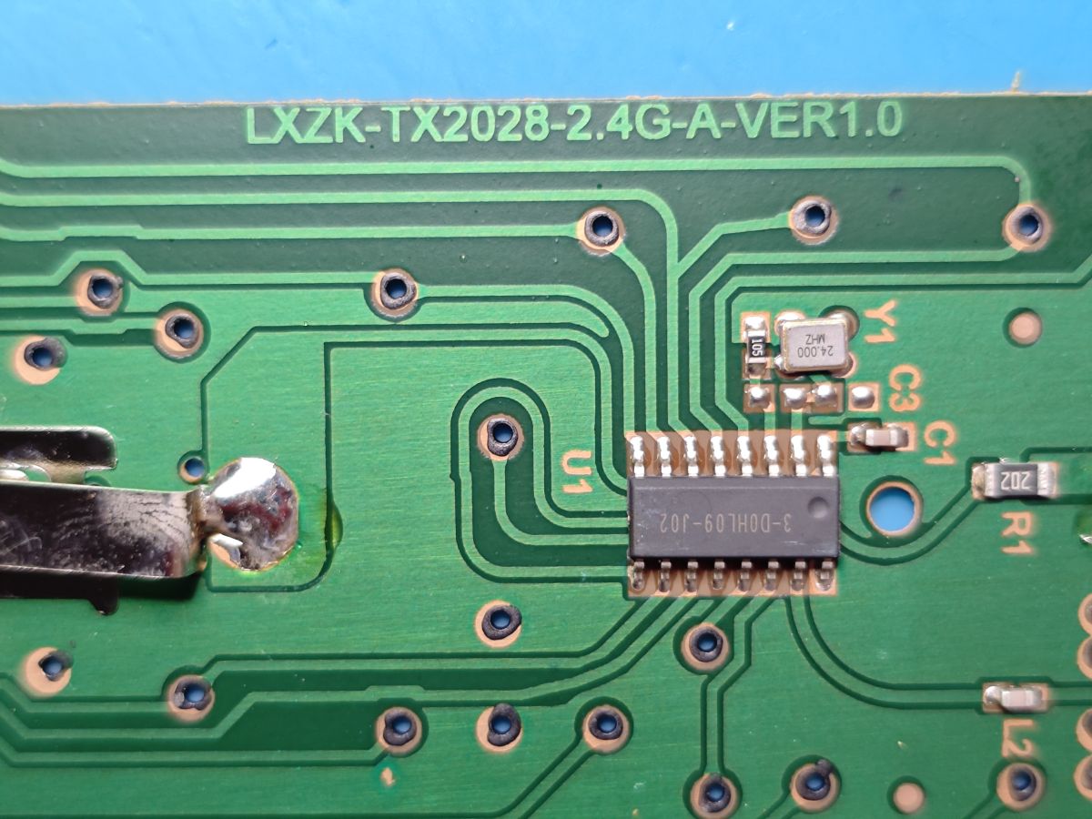

  • FCC IDs and module identifiers for the controller teardown
    #20 21885986
    Posts: 5236
    Help: 450
    Rate: 920
    TEARDOWN [BL602] ZENGGE Magic Home Pro RGBW 12-24v 3+3 pin SMART LED Strip Controller TEARDOWN [BL602] ZENGGE Magic Home Pro RGBW 12-24v 3+3 pin SMART LED Strip Controller TEARDOWN [BL602] ZENGGE Magic Home Pro RGBW 12-24v 3+3 pin SMART LED Strip Controller TEARDOWN [BL602] ZENGGE Magic Home Pro RGBW 12-24v 3+3 pin SMART LED Strip Controller TEARDOWN [BL602] ZENGGE Magic Home Pro RGBW 12-24v 3+3 pin SMART LED Strip Controller Close-up of a green PCB with an IC, traces, and the printed text “LXZK-TX2028-2.4G-A-VER1.0”
    3-DOHL09-J02
    https://fcc.report/FCC-ID/2a2i3rgbcwr01
    MODUS / Dream Tree LLC
    Loongco International Limited
    MOODLIGHT REMOTE
    MODUS-RGBCW-R01
    FCC ID: 2A2I3-RGBCWR01
    IC: 27522-RGBCWR01
    2402 MHz GFSK

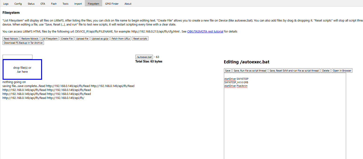

    #21 21914425
    Posts: 14797
    Rate: 12954
    @divadiow did you manage to run BL602 SPI LED on this device? You need to select DIN pin?
    Edit: Works!

    Added after 9 [minutes]:
    startDriver SM16703P
    SM16703P_Init 7 GRB
    startDriver PixelAnim
