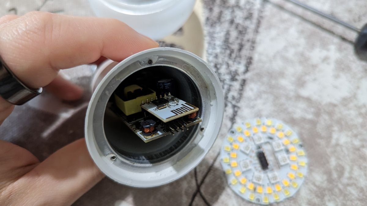

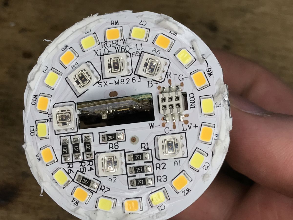

  • Hello!
    I recently came across this board while looking to convert an Aubess/Tuya relay to OpenBeken... And I was wondering what was making my smart lights tchuutchuu! So please join me in this teardown and modding journey :)
    I bought these lights back in 2019 from Amazon France. They are not available anymore, this link is only for reference. The build quality is good, the body is made of plastic and aluminum. It is compatible with Google Home and Alexa but you need the Smart Life app... Which I'm not a fan of.
    The white dome is held secured to the housing with 2 or 3 dots of glue. Simply twist the dome to break the joints, and unclip it from the housing when it starts rotating. The electronics are made of 3 pieces: the LED board, power supply, and driver board. The LED board is held secured to the housing with 3 small screws and a bit of glue: unscrew the screws then use a dental pick or a small flat screwdriver to pry the board up to break the glue joints. Upon reassembly, I would add some thermal paste where the board meets the housing to help dissipate the heat. The driver board sticks through the LED board... Push against it with your thumb while pulling the LED board to keep the power supply + driver boards inside.
    [W600 / AJ-05] Bakibo TB95 9W 1000lm RGBCWW Light [W600 / AJ-05] Bakibo TB95 9W 1000lm RGBCWW Light [W600 / AJ-05] Bakibo TB95 9W 1000lm RGBCWW Light

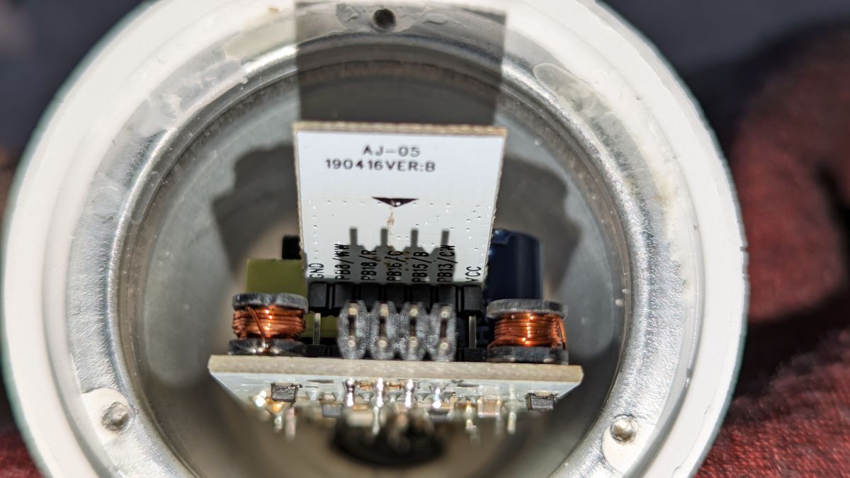

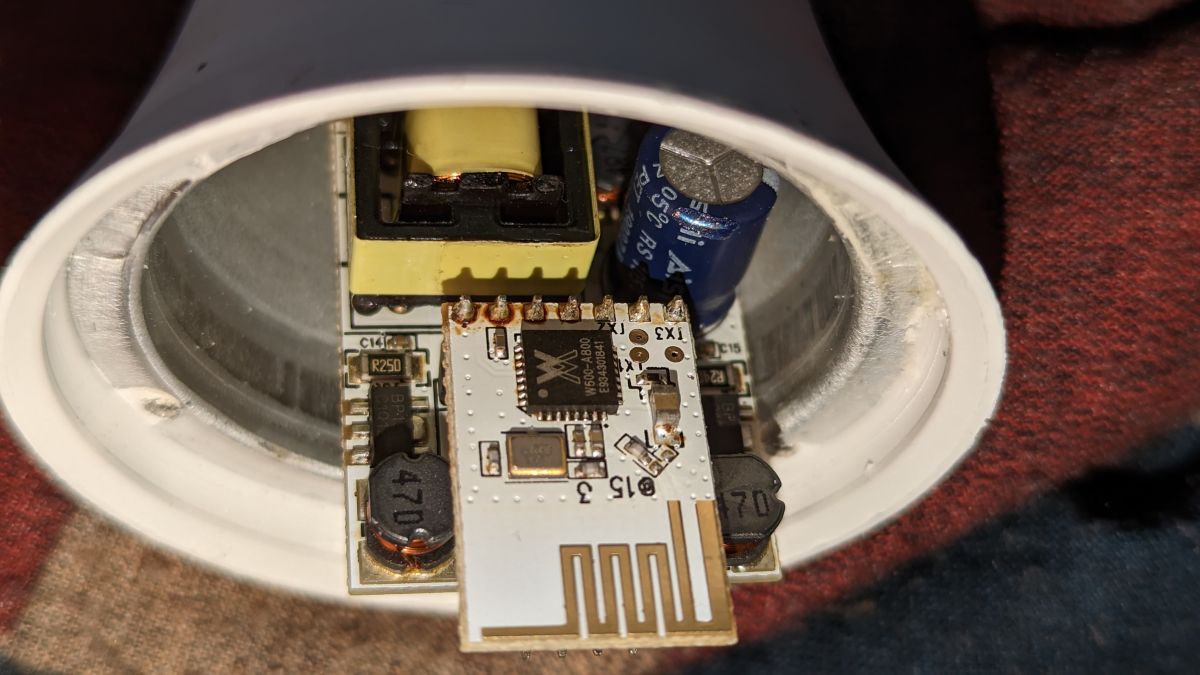

    The driver board is soldered to the power supply. By the way, the power supply looks to be a real switching power supply, which is way better than what you can find in an Aubess/Tuya relay! There might be high voltage in there so be careful, but you could connect a USB-TTL converter to the driver board without fearing of frying your USB-TTL or computer. Back to the driver board, it is identified as "AJ-05" on the back, where you can also see the pinout! That's so convenient :)
    (left to right)
    - GND
    - PB8/WW
    - PB18/R
    - PB16/G
    - PB15/B
    - PB13/CW
    - VCC (3.3v)

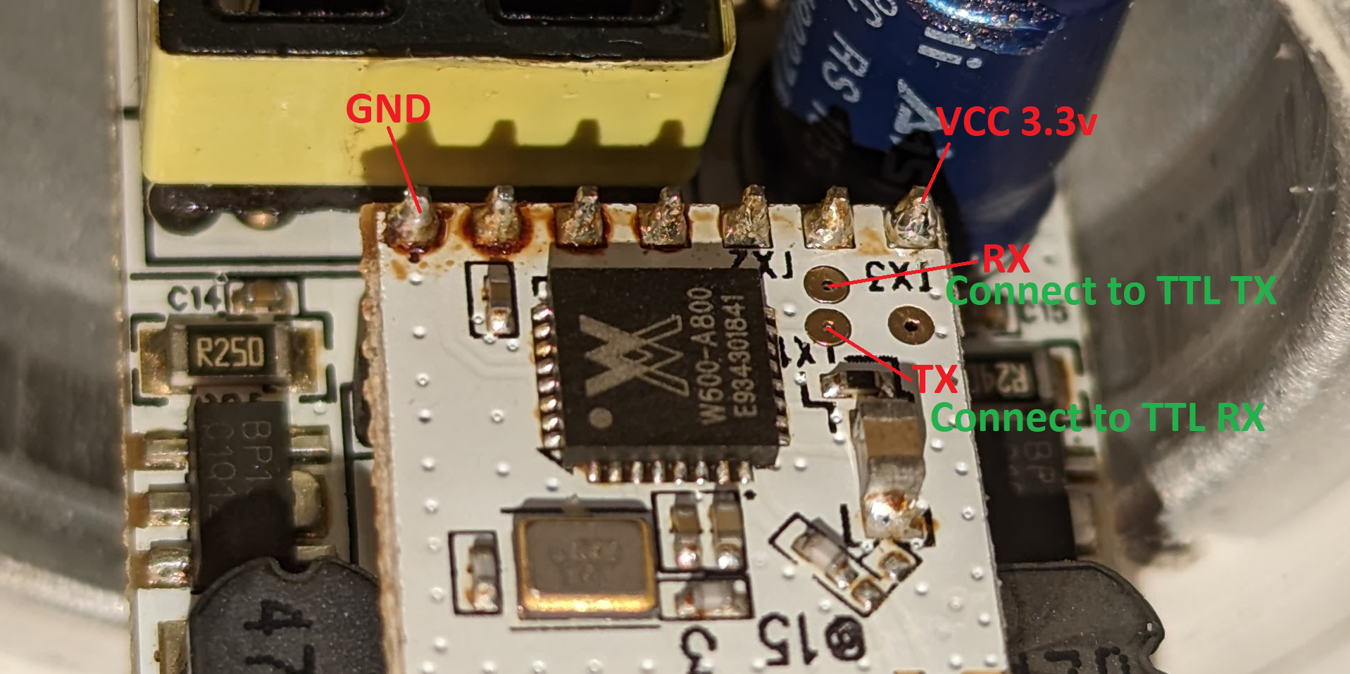

    The board hosts a Winnermicro W600-A800 microcontroller datasheet here.

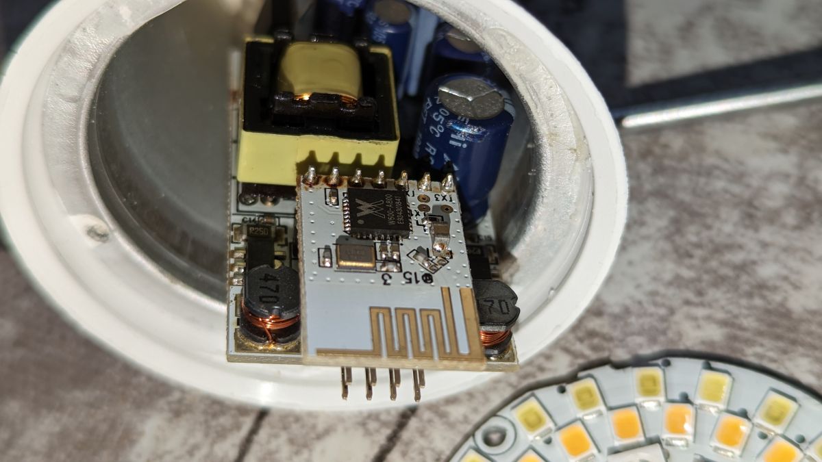

    We can see 3 test pads on the driver board next to the W600 chip, this is where it gets interesting :)
    - TX1 = PA4 - UART0_TX
    - TX2 = PA5 - UART0_RX
    - TX3 = TEST (useless for us)
    In other words... Would you want to connect this lamp to a USB-TTL converter this is what you would want to do:

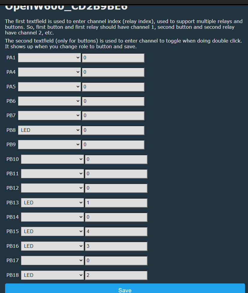

    Reboot the device, and you should see a new Wifi popping up around you called OpenW600something. Connect to it, browse to http://192.168.4.1 and configure the device to match your wills (wifi, mqtt...). Then, configure the pins:
    With these settings, each color has its own channel. However, there is an issue: they are not dimmable. They are either on or off. I tried playing with the settings to get some PWM working but I couldn't get any working results. OpenW600 does not even support PWM on all pins... I'm pretty sure the hardware is capable of outputting PWM on those pins because there is no driver down the line toward the LEDs, only humble transistors. So I guess some modifications would be required on the firmware, I'll look into that later.

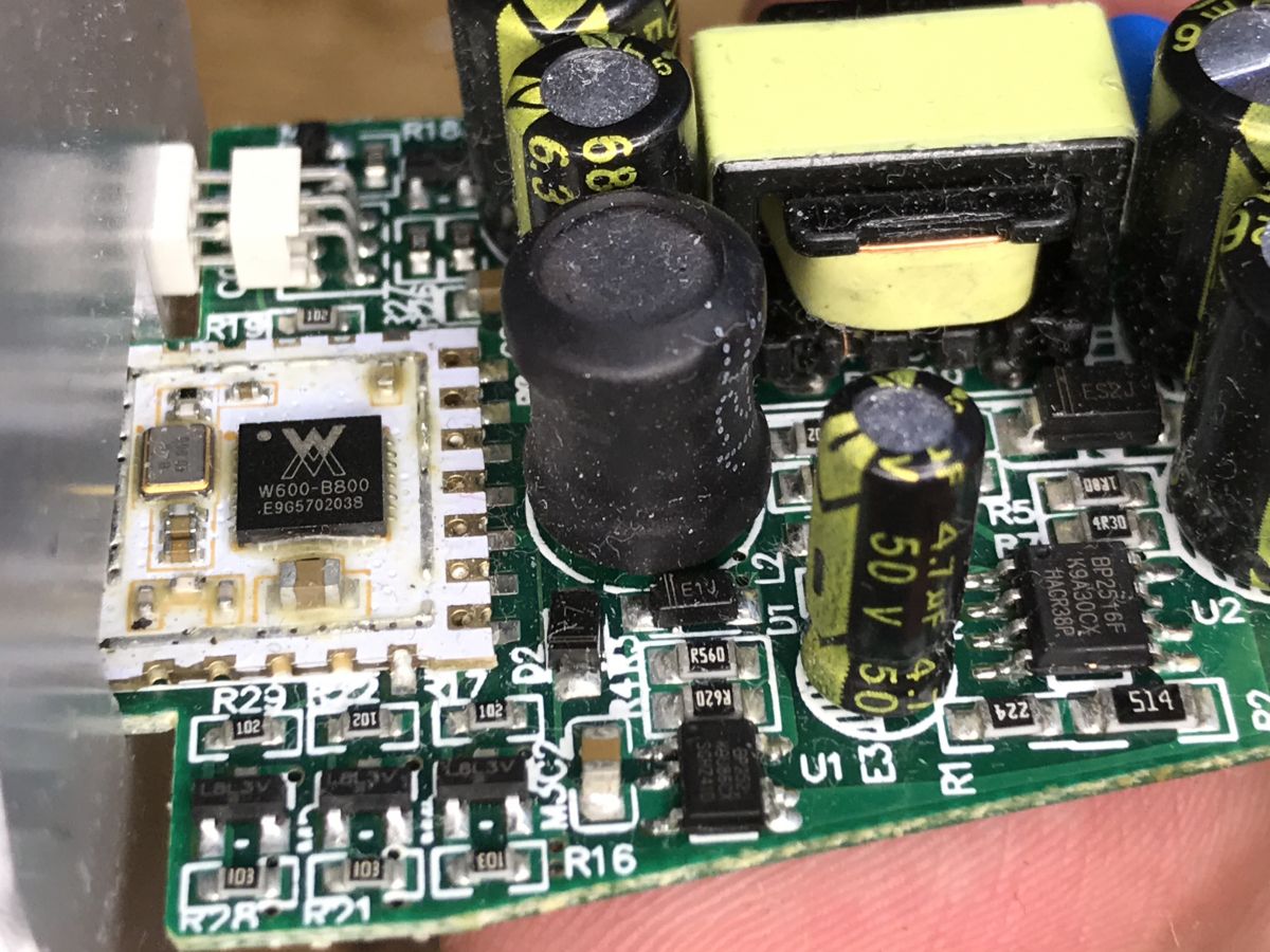

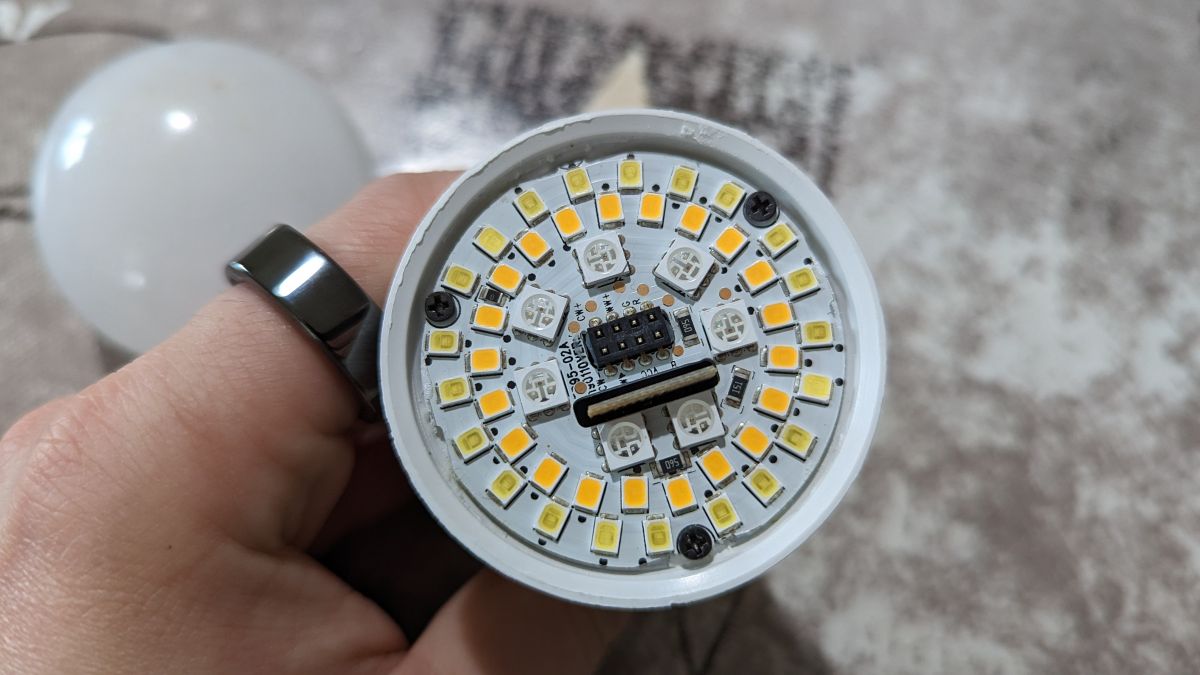

    I also have W600 bulb, not flashed yet:

    Thank you. I may have misconfigured the pins tho... In such a case, I guess setting the pin to PWM should work, correct?
    I already have the code and the compiler on my computer because I also highly modified the Aubess relay I have to add a SHT3x temp/humidity sensor and an IR receiver... The value for the temperature is multiplied by 10 upon measure to allow for float result, however the channel's value is sent "as is" over MQTT. I use Domoticz, and it would display a temperature of 235 celsius degrees instead of 23.5. Setting channelType to temperature_div10 would not change the value sent over MQTT so I changed that... Where the code calls for sprintf, I added a switch case to take the channel type into account, and divide the channel value by 10, 100 or 1000 depending on the type. I can send a merge request if you want.

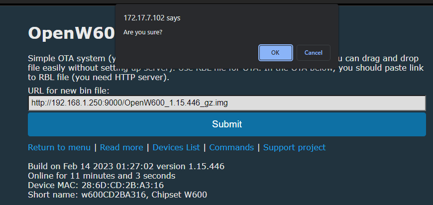

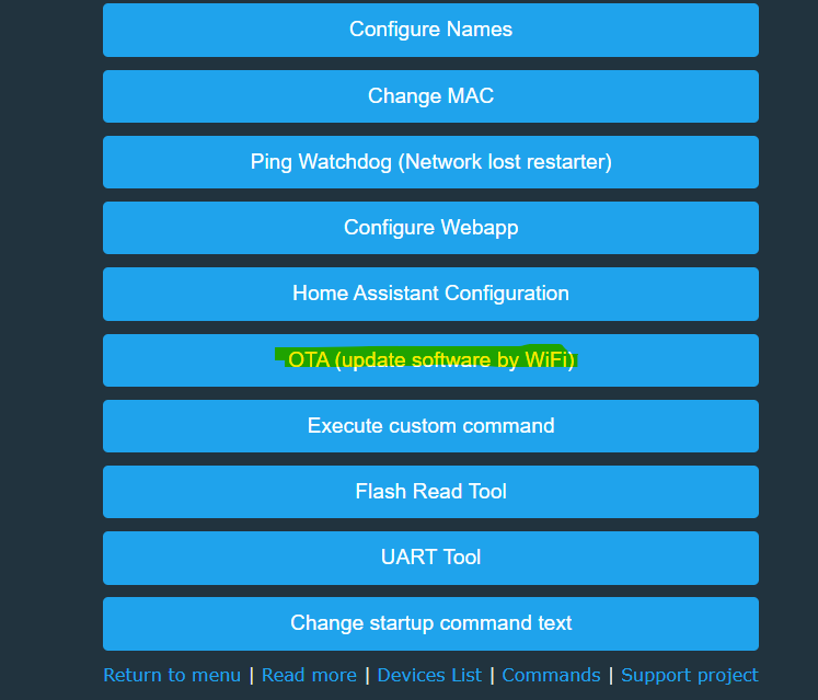

  • OTA fixed in v1.15.446 via old menu
    #5 20438743
    ShadowLight30
    Posts: 8
    Follow-up:
    OTA was broken, even when compiling the firmware locally. It was partially working since I could not even start another OTA from the web app after trying and failing one first time. Something was wrong with the image header. The only way of updating the firmware was via serial...
    Version 1.15.446 fixes the issue, probably since the SDKs update in v1.15.437. I was able to do an OTA through the "old" menu in the config section (it would not work with the previous versions just like in the web app). However, I'm not sure an https link would work from there so here is what I did, assuming these commands are run from a Linux machine with the private IP 192.168.1.250 with Python 3 installed:
    Code: Bash
    So now we have a web server ready to serve the firmware image to the light bulb. Go to the device's config menu and navigate to the old OTA sub-menu, enter the URL "http://192.168.1.250:9000/OpenW600_1.15.446_gz.img" (set the IP address to your Linux machine) in the text field, click Submit and confirm... Wait for the OTA to finish.
    PWM is still broken on my devices tho... I tried to watch for a signal on the oscilloscope on the driver board outputs (off-grid testing) but they stayed flat low whatever the value set on the channel. I wonder if it would have to do with internal pullup or pulldown?

    We've really tried to reduce the OTA image size so it works again. Problem should be solved, at least for the time being.
    HTTPS support would take too much memory, we can't afford that on W600 platform, W600 has very little memory available, as far as I know.
