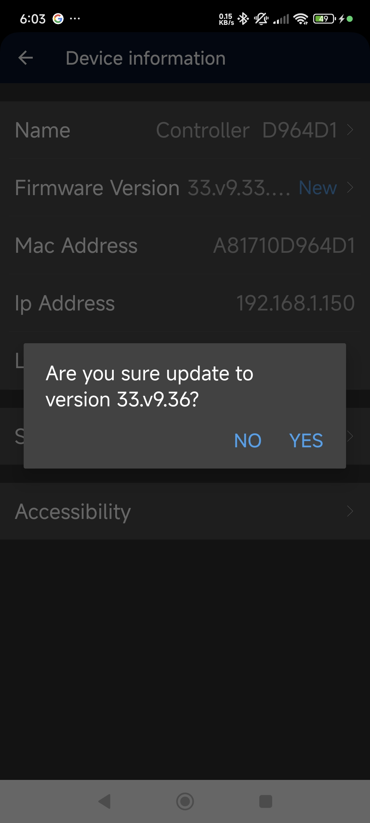

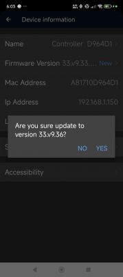

    After turning the power on and off three times, pairing starts. Suddenly, the channels are switched quickly, in sequence R, G, B.
    We then see that an open WiFi network is created for pairing:
    RGB LED strip with IR remote control and WiFi - MWIR-RGB Magic Home Pro
    Trying to pair with the Tuya app
    The manufacturer requires you to use the Magic Home application, but I have most of the tested devices in the Tuya application, so I decided to try it first. Sometimes it happened to me that the devices were compatible between different applications. This is useful when we want to have one ecosystem and create scenarios, automations and control everything from one place.
    Unfortunately, Tuya does not detect this device:
    RGB LED strip with IR remote control and WiFi - MWIR-RGB Magic Home Pro RGB LED strip with IR remote control and WiFi - MWIR-RGB Magic Home Pro RGB LED strip with IR remote control and WiFi - MWIR-RGB Magic Home Pro

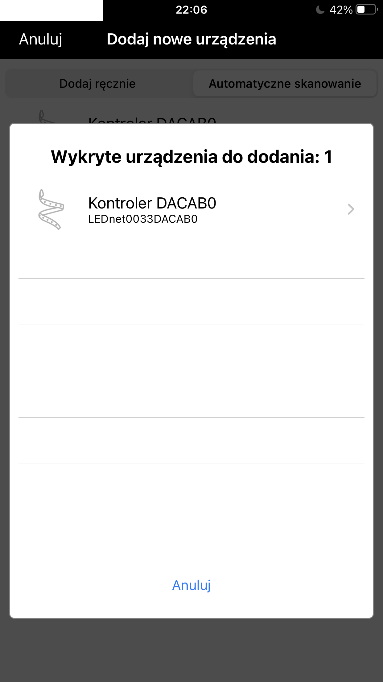

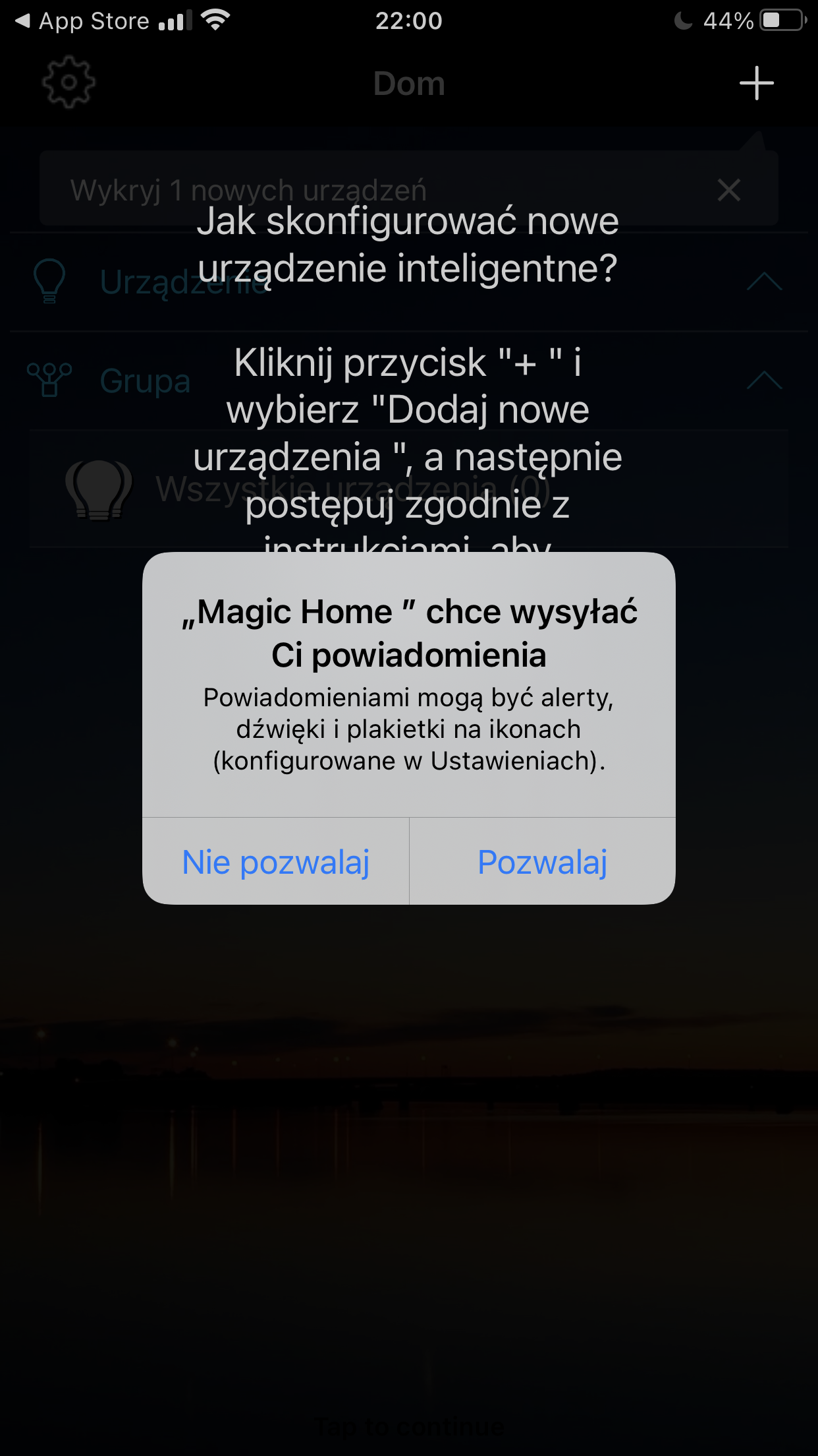

    Pairing with the Magic Home app
    I had to download the Magic Home application from the AppStore, because I use the iOS platform on my iPhone. This application is also available for Android.
    The application should be granted permissions (including location, without this you will not pair the device - more on that later).
    The interface feels like something new. This is not a 1:1 Tuya clone. The application immediately detects the new device:
    Normally you need an account, but you can test the application locally, without an account, only within our WiFi and without saving data in the cloud:
    Then the application asks for access to the location - we have to give it, otherwise there are problems with pairing the device (the application does not see that we are connected to our WiFi network):
    Choosing a WiFi network, entering a password:
    RGB LED strip with IR remote control and WiFi - MWIR-RGB Magic Home Pro RGB LED strip with IR remote control and WiFi - MWIR-RGB Magic Home Pro RGB LED strip with IR remote control and WiFi - MWIR-RGB Magic Home Pro RGB LED strip with IR remote control and WiFi - MWIR-RGB Magic Home Pro
    Problems with connecting to WiFi - as a result of what I wrote earlier, I did not give access to the location:
    Only after allowing location access was I able to pair:
    Ready! Paired.

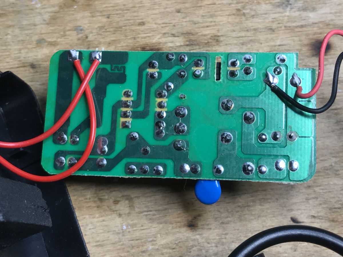

    Inside of the 12V 2A power supply
    The power supply in the set is described as the JSY-1220 model. As a rule, Chinese power supplies are quite low-quality, and sometimes they are even dangerous, so I also decided to look inside. Just pry the housing with a screwdriver, it is on the hooks:
    It's obvious from the start that it's wrong. There is a place for EMI filters and a fuse, but they are not:
    RGB LED strip with IR remote control and WiFi - MWIR-RGB Magic Home Pro RGB LED strip with IR remote control and WiFi - MWIR-RGB Magic Home Pro RGB LED strip with IR remote control and WiFi - MWIR-RGB Magic Home Pro RGB LED strip with IR remote control and WiFi - MWIR-RGB Magic Home Pro RGB LED strip with IR remote control and WiFi - MWIR-RGB Magic Home Pro
    Of course, there are other problems as well. For example, the class Y capacitor, the one connecting the secondary and the primary side, is replaced here with the usual 2kV 222 (2.2nF).
    One of the electrolytic capacitors on the secondary side was also omitted. The manufacturer has probably never even heard of varistors. Not about surges.
    It's only worse at the bottom of the plate. It is true that the manufacturer tried to make a fuse from the path, but is it a good method?
    The solders are also very weak, the electrolytic capacitor is almost cold solder:

    Start pairing with the Magic Home app via Bluetooth (?):
    rtc not init!Please check!!!
    (mac-B4E842DACAB0)-(10.10.123.3)-(common:3.0.9_build2)-(fw:33_33_20201024_ZG-BL-IR)-freeheap:46120-st1:37-st2:0

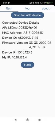

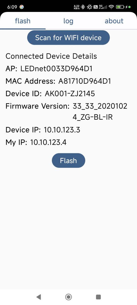

    There was a flash dump containing the string AK001-ZJ2145 at FlashDumps\IoT\BL602\10wRGBCWbul\Bl602Lamp-4th\dump.bin (old path) which I assume was from this device (although the naming would suggest an RGBCW bulb). It would not flash back to a test device, giving this error in Bouffalo Labs Dev Cube
    I transplanted 0x0-0x10000 from another Zengge BL602 device and the firmware now boots and pairs with MagicHome/Zengge apps. That new file is available as Zengge_RGB_LED_AK001-ZJ2145_33_33_20201024_ZG-BL-IR.bin at https://github.com/openshwprojects/FlashDumps/tree/main/IoT/BL602
    Additionally, the Magic Home app offers an OTA upgrade to 33.v9.36 from 33.v9.33.7601-A
    Dialog box asking about software update to version 33.v9.36 on a mobile device.
    but none of Zengge/MagicHome/Surplife apps are a success in upgrade, with MagicHome giving this on 2 phones tried:
    mhflasher is a success with this one so it's been added to the tracking doc.
    Screenshot of an app displaying device connection details.
