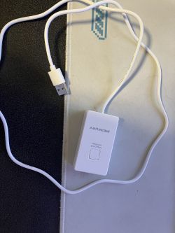

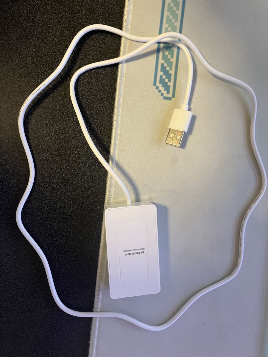

    Appearance:
    Main body:
    [BK7231T (WB3S)] Merkury Smart Wi-Fi LED Strip [PN: MI-EW014-999W] [BK7231T (WB3S)] Merkury Smart Wi-Fi LED Strip [PN: MI-EW014-999W] [BK7231T (WB3S)] Merkury Smart Wi-Fi LED Strip [PN: MI-EW014-999W]
    I did find it interesting that the main body says RGBW, and the socket supports RGBW, when this only and RGB strip. The circuit board also the circuitry for the W, so that makes me wonder if this was sold as an RGBW strip as a different part-number in which case the teardown and flashing would look similar.

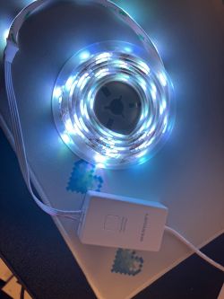

    LED Strip:

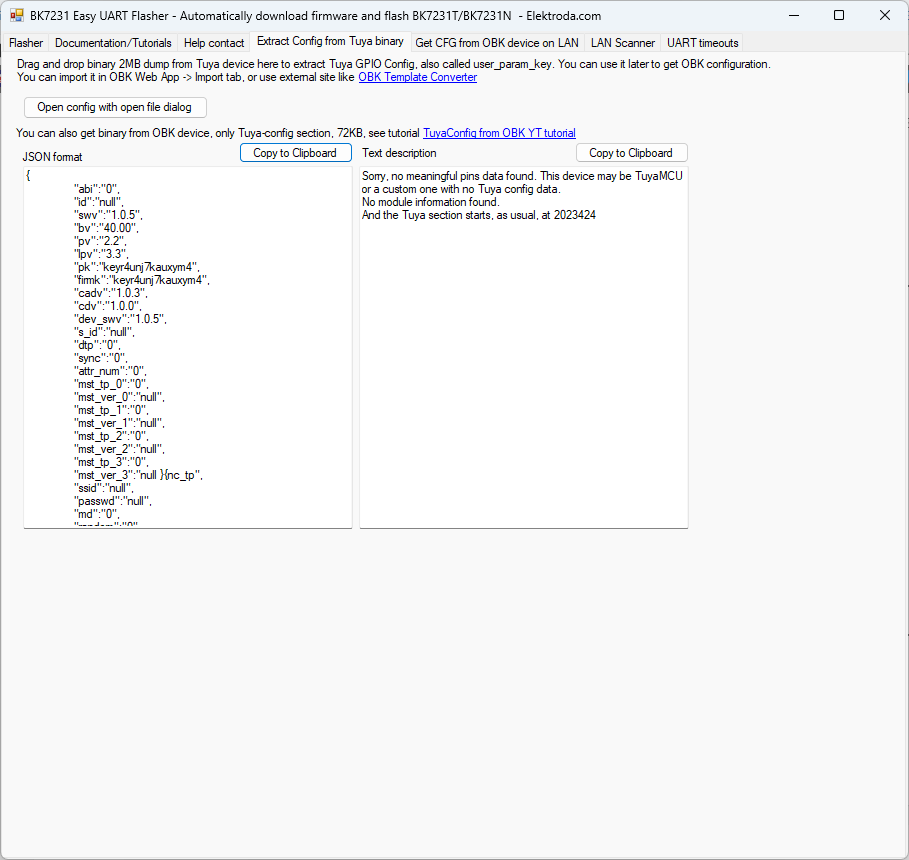

    I have a similar model, but I cant figured out the config to use.. MI-EW011-999W. I was able to get it flashed to OpenBK, but not sure how to configure it..
  • #4 21059344
    Posts: 14763
    Rate: 12893
    Can you do config extraction?
  • Second unit exposes BK7231T device JSON data
    #5 21061528
    mchipser
    I tried it on a second one.. this is what I get..
    Screenshot of BK7231 Easy UART Flasher program displaying JSON data and a text description.

    If there is no decodable configuration in your Tuya JSON partition, then the next step is to use the GPIO doctor tool from the OBK Web App. Use it to check each GPIO one by one and note which LEDs are controlled by which GPIO.
