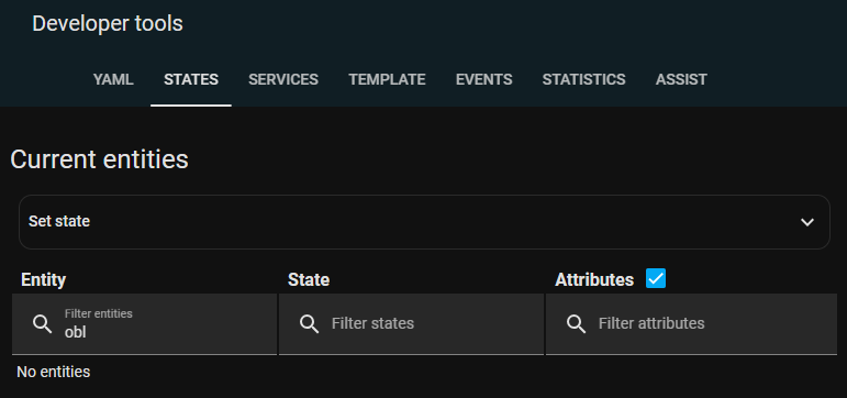

    But no devices or entities appear in Home Assistant.
    Configuring OpenBeken on MagicHome RGBW-IR with BL602 for Home Assistant Discovery
    Today I upgraded again to 1.17.248 and tried running Discovery again, but still nothing is getting added to Home Assistant.

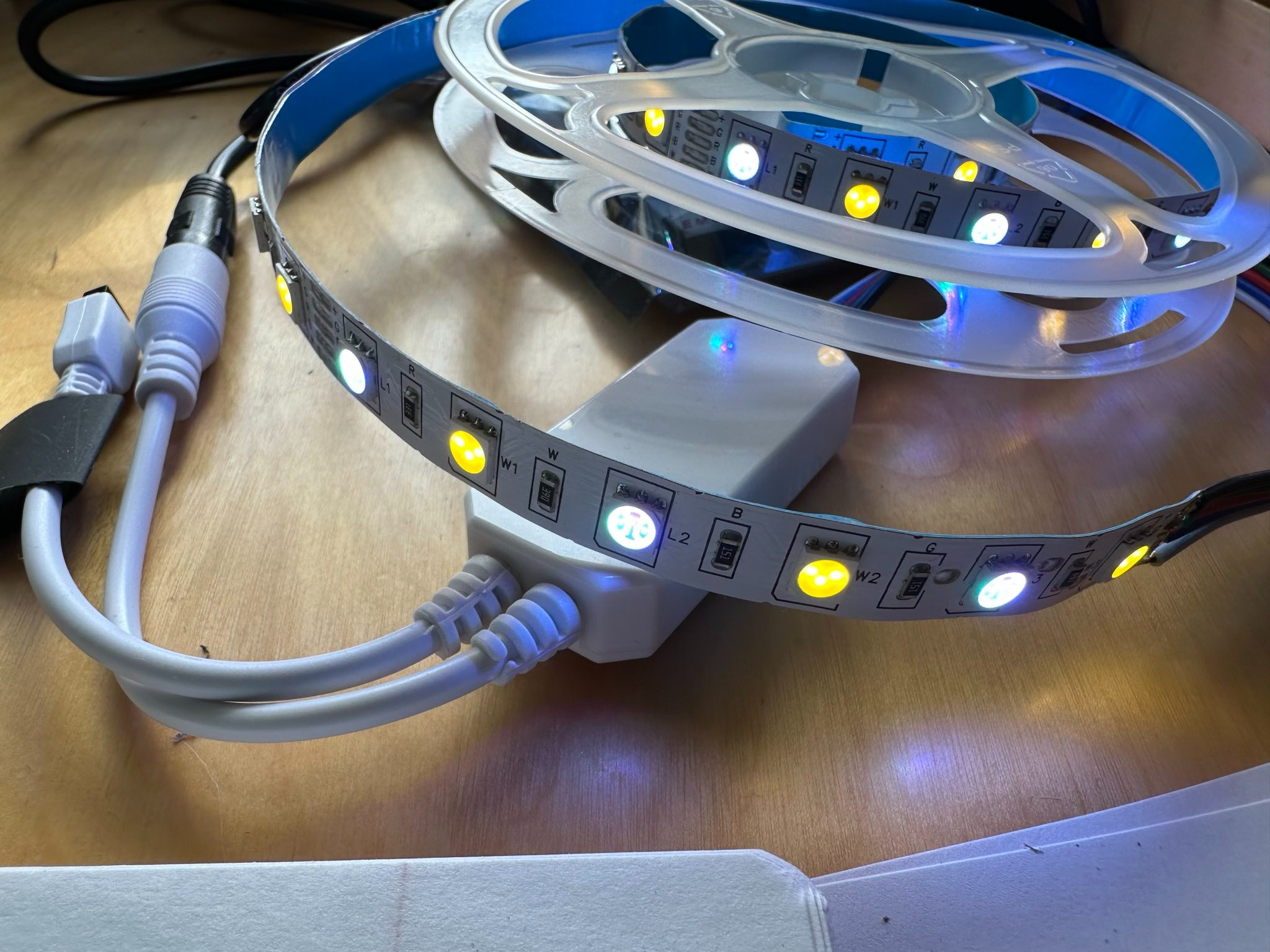

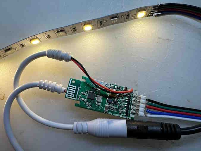

    Here's the LED strip lit up and working with the White LEDs - the RGB LEDs also work, I just can't control it from Home Assistant yet.

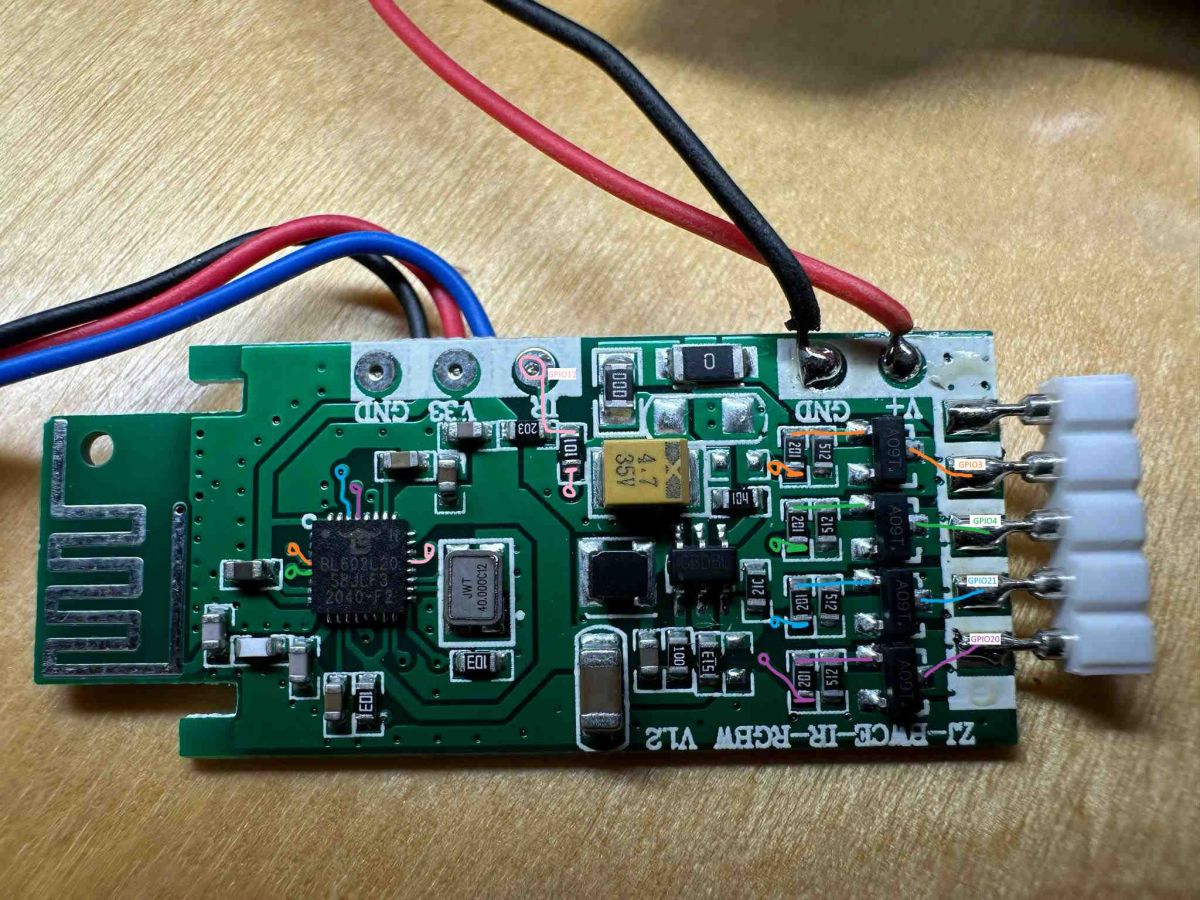

    And here's a photo of my specific controller with the ZJ-BWCE-IR-RGBW v1.2 board with the Buffalo BL602 L20 S8JlF3 2040-F2 chip.

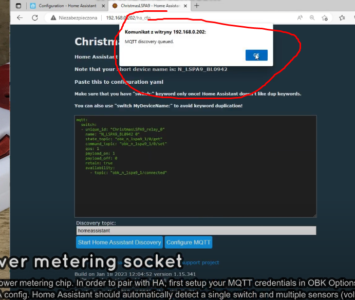

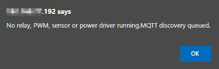

    Hello, do you get that message?
    A browser screen message regarding MQTT discovery queued.
    What happens in HA logs when you get that message?
  • #3 20741294
    MrShannon
    Posts: 9
    I do, but it actually says "No relay. PWM sensor or power driver running. MQTT discovery queued."
    Error message: No relay, PWM, sensor or power driver running. MQTT discovery queued.
    I see nothing new in the Home Assistant Core log nor in the Mosquitto broker log. Is there somewhere else to look?

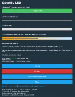

    I also noticed that if I go to "Launch Web App" / Tools, I can use the buttons for 100% Red, 100% Blue, 100% Green and 100% Cool all work, but 100% Warm does nothing.
    Screenshot of LED tools menu with six buttons: 100% Red, 100% Green, 100% Blue, 100% Warm, 100% Cool, Toggle LED.

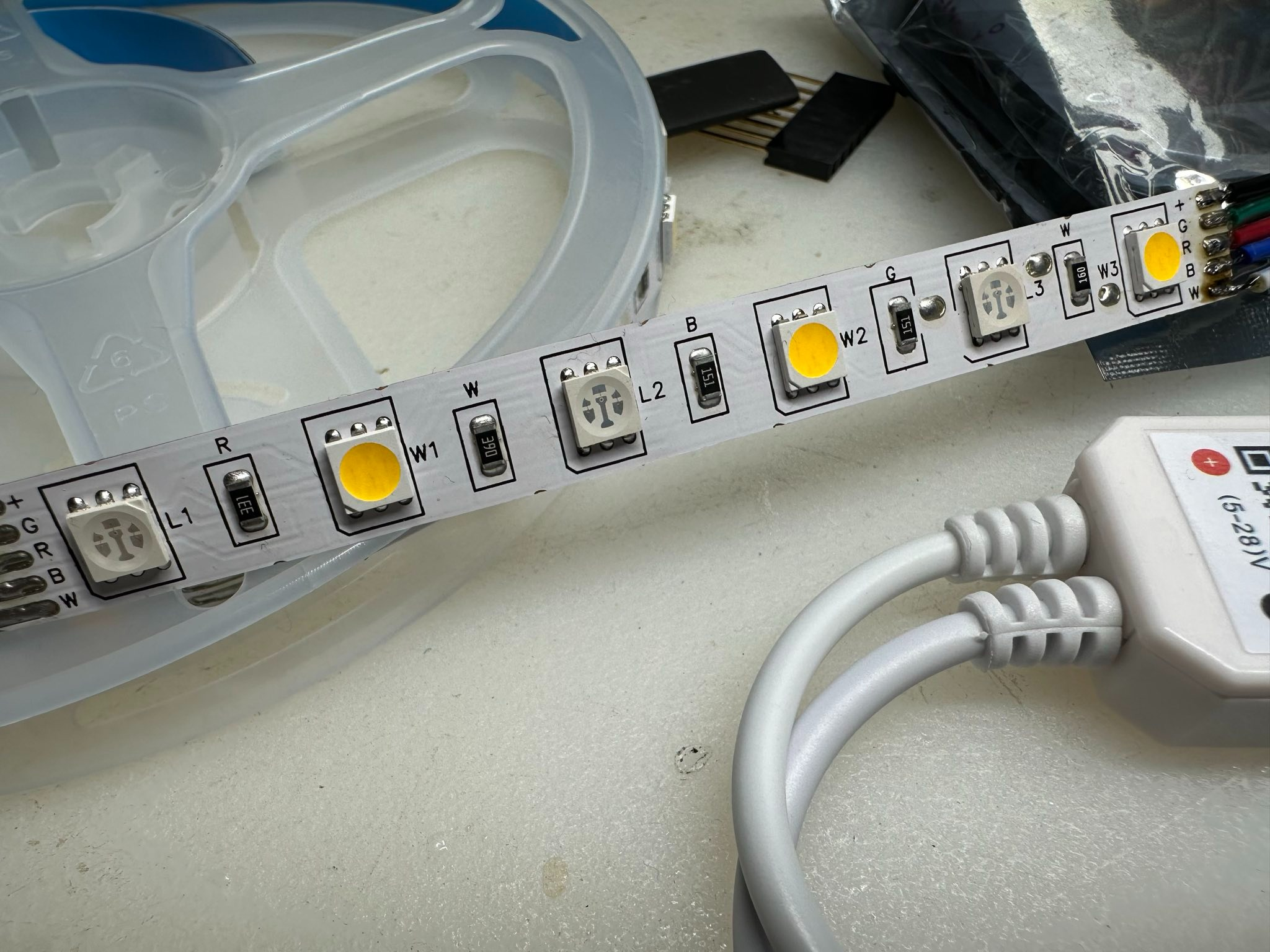

    I know the RGBW strip I am using has a dedicated White LED, and mine happen to be Warm (not Cool), so I am not sure why there are different buttons for Warm/Cool in the Tools. I thought maybe the 100% Cool button would use the RGB LEDs to make a cool white, and the 100% Warm button would use the dedicated White channel. Is that configurable?

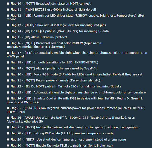

    Look at the Flags page and play with them. The 24th looks good.
    My firmware is old, I don't know if the Flag numbers will match yours.
    List of software feature flags with selected options.

    Flag 24 did sound like it might do the trick, but when I turn that on the White LEDs stop working and the RGB LEDs just 'emulate' the white channel. In fact, the controller just completely stops using channel 4, so I have disabled that flag again.
    Do I need to configure the pins differently? My LED strip is pretty simple, but I don't know what the model is. They are not individually addressable so there is no IC chip and no data wires, just the ground wire and then 4 channels, one for each LED. Even the Tasmota guide for the Magic Home controller talks about using PWM, so I assumed PWM was the right setting for this strip.
    LED strip with wires and controller on a white surface.
    I don't understand why the YAML is making 4 individual lights instead of a single RGBW Light?

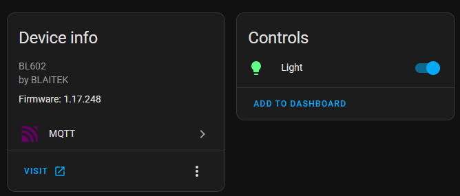

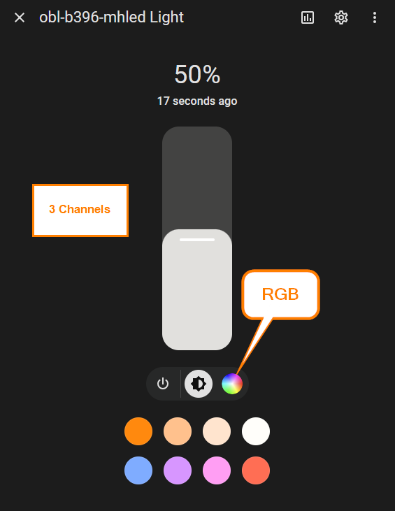

    Hey, good suggestion spin55! I did not try an older version, but I did remove the settings from the white channel pin.
    Apparently having a fourth PWM channel is not being handled like I need it to. With only the RGB channels set, it generated some very different YAML code than before and similar to what you posted:
    Code: YAML
    and Home Assistant Discovery did send the message to the MQTT broker on the "homeassistant" topic!
    This was picked up by HA and now there is a device named "obl-b396-mhled" with a "Light" entity that I am able to use the strip with the color LEDs...but not the white. Still, that's progress!
    Screenshot of device info for BL602 and light control options
    Any suggestions how I can help getting this working with all four channels?

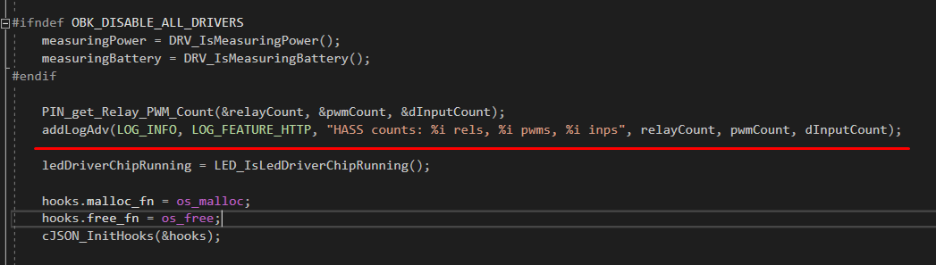

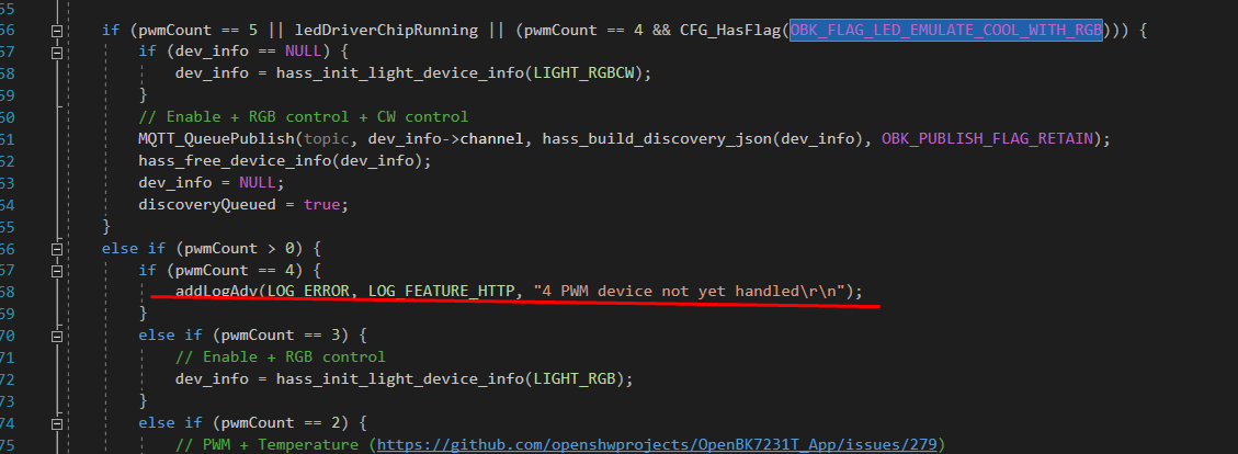

    I checked the code and it really looks like it should work. I also added a self-test to Window build and it passes it.
    I have no idea what's wrong at the moment, so I added this debug log:
    Screenshot showing a snippet of C code involving PWM counting functions.
    Can you update to latest build (it will be available in 15 minutes), of course don't power off during update, and try new version and check what does the log say? What are the seen PWM counts?
    Of course, I assume that:
    - you have 4 PWMs set
    - you have enabled flag 24 (OBK_FLAG_LED_EMULATE_COOL_WITH_RGB)
    It will not work otherwise with 4 PWMs at the moment. You would get that error:
    Code snippet in an editor with a highlighted error message line related to handling 4 PWM.
    of course, first set flag, then do discovery.

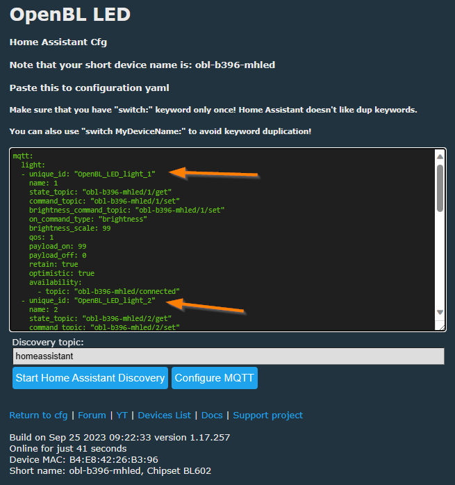

    I updated to 1.17.257, but whenever I add a fourth PWM pin the YAML that is shown in the "Home Assistant Cfg" page creates four "unique_id:" entries. This happens if I use Channel 4 or channel 5, and if Flag 24 is on or not.
    Screenshot of Home Assistant configuration with unique IDs.
    Code: YAML
    The odd thing is, when I hit "Start Home Assistant Discovery", it sent the same discovery message as if it still only had 3 pins configured. It's as if adding the 4th pin isn't being processed somehow.
    I watched the logs on the OpenBeken Web App and, there were a LOT of messages about "secondsWithNoPing" in there, but here's what I saw when I would make changes. It's also worth noting that there was only activity in the log when I change the pin configuration. There were no log entries when I changed the flag.
    I set Flag 24 OFF and removed the fourth PWM channel. This made a YAML configuration for RGB with only one unique_id for "OpenBL_LED_light" and posted a discovery message to Home Assistant
    Leave Flag 24 OFF and add a 4th PWM pin on channel 5. This created a YAML configuration with four unique_id's "OpenBL_LED_light_1", "OpenBL_LED_light_2", "OpenBL_LED_light_3" and "OpenBL_LED_light_5" but did not send any messages to Home Assistant.
    Turn Flag 24 ON and remove the 4th PWM pin. This made the same YAML configuration for RGB (no W) with only one unique_id for "OpenBL_LED_light" and posted a discovery message to Home Assistant
    Leave Flag 24 ON and add the 4th PWM pin on Channel 5 again. This created the same YAML configuration with four unique_id's "OpenBL_LED_light_1", "OpenBL_LED_light_2", "OpenBL_LED_light_3" and "OpenBL_LED_light_5" but did not send any messages to Home Assistant.
    Does that help?

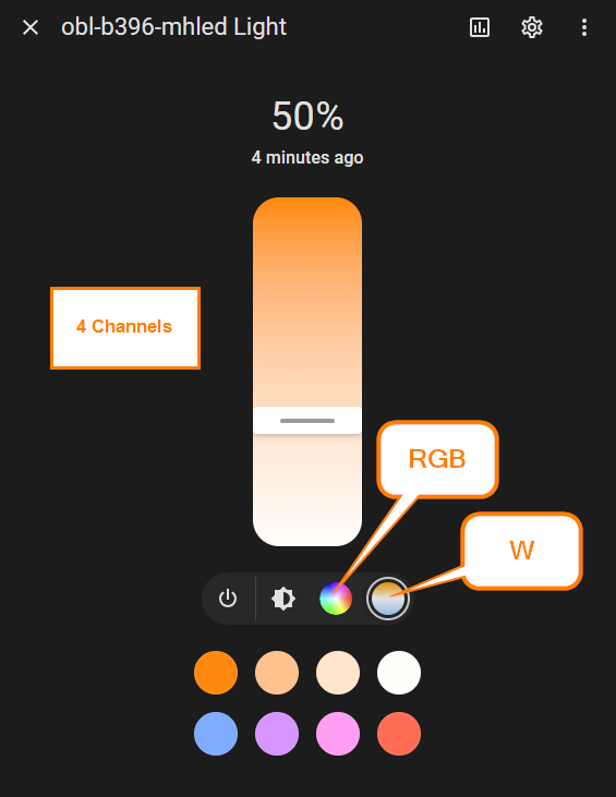

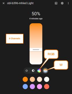

  • OpenBeken RGBW discovery exposes separate RGB and white controls
    #14 20747335
    MrShannon
    Posts: 9
    Why do you think that it didn't publish any messages?
    That's a fair question. What I shared from the logs was what happened after I would change the PIN settings and hit Save on the "Configure Module" page. When I changed the Flags or when I hit "Start Home Assistant Discovery" is when nothing would get posted to MQTT. It seems that changing the PIN settings was automatically posting the discovery message, which is good, but I was unable to do it manually.
    That, and the YAML being generated when I set up 4 channels doesn't look right, so even if I could force it, I think it would be...bad.
    When I only have the three channels configured, Home Assistant only shows the RGB color picker
    Screenshot of Home Assistant lighting interface with three channels and RGB control.
    But, after you pointed out the discovery message was posted after adding the 4th channel, I looked again and realized that the Light Entity in Home Assistant now has both an RGB and W control.
    Light control interface with four RGB and W channels

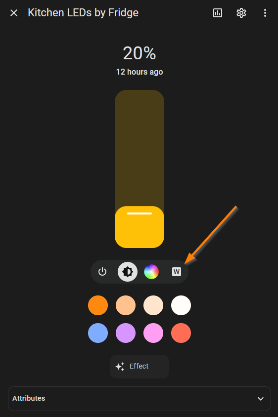

    The odd part is that the controller is allowing both the RGB and W LEDs to be on at the same time. I can turn off Flag 24 to prevent both from being on, but then "Cool White" no longer works.
    LED strip with RGB and white diodes connected to a controller.

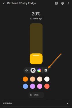

    This is pretty different from how the Magic Home controller manages things. There, the Light entity shows an RGB and W control, but the W is just an on/off button and not a color temperature picker. The White LEDs on the strip are a fixed temperature and only their brightness can be adjusted. Here's an example of the same hardware under Magic Home.
    LED lighting control interface in a kitchen with a slider set to 20% and options for color and brightness selection.
    Is there a flag I should be setting to make the OpenBeken controller behave like this?

    Leave Flag 24 off, and set a fourth channel to PWM on channel 5
    Turn Flag 24 on, then remove the fourth PWM channel
    Finally, leave Flag 24 on and add the fourth PWM channel
    After that, I disabled Flag 24 to prevent the RGB and W channels from being used at the same time, but that did not create any events in the log.
    Then I rebooted it just to see the log entries and saw a few things of interest.
    First, the password for the Wifi SSID -and- the MQTT is clearly in the logs... this might be ok for debugging, but I'd recommend not doing that on a real release. It would make sharing logs potentially dangerous! Maybe replace the clear text password with '***' or something?
    Second, there is a message about the "IR" driver being "not known", is that just meaning future work is needed to implement the IR controller?
    And finally, there was an error about 'startScript NOT found' - not sure if that really matters either at this point.

  • Request for white-channel brightness without color temperature
    #17 20775417
    MrShannon
    Posts: 9
    Is there a configuration or flag that I can set to expose the controls for an RGB color selector and brightness, but the White LEDs are just on/off/brightness without a color temp? Like this:
    My controller/strip has only a dedicated Warm LED, and if I switch from the RGB to the White channel, the temperature picker is not appropriate. Sliding the picker all the way to warm basically sets the White LEDs to 100% brightness, and sliding to cold just turns them off because there are no Cool LEDs to turn on.
    I've updated to 1.17.276 and found if I turn on Flag 24 the RGB LEDs will emulate the Cool White. This also means adjusting the color temp basically adjusts the brightness of the W and RGB channels to create the selected color temperature. This also means all of the LEDs on the strip would be on at the same time, and I'm not sure if that's... safe?
    If possible, I'd prefer to have the White channel only allow on/off/brightness settings and to not provide a color temp option. That would prevent all the LEDs in the strip from being on at the same time, but I could switch between a color selection and white.

Why is my device not appearing in Home Assistant even though MQTT shows connected?
Trigger discovery and check OpenBeken’s message: “No relay. PWM sensor or power driver running. MQTT discovery queued.” That means the device queued discovery but HA may not reflect it yet. Review HA and broker logs for a discovery payload on the homeassistant topic. If still missing, simplify to three PWMs and retry discovery to confirm the pipeline. [Elektroda, MrShannon, post #20741294]

I see “4 PWM device not yet handled” in logs. What should I do?
That message indicates 4-PWM discovery handling is incomplete. Enable Flag 24 first, then re-run HA discovery. The author shows that without Flag 24, discovery halts with that error. After setting the flag, discovery continues and publishes the RGBW config. [Elektroda, p.kaczmarek2, post #20746449]
