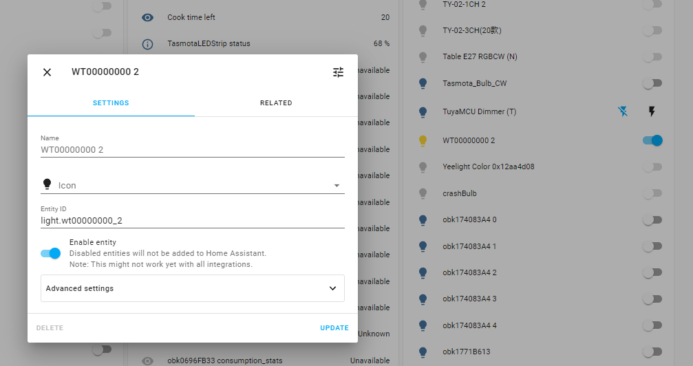

    Is there any way to show devices as lights in Home Assistant? Similar to SetOption30 in Tasmota?
  • #2 20444548
    Posts: 14793
    Rate: 12941
    Hello, it is not possible yet, but it seems simple. So you basically want the HA discovery to put all relays under "light:" section as well, instead of "switch:" section?
  • Request for per-channel light and switch entity mapping
    #3 20447064
    jbrande
    Level 4  
    Posts: 25
    Yes please, it is a small thing but if not you have to import it and then change it to a light and it creates a link between the switch and the light.
    Right now I'm importing it manually as mqtt in the yaml, but I prefer to show them as devices with all the links between light and switches.
    Also if you can choose by channel it would be nice, like if you have a light and a fan to choose one as light and one as switch on each channel
  • Enable flag and rediscover device as light
    #4 20447147
    Posts: 14793
    Rate: 12941

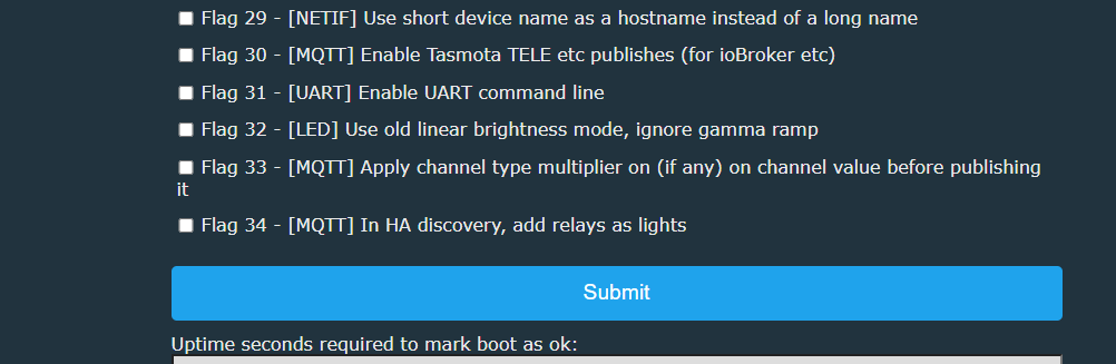

    Ah okay, here it is:
    https://github.com/openshwprojects/OpenBK7231...mmit/f346c6169e3d0756a230d8315f5bb1c83742c2cb
    Enable this flag:
    OpenBeken: Displaying Devices as Lights in Home Assistant - Similar to Tasmota's SetOption30
    Remove entity from HA.
    Redo HA discovery.
    It should appear as light:
    Can you check if it works for you? I only tested it on Windows OBK simulator:
