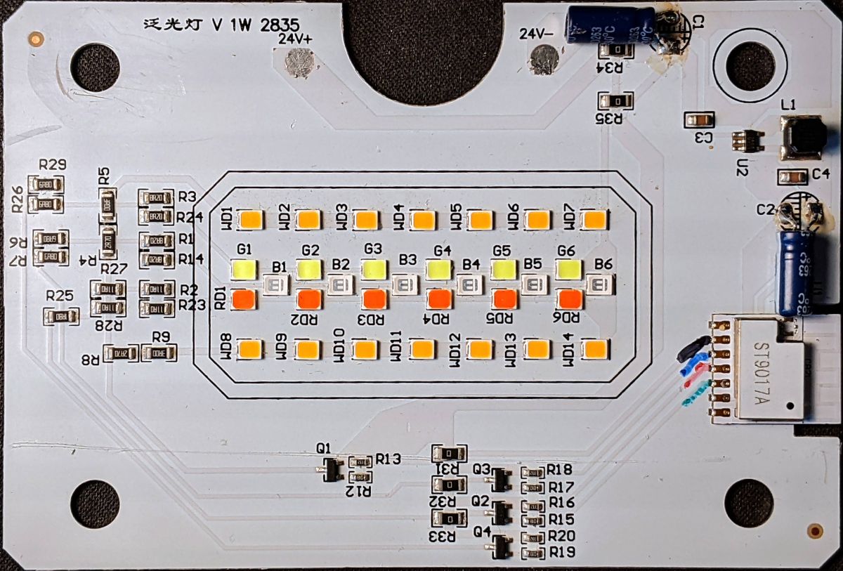

    I have this light apart.
    Disassembly was destructive in nature, so I don't recommend opening it up unless you have other plans (like I do).
    The exact module used is the CB2L, the same one as in the outdoor spotlights formerly mentioned. I took those apart a year or so ago and posted a teardown on here.
    Component-wise:
    - CB2L module, flat on its back
    - local step-down regulator for the logic control
    - 24V input
    - 2835 LED's
    - AO3400 N-channel MOSFETs
    - LED's:
    - Warm white: 2 parallel strings of 7 in series
    - Red: 6 in series
    - Green: 6 in series
    - Blue: 6 in series
    - PWM lines:
    - Warm white: PWM1 (P7)
    - Red: PWM5 (P26)
    - Green: PWM4 (P24)
    - Blue: PWM0 (P6)
    Circuit board with a light module, LEDs, and electronic components.
