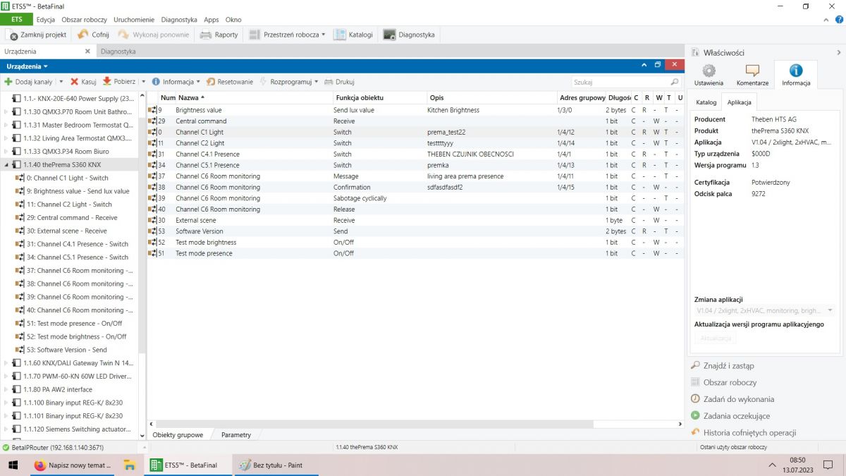

    Hello, I have a problem with the presence sensor Theben thePrema S360 KNX.
    I am not able (in normal mode) to get values about presence, lighting activation, only the brightness measurement works well. I add that in test mode everything works ok.
    The device is set in motion detection measurement mode without taking brightness into account.
    I do not receive presence values from theben thePrema S360 KNX sensor in normal mode
    Attached I add the report and settings of the device. DeviceDeta...Report.pdf (1021.46 kB)You must be logged in to download this attachment.
    I tried:
    - update device application to latest version
    - change device flags transmit, read, write, update
    - reset device and full programming from scratch
    I would go through test mode because I can run it for 60 min but the device flashes red.
