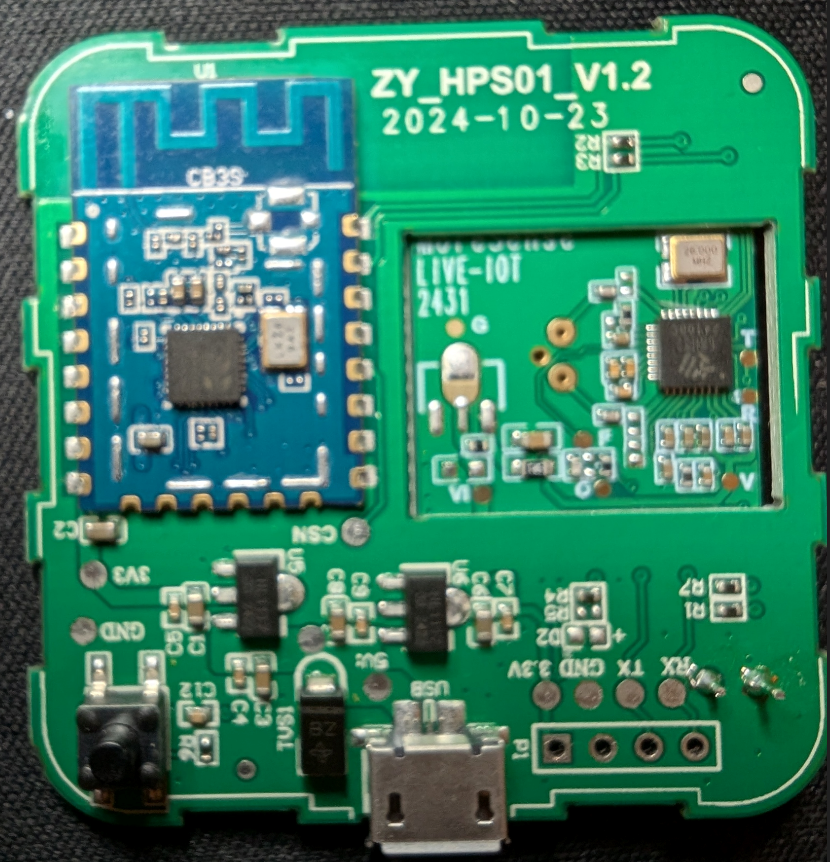

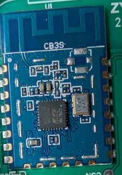

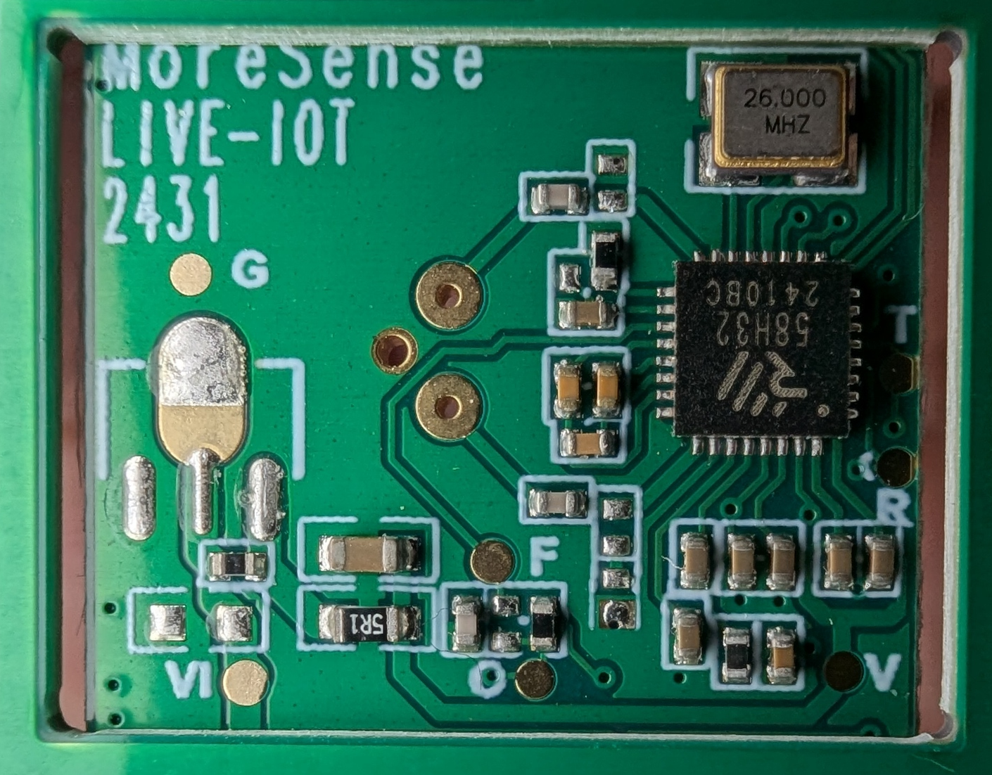

    Hi, first time posting here. I have a presence sensor bought on AliExpress by mistake (Click bait?) and I would like to flash it but this is more a test run for something else since I already have a few of these in Zigbee. So, I flashed a couple of 8266 a while back and it was pretty easy, but this looks like a more daunting task.
    Close-up of a MoreSense LIVE-IOT 2431 electronic module circuit board with visible components and labels.
    Printed circuit board (PCB) with electronic modules and a micro USB connector.
    CB3S electronic module mounted on a PCB, with visible SMD components.

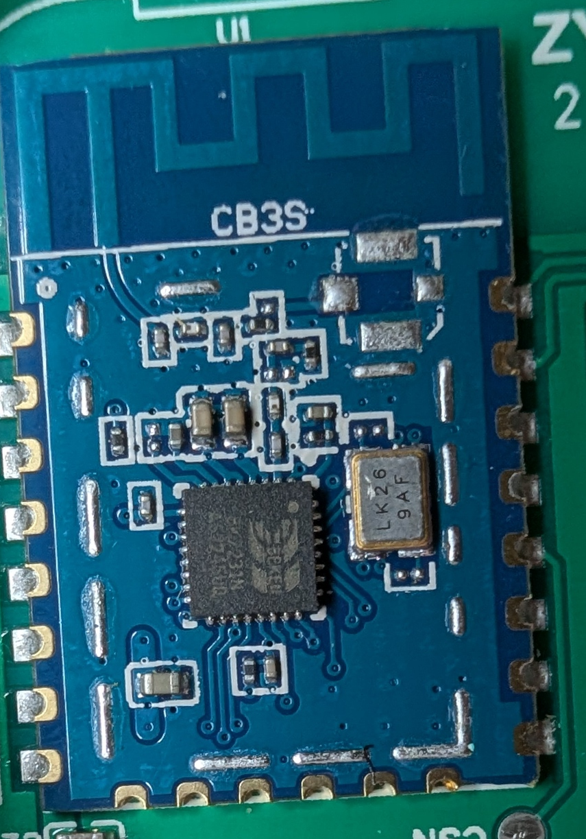

    On the board there is the name ZY_HPS01_V1.2, the module is a cb3s and I think I got the pin right. Even if there is no Tuya Mcu on the board is it possible that the motion sensor chip is connected on the TX RX? And preventing me from flashing it? I added picture of the board and chips, and a portion of the log of the flasher. It did output another key than Encryption key: 00000000 00000000 00000000 00000000

    AI: Can you share exactly how you’re connecting the CB3S module for flashing (e.g., which USB-to-serial adapter you’re using, wiring details, and whether you’re powering the board separately or through the adapter)?
    I am using a USB FTDI FT232RL, I did try powering the device through an external source but got the same results.
    AI: Did you put the CB3S module into flashing mode before trying to flash it? If so, how did you do it (e.g., holding a button, grounding a pin, etc.)?
    There is a reset button and I tried holding it, pressing it a couple of second, at intervals (~2sec). The only thing that made me have some kind of information out of the chip was power off/on and cen to ground.

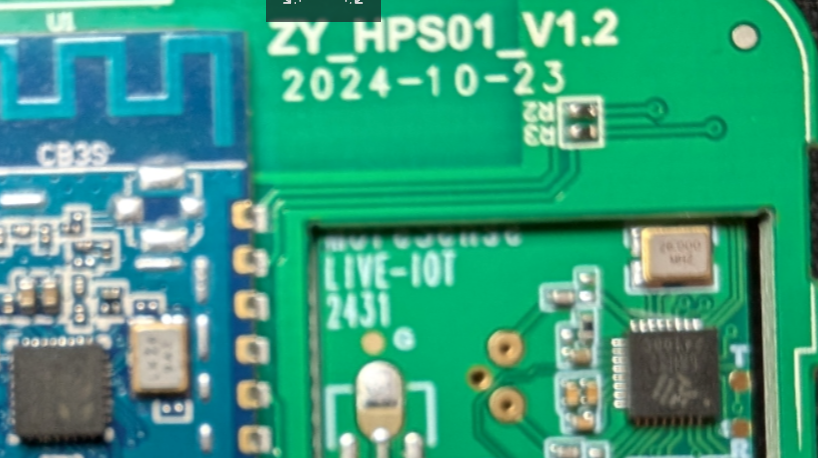

    It looks like your device has something connected to UART port.
    Close-up of a PCB with a CB3S module and the marking ZY_HPS01_V1.2 dated 2024-10-23.
    Try disconnecting it (desoldering those two resistors or desoldering CB3S entirely).

    Hi, thanks for the quick answer, that's what I expected but hope that was not the case. Is the log consistent with a blocked/occupied UART? On my side I am not equipped for desoldering, so I hoped that someone would say that you just don't press the button hard enough. :-) When I did the 8266 there was spot on the board directly linked to the chip. In this device case the obvious ones are linked to the sensor chip if I am not mistaken. I might give desoldering a try but that won't be today, is it easier to just remove the cb3s (heat gun) or unsolder the resistors?
  • #4 21523521
    Posts: 14795
    Rate: 12945
    You can still try different baud rates, but for reliable operation, clearing UART lines is always recommended.

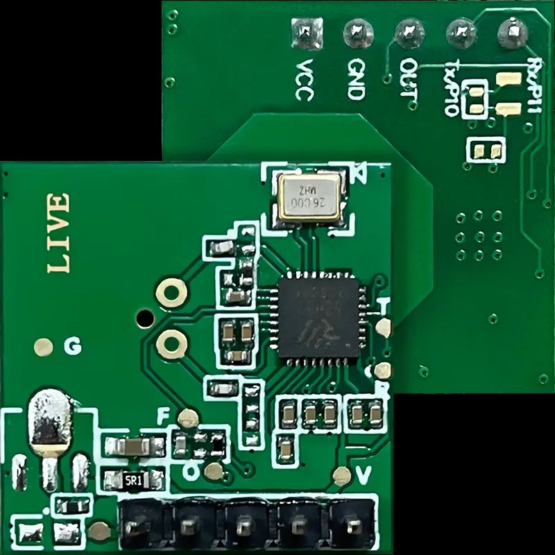

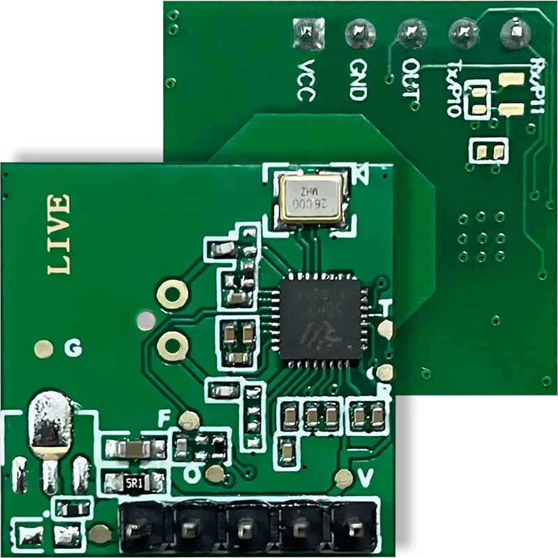

    sensor module itself looks to be an MS58-2020D20M4-LIVE from MoreSense / Migan
    https://www.moresense-tech.com/product_details/70.html
    https://miganiot.com/product/ms58-2020d20m4-live/
    Close-up of two green printed circuit boards (PCBs) with electronic components and connectors.

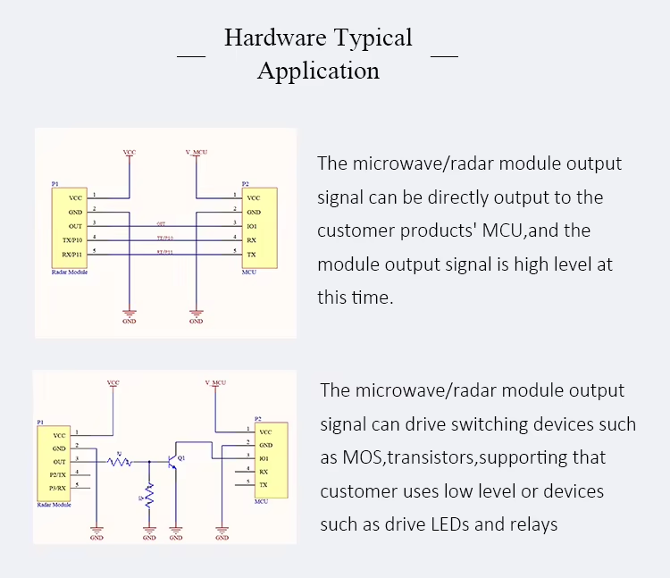

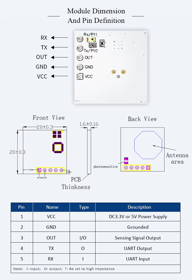

    any info on protocol? i got this so far
    A diagram of radar detection range showing sensitivity zones and a detection angle of about 120 degrees.
    Schematics of microwave/radar module applications showing two connection methods to a microcontroller.
    Diagram and description of an electronic module with labeled VCC, GND, OUT, TX, RX pins and PCB dimension drawings.
    Photo of both sides of an electronic radar module with labeled technical components.
    Photo of the MS58-2020D20M4 5.8G radar module showing the circuit board with electronic components and connector labels.

    It seems the protocol is not known yet, so probably the first thing we need now is the data packets capture. If it's UART, then guess baud and capture with Realterm, both RX->TX and TX->RX traffic. It can be also captured more easily with Sigrok clone:
    Salae 24MHz logic analyzer for 10$ - analysis of an unknown LED display protocol
  • #12 21540559
    Posts: 5236
    Help: 449
    Rate: 918
    I was also sent this after requesting more info, but it still doesn't contain what's needed
    • wetransfer_ms58-2020d20m4-5v-g-5d-nls-live-product-data-sheet-v1-0-pdf_2025-04-24_0647.zip (37.81 MB) You must be logged in to download this attachment.
  • #13 21540736
    Posts: 14795
    Rate: 12945
    Included ATRadarSettingTool_V1.4 seem to be able to use UART to communicate with that, so maybe we could use it for testing, but I still can't see protocol documentation.
