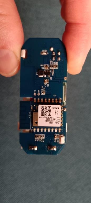

    I have an issue with one older sensor with a magnetic reel switch, PB-69W. The template:
    "vendor": "Tuya",
    "bDetailed": "0",
    "model": "Enter Short Model Name Here",
    "chip": "BK7231N",
    "board": "TODO",
    "flags": "0",
    "keywords": [
    "TODO",
    "TODO",
    "TODO"
    "pins": {
    "7": "DoorSnsrWSleep_nPup;1",
    "9": "WifiLED;5",
    "24": "DoorSnsrWSleep_nPup;2"
    "command": "",
    I use two GPIOs (7 - channel 1 for reed switch), (24 - channel 2 for tamper button).
    It works well, goes from sleep to wake up on change and sleeps after timeout (60 sec, but I tried also 30 sec)
    There is an issue that the sensor does not wake up after cca 6-10 hours without change. I have to remove batteries and put them back. Then it works for half a day.
    Build: Created on Dec 17, 2023, at 22:12:49, version 1.17.366
    MAC Address: fc:67:1f:07:ce:d0
    Chipset: BK7231N
    Flags: 0
    Version: 1.17.366
    I also attempted to identify GPIOs for battery monitoring, which did function, but I encountered some issues as detailed here: https://www.elektroda.com/rtvforum/topic3959103.html. My setup was as follows:
    Pin Description Config Channel
    6 reset button dInput_n 3
    7 reel contact DoorSnsrWSleep_nPup 1
    9 WiFi LED WifiLED 5
    21 BAT_ADC battery level 4
    24 tamper contact DoorSnsrWSleep_nPup 2
    Upon realizing the wake-up problem, I disabled the battery driver. I now understand that battery monitoring is a separate issue.
    Thank you for your help. It is not extremely important to solve it, maybe I will throw out this one sensor but I am interested to have one sensor with two door contacts and deep sleep (tamper + reel).

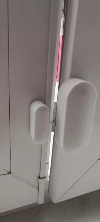

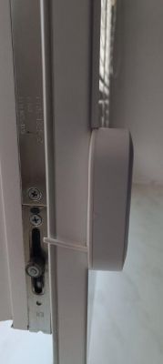

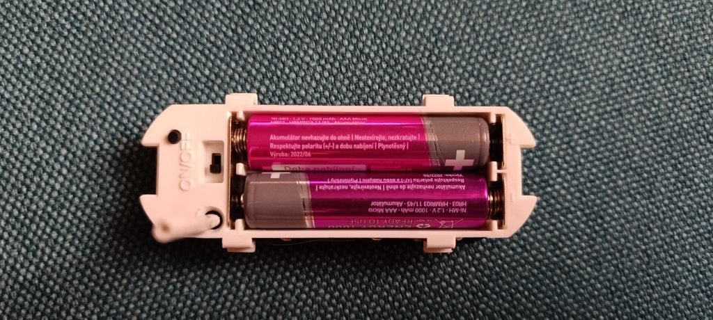

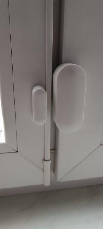

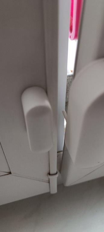

    The sensor and the installation. It has to be near the bottom of the window. You have to find the right position of the magnet. The reel has to be closed when the ventilation is opened.
    Image of an electronic module held in a hand. Close-up of an open battery holder with two AA batteries inside.
    Sensor mounted on the interior window frame.
    The window opened - the reel contact and the tamper contact are opened:
    White sensors mounted on a window, one on the sash, the other on the frame.
    Sensor mounted on window frame.
    The ventilation only opened - the tamper contact opened
    Sensor mounted on the frame of an open window.
