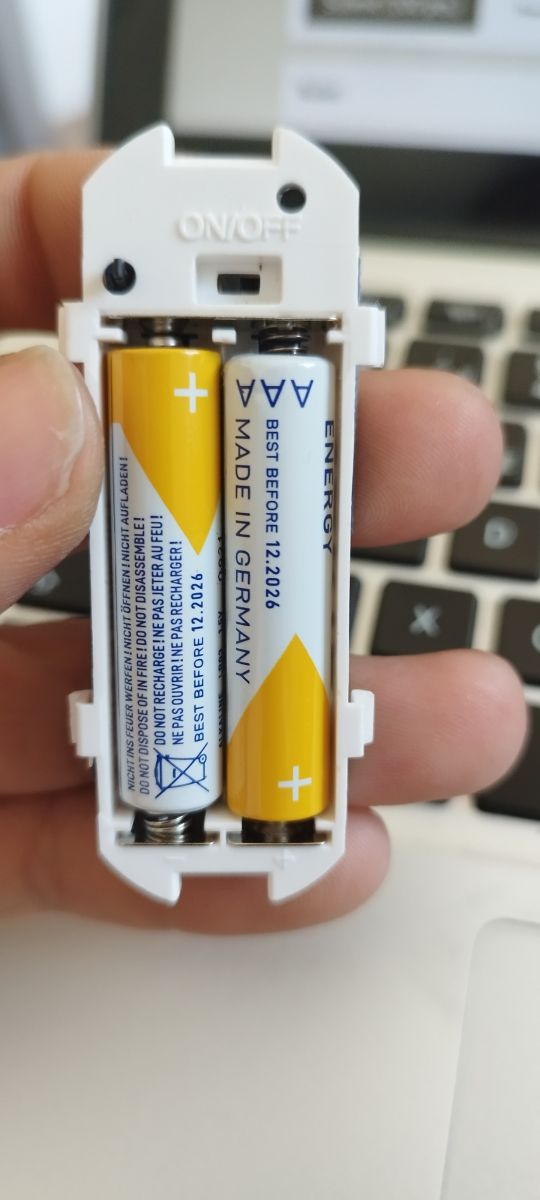

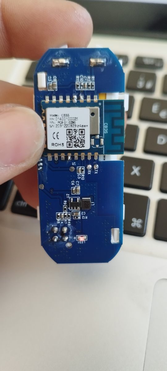

    Hello!
    I bought some door/window sensors on Aliexpress a few days ago. When they arrived, I was able to verify that they contain the CB3S chip. So I have flashed it with OpenBK, latest version. They seem to work fine. But two of them that are the ones I'm working with. A few hours after flashing it, they stop working.
    I have tried to reflash, but now it seems that the chip does not work. I changed the batteries and it has power. I will continue to investigate what happened to him.
    The PCB is named as PB-69w VER 1.4.
    It has a magnet with which it detects the closed door
    A rear alarm button in case it is disassembled
    a reset button
    And a status led.
    So far I have managed to make the Led act as an inverted wifi led (P9) to know if it is connected to the wifi.
    I know when the door opens and closes (P7)
    But the rear alarm button, I don't know how to make it work.
    Another issue is that the batteries (2xAA) last about 5 or 6 hours.
    In the options I already have the options marked (I think there are 3. 2, 10 and 19).
    I hope someone has already reached out to them too and we can help each other!

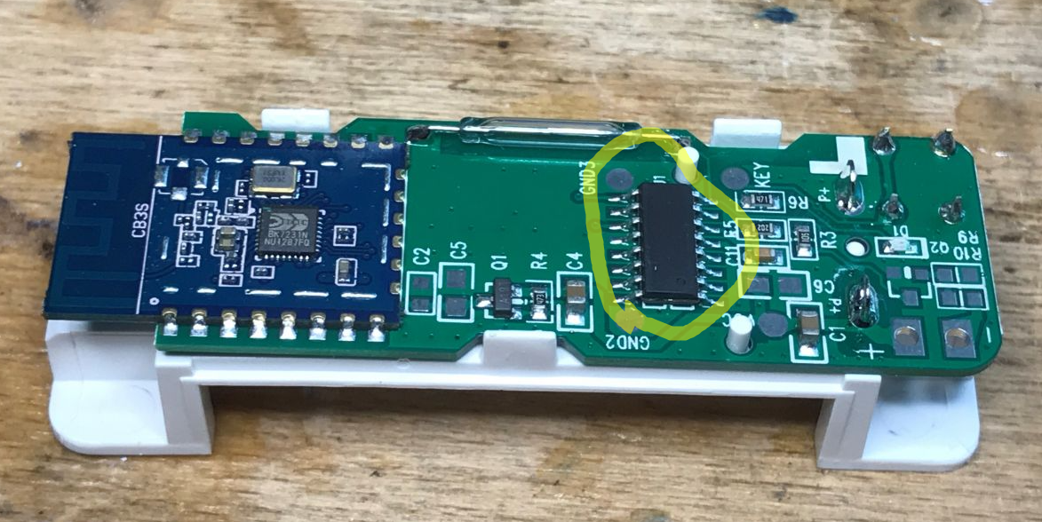

    4139ggn wrote:
    How can I know if this device also works with MCUTuya?
    TuyaMCU is a protocol of communication between MCU and wifi module. MCU looks like this:
    OpenBK CB3S Door/Window Sensor Issues: PB-69W VER1.4, Battery Life, Rear Alarm Button

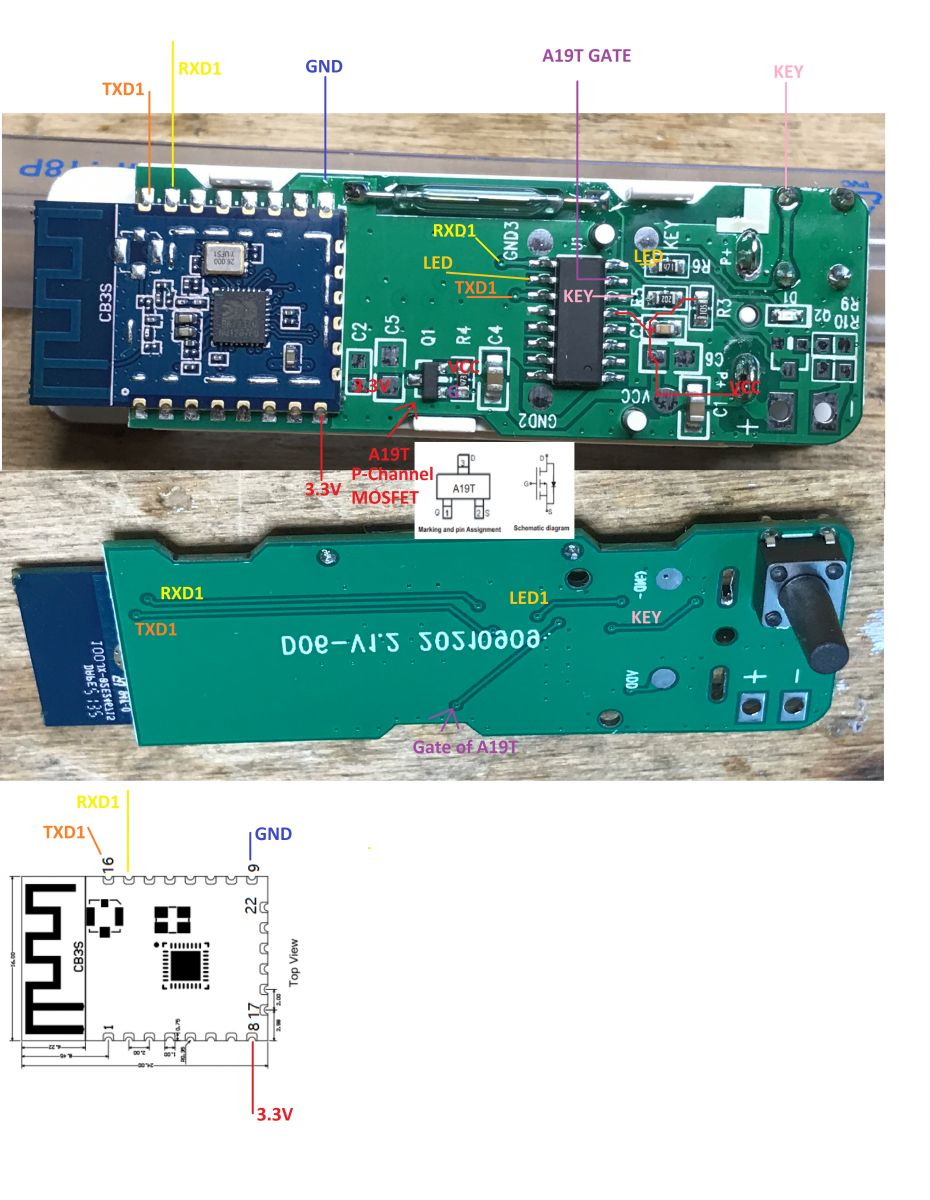

    MCU is always connected to WiFi module by UART1 port on Beken, RX1 and TX1.
    There is no MCU on your board.
  • CB3S power is not managed by the MCU
    #5 20456599
    4139ggn
    Posts: 36
    The driver is ready! I will be posting the guide in 24 hours, first on polish site and then the translation.
    Yeah!
    Three other devices? Please post teardowns as well.
    But they are the same model :D I bought several at the same time.
    Understood! So, in my device, nothing manages the power of the CB3S, right?
  • #6 20456605
    Posts: 14755
    Rate: 12881

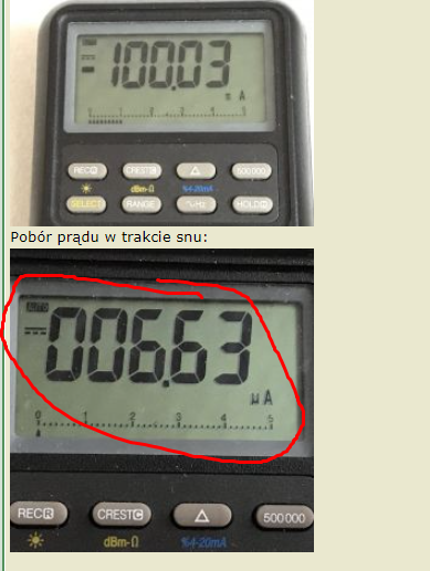

    In your device CB3S is all time on and takes 100mA at average.
    With deep sleep, we can go down to:
    Have you managed to do the Home Assistant pairing already?

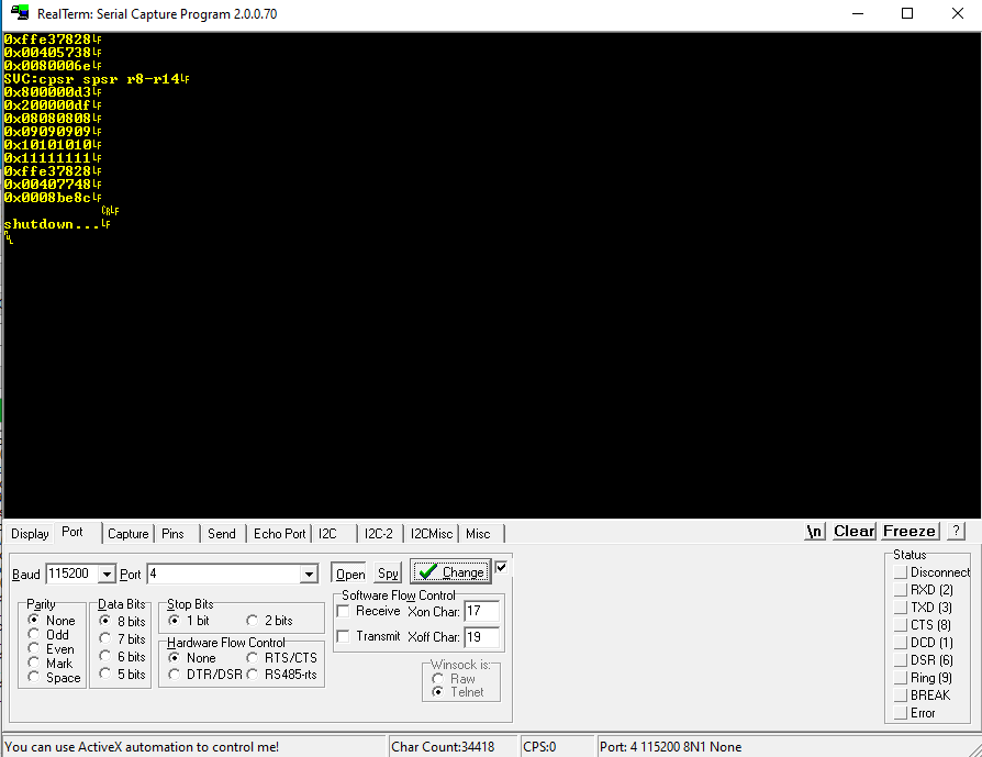

    Good morning! This morning I tried to resuscitate one of the sensors I have. Flash version 1.15.487.bin with the tool. It flashes fine. But then it doesn't do anything else. Neither do I create PA, nor does it connect to the configured Wi-Fi network... Nothing.
  • #15 20457253
    Posts: 14755
    Rate: 12881

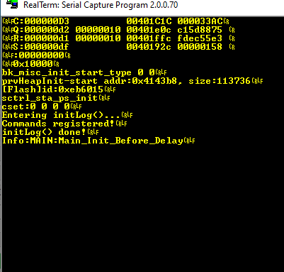

    If you connect the RX of USB to TTL converter to the TX2 of CB3S (debug log output), what does the log say in Realterm?

  • Requesting CB3S debug log via TX2 and RealTerm
    #19 20457385
    4139ggn
    Posts: 36
    About what you comment; I have tried turning on/off five times.
    Before they fell asleep, like this, I would go into AP mode. Since they fell asleep, they do nothing.
    @4139ggn if you have a flasher hooked up, you can do a full 2MB read backup and send us file, possibly first by replacing characters of your WiFi pass with the same amount of other characters (do not change the amount of bytes in the file).
    I have read with the app. But I don't know how to proceed...
    dheenhasty wrote:
    first action I will suggest to put new battery on the device and check for the AP to show (and don't forget that failsafe deactivates all pin and led !!!! so your device might be running but doesn't seem like it's running )
    I already have 3 packs of 4 batteries...
    What program should I read with? I have tried with Arduino and I have not seen anything

    @4139ggn did you use deep sleep command? if so, remove batteries, and wait few minutes to make sure that is discharges capacitors...
    RealTerm, it will work as long as you make sure you are connecting to TX2 for log and not for TX1 (which is for programming) and set baud 115200
  • #21 20457594
    4139ggn
    Posts: 36

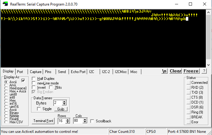

    OpenBK CB3S Door/Window Sensor Issues: PB-69W VER1.4, Battery Life, Rear Alarm Button This is what I see in Real Term OpenBK CB3S Door/Window Sensor Issues: PB-69W VER1.4, Battery Life, Rear Alarm Button
  • #22 20457782

    seems like a corrupt firmware ... you need to reflash . you had a backup of your tuya firmware ?
  • #23 20457964
    4139ggn
    Posts: 36
    Once reflashed, I get this message.
    There is a previous screen, but I can't capture it.

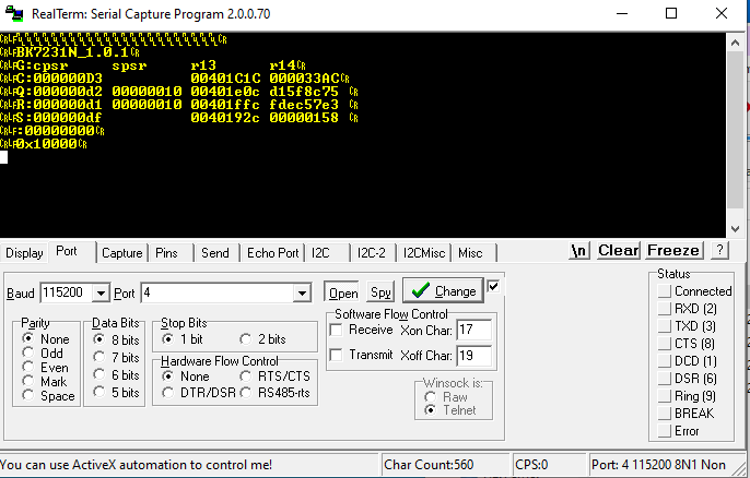

    By the way, I have lost the original FW... This is me.....
    this is what it shows when booting

    Do firmware backup, then do full erase in the flasher and then do RF restore and then write obk again.
  • #25 20458005
    4139ggn
    Posts: 36
    Yeah! For now, at least create an access point. Powered from UART.
    I have installed version 1.15.493.
  • #26 20458038
    Posts: 14755
    Rate: 12881
    To be sure - it created AP after RF restore? Without RF restore it was not able to do that?
  • Erase all fixed AP boot loop and UART output
    #27 20458093
    4139ggn
    Posts: 36
    Before, I had not seen the "erase all" button. Once I clicked there, everything was rolled. Flash and reboot, the AP appeared. Also, at the same time, I had another UART reading the data from TX2. So I was seeing more coherent messages. I don't know how, but the device, when it started, also had the shutdown order. So it kept turning on and off. When I plugged it back in, it turned on and off.
    The links you posted this morning aren't available yet, are they? PowerSave is already 1. Besides that, what else should I do until the FW we talked about before comes out? To save battery. The led, I have left it as LEDn so that only when it is open, it is on. Also so I can see if it's on or not. Another question I have is: How do I find the rest of the buttons to give it a function? There is one that is a pick-up alarm. But I don't know which P it belongs to, and I don't know how to look it up either. It has another reset button. That the truth, I do not know if we could give it another use, or how to apply the reset button. The battery level: Could we see it somehow?
    Thank you very much for your help and I hope this helps someone else!
