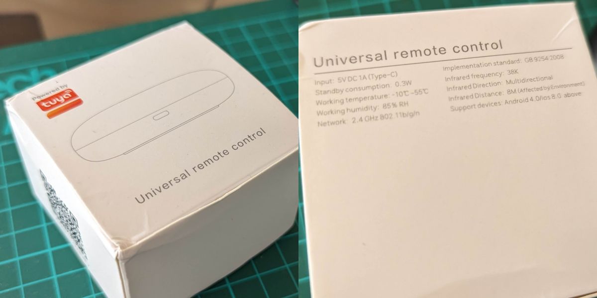

    Chipset: BK7231N
    Two images of a universal remote control box with Powered by Tuya branding, showing the front and technical details on the side.

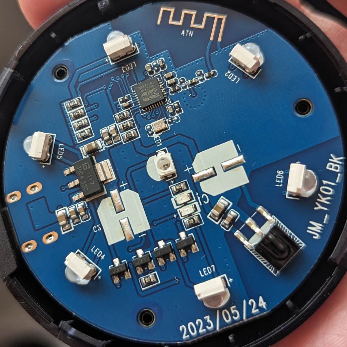

    Disassembly pictures:
    Close-up of JM_YK01_BK PCB with electronic components and a Wi-Fi antenna trace. Blue PCB with a push button, visible traces, and labeled pads for programming.
    GPIO map:

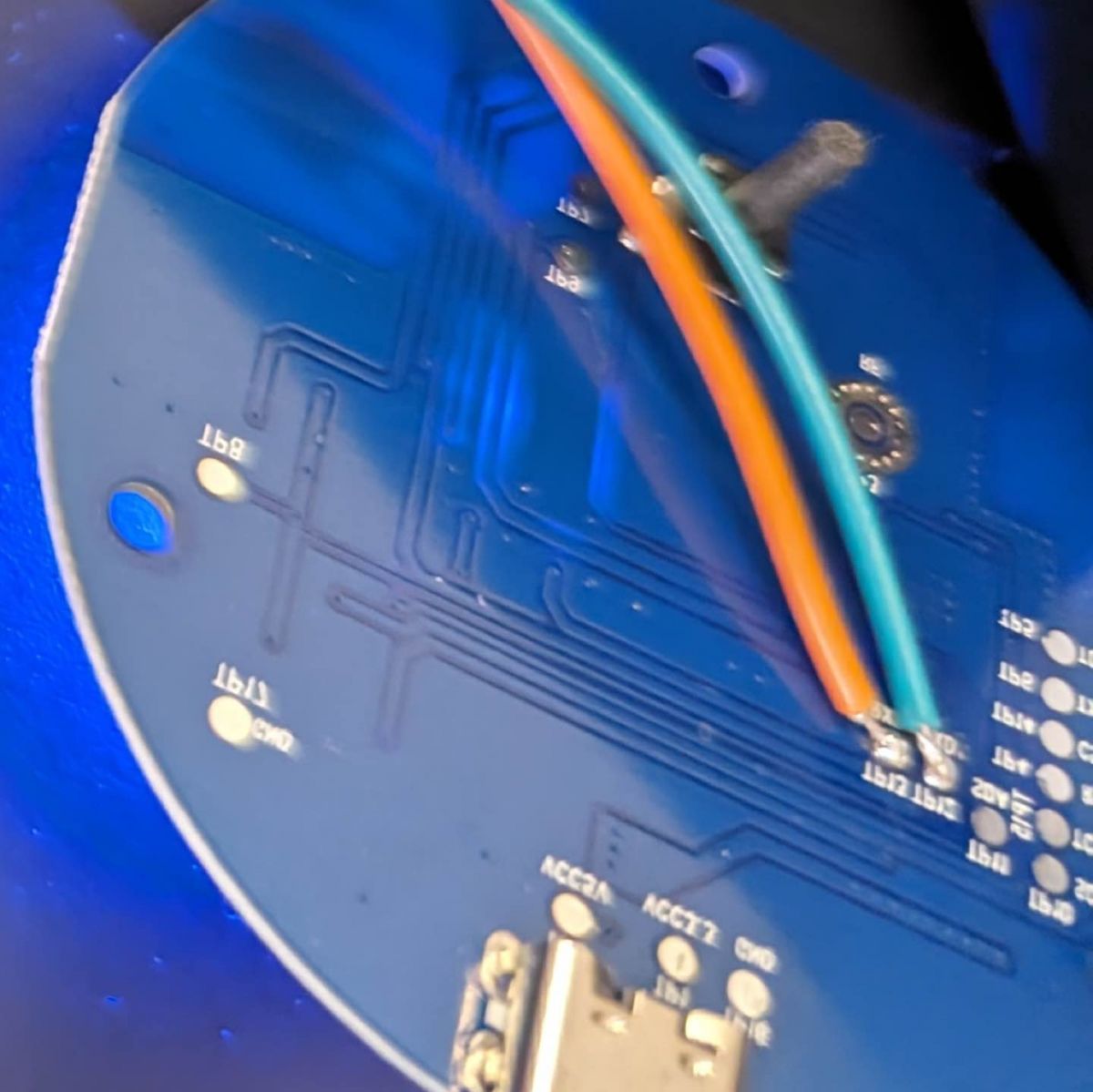

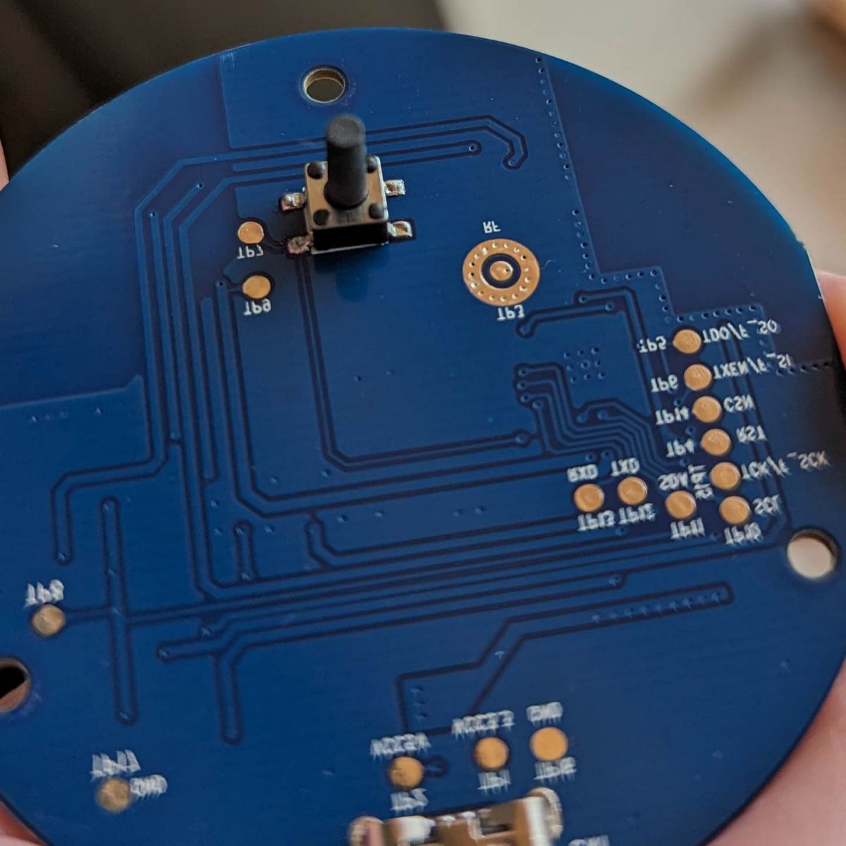

    Flashing procedure:
    Underneath the PCB are pads for serial TX/RX. Annoyingly the silk screen text is mirrored but not too hard to figure out. Power board using USB-C.
    Close-up of a blue PCB with orange and blue wires soldered and a visible USB-C port.
    I had success with an FTDI USB to TTL and BK7231 GUI Flash Tool
