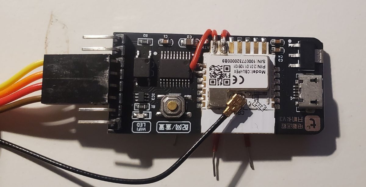

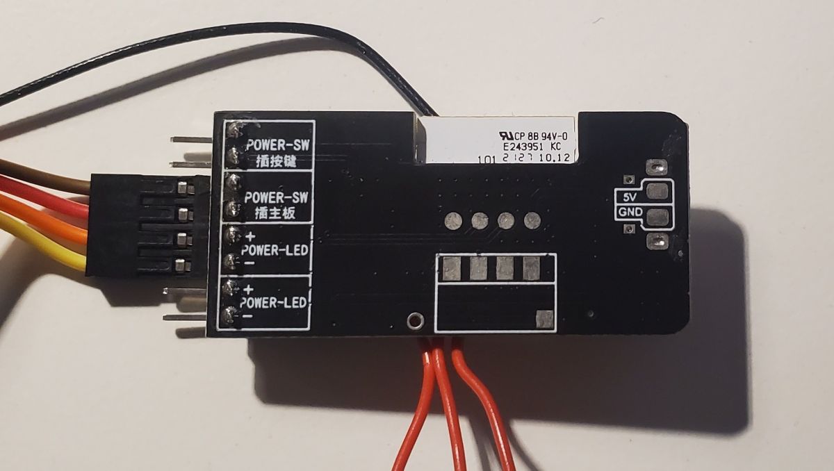

    I have this PC remote WiFi switch that i want to get working with this openbk firmware. I bought it from aliexpress and it has an CBU-IBEX module with a BK7231N MCU. I flashed the openbk firmware successfully after soldering wires to the corresponding pins. I extracted the json with the bk7231flasher tool (see below). The BK chip communicates with an STC 8P1K17S2 Microcontroller via serial 9600 baud protocol.
    Close-up of a WiFi remote switch module with visible wires and connectors. Electronic module with soldered wires on a white background.

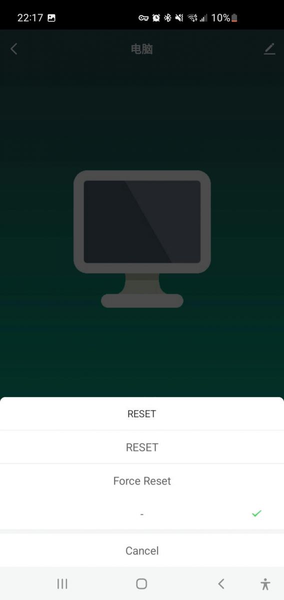

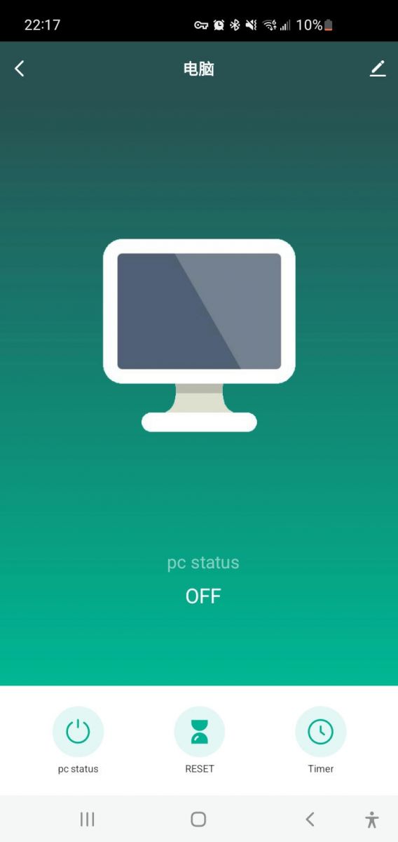

    So I flashed back the original Tuya Firmware. Seems to work (Shows up in Smart Life app and blinks). The CBU-IPEX module has second RX2 TX2 pins but these seem to be not used. I only can see traces from RX1 TX1 (16,15) Pins that go to the ST MCU.
    Using the TuyaMCUexplorer I was able to decode the messages
    This is for pressing the on button in the Smart Life app.
    Received by WiFi module:
    55 AA	00	06		00 05	0101000101	0E
    HEADER	VER=00	SetDP		LEN	dpId=1 Bool V=1		CHK
    Reset shows up in app(?)

    Smart Life app interface showing computer status as off.
    Smart Life app interface with computer icon and reset options.

    There are few dpIDs. Have you tried to narrow down which dpID is what? It would be very useful for us to know what's the meaning of each of them.
    For example, try toggling something in Tuya app (like first relay) and observe which dpId changes?
    For example, which dpId is responsible for timer variable?
    Can you also post some photos of your device? I haven't seen that one yet
  • #7 20858792
    keCho6oo
    Posts: 12
    Photos are in the first comment. I described before every dump what the cause was. I wasn't able to test the inputs. There is an optocoupler to detect whether the power LED of a PC is on. You plug this thing into a PC motherboard (which I have not done yet) and connect it via USB to power it when the PC is off.
