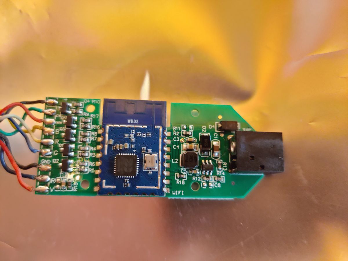

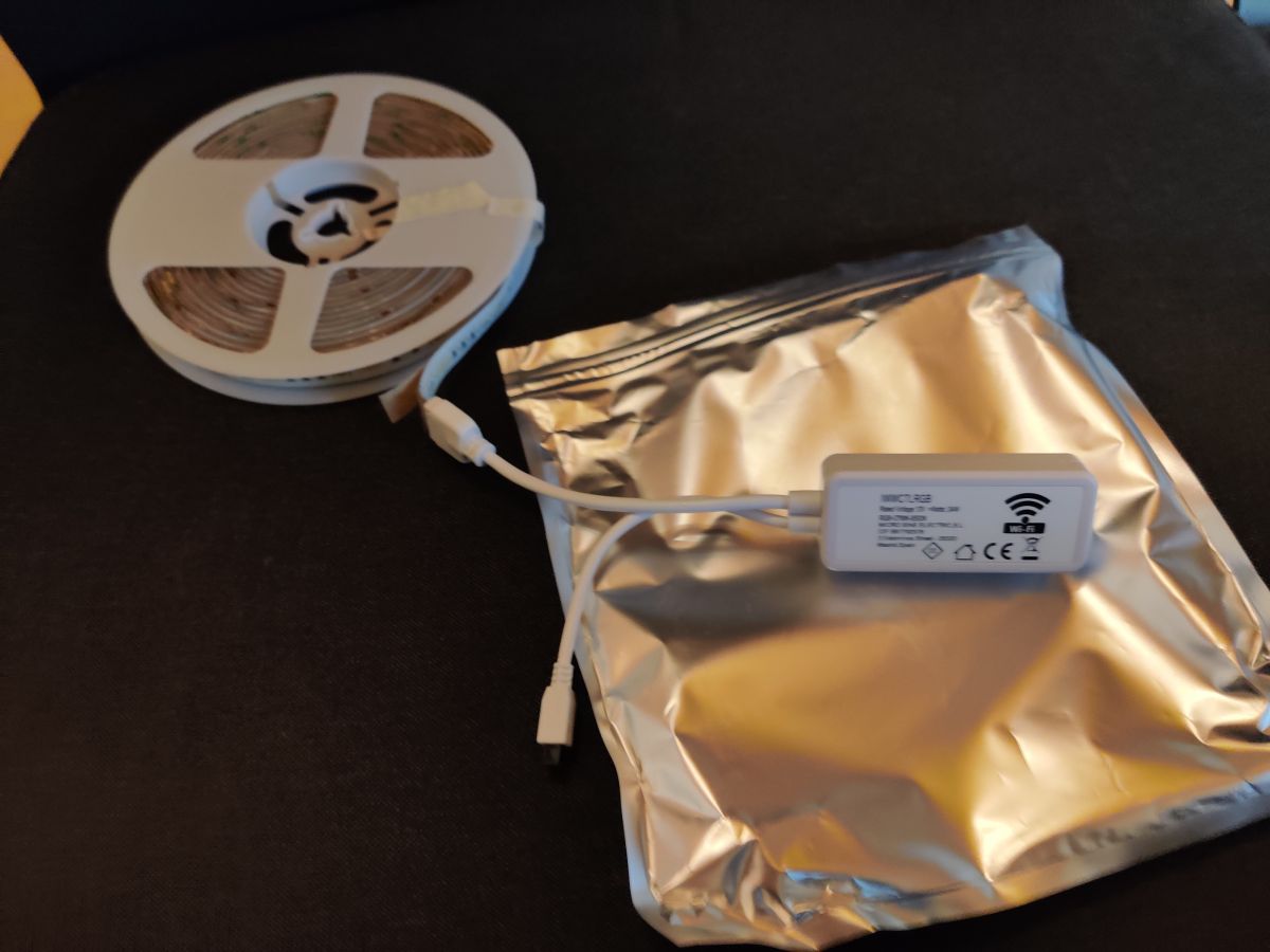

    I'm pretty newish on openbk, I dumped the original tuya/iwiik whatever firmware with the bk7231 easy uart flasher. Then flashed openbk but the pinout seems to be my current problem.
    It's a wifi/ir controlled led rgb strip controller. The pinout on the tuya site itself seems to be off as it got WB3S and TYWE3L-2-V2.1 printed onto it.
    Maybe someone here could do the magic and tell me the pinout that lets all buttons and ir work again, thanks in advance. iwiik_tria...K7231T.bin (2 MB)You must be logged in to download this attachment.
  • Suggested OpenBK7231T pinout for RGBCW channels
    #2 20548164
    Posts: 14755
    Rate: 12881
    Hello, please try the following configuration:
    - Red - P9 - set channel 1
    - Green - P24 - set channel 2
    - Blue - P26 - set channel 3
    - Cool - P8 - set channel 4
    - Warm - P6 - set channel 5

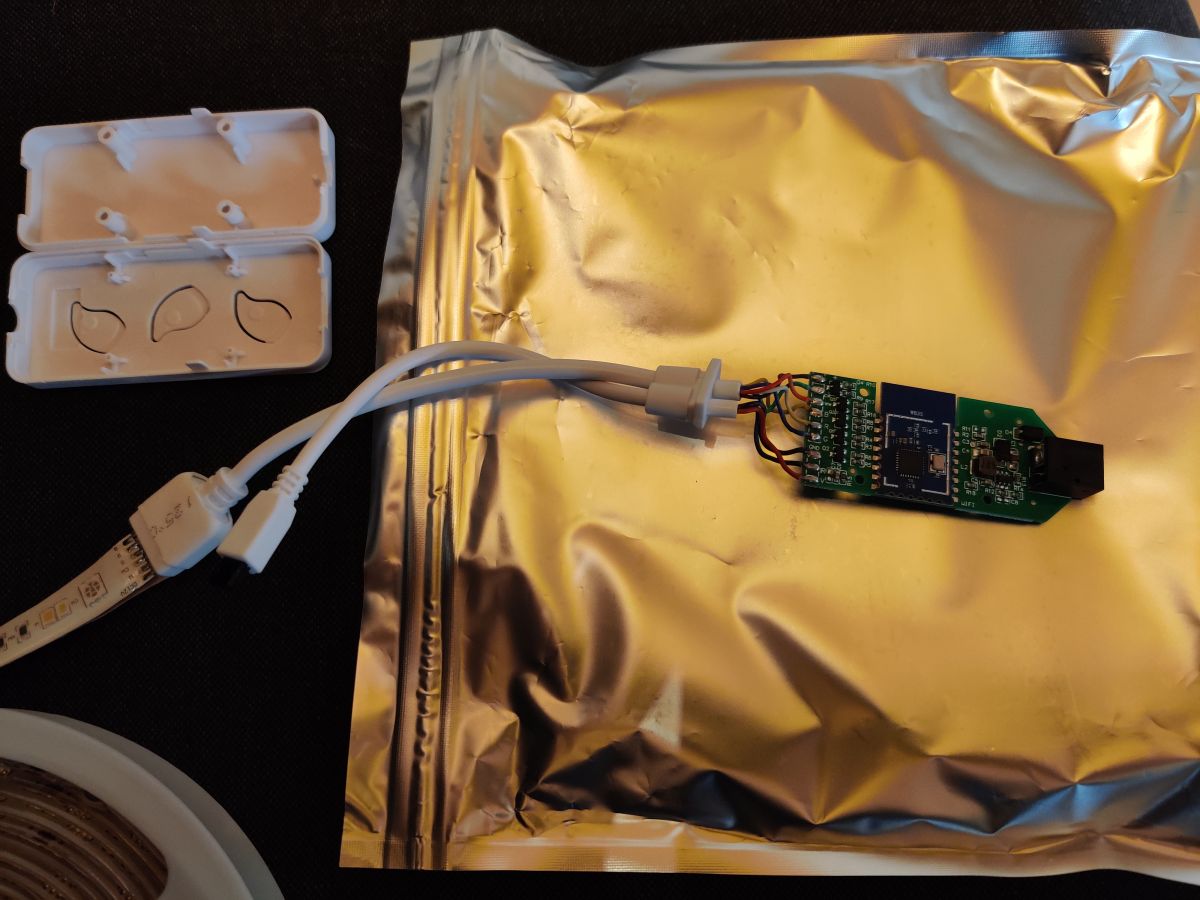

    I haven't found anything related to IR in that, you might need to try one by one or give some photos from the device inside.
    Also please provide more information on this device (model name, photos ,packaging photos, where it was bought) so we can add it to our templates list.

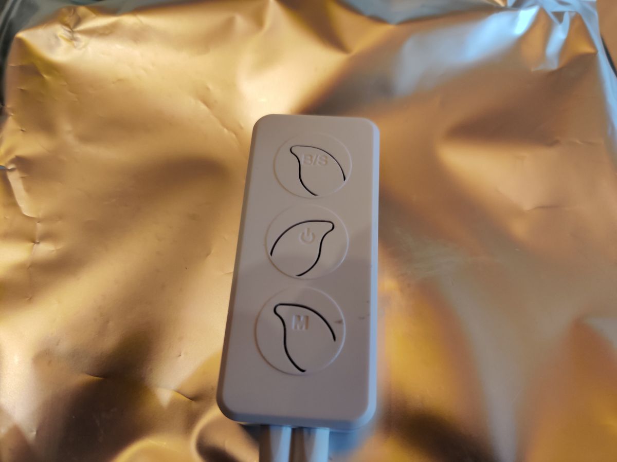

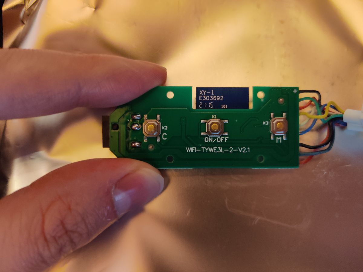

  • Need help identifying IR and button pins
    #3 20548204
    yamacore
    That was my plan when I got it all running, but I can just add them now.
    About the PWM's I already sorted those out, I would need help about the IR and the buttons seen on picture
    IMG_20230420_104006 (Picture4)

  • #4 20548221
    Posts: 14755
    Rate: 12881
    Do you have a multimeter? That way you could figure it out really fast.
  • #5 20548328
    yamacore
    yes I got one but sadly my multimeter does not support a continuity test

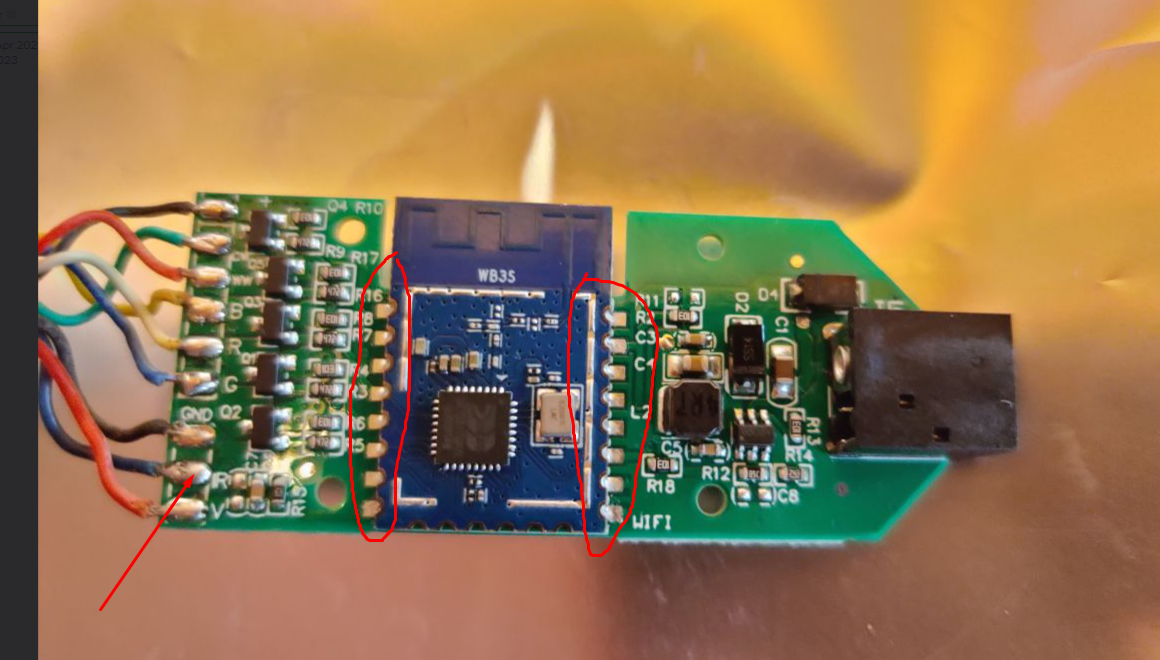

  • #6 20548353
    Posts: 14755
    Rate: 12881
    What about a resistance check?
    Put one probe at IR solder joint and check with second probe all solders pads of WIFI module:
    Flashed OpenBK7231T but dont know how to get the correct pinout
  • #7 20548375
    yamacore

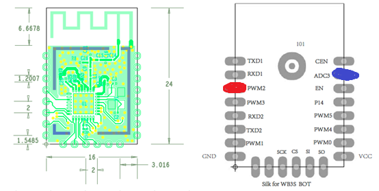

    I'm glad I can learn something new, but I don't get the pinout still in the picture from tuya wb3s Flashed OpenBK7231T but dont know how to get the correct pinout I marked where the red and blue IR cable goes how are these pins displayed in the webinterface?
  • #8 20548380
    Posts: 14755
    Rate: 12881
    IR has a single pin. Futhermore, the image you marked is WB3S bottom view, not a top one.
    For IR, please set IRRecv role in pins config.
    Are you sure about those connections?
    Black IR cable is GND, Blue IR cable is signal, red IR cable is VDD - 3.3V.
  • IR decode works on rxd2, but IREnable command is missing
    #9 20548393
    yamacore
    Yes the red one got a connection on EN and VCC then if i switch it based on the info i got
    So the blue one is rxd1
    Added after 34 [minutes]:
    i checked the middle button on/off goes to rxd2 i changed it to btn and it works
    i set rxd1 to irrecv but it seems not to do anything do i need to set anything more special?
    EDIT: I did restarts but it seems IR does not work got all other buttons working now tho
