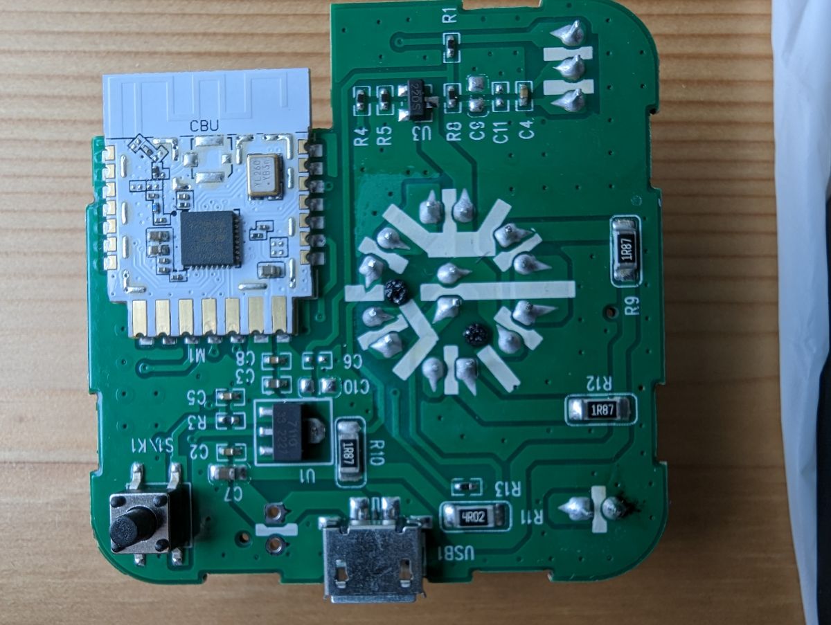

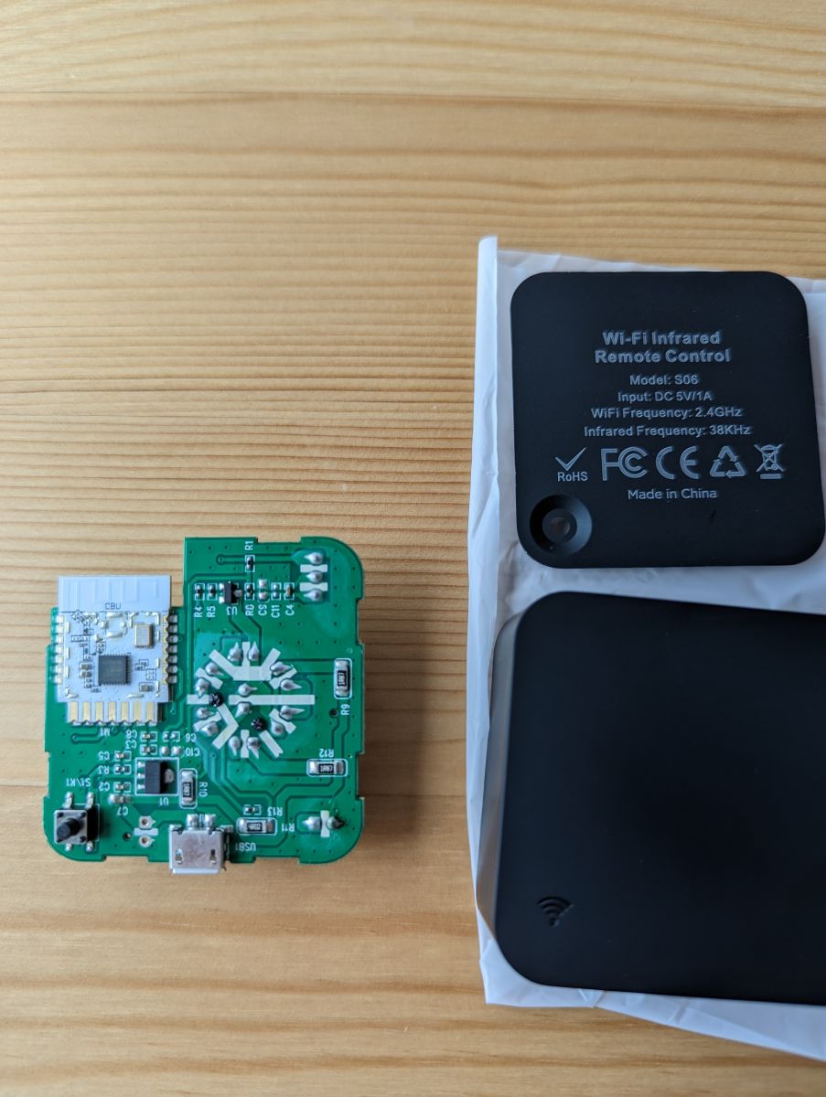

    Recently bought 3 pcs S06 IR blasters from temu.com with the hope of them being ESP8266 based, as all the experience I had so far was with Tasmota and ESP based hardware.

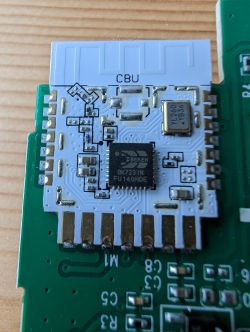

    To my surprise, the devices were something I have never seen before - BK7231N, CBU module. This is how I got here!

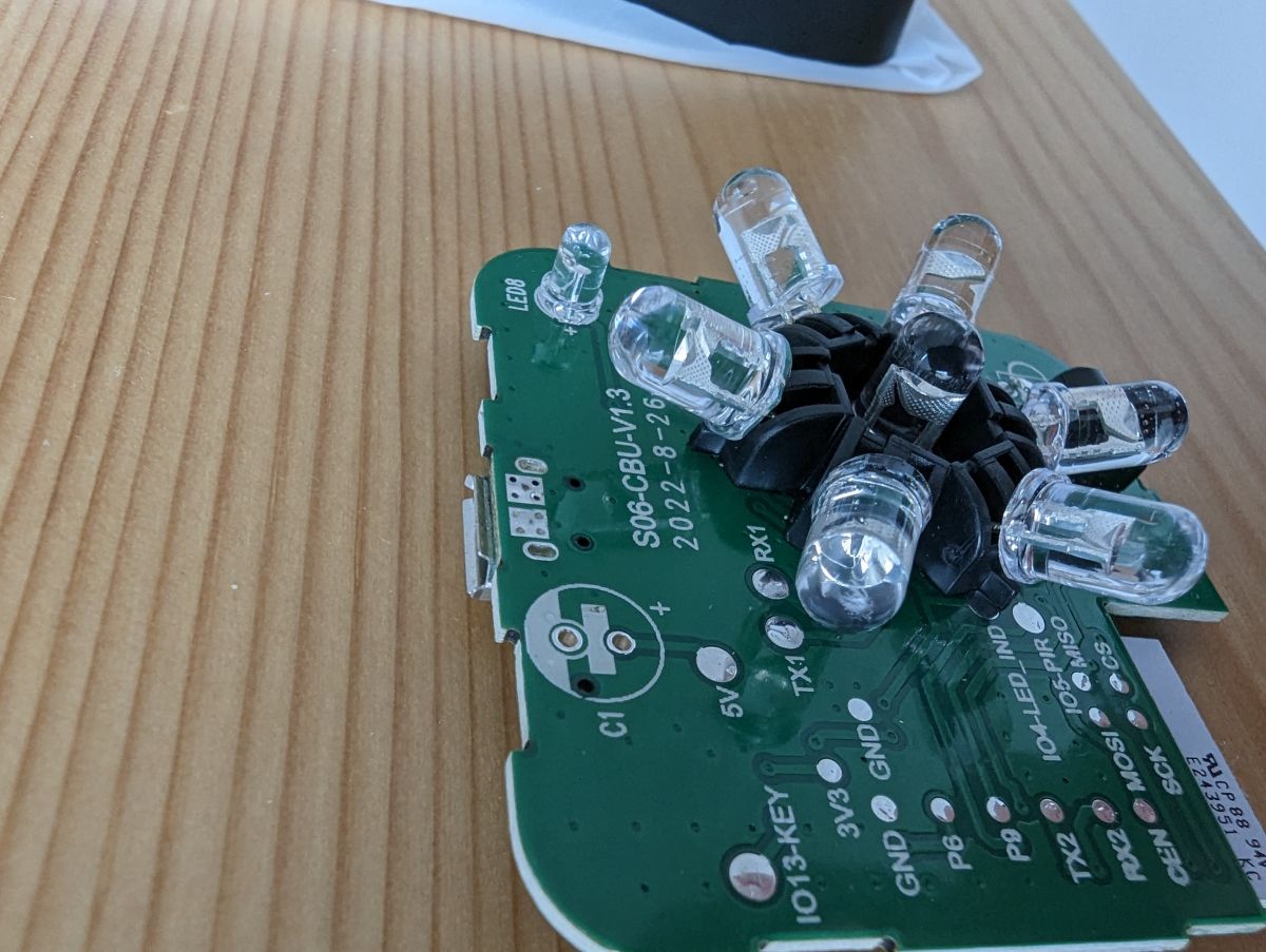

    The PCB version is S06_CBU_V1.3. Judging by the replies from others in similar threads, this is the most recent version. I read the README.md in the github repositories and managed to flash one of the devices with the latest version of OpenBK7231T_App (1.17.116) using hid_download_py on Linux using the following command:
    ./uartprogram OpenBK7231N_QIO_1.17.115.bin --unprotect -d /dev/ttyUSB0 -w --startaddr 0x0

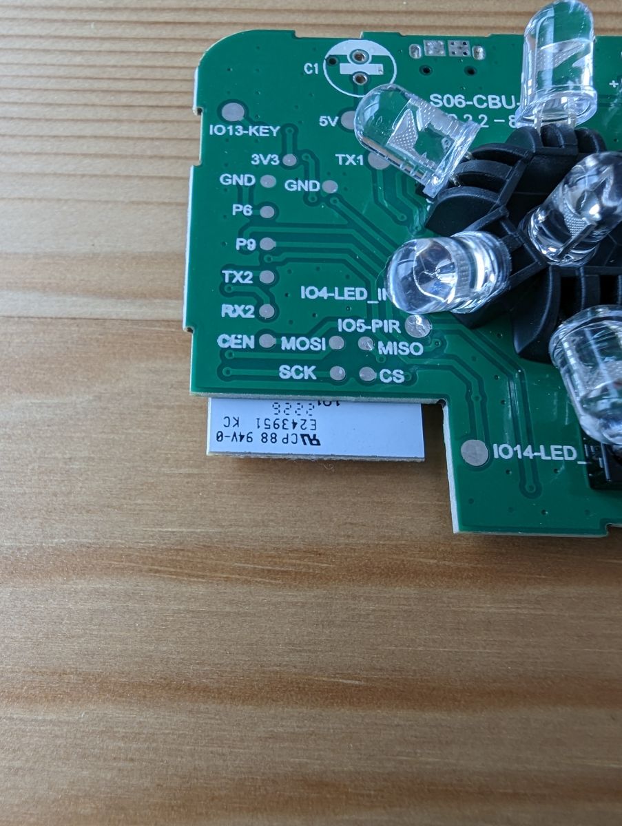

    I used the unpopulated capacitor holes to jam two jumper wires for 5V VCC and GND (lazy and dangerous, I know) and tapped two little wires on the RX1 and TX1 pins. This allowed me to flash the device with very little soldering and without using a 3.3V (as I was too lazy to find a proper regulator and build a breadboard circuit).
    So far so good. By reading the forums and experimenting with the GPIO finder I came up with the following peripherals layout:
    P7 (PWM1) IRSend
    P8 (PWM2) IRRecv
    P24 (PWM4) WifiLED
    P26 (PWM5) Btn
    I find this rather important to share with others, as the pins for other device versions are different.
