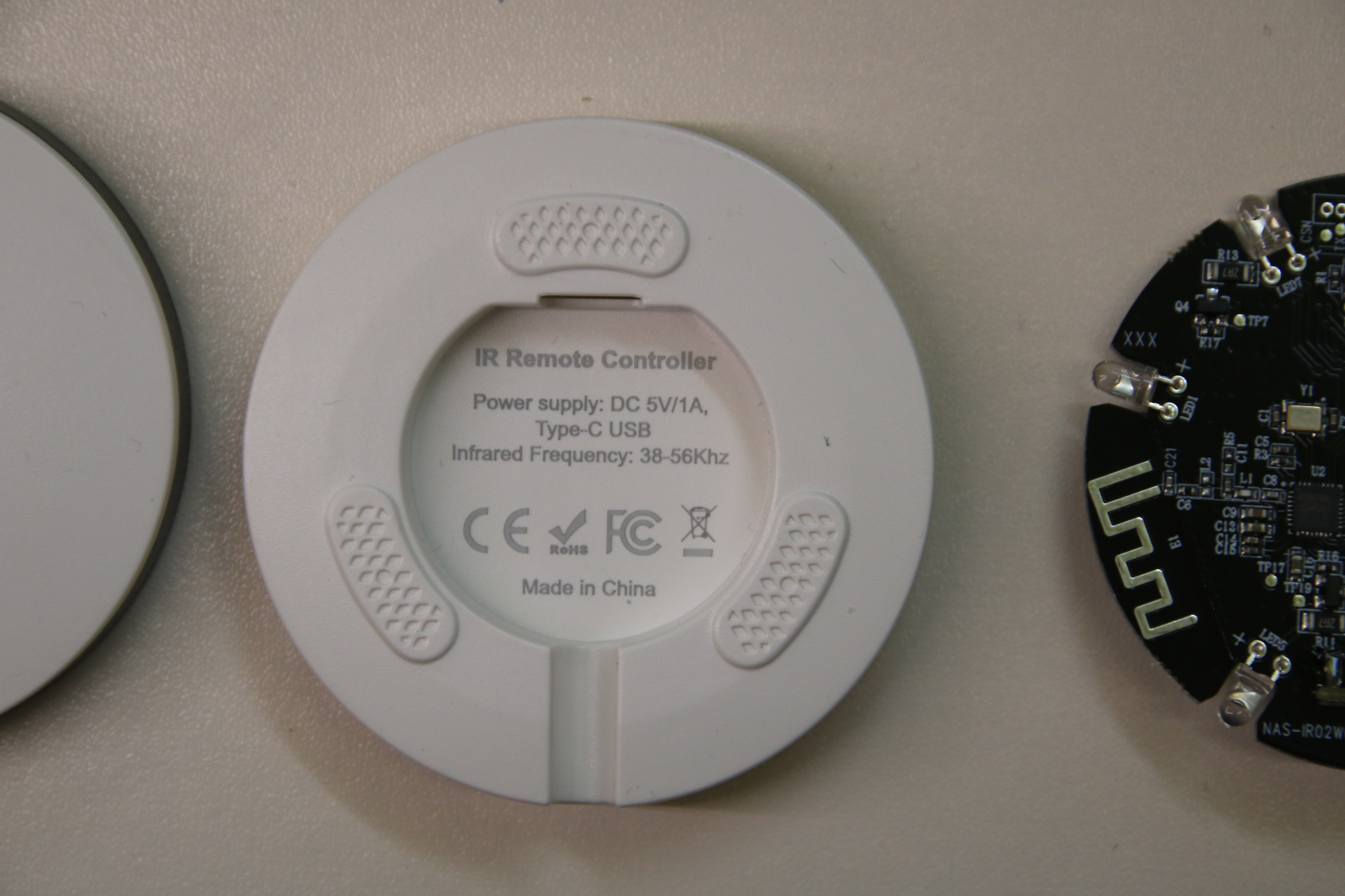

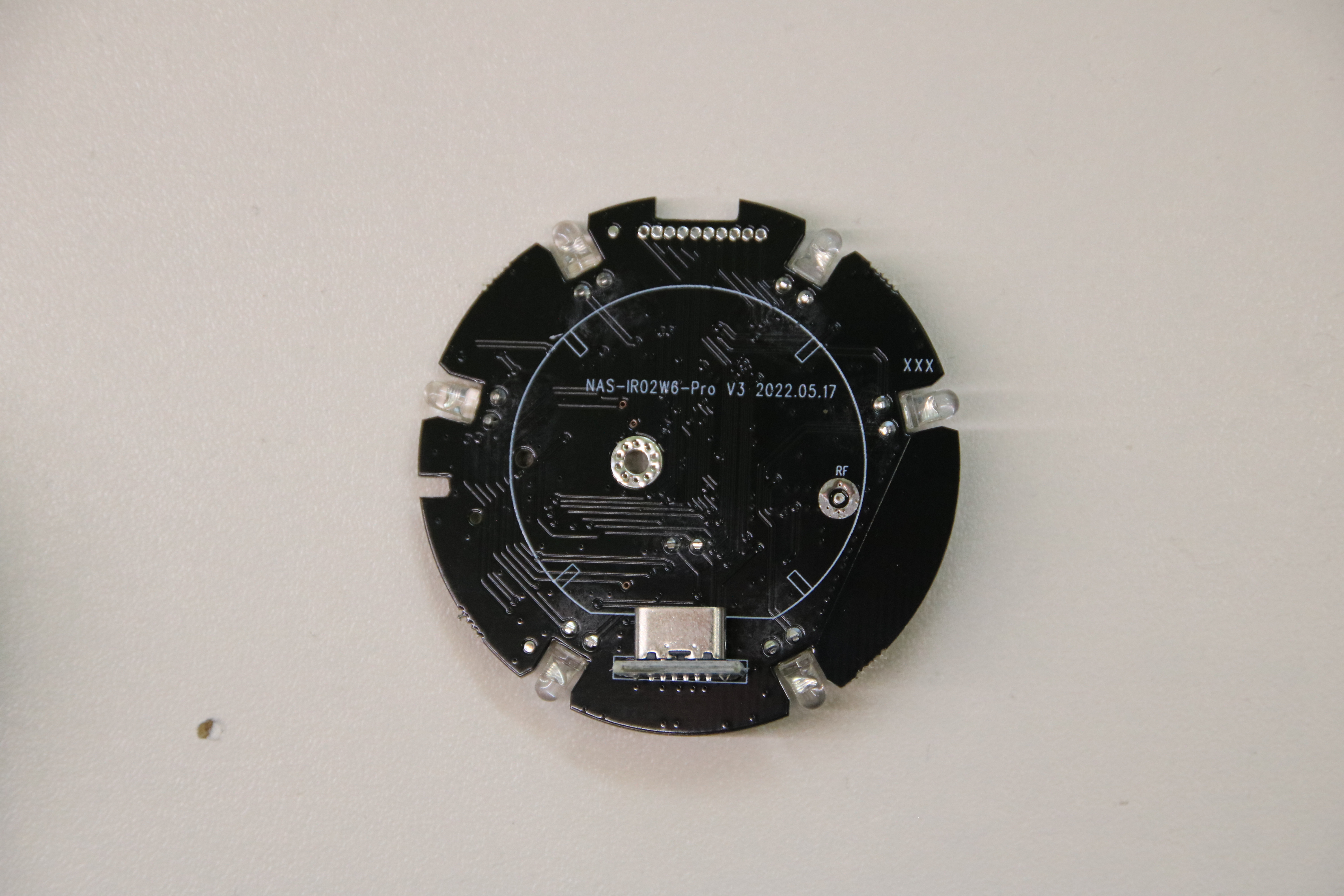

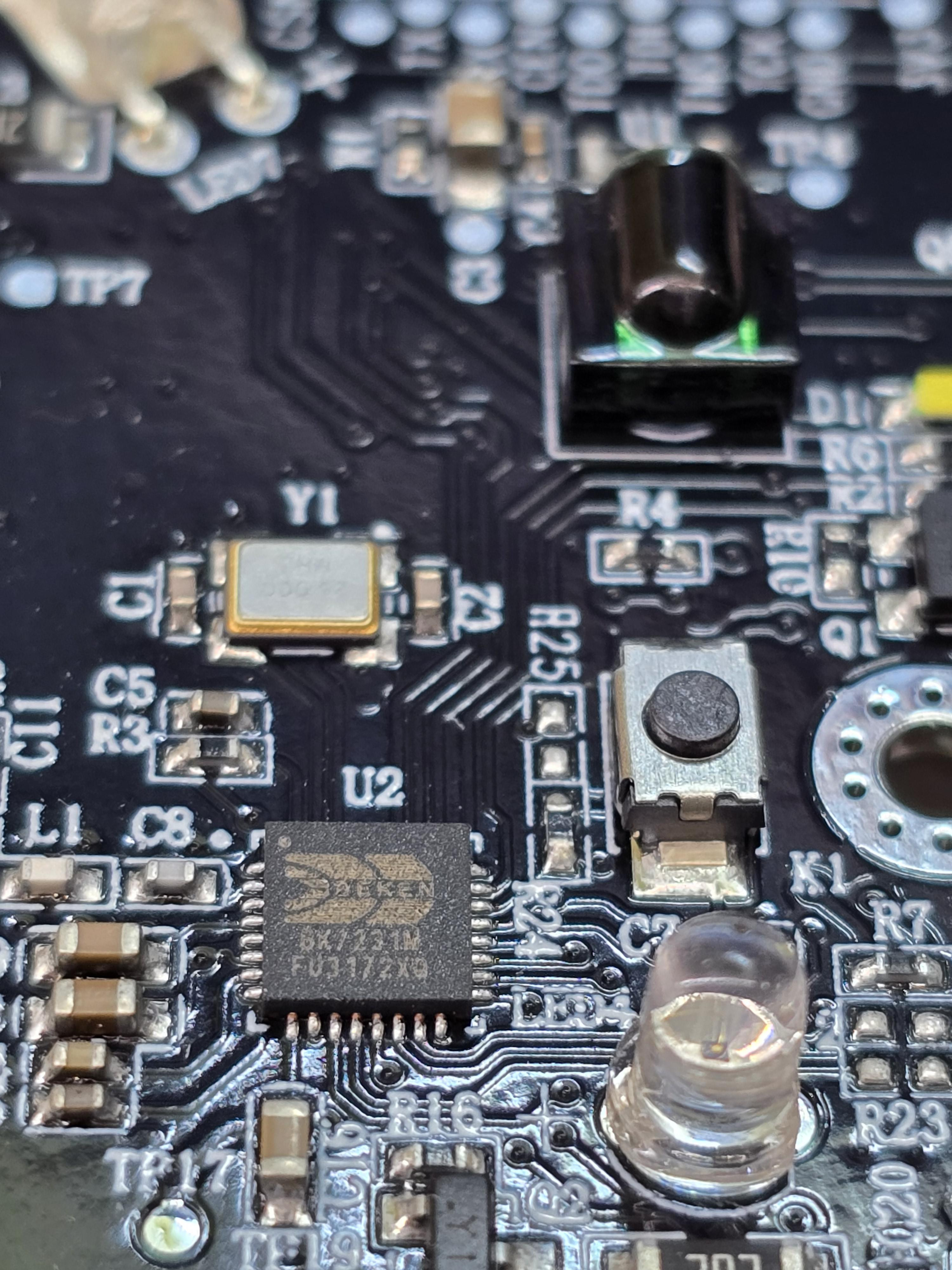

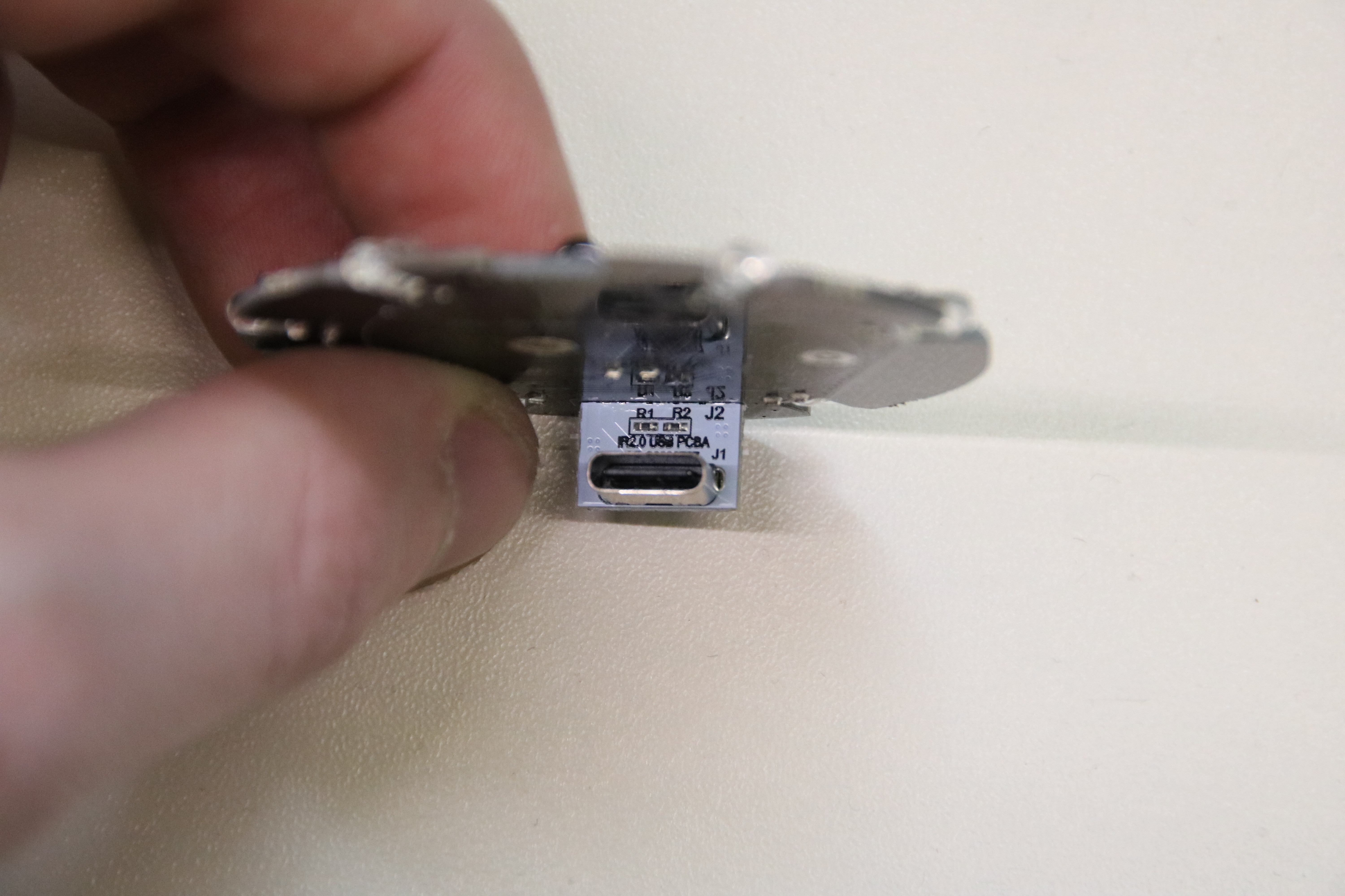

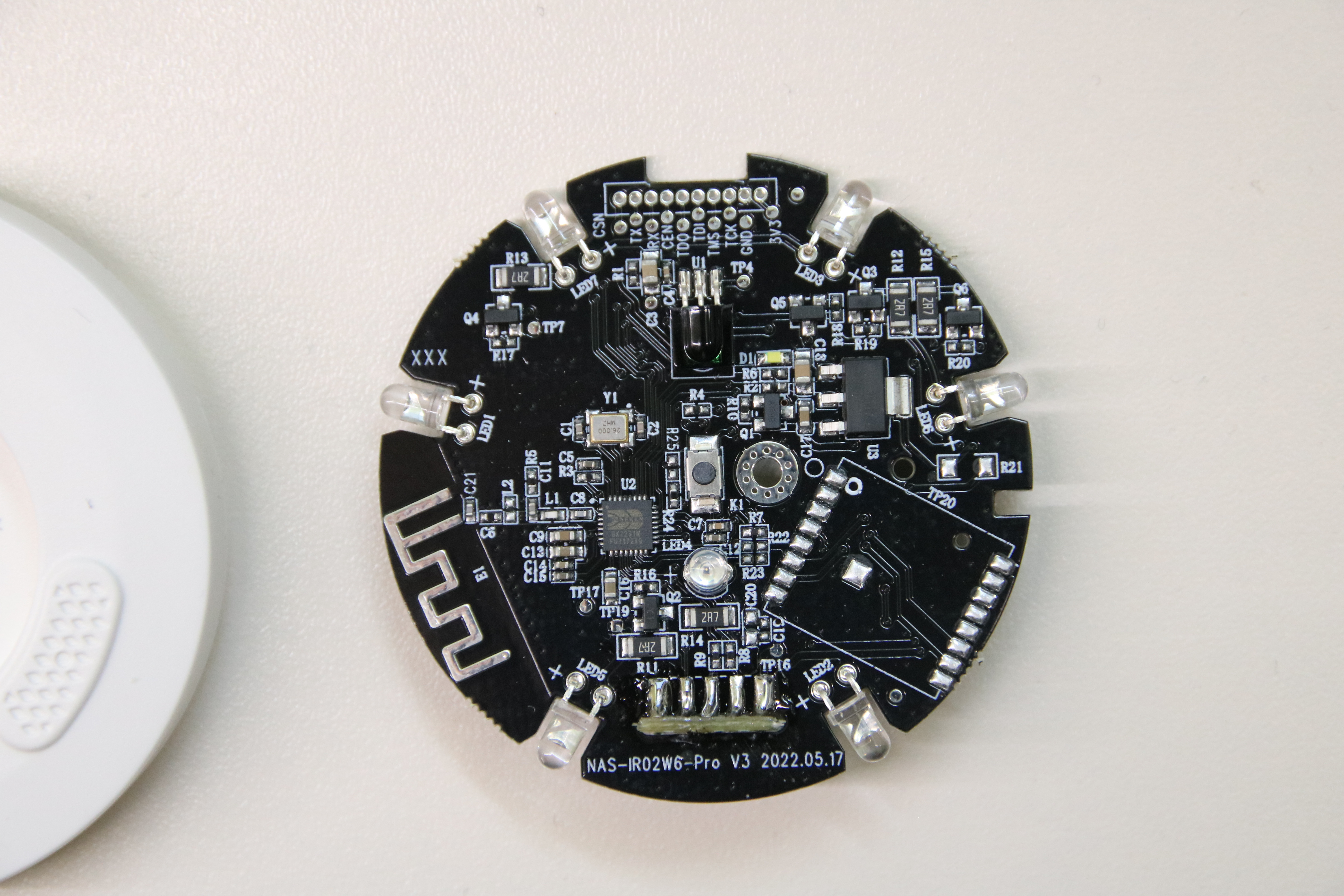

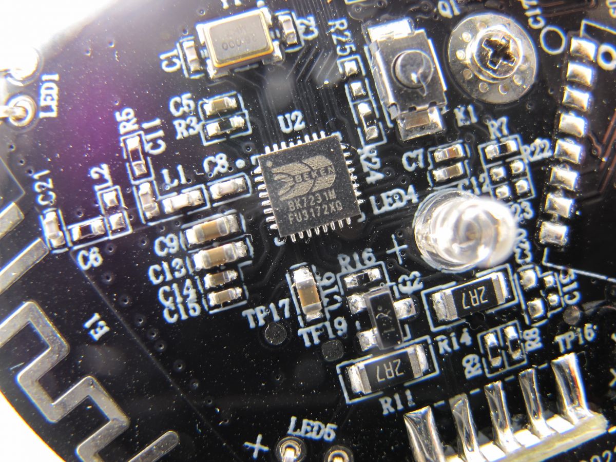

    I received this IR/(maybe RF) remote as a "gift" with a tuya smart plug and can't find the exact same one in the teardown list so I am posting it here. I am stepping into a new territory with this and have no idea how to go about checking which GPIO pins are for what and exactly how to structure the config. Any help and tips are appreciated.
    • [BK7231M] Configuring GPIO Pins on BK7231M Smart Wi-Fi IR Remote from Aliexpress IMG_2042.JPG (2.96 MB) You must be logged in to download this attachment.
    • [BK7231M] Configuring GPIO Pins on BK7231M Smart Wi-Fi IR Remote from Aliexpress IMG_2040.JPG (2.71 MB) You must be logged in to download this attachment.
    • [BK7231M] Configuring GPIO Pins on BK7231M Smart Wi-Fi IR Remote from Aliexpress IMG_2036.JPG (2.85 MB) You must be logged in to download this attachment.
    • [BK7231M] Configuring GPIO Pins on BK7231M Smart Wi-Fi IR Remote from Aliexpress IMG_2035.JPG (2.74 MB) You must be logged in to download this attachment.
    • [BK7231M] Configuring GPIO Pins on BK7231M Smart Wi-Fi IR Remote from Aliexpress IMG_2033.JPG (3.16 MB) You must be logged in to download this attachment.
    • [BK7231M] Configuring GPIO Pins on BK7231M Smart Wi-Fi IR Remote from Aliexpress 20250202_191316.jpg (1.42 MB) You must be logged in to download this attachment.

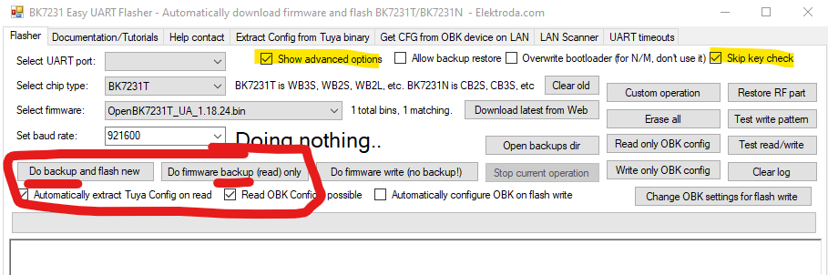

  • #7 21423093
    Posts: 5209
    Help: 446
    Rate: 914
    was about to say make sure you do a backup!
    Screenshot of BK7231 Easy UART Flasher software with backup options highlighted.

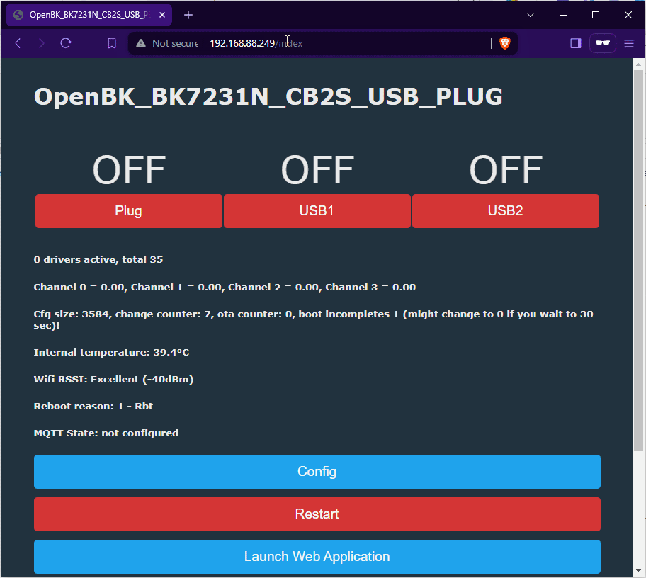

    from the web app you can still get *some* of the original info - the Tuya config data. you can then run that file into the config extractor in Easy Flasher
    Web interface of OpenBK_BK7231N_CB2S_USB_PLUG showing connection status and configuration.

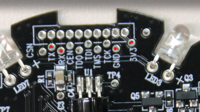

    Close-up of a printed circuit board with various electronic components, including a microchip.

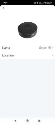

    Damn, I was gone for work and didn't check my emails. That's awesome. Thank you. At this point how do I go about using your configuration? Also what is that app? I probably plan on using Home Assistant if I can figure out how :), but still.
  • #18 21441835
    Posts: 5209
    Help: 446
    Rate: 914

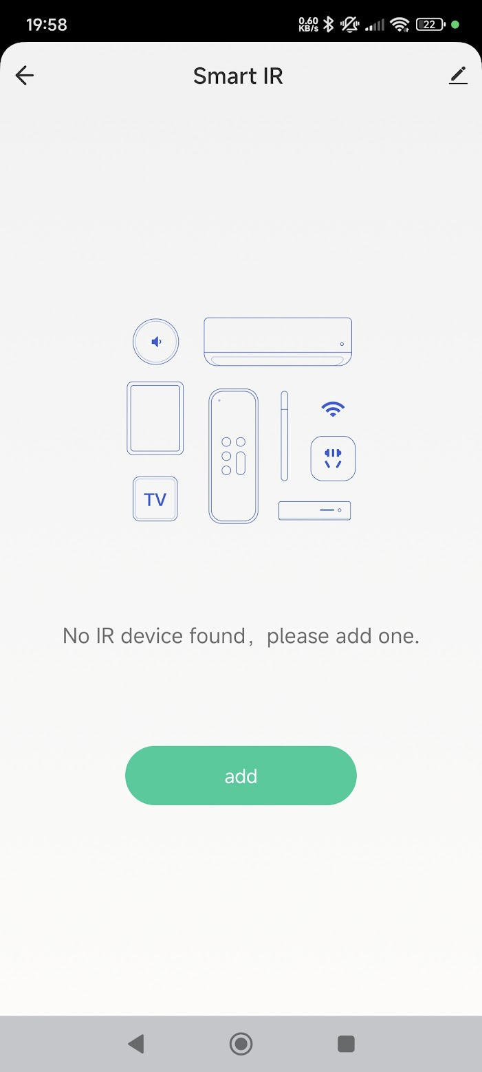

    that's just the official Tuya app - what you're avoiding by converting to OpenBeken ;)
    The JSON text is what you'd import into the web application
