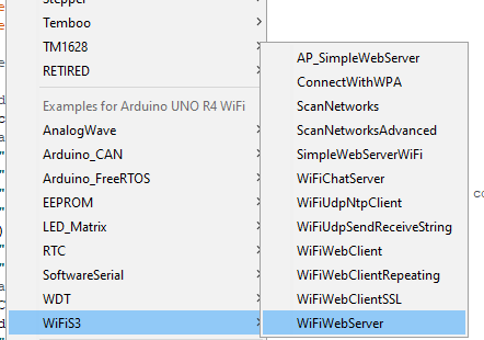

    Arduino R4 WiFi has some ready-made examples of network projects:
    Screenshot of Arduino menu with the WiFi WebServer example selected.

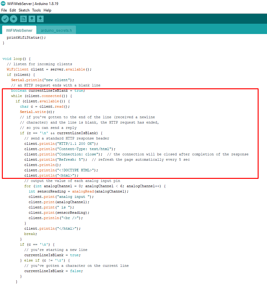

    But after opening them, to our surprise, it turns out that HTTP parsing is implemented in a very simplified way and is not packed into separate classes:
    Arduino code snippet showing HTTP request handling.
    So I started looking for a library that would offer it to me.

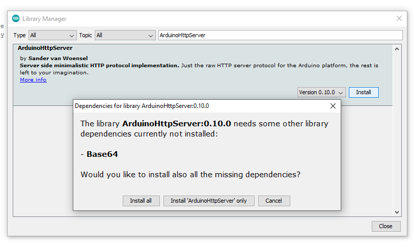

    ArduinoHttpServer installation and fixes
    We download ArduinoHttpServer from Libraries Manager, by the way, you also need to install one dependency, namely Base64:
    ArduinoHttpServer library with a popup window of missing dependencies

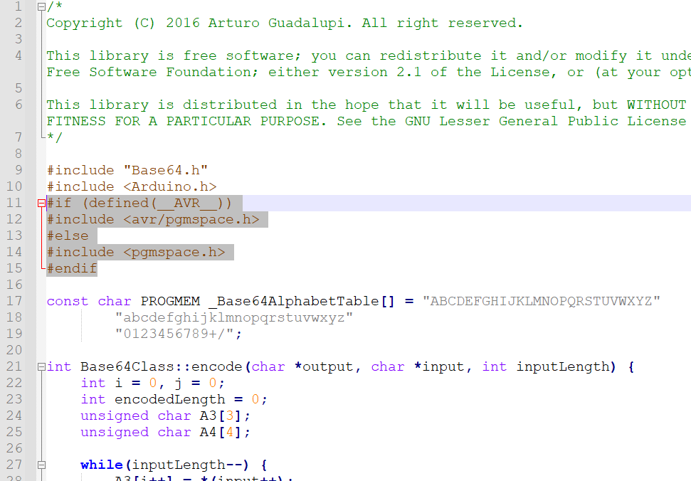

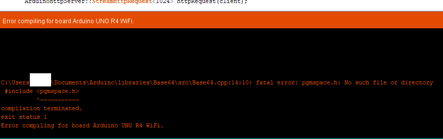

    Then you can try to compile their example from Github but it will fail:
    Code: C / C++
    We will get a compilation error like this:
    Screenshot of Arduino R4 WiFi compilation error.
    The pgmspace.h header is missing. We'll fix it right away. It is not actually needed in this case.
    We open the library code, for me it is under:
    C:\Users\Admin\Documents\Arduino\libraries\Base64\src\Base64.cpp
    Just comment out this block (or add define for R4):
    Edited source code in the Base64.cpp file with a highlighted conditional block.

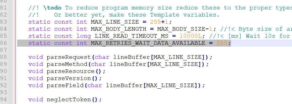

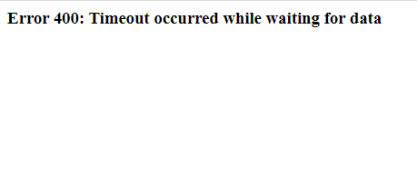

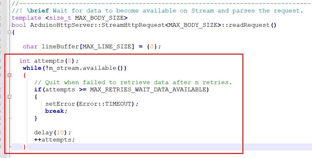

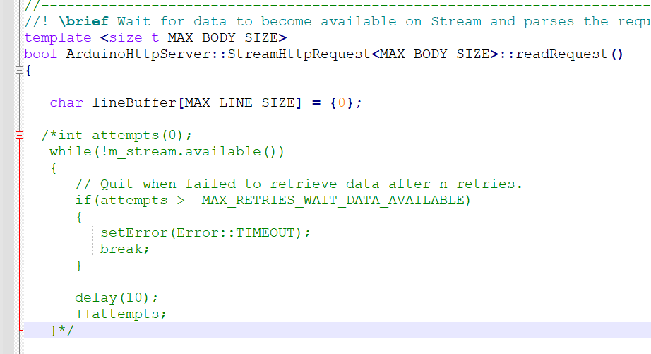

    Now the example should work, but if we sometimes get a message like this:
    Error 400 message: Timeout occurred while waiting for data.
    It's worth taking a look at:
    C:\Users\Admin\Documents\Arduino\libraries\ArduinoHttpServer\src\internals\StreamHttpRequest.hpp
    The problem is this piece of code:
    A snippet of ArduinoHttpServer code with a loop checking for data availability in the stream.
    It just detects a timeout error. Initially, I wanted to increase the value of the MAX_RETRIES_WAIT_DATA_AVAILABLE constant:
    Code snippet in a text editor with a highlighted line about the constant MAX_RETRIES_WAIT_DATA_AVAILABLE.
    but in the end I just commented out the whole block. From then on, the whole thing started to work a little more stable.
    C++ code with a commented-out block checking for timeout.
    I don't know how correct this approach is, but after this change, this library works a bit more stable for me.

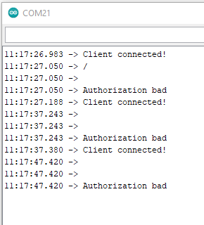

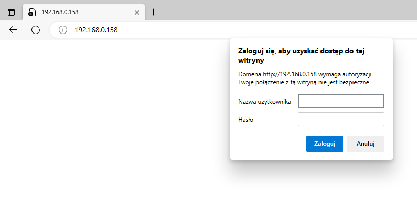

    Indeed, after entering the site, we have a window asking for data:
    HTTP login prompt on a local page requesting username and password.

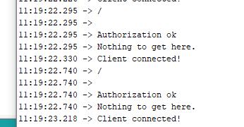

    After entering the wrong data in the log, we get:
    Screenshot of console messages about client connection and authorization errors.
    However, after entering the correct ones:
    Console screen with logs of Arduino program operation
    Authorization may be useful, but strangely enough, I don't see anything more fundamental anywhere, i.e. the ability to extract arguments from a GET request. We'll take care of it right away.

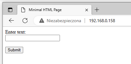

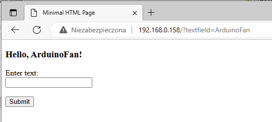

    Argument parsing implementation
    A short analysis of the library code shows that the HttpResource class is responsible for parsing the resource address. The author in this class only keeps one string and splits it up as needed:
    Code: C / C++
    The [] operator allows you to get to specific folders in the address of the resource:
    Code: C / C++
    All the magic happens in the snippet with the variable textField . The code checks if there is a GET argument with that name, and if so, it includes a message in the HTML displaying the textField value. If not, the display skips. In both cases, I continue to create an HTML form with a field named textField so that the user can easily send a GET request with the new value of this variable.
    After opening the page we see:
    Web page in a browser with a text input form and a Submit button.
    After typing the text "ArduinoFan" and sending:
    HTML page with a form field and user greeting.
    My GET argument handling seems to be working.

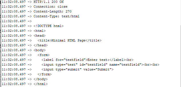

    It may seem strange, but nothing prevents you from using the HTTP protocol on the UART stream, instead of the TCP stream. Let's consider a larger example:
    Code: C / C++
    Result in the console:
    Screenshot of HTML results and HTTP header in console.
    That's right, this code just printed the sent HTML with the HTTP header appended. This very nicely shows the hermetic and modular structure of this library.
